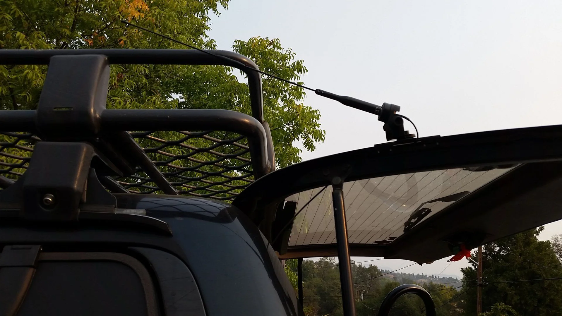

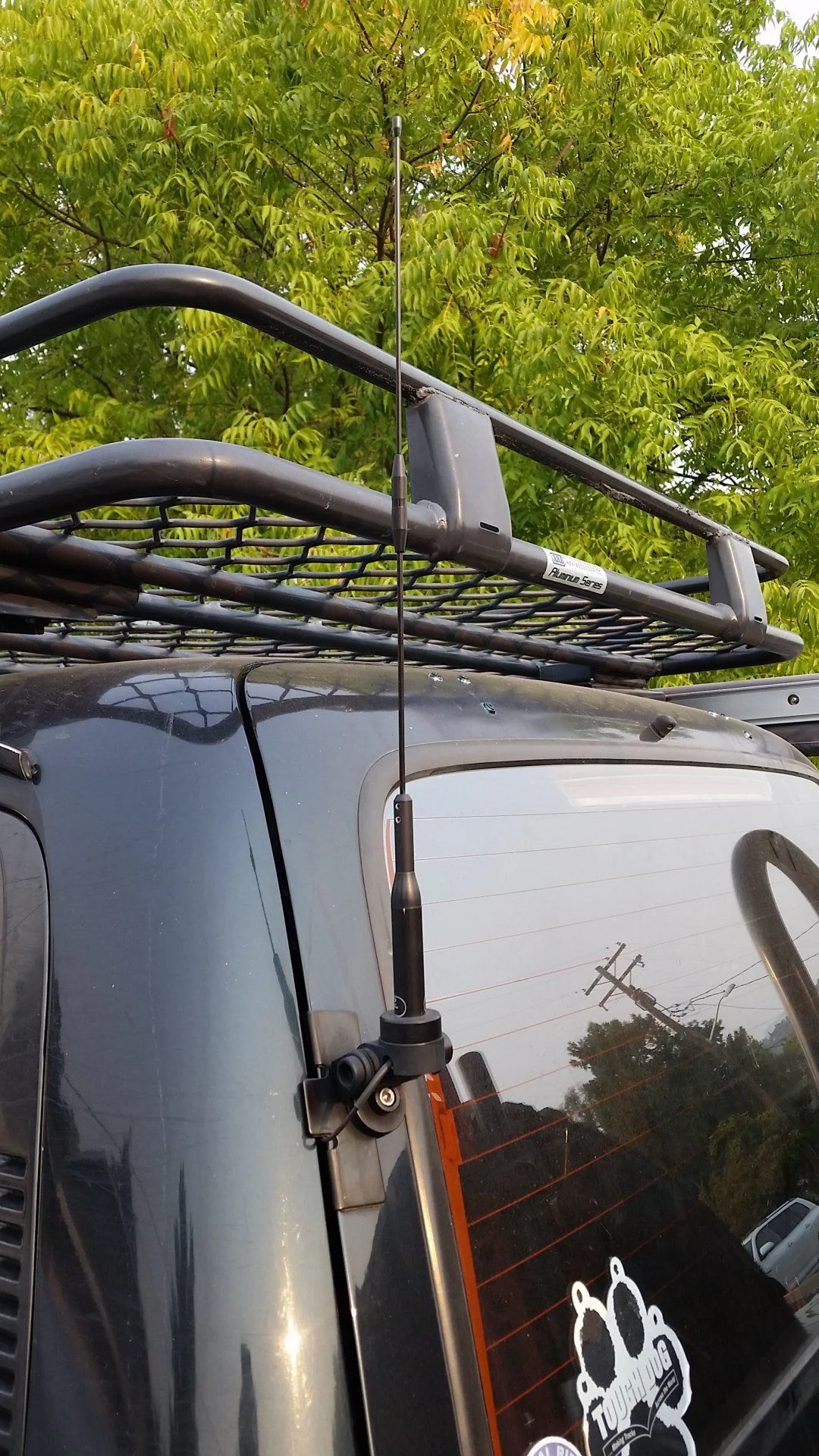

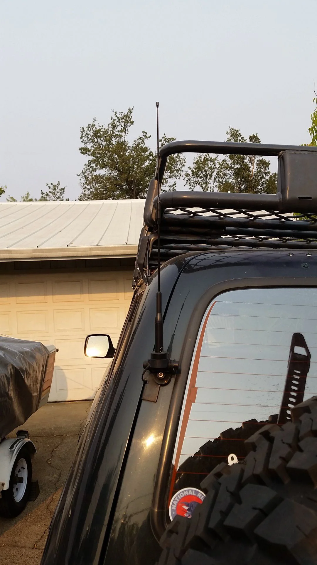

Alrighty then...finally got some pics to share of the Diamond K400 antenna mount. I got the idea for this mount from here on MUD, out of the Communication & Navigation forum. Like @retrofive, I've been real pleased with this setup and would not do it differently.
The attached antenna is a Comet SBB-2, which is a dual-band unit with NMO mounting base, 18" long, 1/4-wave (on 2M). It's rated for 60 Watts, but is hasn't blown up yet from the 75 Watts I usually push through it.

And...a pic of the radio(s). The Ham unit is a Kenwood TM-281.
