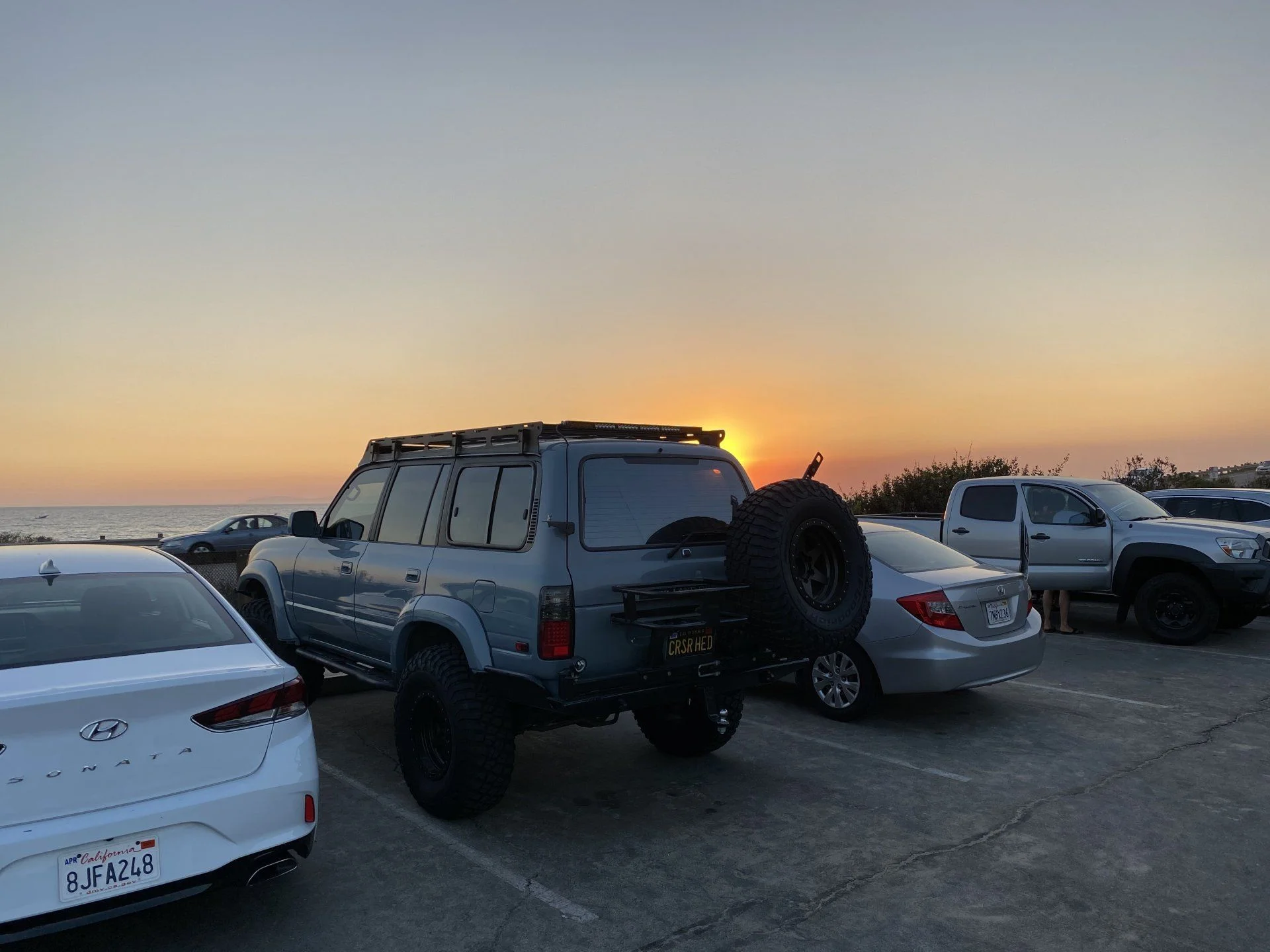

Went to beach this afternoon to beat the heat
Regular length shocks, med rear spring/heavy fronts.
I have a bit of sway/wander but thinking its mostly due to the front being too stiff since i don't have a winch in the bumper or dual batt in yet. A bit oversprung still.
Still much much better with the delta parts.

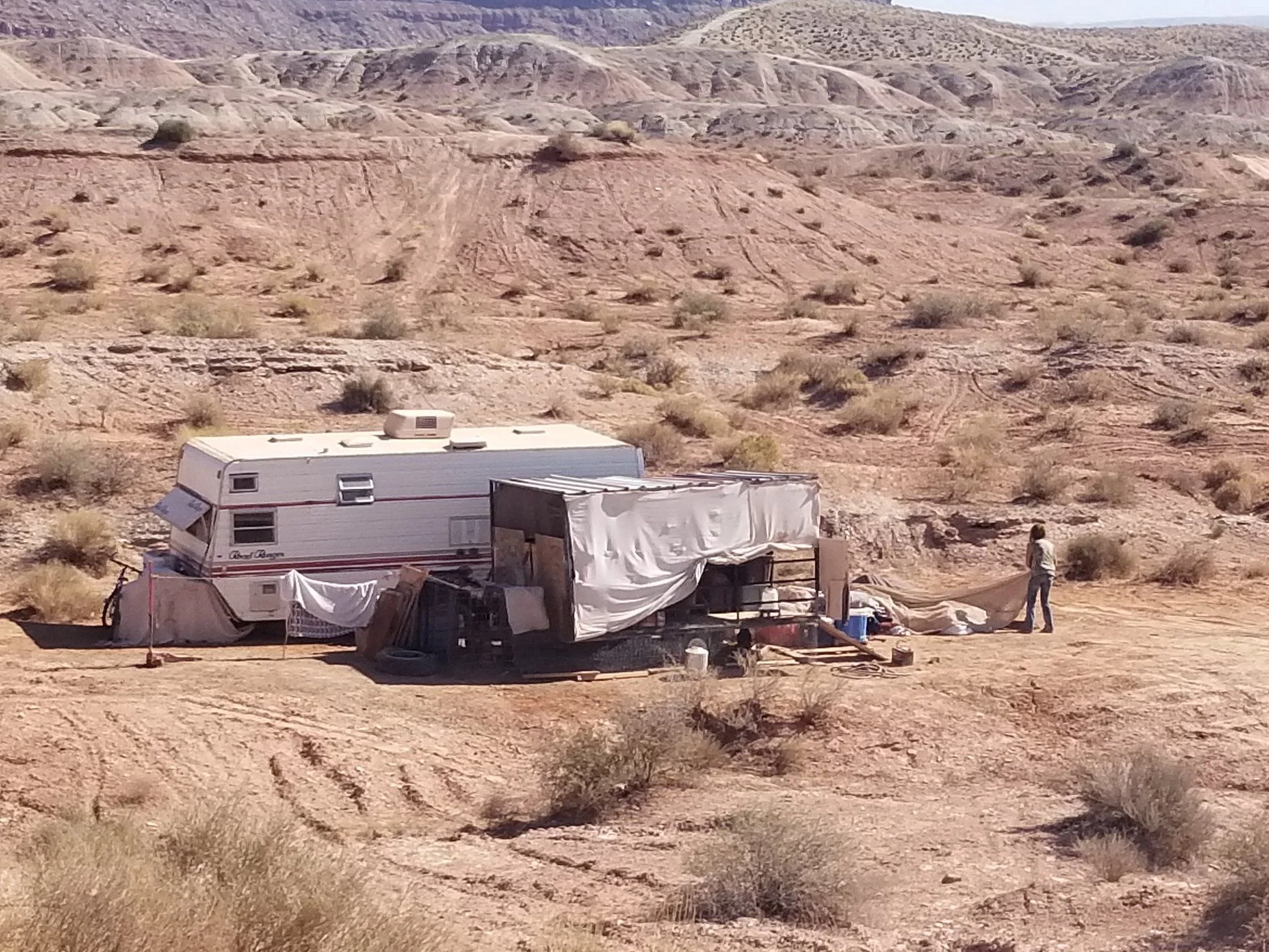

Did a little exploring and found another access to a local river. Than I was looking for a new spot close to home for shooting the rifles because I am elk hunting the next couple of weekends. As I was looking for a shooting spot I came across this weird situation of squatters. They were clearly alarmed by my arrival and immediately started pulling tarps over something. They were even raising chickens. The worst part is that the BLM knows about them and won't do anything about the situation.
View attachment 2449977View attachment 2449978View attachment 2449979
Looks like a scene from Breaking Bad!

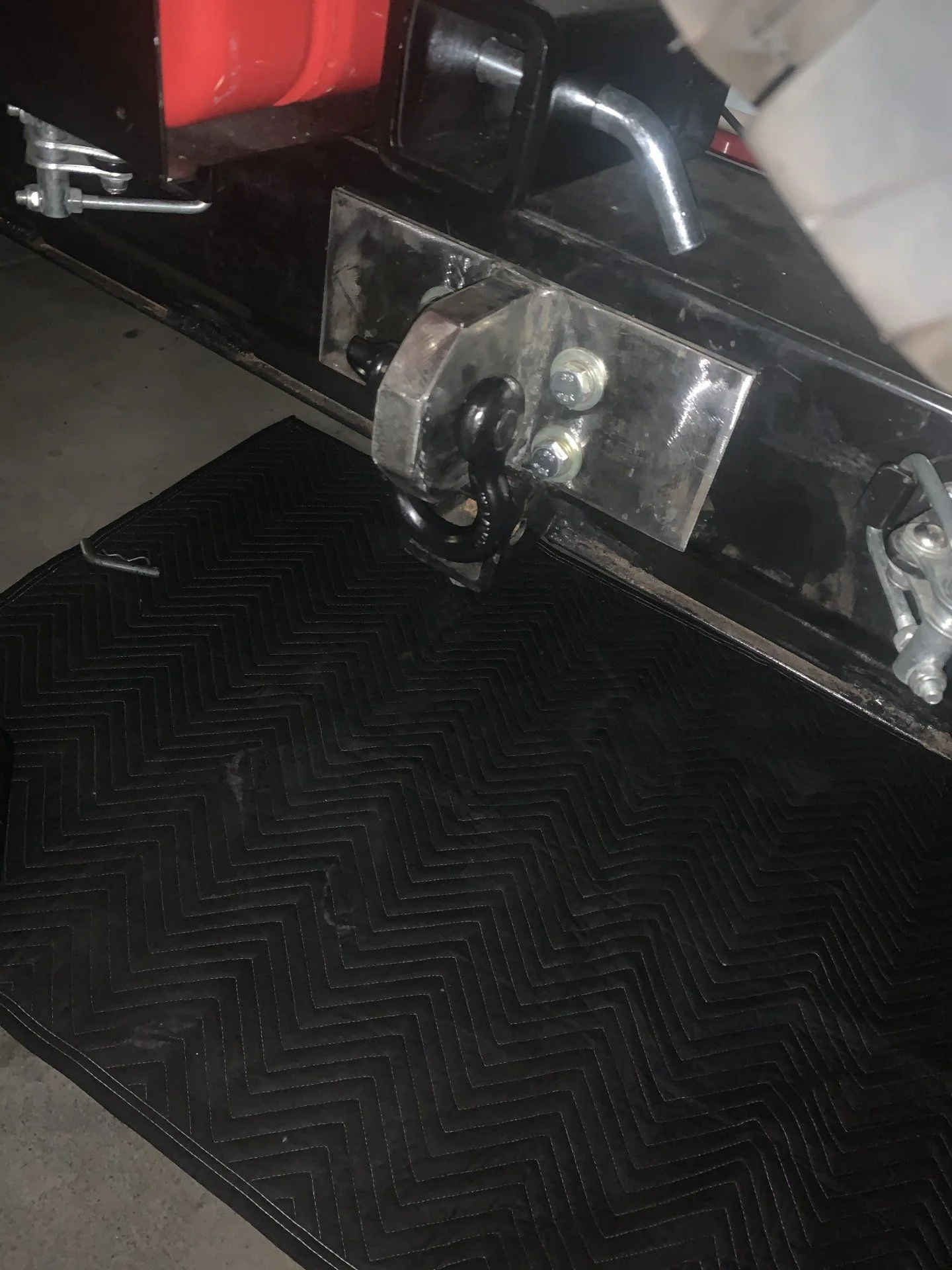

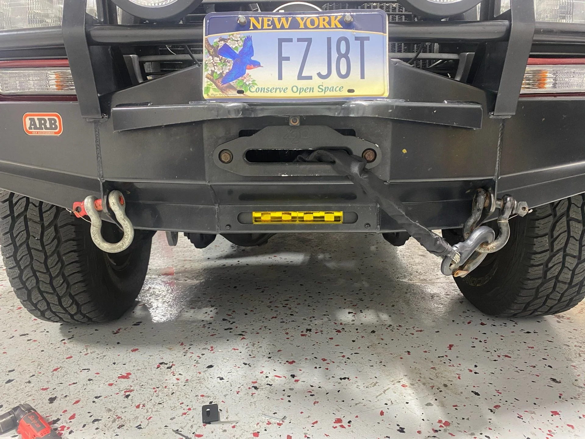

Fabricated a clevis mount for the “unused” to me pintle holes.
1” thick 4” steel bar through welded to a 1/4 inch plate.
this is not bolted to the aftermarket bumper, it is bolted to the rear crossmember.
I cut a 4x3” section out of the aftermarket bumper to fit the unit.
Obstacle: there is a 2” space between the aftermarket bumper and the rear cross member. To torque the bolts down without relying on the 1/4 plate as an anchor, I had to weld four 3/4 ” .120 wall square tube standoffs where the bolts go through. Each is exactly 2” long. I can torque to specs without bending the plate.
next step: weld the plate to the aftermarket bumper and paint.
Concept: originally, I wasn’t going to add a recovery point. I didn’t like how the aftermarket bumper relied only upon the 6 tow hitch frame bolts to anchor to the truck. I wanted to use the rear cross member as well.
