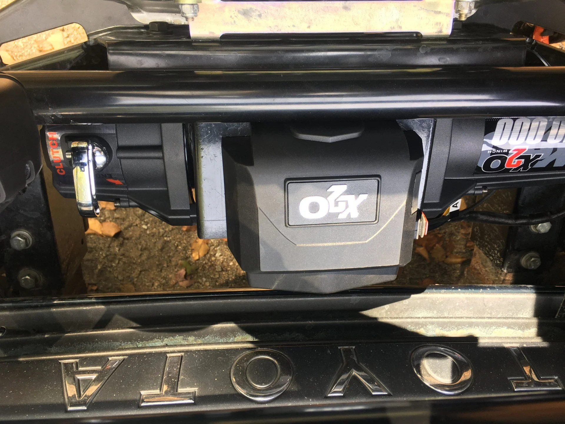

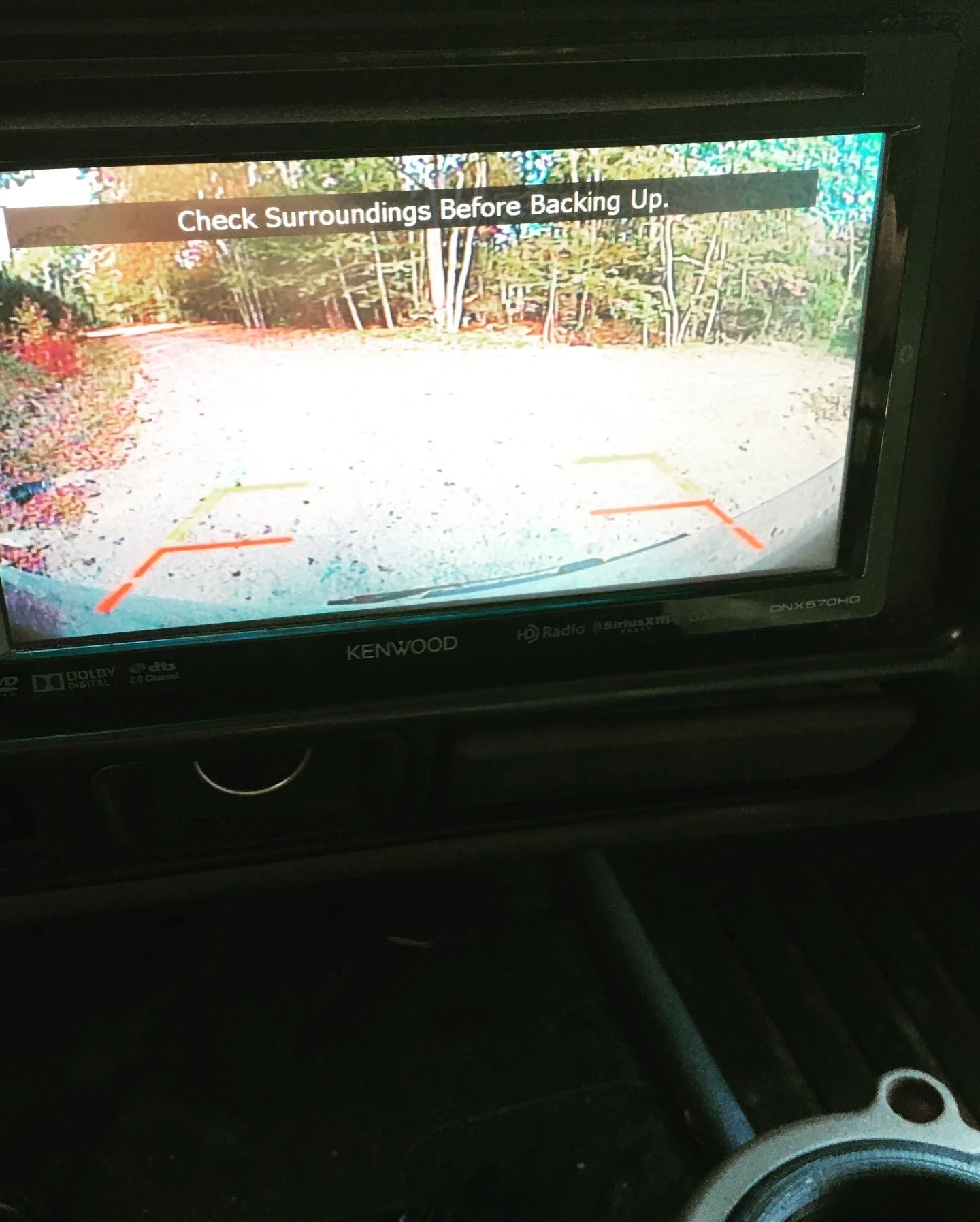

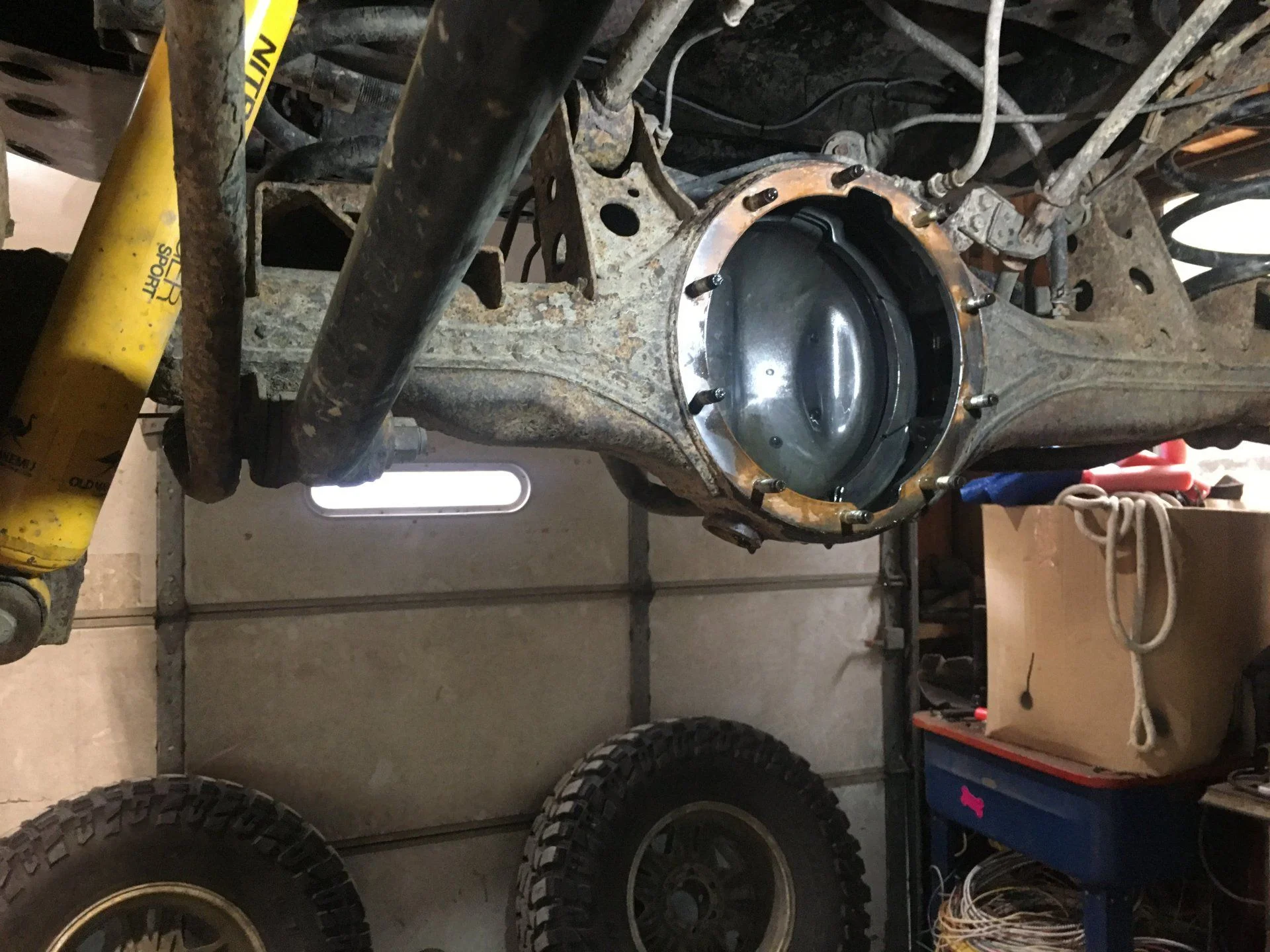

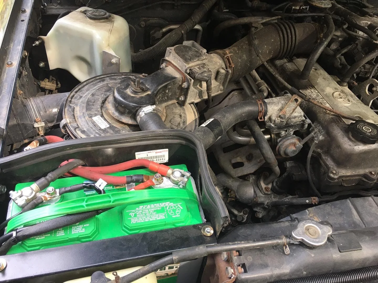

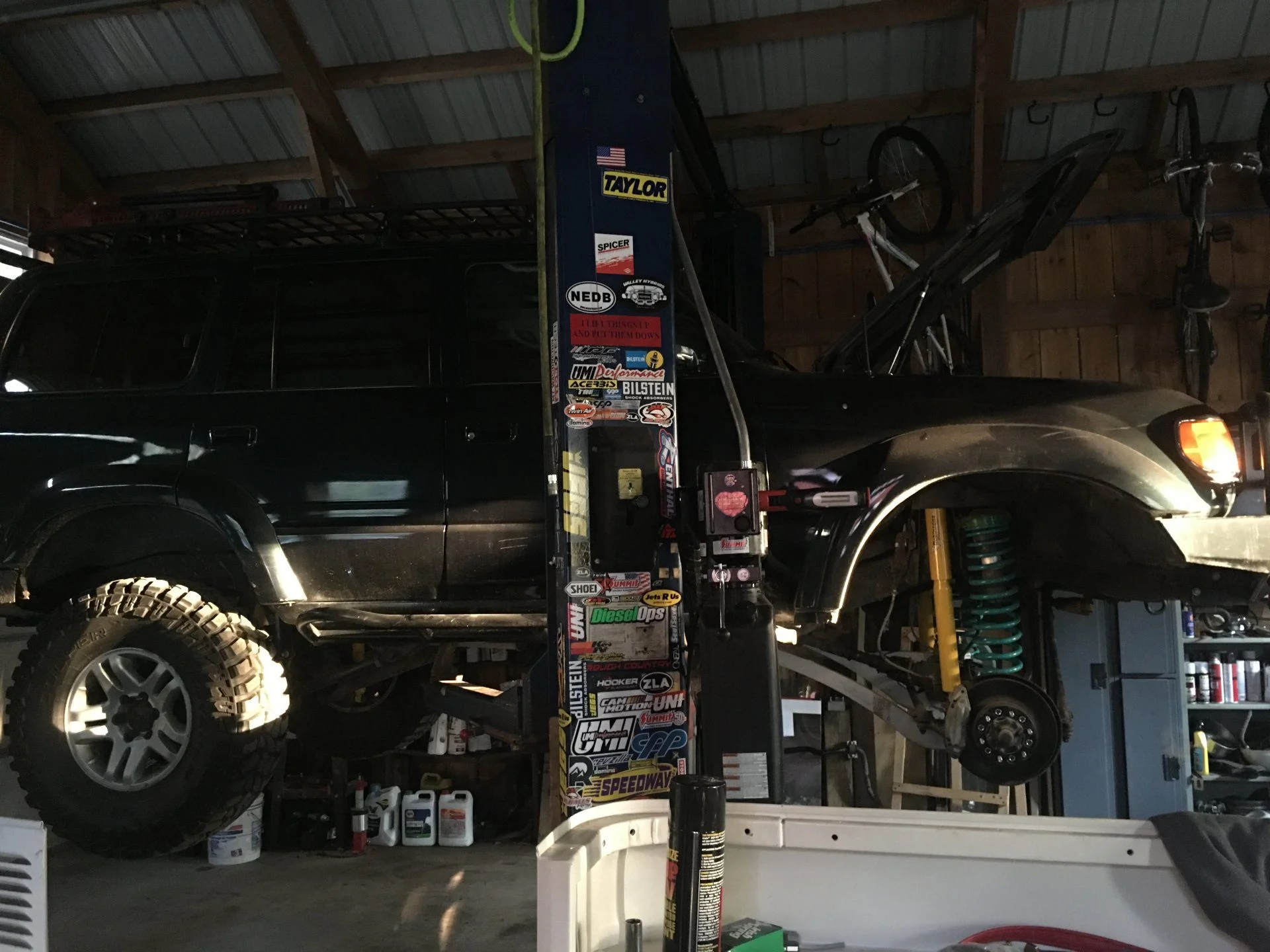

Got caught up on 80 series projects this and last weekend. New dobinsons front suspension, dual battery install, center console swap, spartan locker, pinion seal, reverse camera hooked up, front winch replaces, rear winch repaired, cleaned up some wiring and repacked/adjusted front wheel bearings.

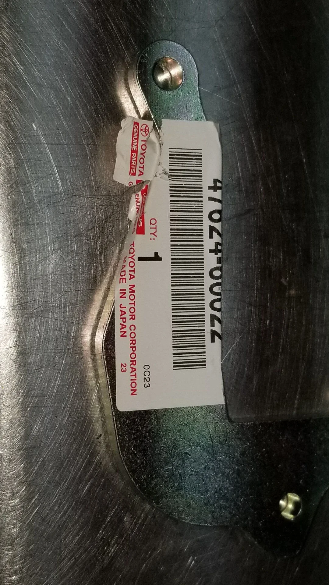

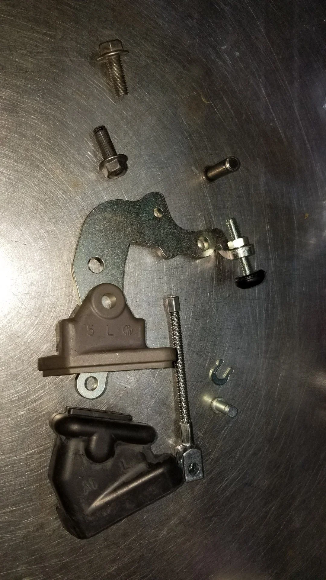

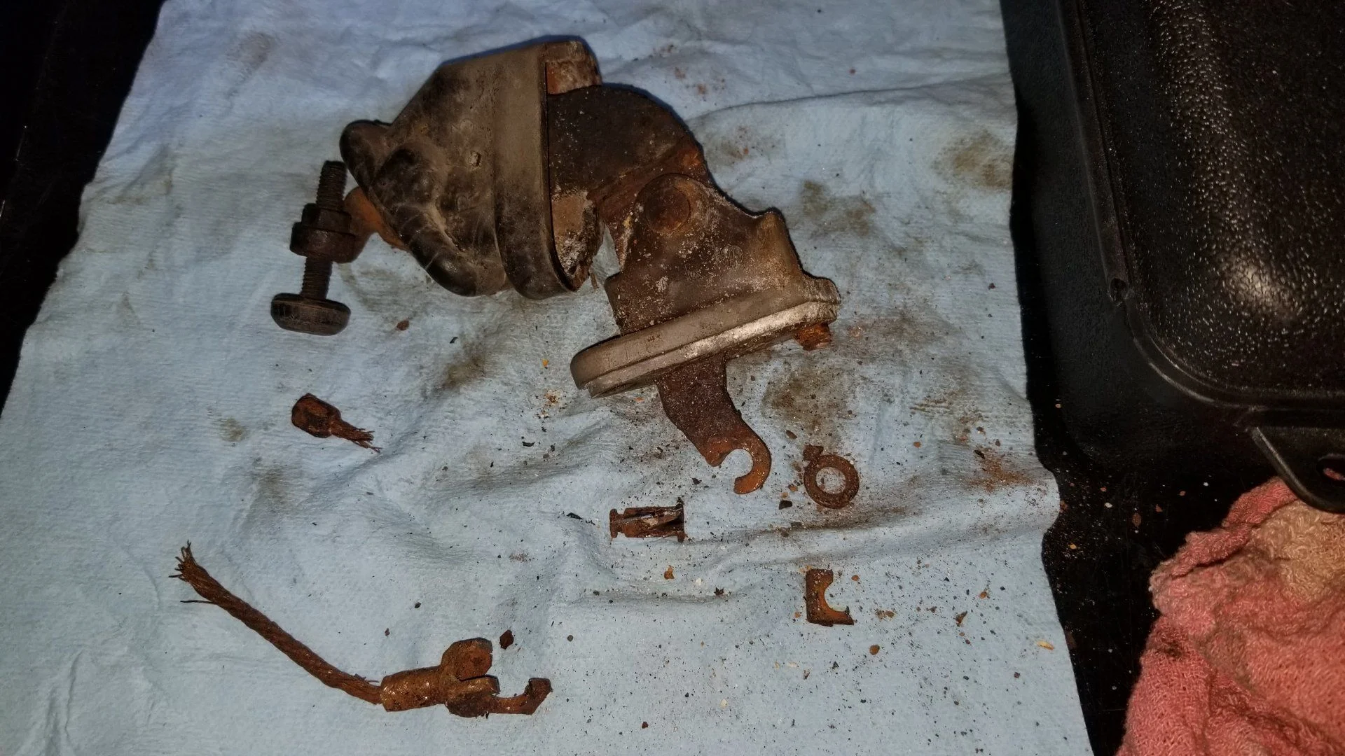

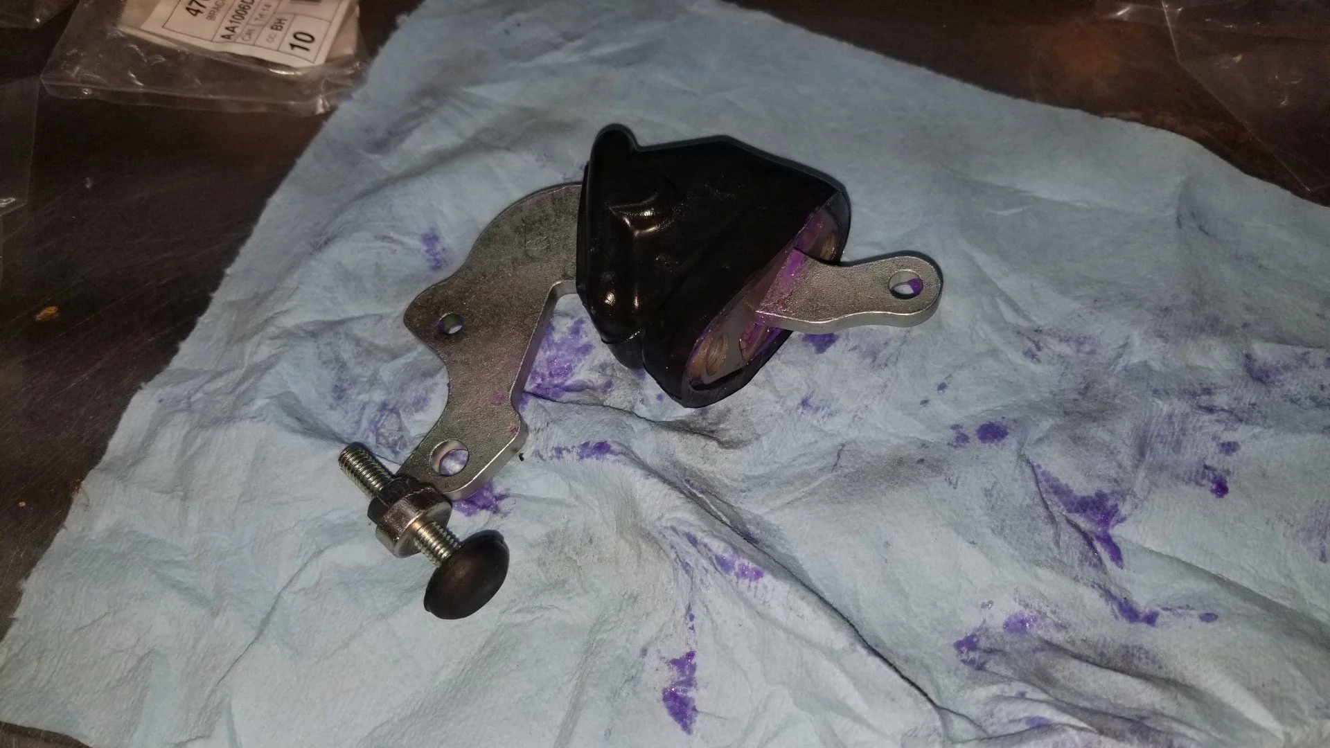

Used the down time waiting on a new knock sensor to take a 3rd shot at fixing the parking brakes. Had already installed new brake hardware previous, but still had binding. Finally saw an OTRAMM video explaining how the bell cranks seize and sure enough, that was my issue.
These were seized so badly I ended up having to cut the pins out of them to remove them. Then each side snapped a bolt on removal too. Oh, and the pull cable was snapped on one side.
Quick side note ... not sure if McGeorge or Toyota are the ones doing this, but putting the sticker right on any part large enough to hold it is a major PITA. Spent a bunch of time removing sticker glue from different parts. Just bags it ... then tag it.
New hardware. Heads up to others that components are labeled L and R for proper fitment.
Purple brake grease as per OTRAMM assembly video, what an outstanding community resource.
Done and assembled. Needed to recruit the kid for help in reassembly, just way too awkward trying to hold everything together at once.
Hoping this fixes my issue. The wheels will now rotate by hand, so should be all good again. Finger crossed, I want to be done working on this truck and back to driving it again soon.
Just went through this a few weeks ago myself and yes, that sticker is a pita. I took a wire wheel on the drill to it and that was that.

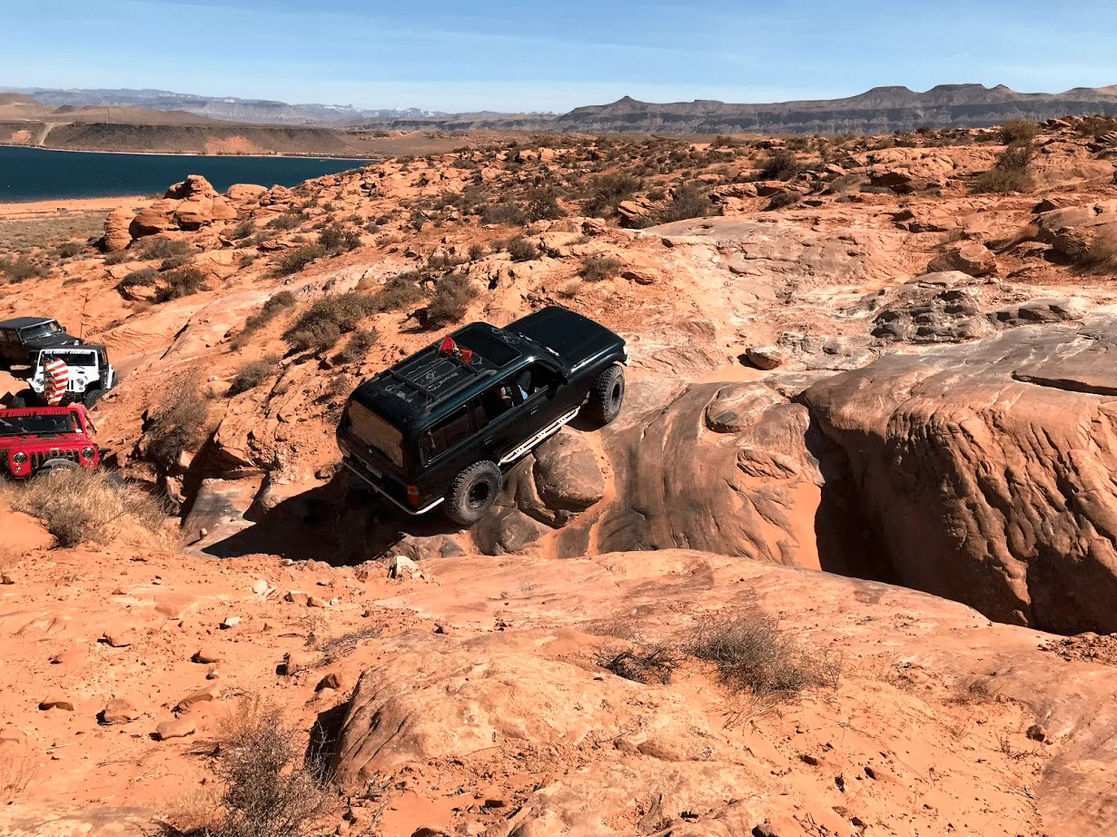

Nice pics Rich! It see a few familiar spots. I think this pic is the same spot as your last photo. Fun little obstacle.
