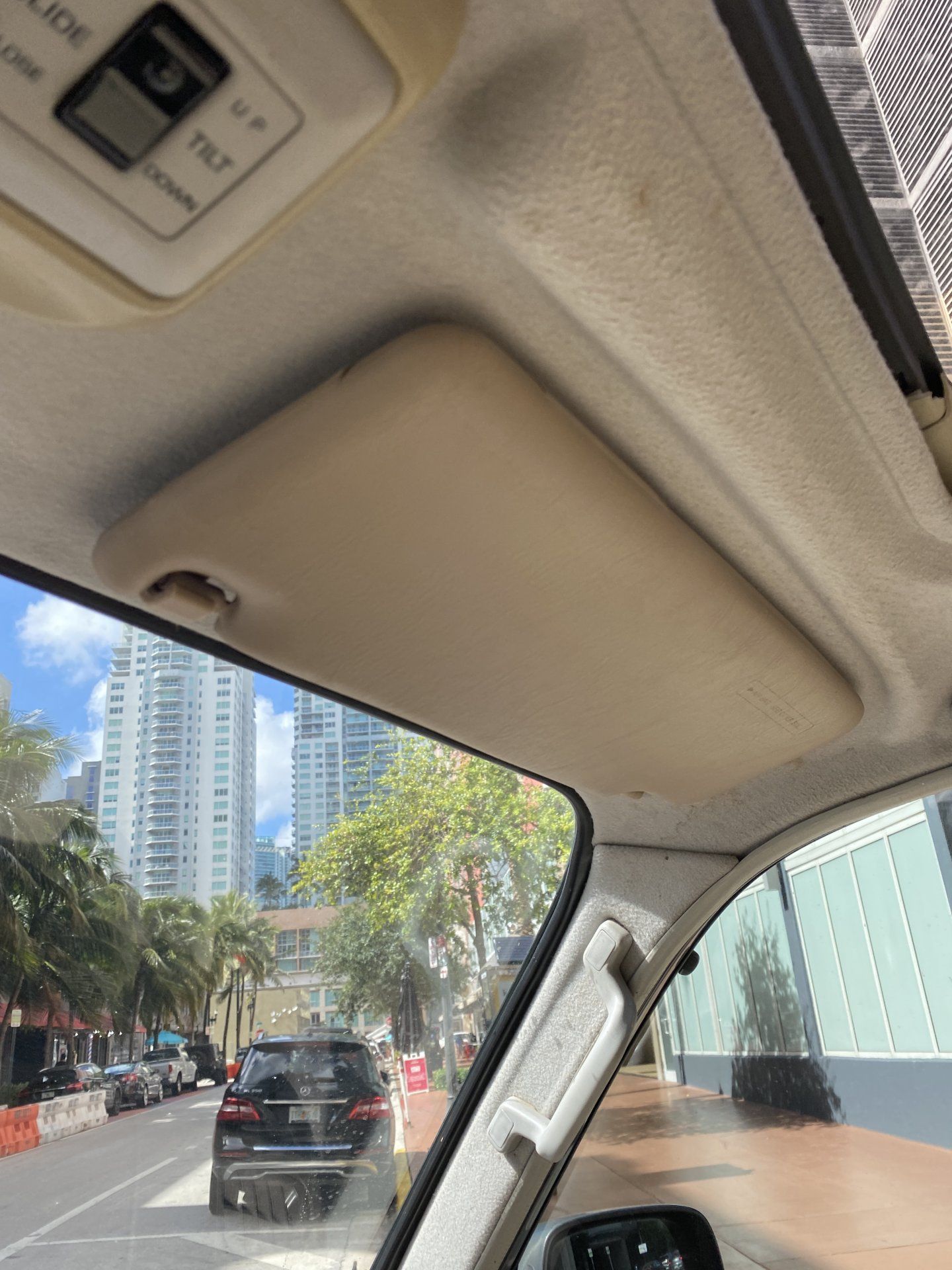

Got a link to the visors?
Are they a direct bolt on with same wiring?
visors can be found on ebay. the connector off the existing 80 visor wiring loom needs to be transferred over to the LS400 loom in order for it to be plug and play.
