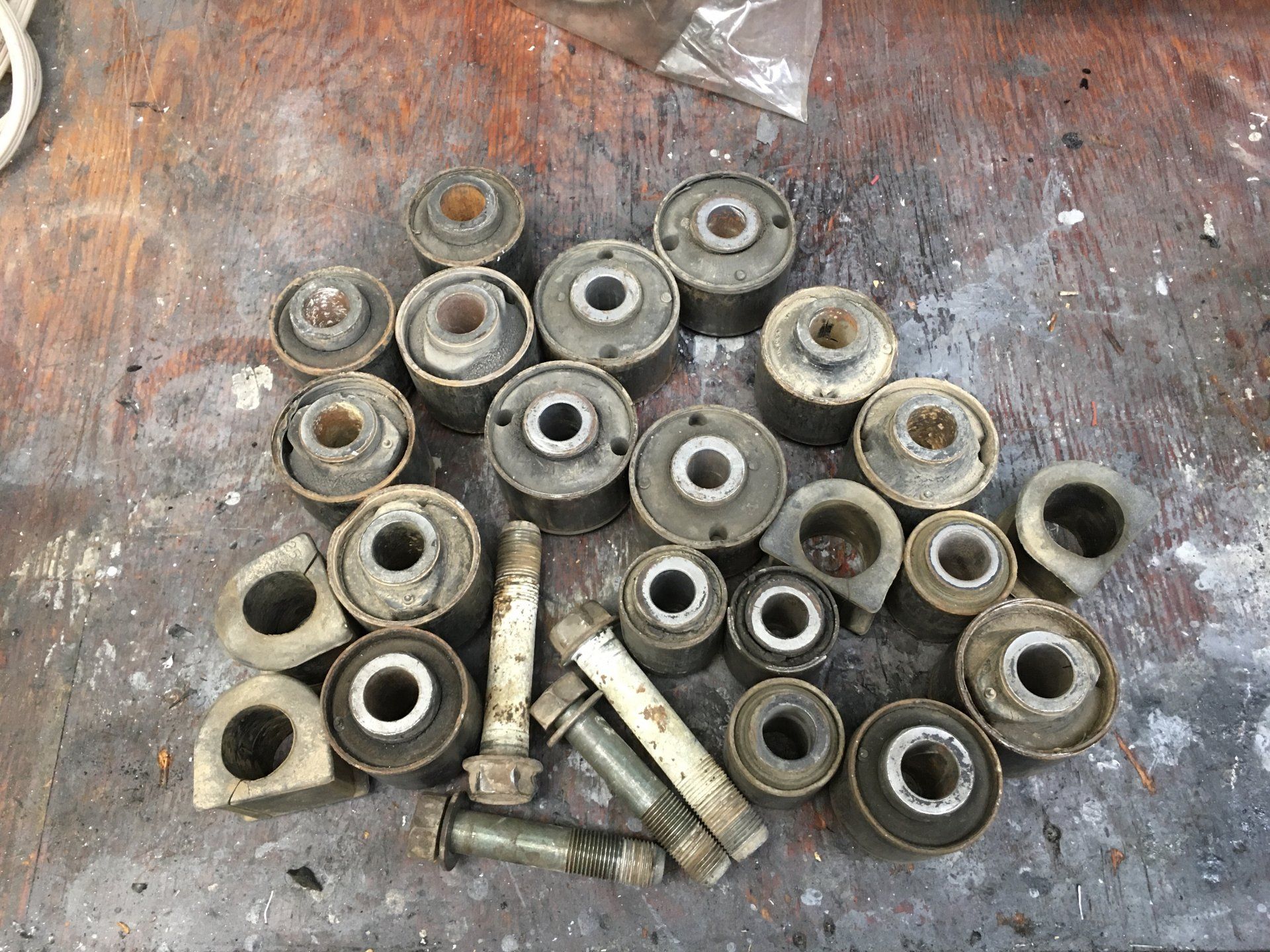

Replaced all of the suspension bushings
Used a Harbor Freight 12 ton press that I pushed to maximum capacity! I don’t care for suspension work, so I used OEM, figuring that they will outlast the remaining life of the truck.

Full suspension bushing update is on my long-term to do list as well. Any real noticeable difference in ride quality once done?
I did mine a few months back. The difference is not a night and day thing but definitely very noticeable. Most of my old bushings were still in one piece but if yours are split then i imagine the difference would be massive.
It isn’t huge but noticeable. After 23 years and 300k, the old bushings were in ok shape. The worst ones were the front Panhard rod bushings, and it eliminated the front end wandering that I had at highway speeds. I plan on driving this thing into the ground so it needed to be done sooner or later.

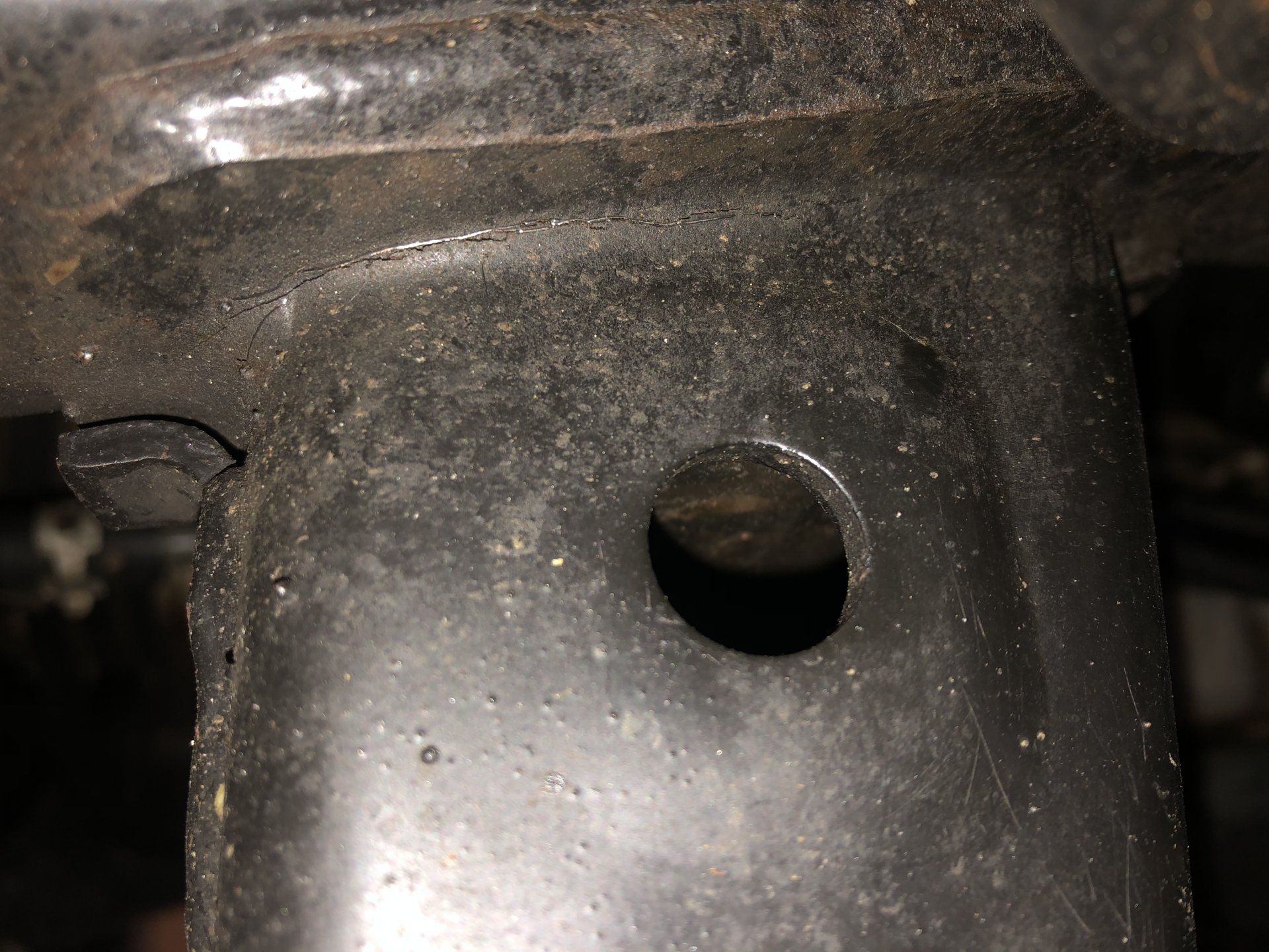

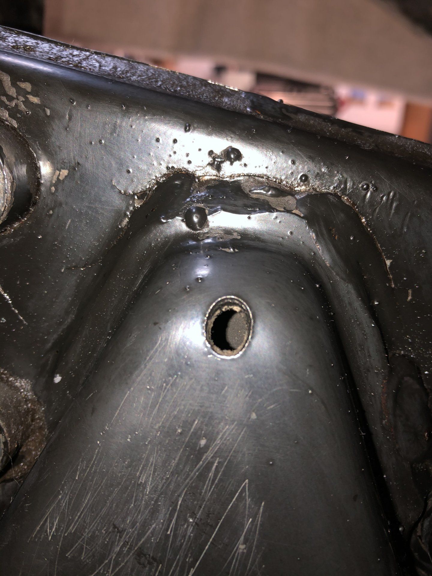

Good catch
I check for cracks in likely areas quite often and I knew it was just a matter of time for the frame and track bar bracket. Instead of patching it up and watching for the work hardened metal crack again, I cut the track bar bracket off, fish plated both sides of the frame and am in the process of building my own track bar bracket from scratch. I’ll post this project to my build thread once it’s finished.
