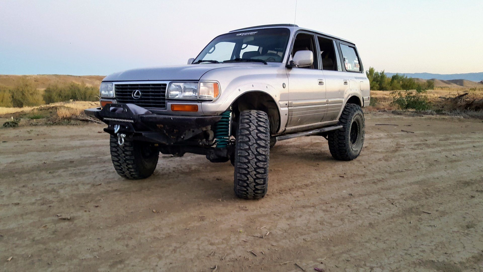

Decided to add some real recovery points to my bull bar:

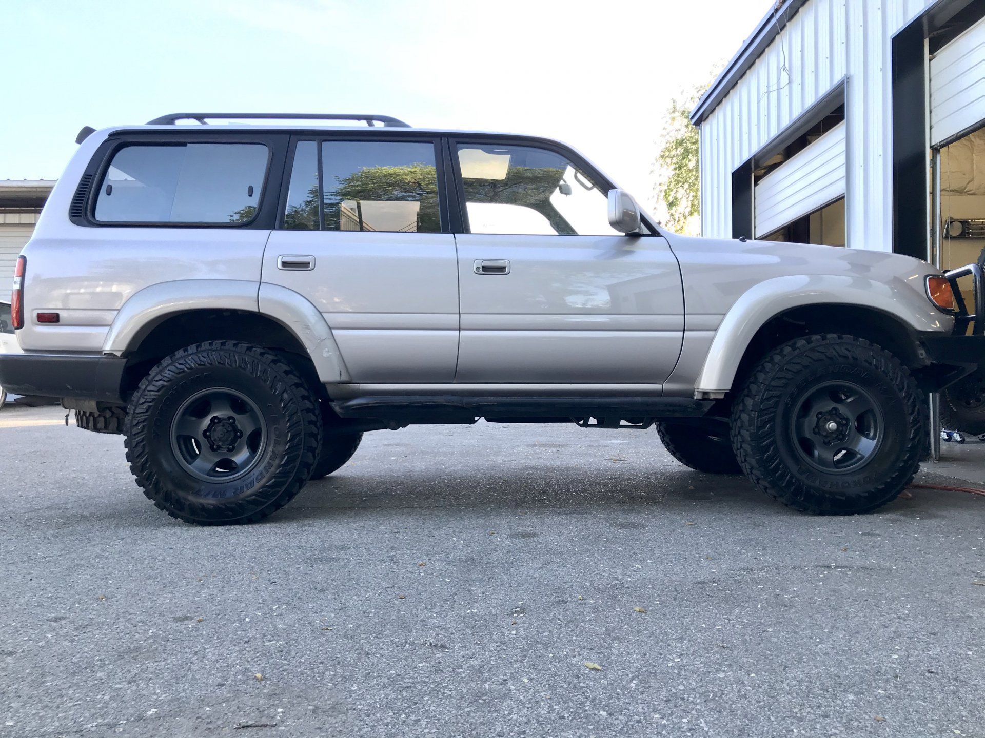

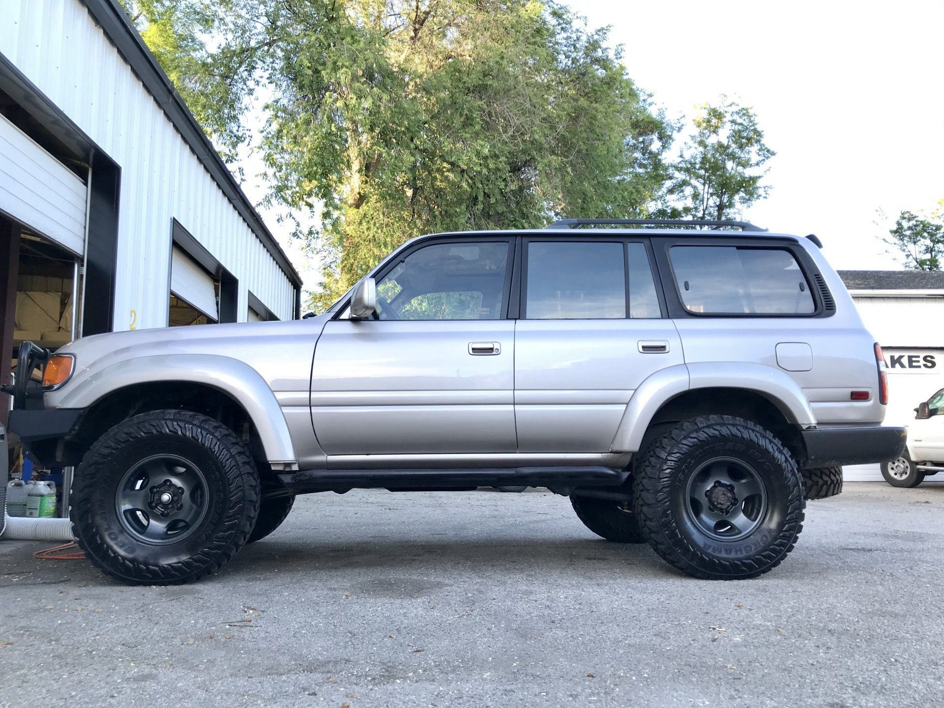

Did you give up on the flares or are they off for trimming?
I like the flare look.

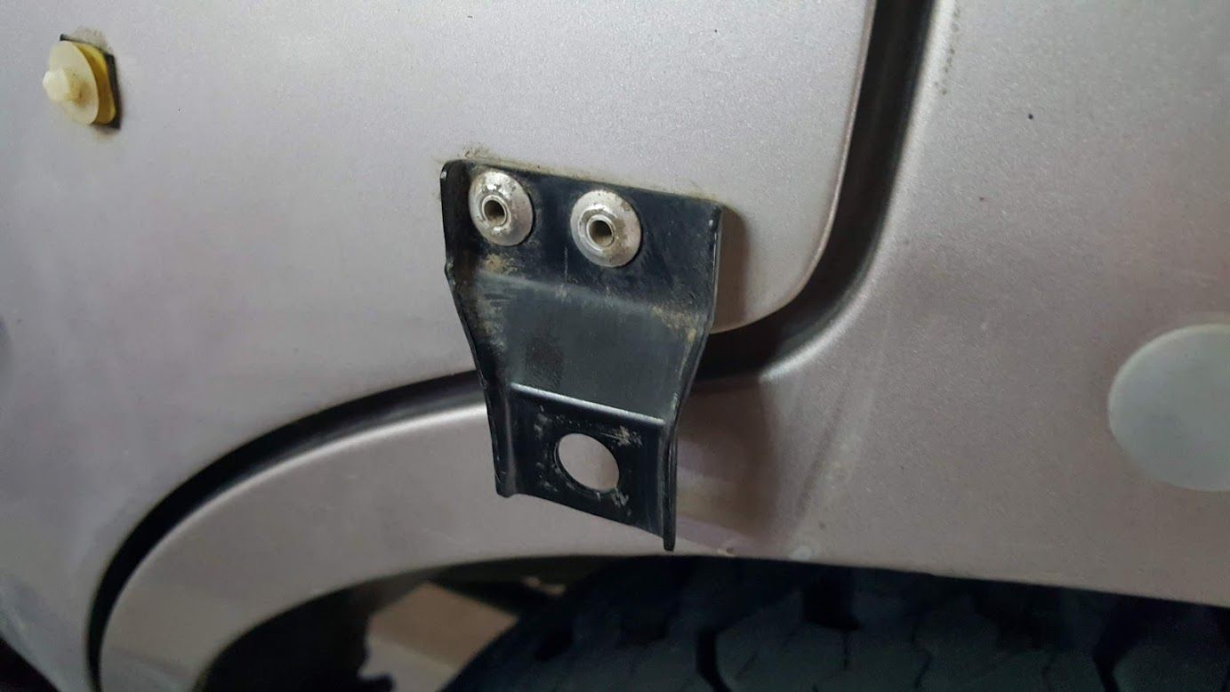

I can make the flares fit the 38s.
Im still on the fence... at this point I can still bolt them back on.
Just need to install some rivnuts to bolt rear door clips back on.
I have one big wheelin trip planned in Sept.
Maybe I'll bolt them back on for winter.
How many Lx450s out there with bigger tires?
What do all you ih8mud 's think???

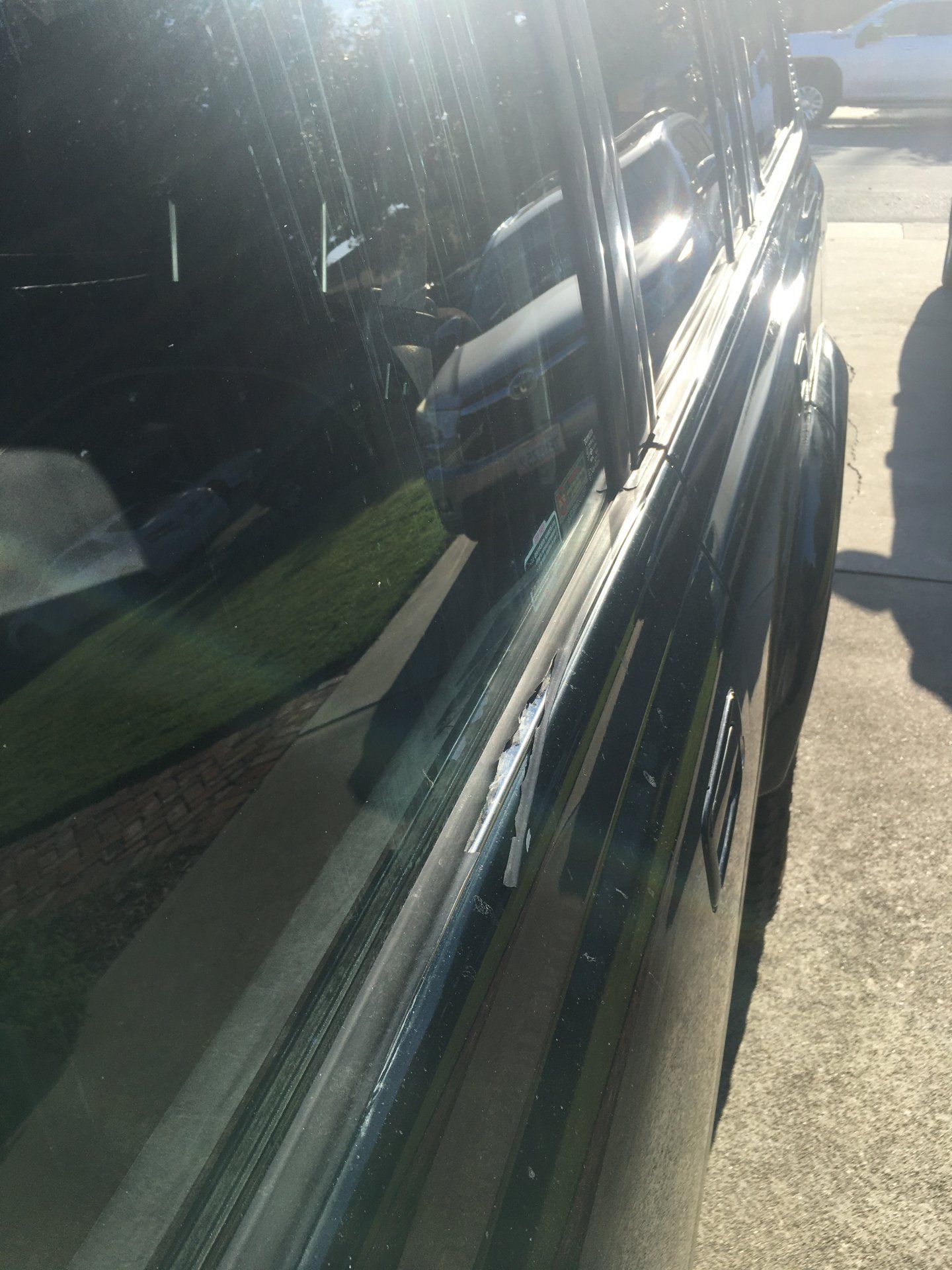

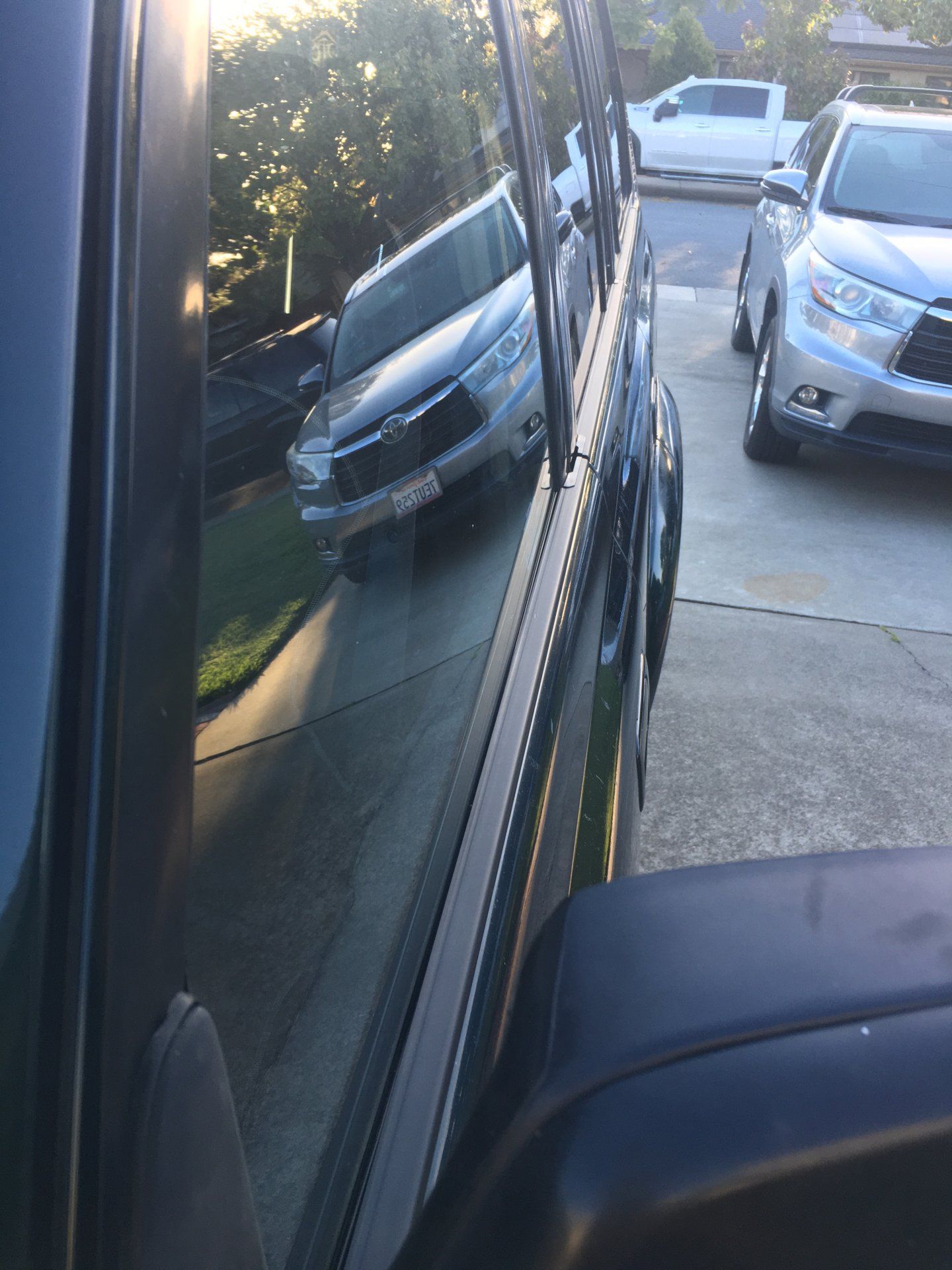

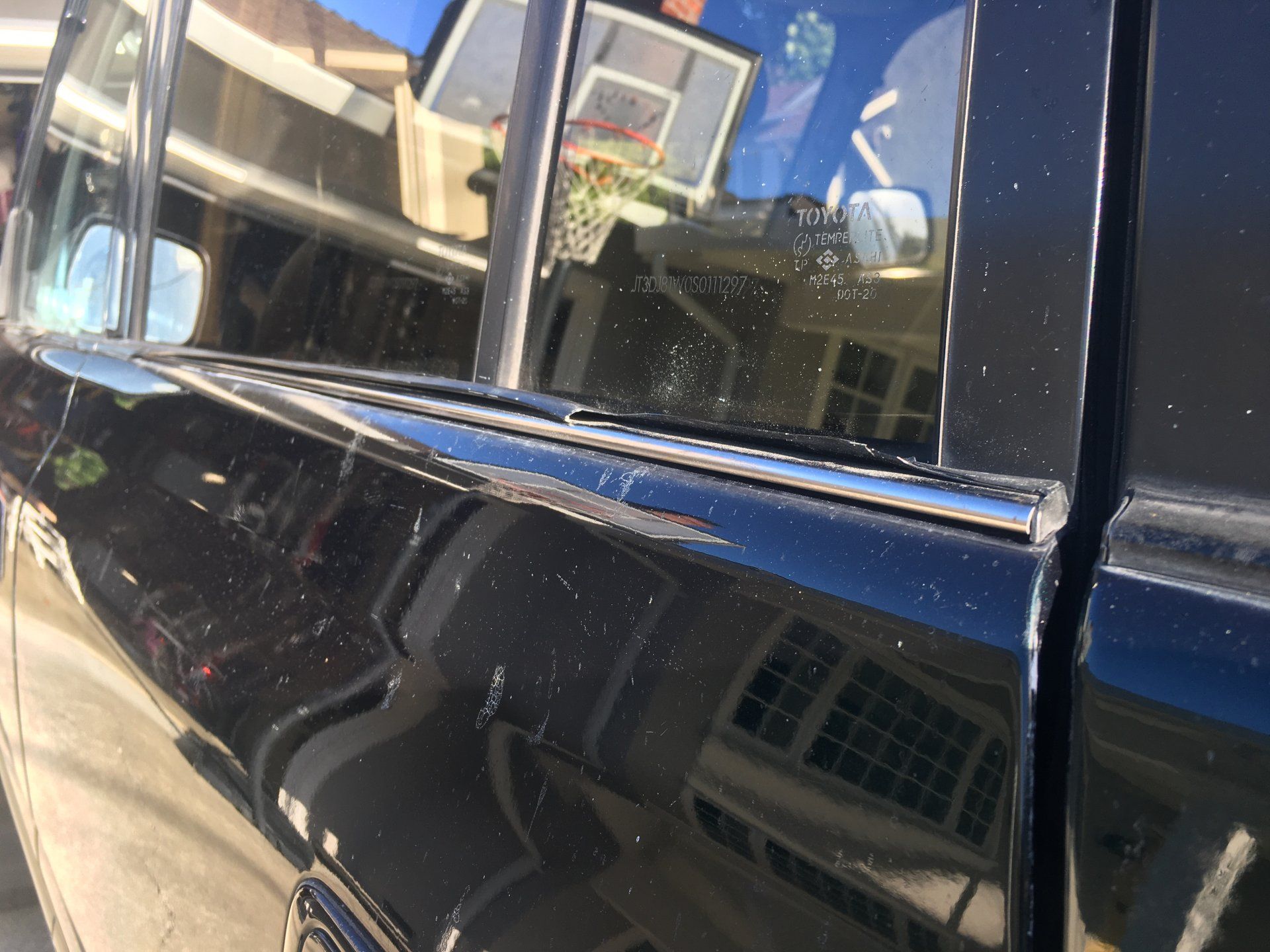

Nice job! I've got to do this too. Is there a link on how to do this replacement?
It's pretty straight forward, they pop right off, used a screw driver with the tip taped. FYI, the small plastic tabs on the old molding may break off, that's ok. There's also a small screw that holds the front one in...can be seen in first pic, at the end of the moulding.
I had to remove the side mirror to replace the driver's molding. If you have to do this, be careful to support the weight of the mirror so the wire doesn't disconnect. If it disconnects, you have to remove the door panel to reconnect it. Not difficult, but annoying... learned the hard way.
Reinstalling them is a cinch, pops right back into the slots.

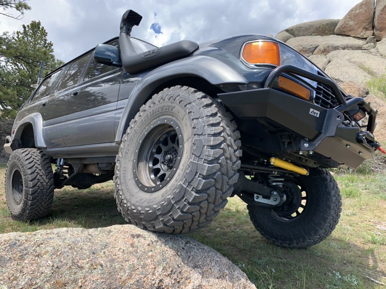

First time off-road since mods, seeing where I'm at with flex. It's stuffing pretty good but does need a tiny bit of rear trimming, anything rough would pop a flare. Gotta admit I'm pretty pleased with slee lift so far, feels more comfortable and less firm than my last couple set of Kings on other rigs.
Oh and 15% tint all around
