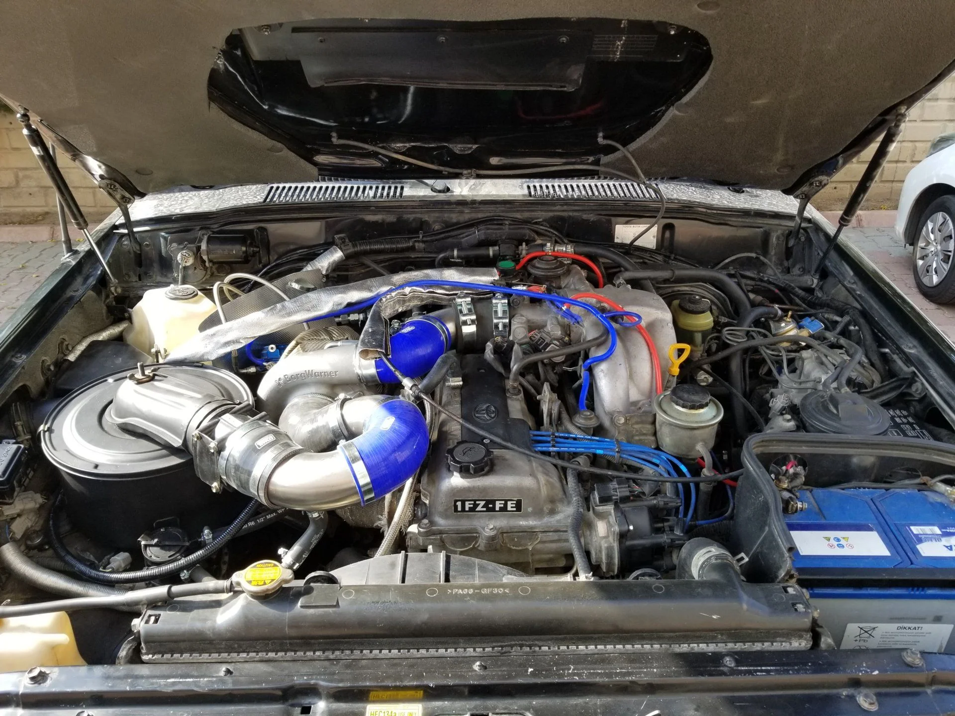

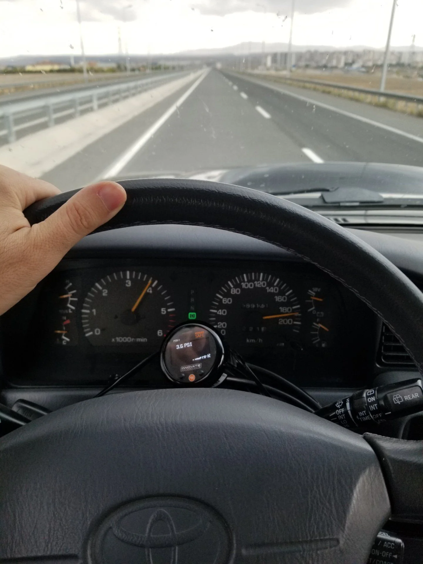

firsr run, only 3.5 psi.

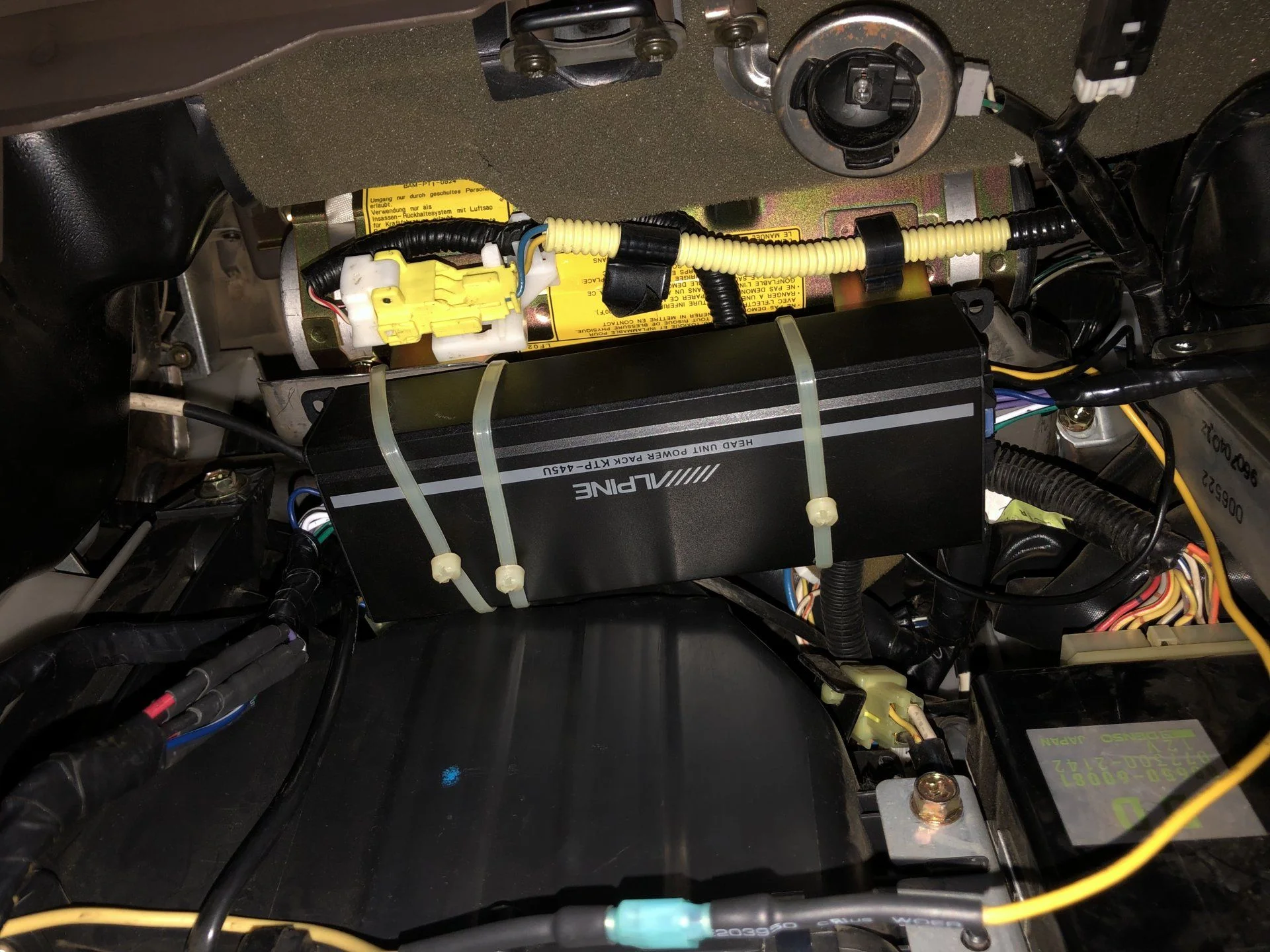

Is the Alpine inline amp worth it in your opinion? I am always about to buy one and never pull the trigger... I feel like it would be worth it with some better quality speakers.
I have used in multiple vehicles. I think it is great.

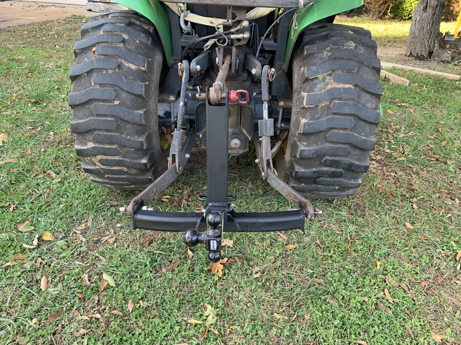

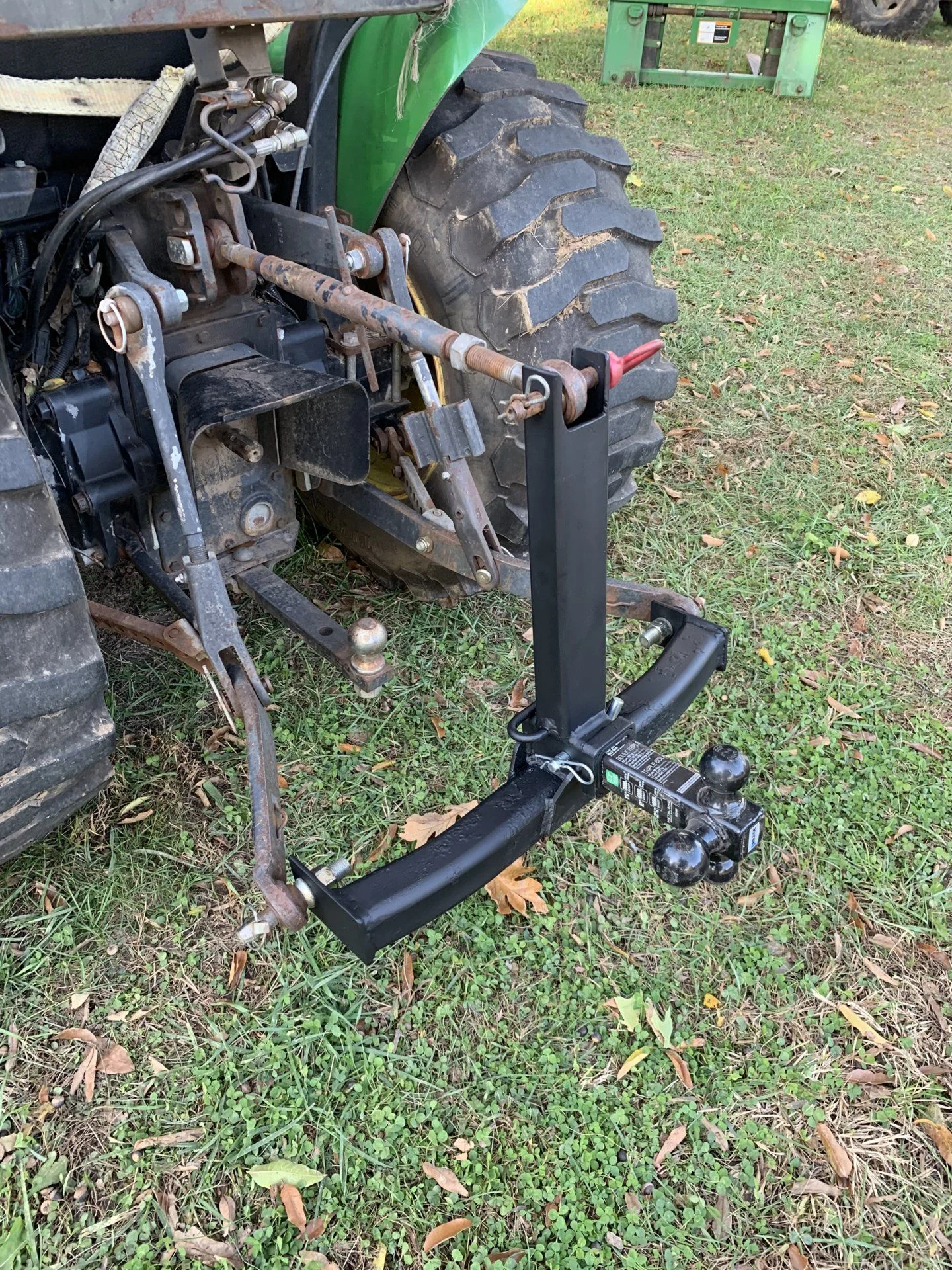

Took the boat anchor hitch and turned into a tractor three point Hitch.

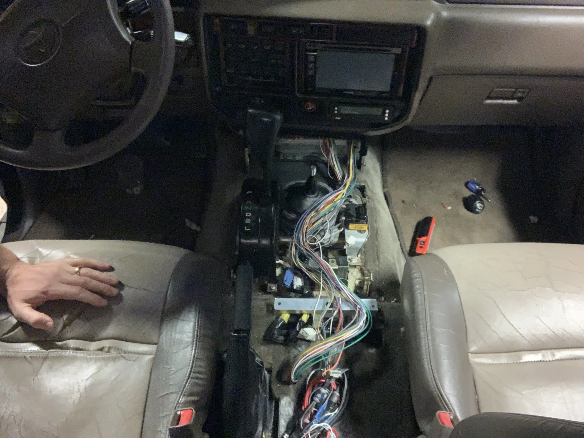

finally fixed my @#%ing airbag light. Ended up being the airbag control module behind the center console. For 95-97 cruisers part # 89170-60010. I gambled and bought a used one off eBay and it worked.

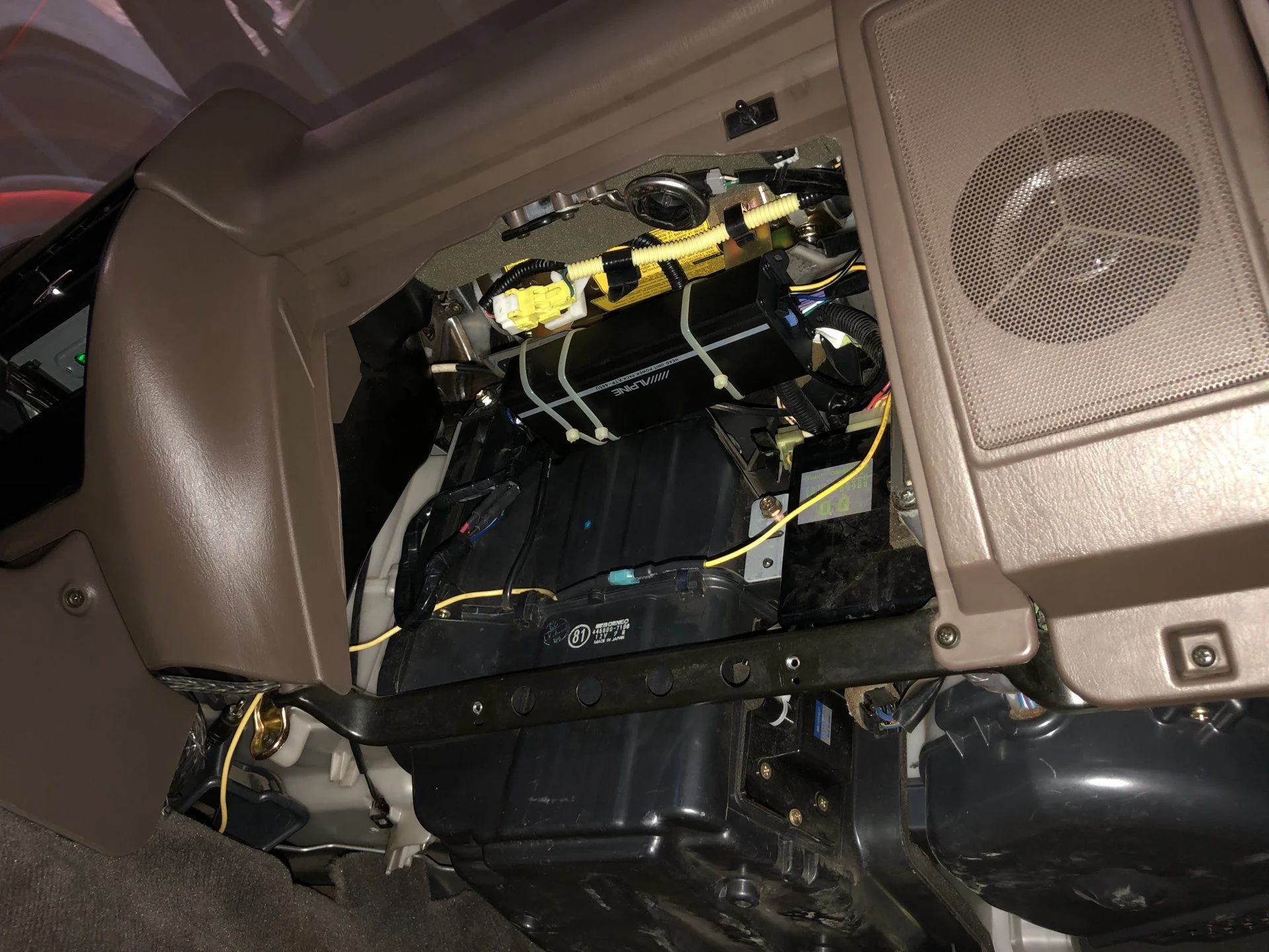

also relocated a small amp to the glove box. We will see how that works out.
Its worth it by far but you need to ditch the OEM everything.... door and dash speakers and craptory (factory) amp to get good sound...
After my car stereo hay-days in college, installing car stereos from alleys to dorm parking lots, I have to say this thing is def worth it. Especially if you go with an Alpine head unit. Literally plug and play.
