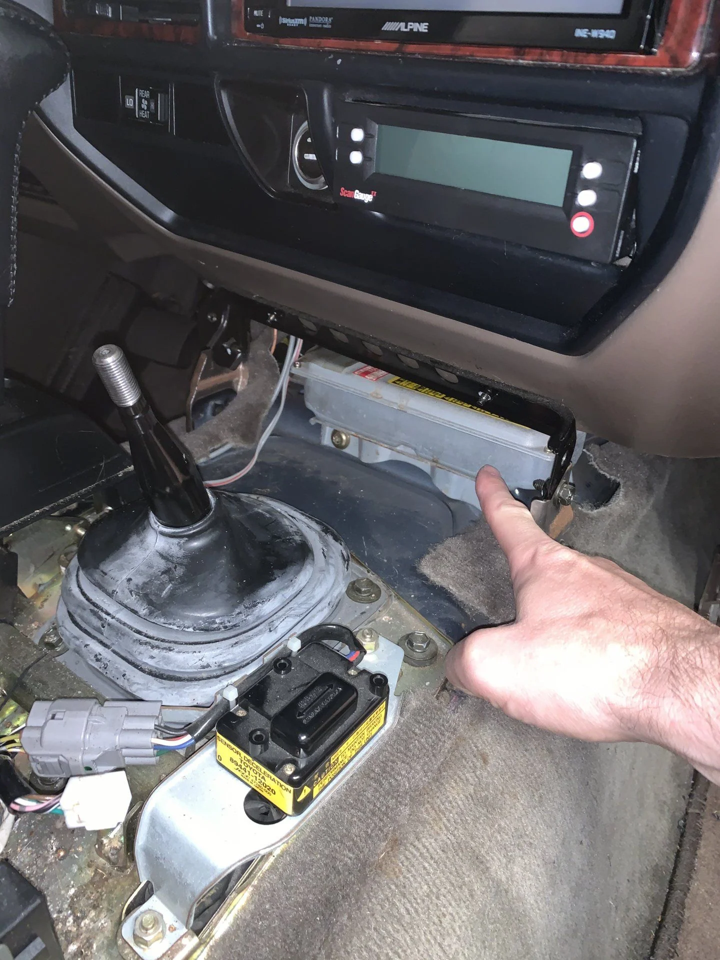

finally fixed my @#%ing airbag light. Ended up being the airbag control module behind the center console. For 95-97 cruisers part # 89170-60010. I gambled and bought a used one off eBay and it worked.

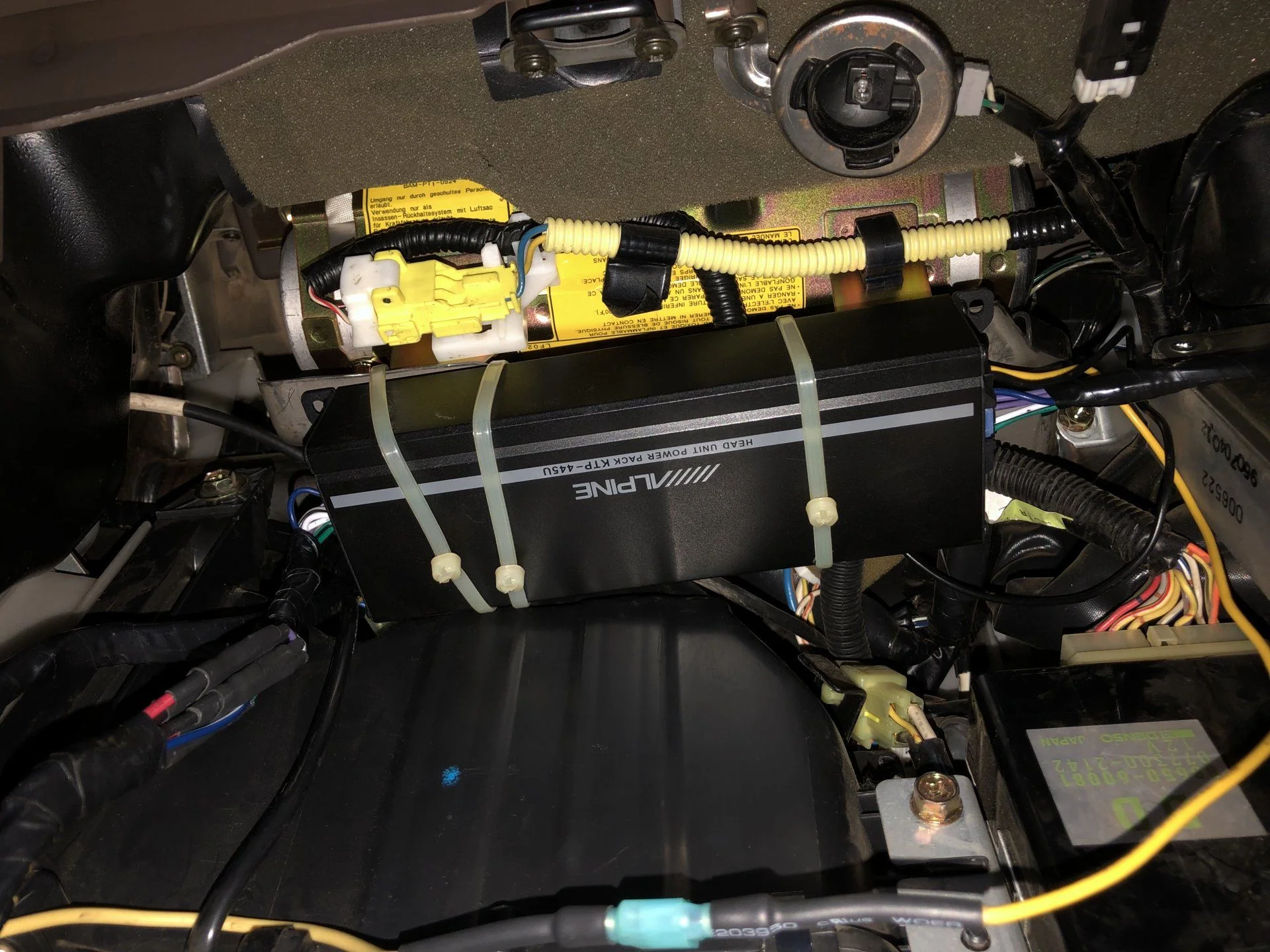

also relocated a small amp to the glove box. We will see how that works out.

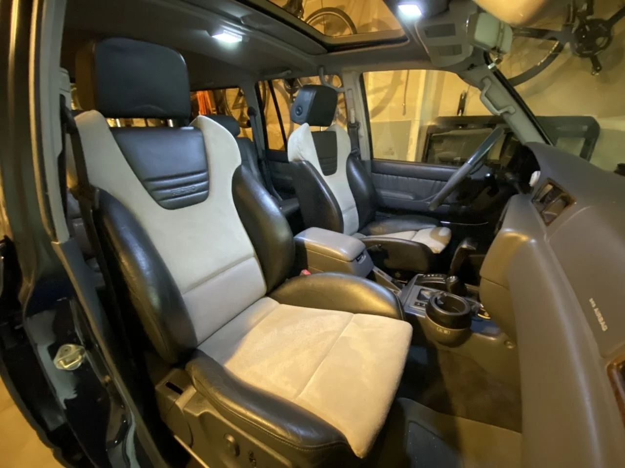

And finally fixed my seat leather! Wright up on that coming soon.
View attachment 2112896View attachment 2112897View attachment 2112898
I believe you can fit that amp behind the glove box with minor trimming... @woodsman 44 ?

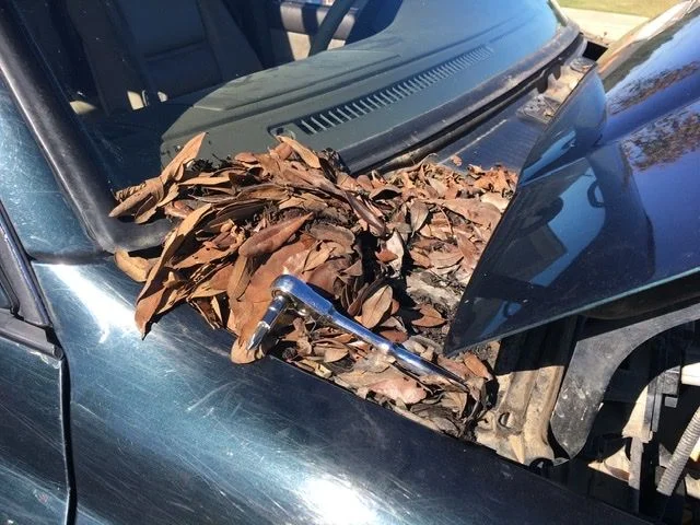

A JIS bit from @NLXTACY shimmed into a 1/4” socket makes easy work of the cowl screws. How in the heck did all those leaves wedge themselves in that tight?
Here's mine above/behind gloveBox....out of sight out of mind.... u have to trim glovebox to get it to close...

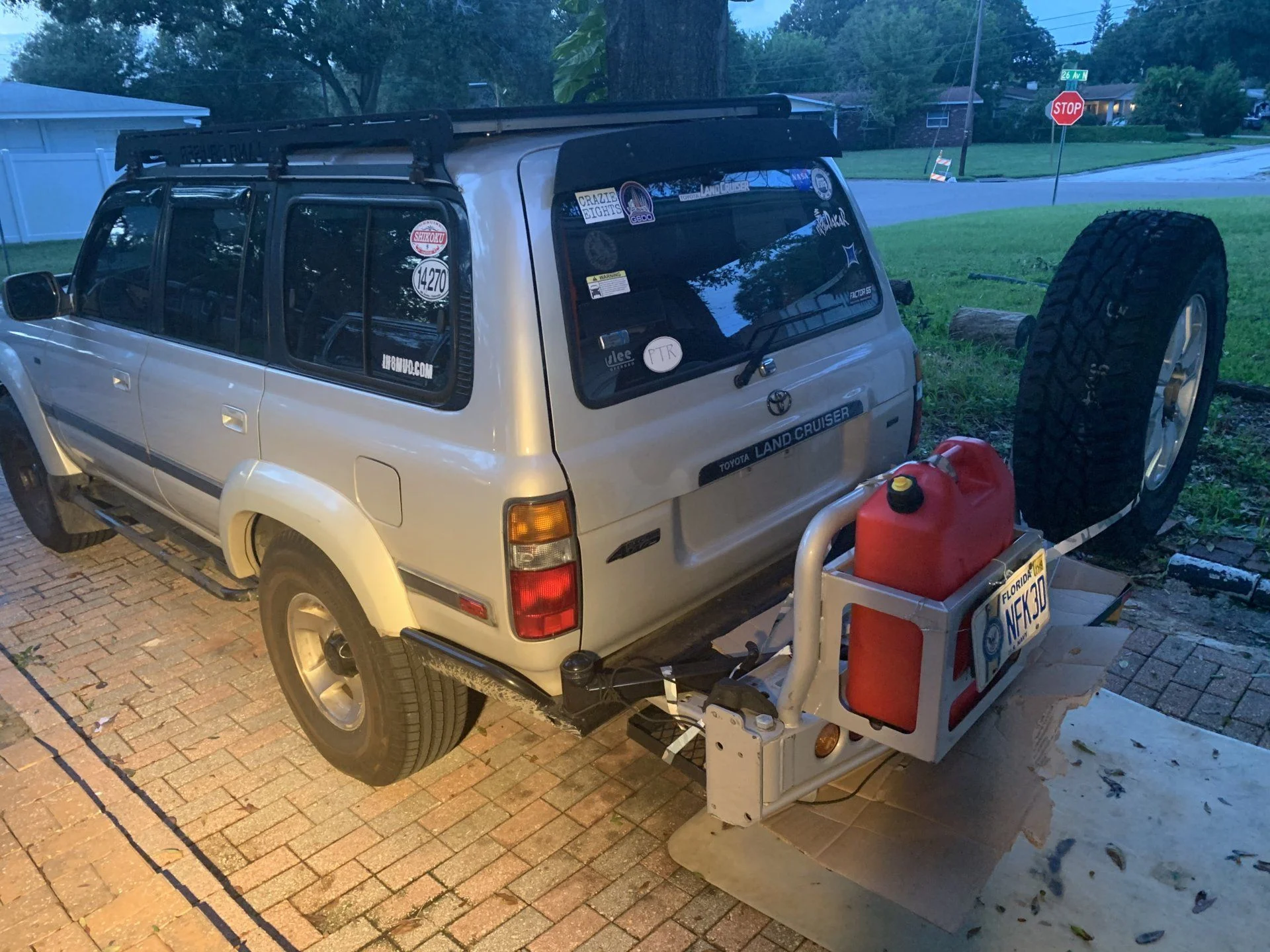

Im doing some drawing and measuring. I have a hairbrained idea about bolting an fj40 bumper on my 80.
My bumper guy Is not emailing me back, I can't afford a Slee, as beautiful as they are, and I'm currently rocking two black fence mounts with a burnt piece of wood 'Shou Sugi Ban' style, since it is Japanese. This is a great idea!!! I'd love to know what difficulties you had if you ever do it!
