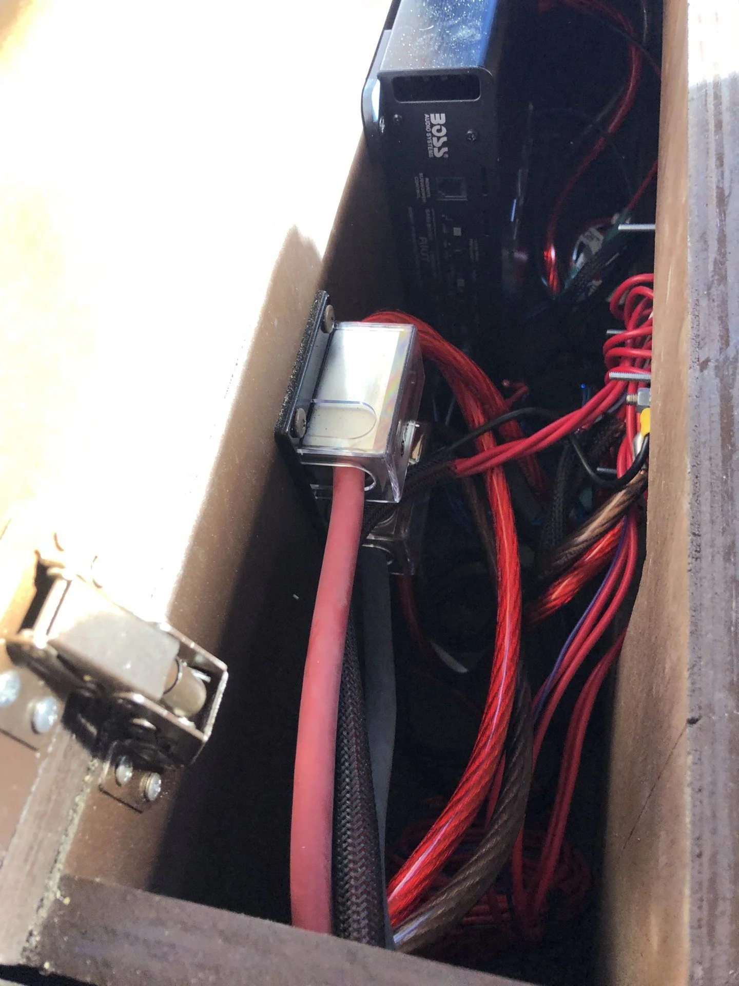

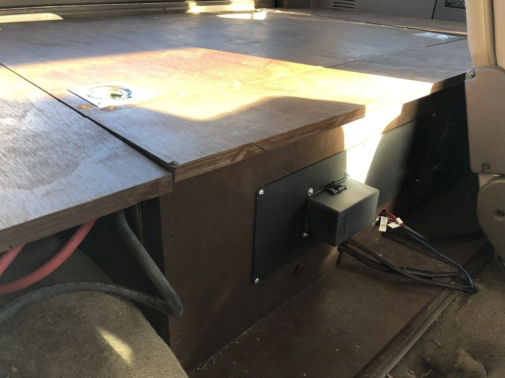

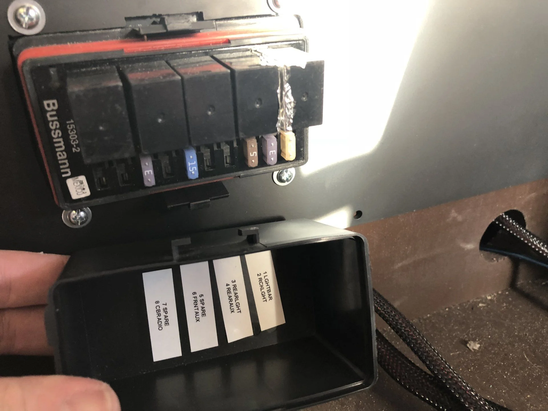

Second system fuse and relay box. This thing works great. I have plenty of spare fuses to tap into and 5 onboard relays.
What’s under the front lift board. Two power distribution blocks. One fire power off the second battery the other is grounded straight to the battery. Just gives me peace of mind that I have a good ground. The positive is protected at the battery by a huge 150 amp fuse.

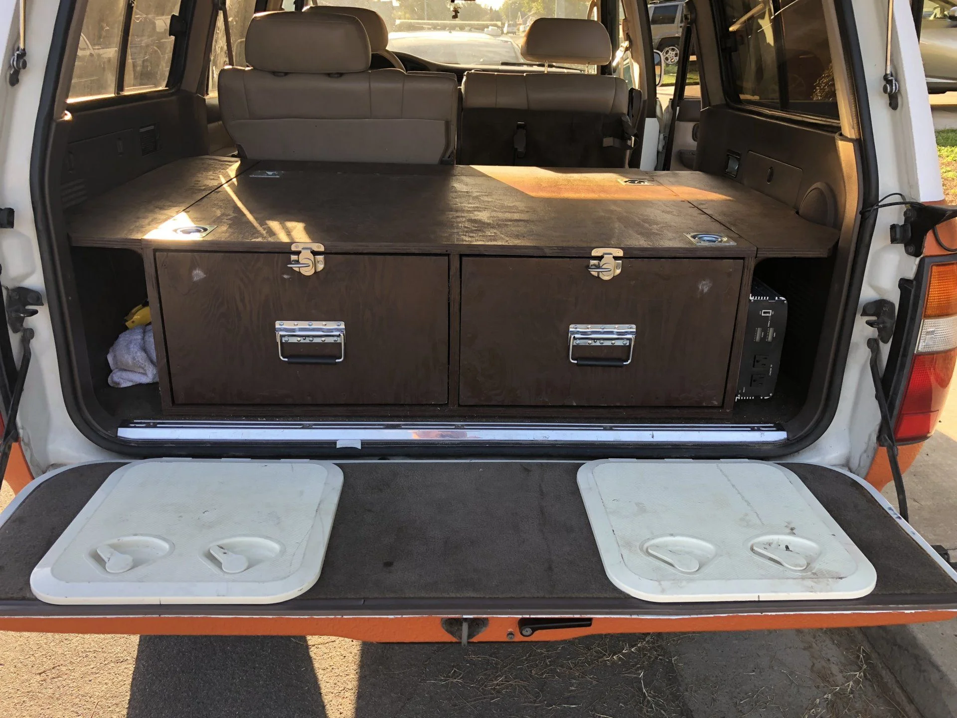

Both sides lift up if I need access under them and for removing/installing the drawers all together. I don’t have crazy expensive slides that lock so to prevent the drawers from opening I have some cheap window latches. Didn’t see a reason to make it more complicated than it needed to be. Before I added them the drawers would open up and bang on the tailgate every time I accelerated. The deck hatches are hopefully temporary until I decide the gate storage solutions are worth the money. Crazy expensive those things.

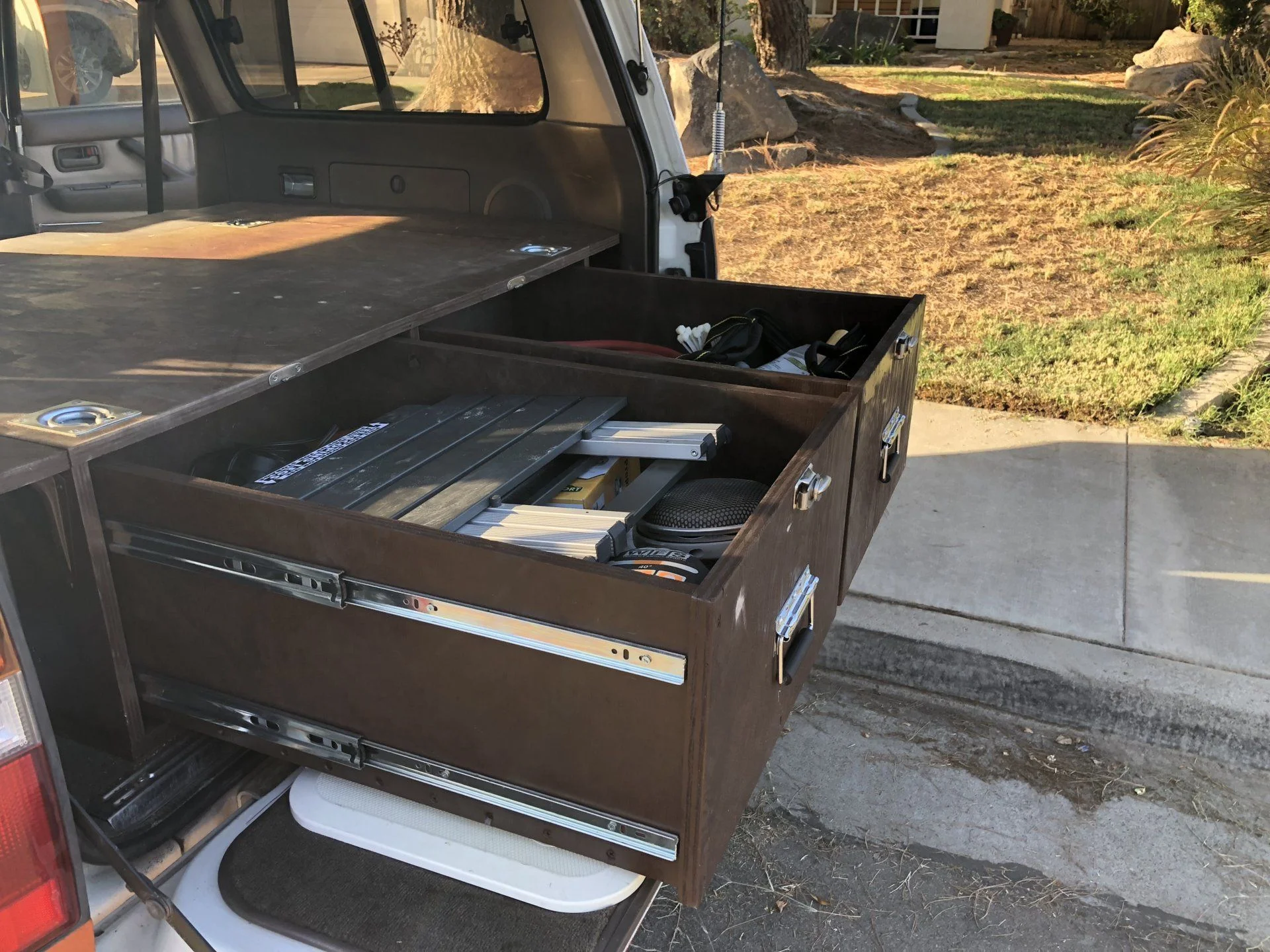

Doubled up on the slides in an effort to share the weight. They’re only rated to about 75 pounds each, but I don’t need to stand in these drawers so I couldn’t justify the price of the super heavy duty slides.
I’m going to get a small can of Monstaliner and roll the top and back as well as the inside of the drawers. Should hold up to any kind of abuse of throw at it. I can also set the second row seats up on a block and it’s flat and level for an airmatress. All totaled up I think I spent maybe $300 for all the wood and materials just to build the box, probably less.
The most important part is using quality wood. I tried to cheap out the first time and my wood warped and wouldn’t square up. Take your time and do it right.

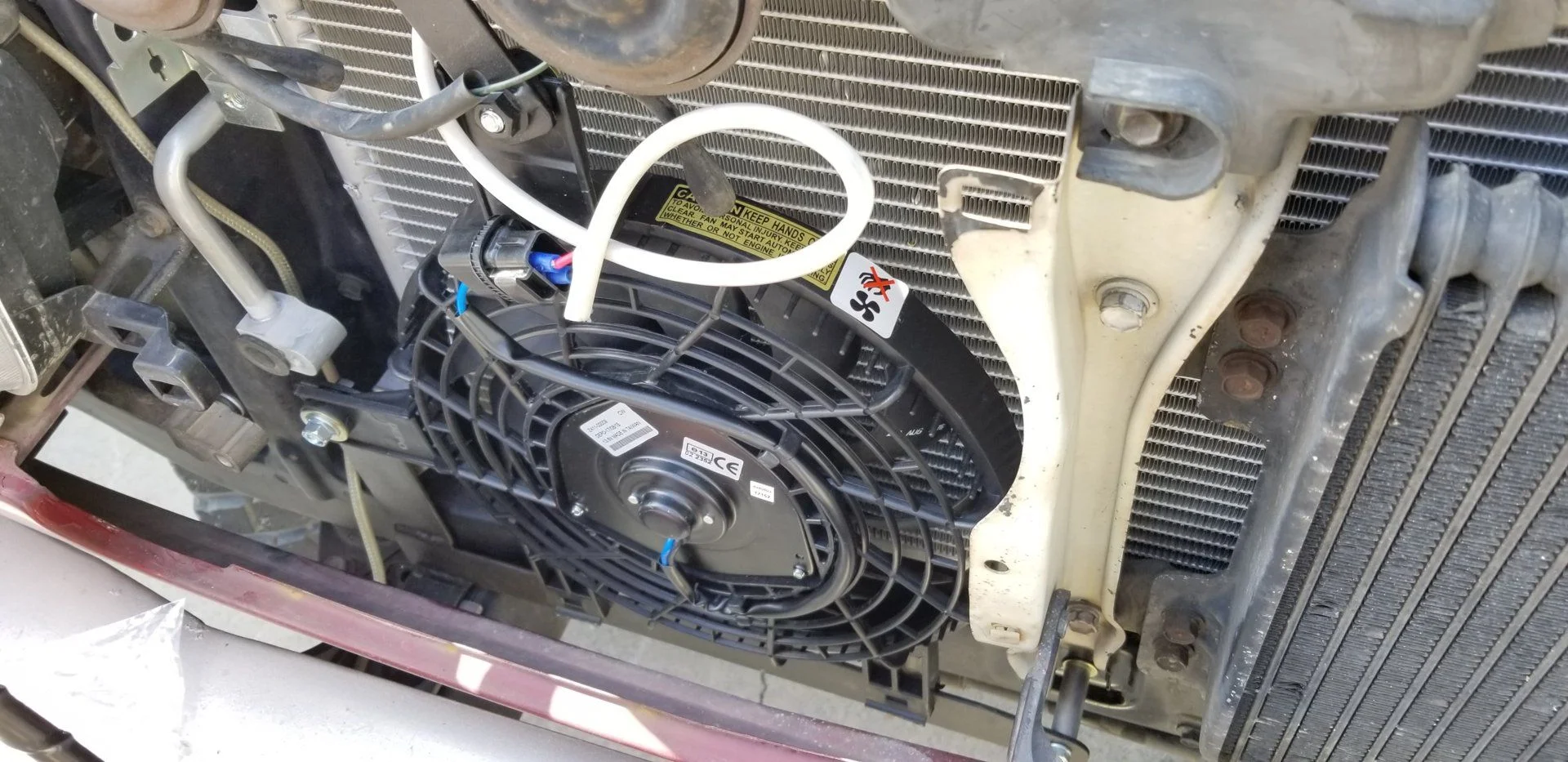

I see you're sporting the Nissens Parallel flow condenser. I love mine, made a huge difference.
Sweet, My A/C still doesn't work, I need one more fitting and I will have replaced all the lines that got messed up when my Sister In Law Wrecked it! Thats why you still see the rubber plug on the line.
I am glad to hear that it is performing good!

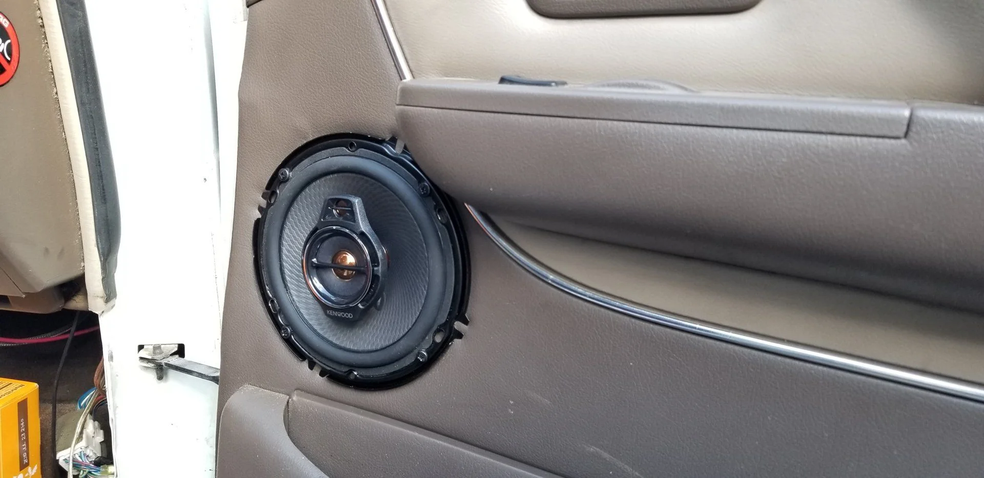

Replaced factory springs with OME 861/862; average lift was 1 3/4 inch. I know it will settle down a little, but those factory springs were saggy. Replaced all 4 shocks with KYB Gas a justs (rears were factory with 155k miles!). Fixed wiring issue on stereo from PO.

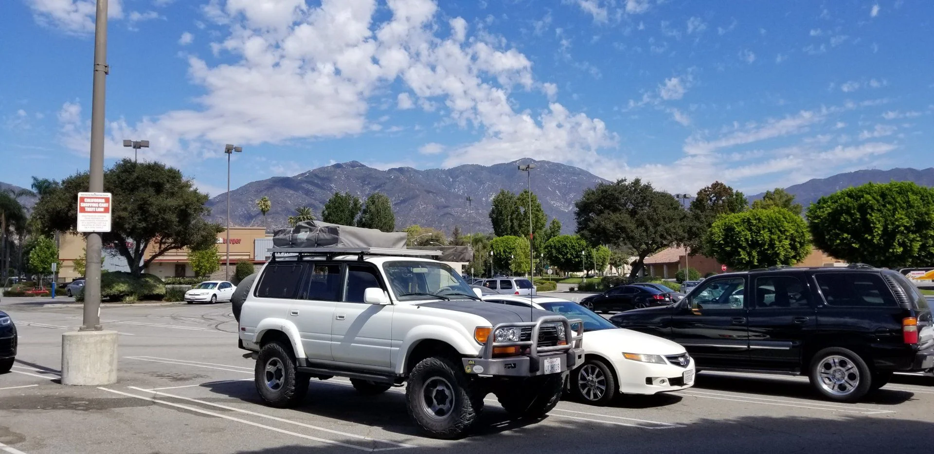

I am very happy with my Bowfin Cruisers rack and highly recommend it.!
It is one of the few aftermarket products I've added to the truck that works and fits flawlessly right out of the box, the first time, with no further adjustments needed. I have hauled lumber, mounted an RTT, nestled a solar panel between the rails, and it just sits up there and works the way it is supposed to. There is plenty of adjustability in spacing the rails for your own custom needs, and nearly an unlimited assortment of tie-downs/anchor points are available to fit the 80/20 extruded rails.
My rack has been on for about 20K miles, and about a year, and still looks new.
Can you tell I love it :D?...
hey thanks man for the mini review. that seems to be the concensus on these racks. and no wind noise whatever I take it when it's unloaded?

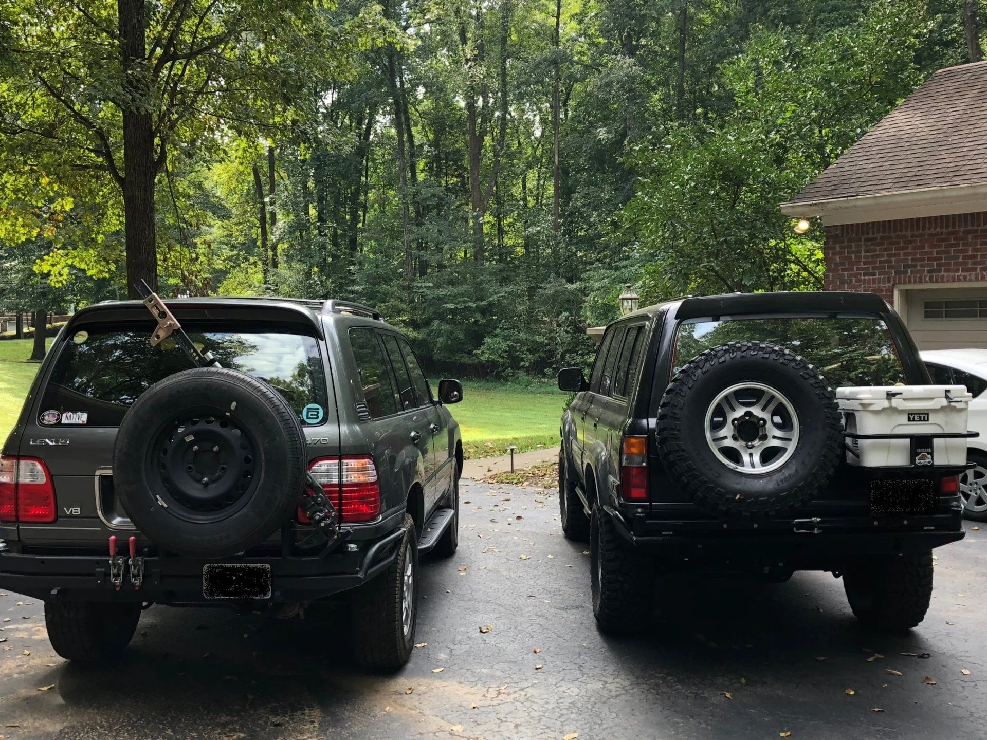

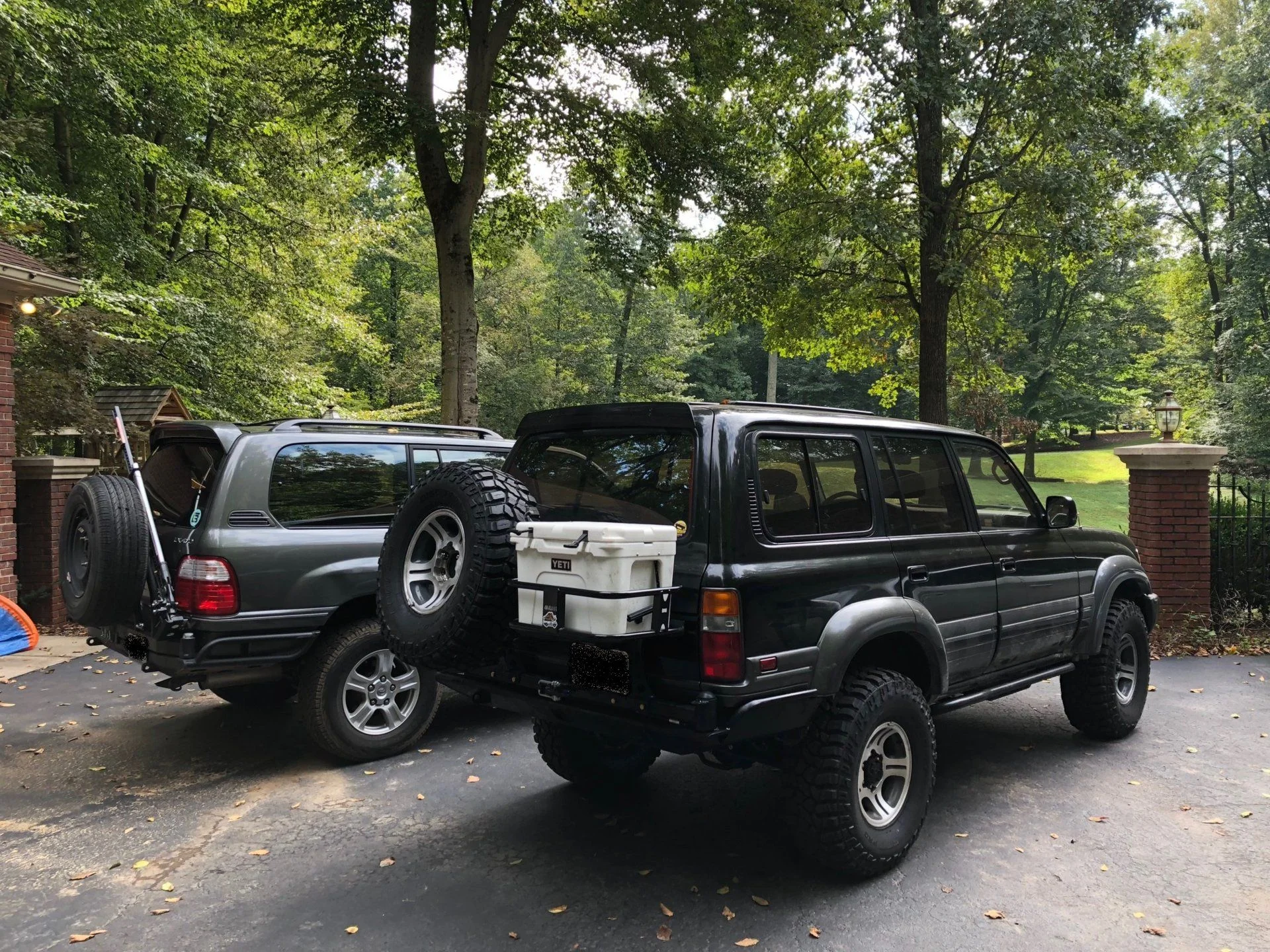

I was finally able to install the 4X4Labs rear bumper with dual swing out on my 80. I love the way it turned out and it helped to settle my rear lift down about an 1", so Hub to Fender is now 24" in the rear.
The dual swing out is tire and 3-gas can holder. Bonus, I can fit the Yeti Tundra 45 in with ease!!!
Here is my 80 with WKOR sliders and Labs rear bumper next to my 100 LX with BIOR high-clearance rear bumper and sliders.
No. No appreciable wind noise with the Bowfin Cruisers rack. I run with my sunroof open most of the time and it is as quiet, if not quieter, than before the rack.
