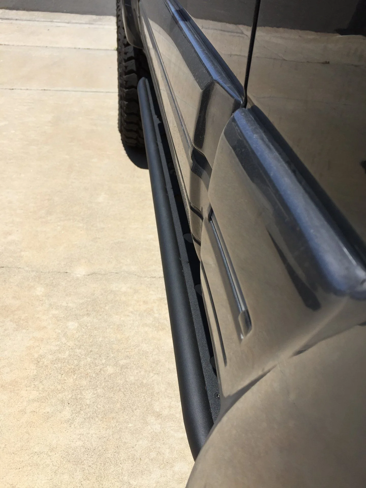

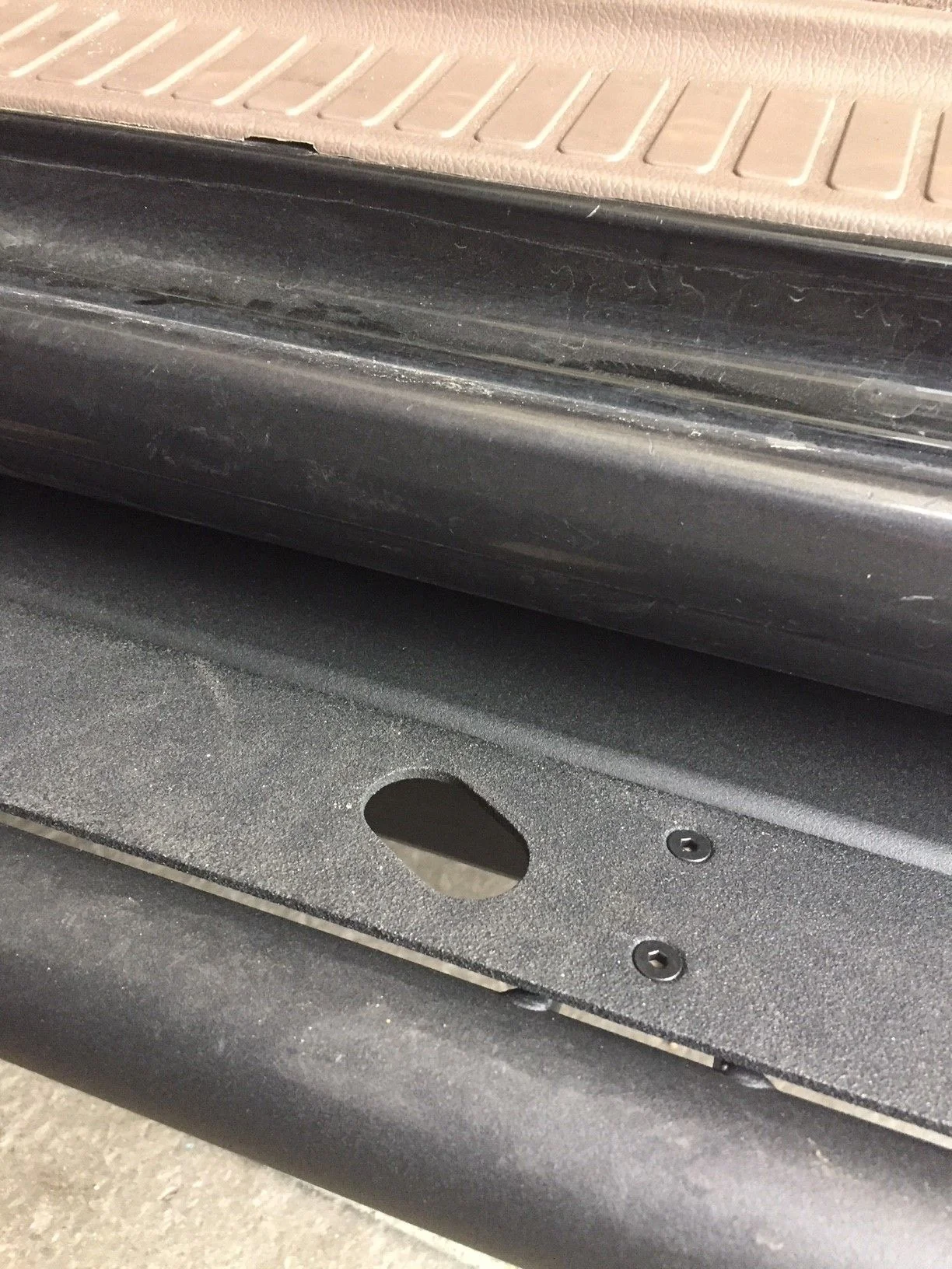

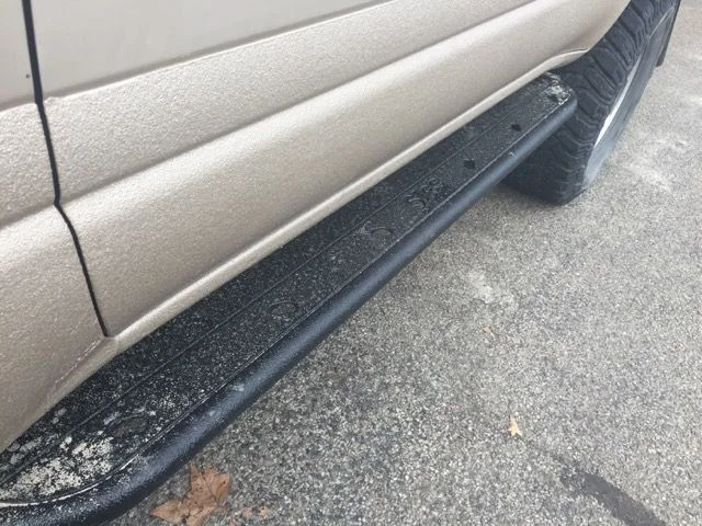

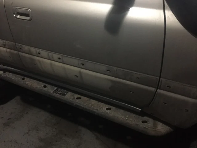

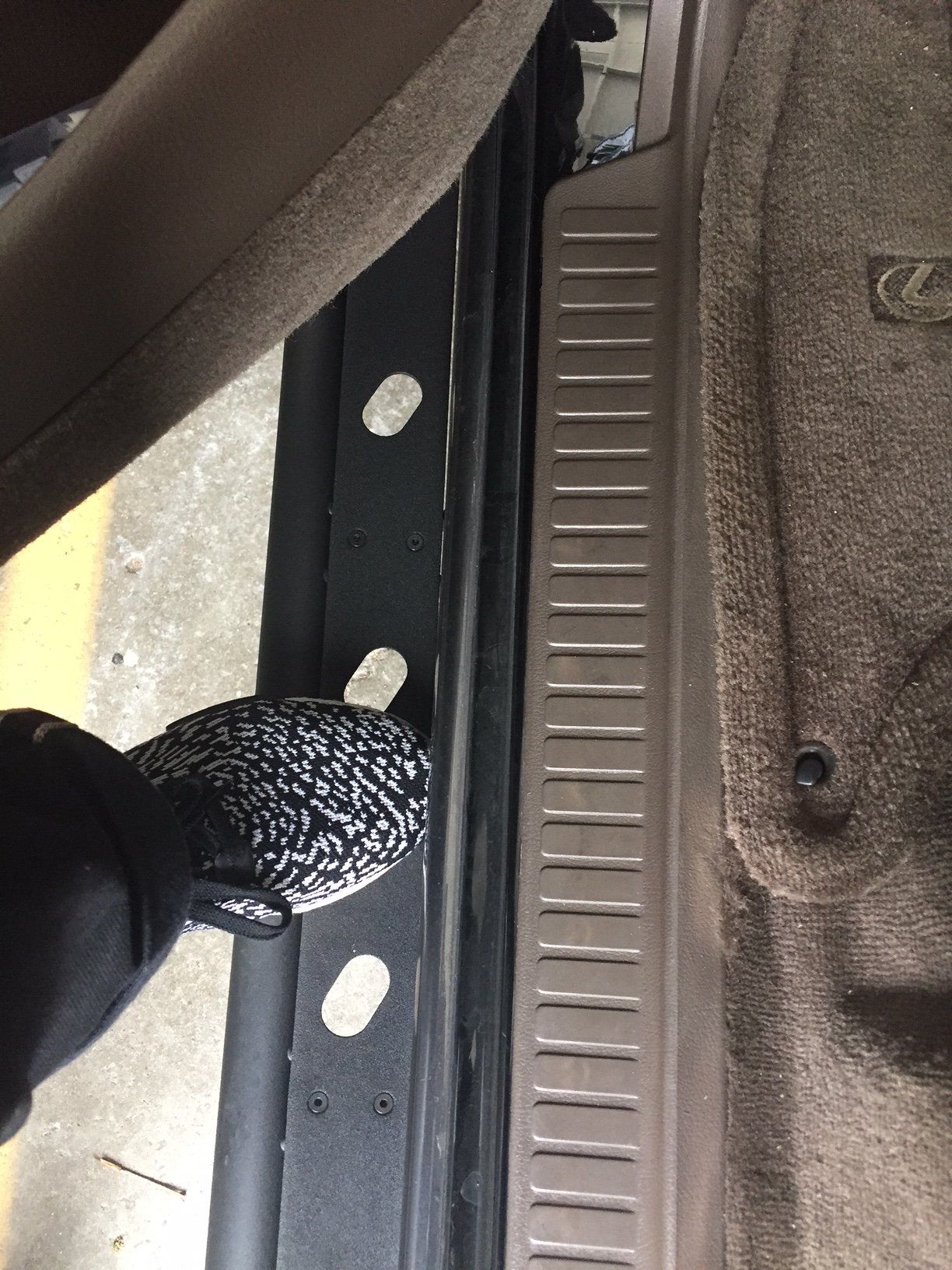

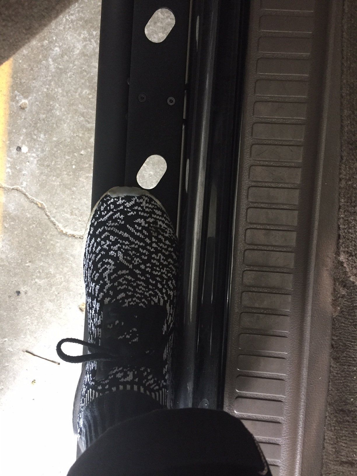

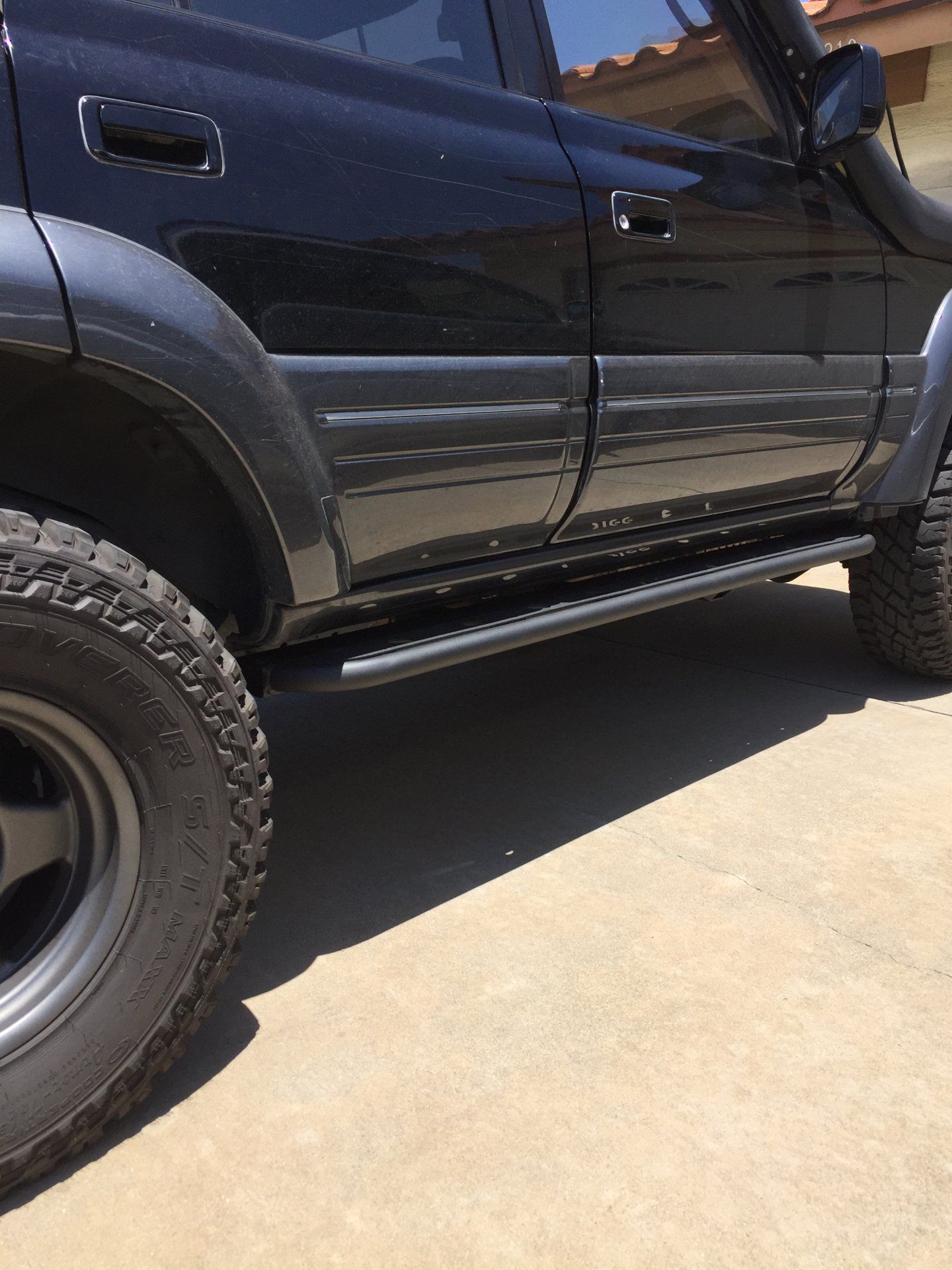

Slee steps seem to have enough room to take the place of a running board with or without the body cladding in my opinion. I've had them set up both ways. I have a very early pair and the powder coat didn't hold up as well over the years but I bet that's been rectified over the years.

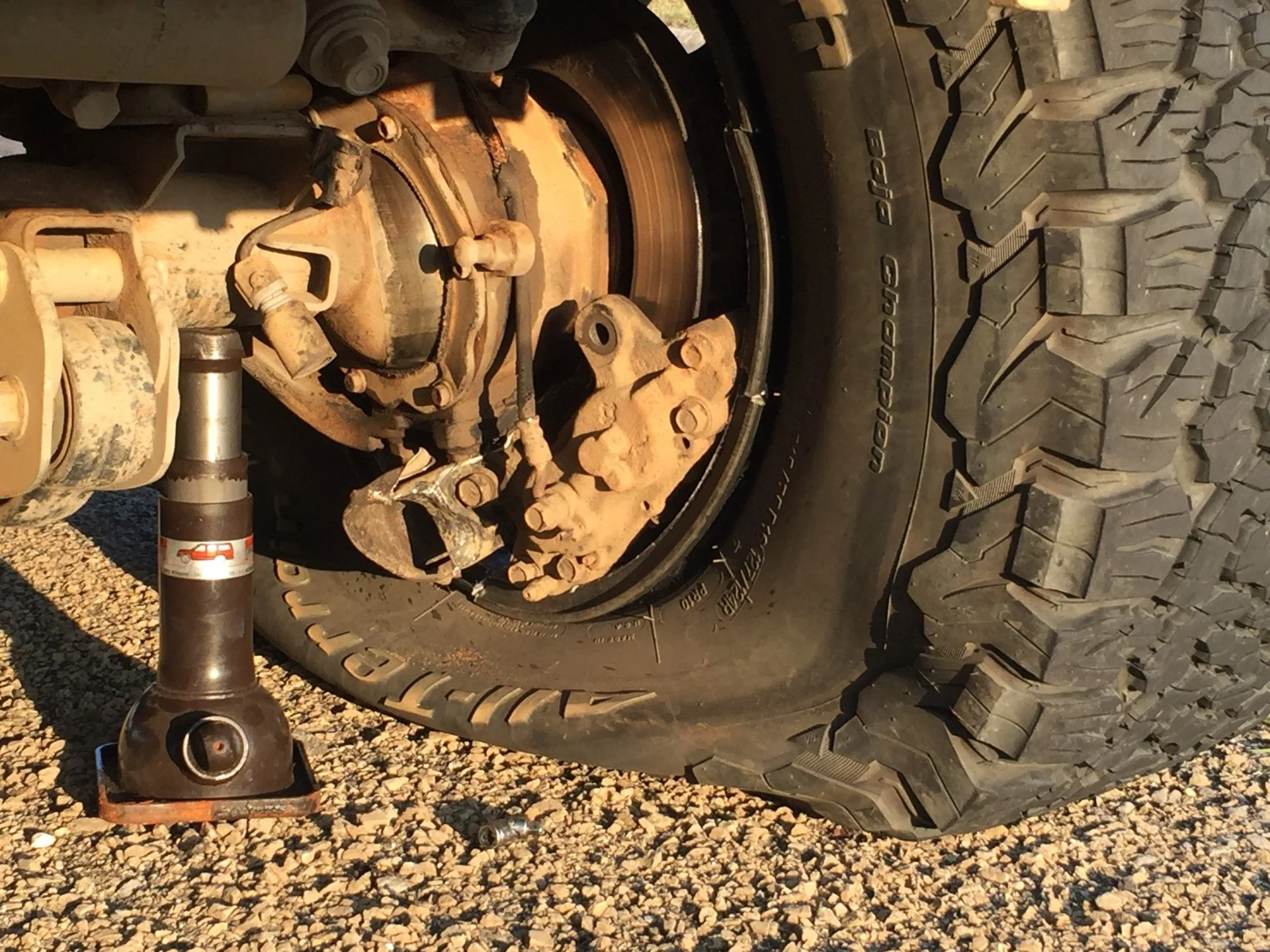

Oh and 85 miles from home, Will and I were both exiting i40 for some gas when crap hit the fan. I was on the phone and saw Will's cruiser nearly roll while he was fighting all sorts of drifting and whipping around at the start of the off ramp while I coasted down.

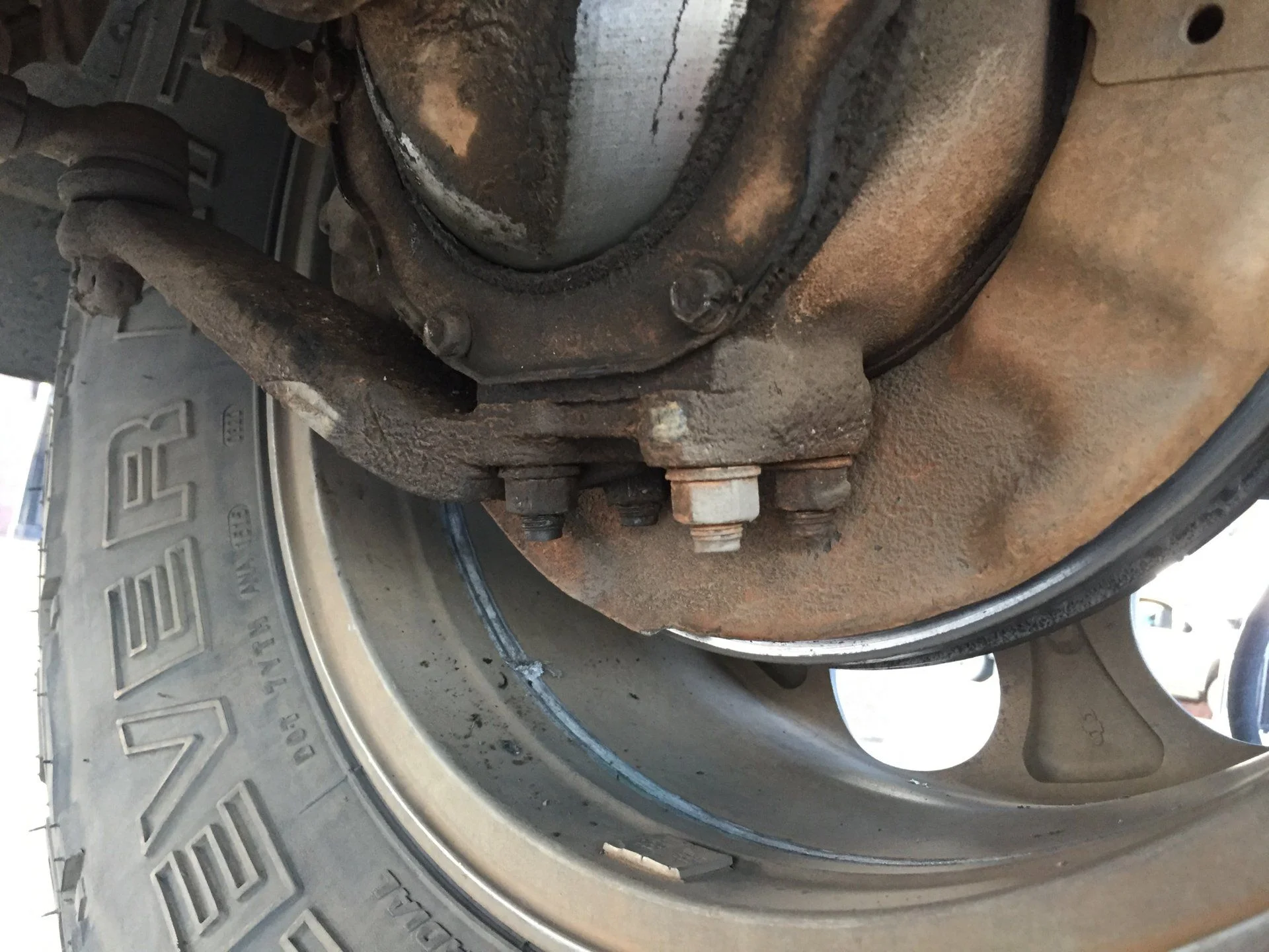

As I applied my brakes to slow down and stop I started getting a horrendous shake which I thought was either a loose caliper or cracked and lodged piece of brake pad. I creeped it into the gas station and found that one of my front caliper bolts was gone and the top one was finger tight. While I found out that that was the issue, Will had walked down from the top of the off ramp to tell me what had happened to his cruiser.
He had a flat tire, shattered one of his new SCS F5s and had a nearly severed brake line and other damage. His caliper came loose and did a full 180 until being wrapped up by the dust shield thus locking up his wheel and shattering it in the process.
It was a long evening, but luckily everyone was okay. Super weird and the fact that it happened at the same time is very strange and makes me want to think we were somehow sabotaged by some side by side people as there were only a couple instances towards the end of the trip while we were out in the woods that I wasn't keeping an eye on my cruiser. It doesn't make sense why someone would do that, but it doesn't make sense how two separate Cruisers who have had brake work done independently from each other and at different times would have lost the exact same lower brake bolts on the driver's front caliper at pretty much the same time.
Mine after scavenging a brake bolt off Will's cruiser and putting the caliper back on.

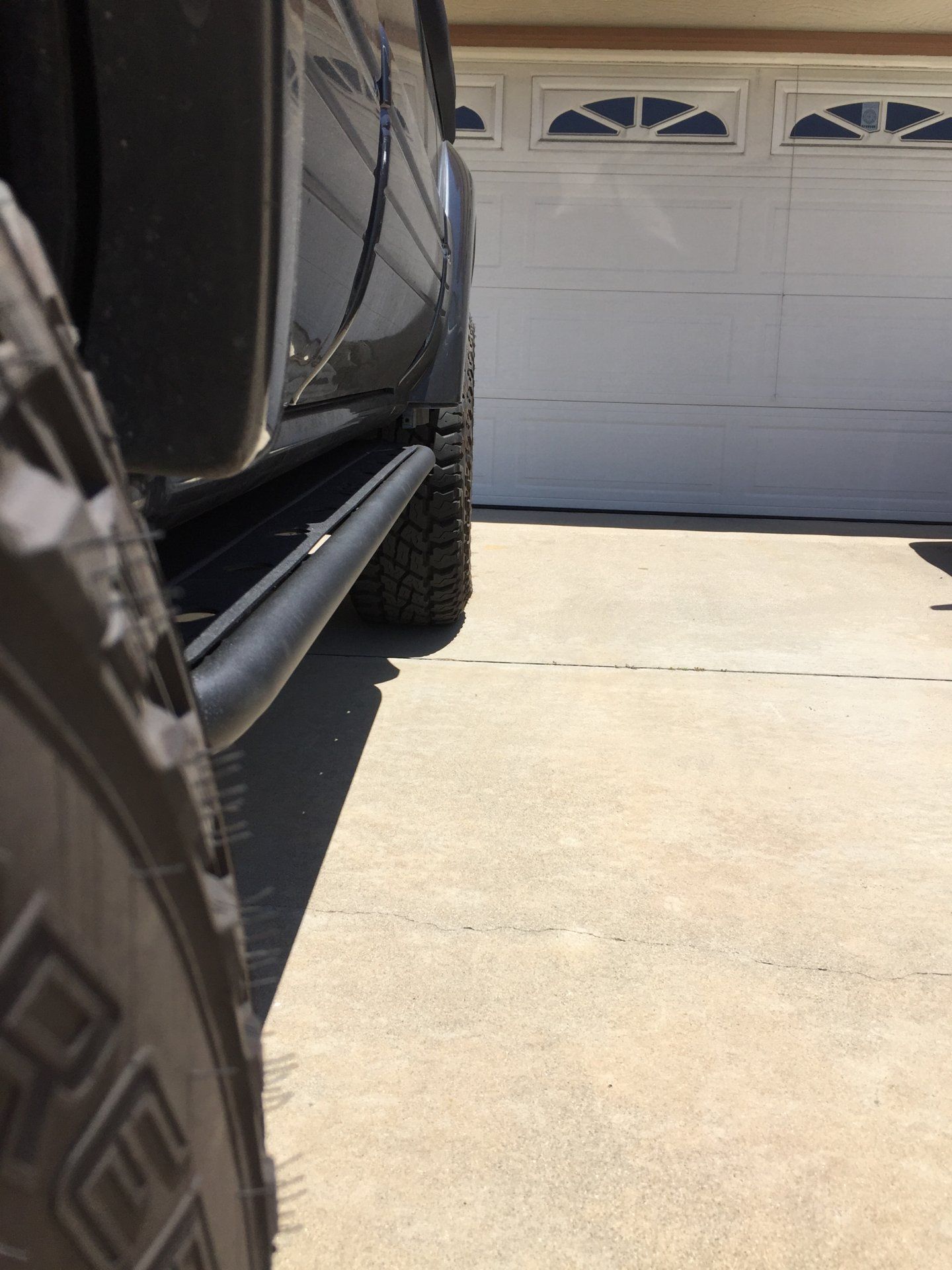

I have the same ones on my own 80 and there's plenty of room to get in and out even with my size 13 clodhoppers!
And I’ve been looking for a pair of the same for my 60 series for years

Yeah seriously glad we all made it out considering how much worse it could have been. I just keep thinking that the last and only place I think it could have been tampered with was where there was like 30 minutes left of trail. Mostly cruising around in low and not needing too much braking. Then a short drive to the gas station and then to i40. We had been cruising for several hours and were making great time until we both used the brakes...
Just doesn't make sense as there wasn't any sort of confrontation between our group and the couple of the side by sides. Just where my mind keeps wandering since it doesn't make sense. I always tighten my brake bolts and then hit the breaker bar or wrench with a mallet several times to really lock them down.

FYI your bumper bolts will work for your calipers

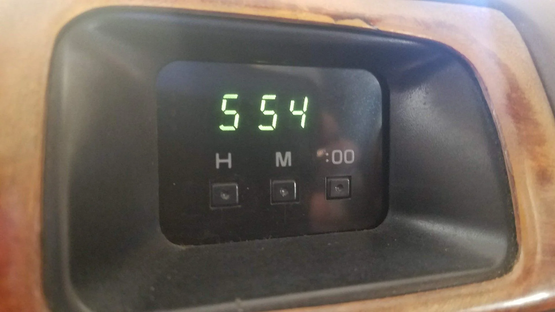

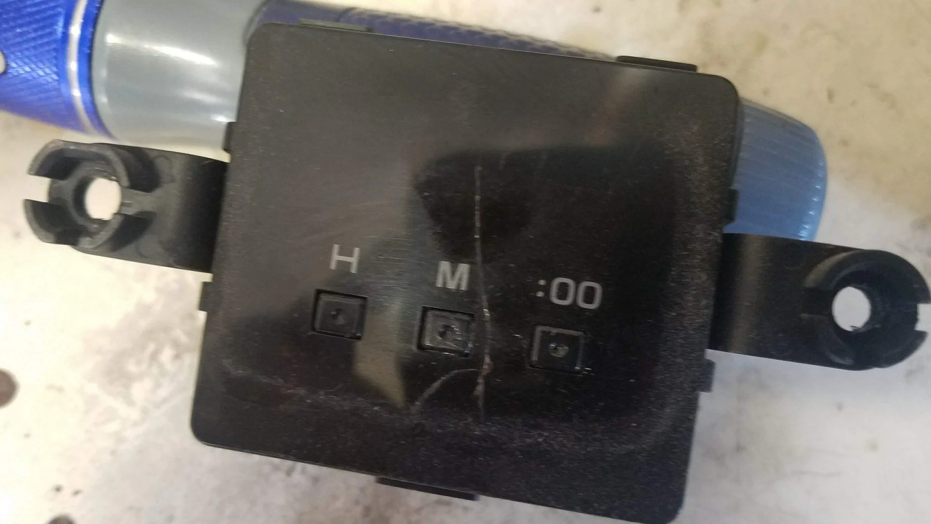

To continue the smallest and cheapest, and frustratingly overdue, and to mention SIMPLE...yet exceedingly gratifying accomplishments, replaced my cracked clock! Now why the heck did that take me 5 years to do?! Another head scratcher. I'll take Door #1 for a New 80! Third time in the last couple of weeks it got new again. Thanks to @05Tacorunner (not DOA!!)
