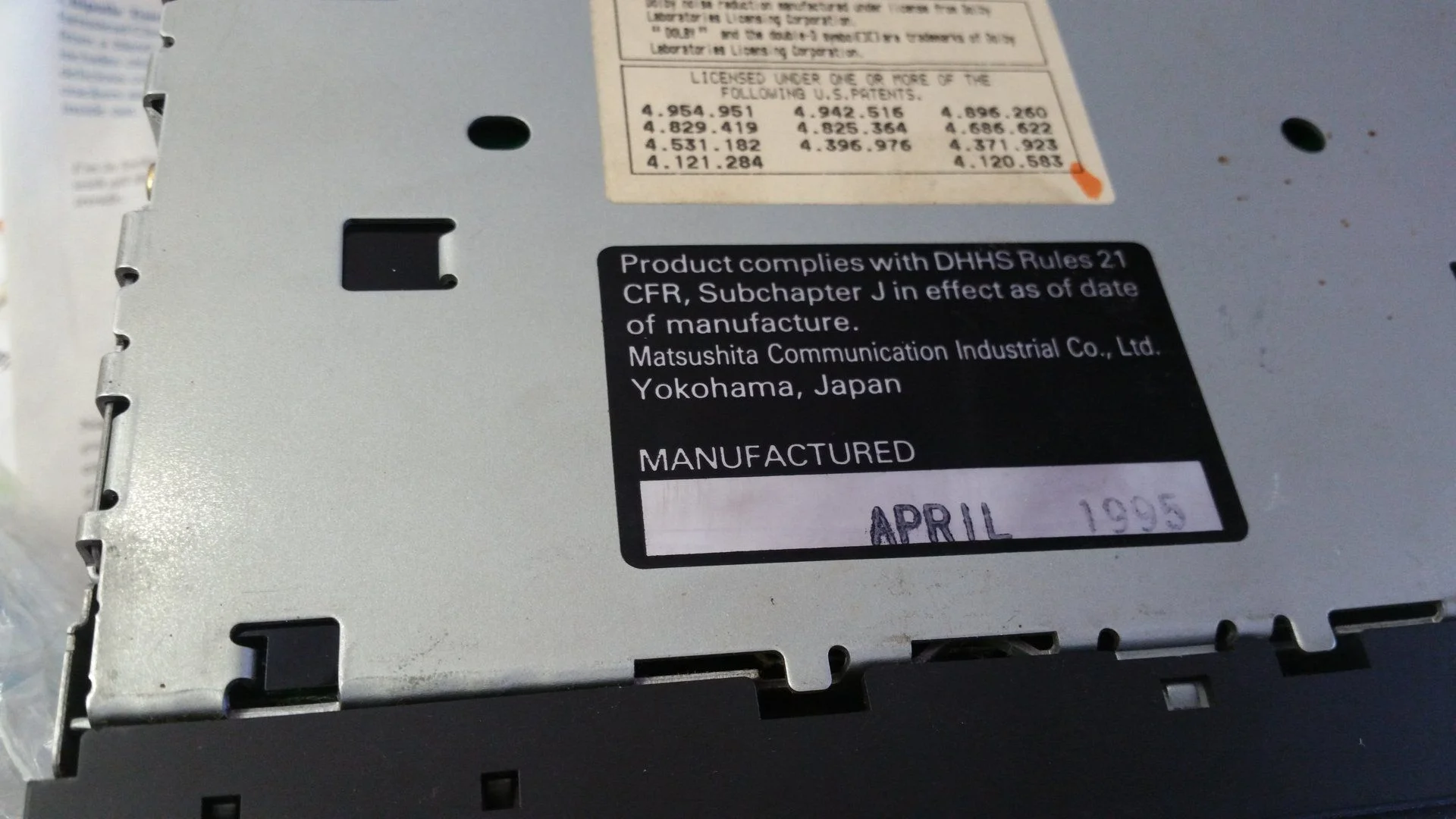

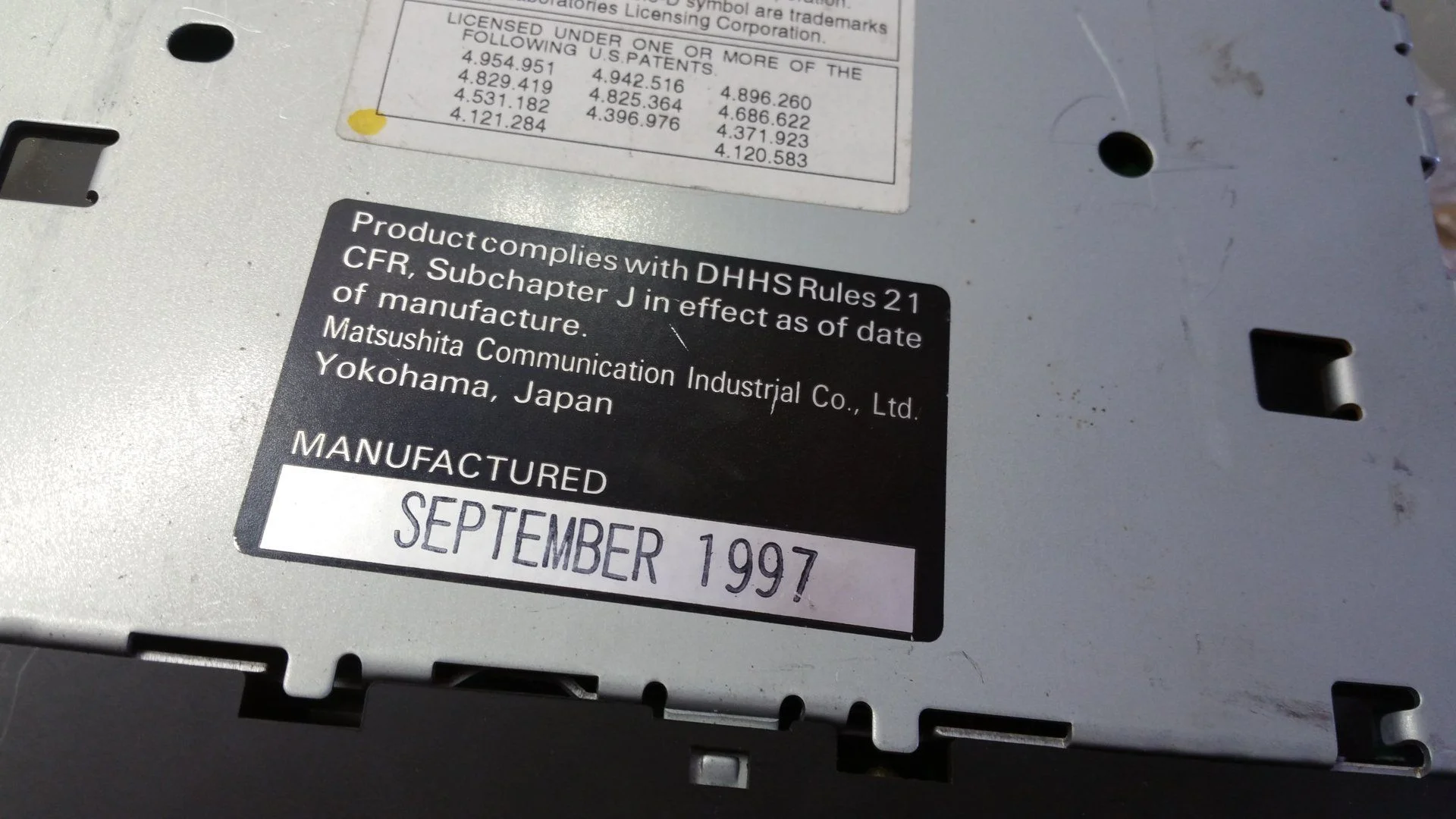

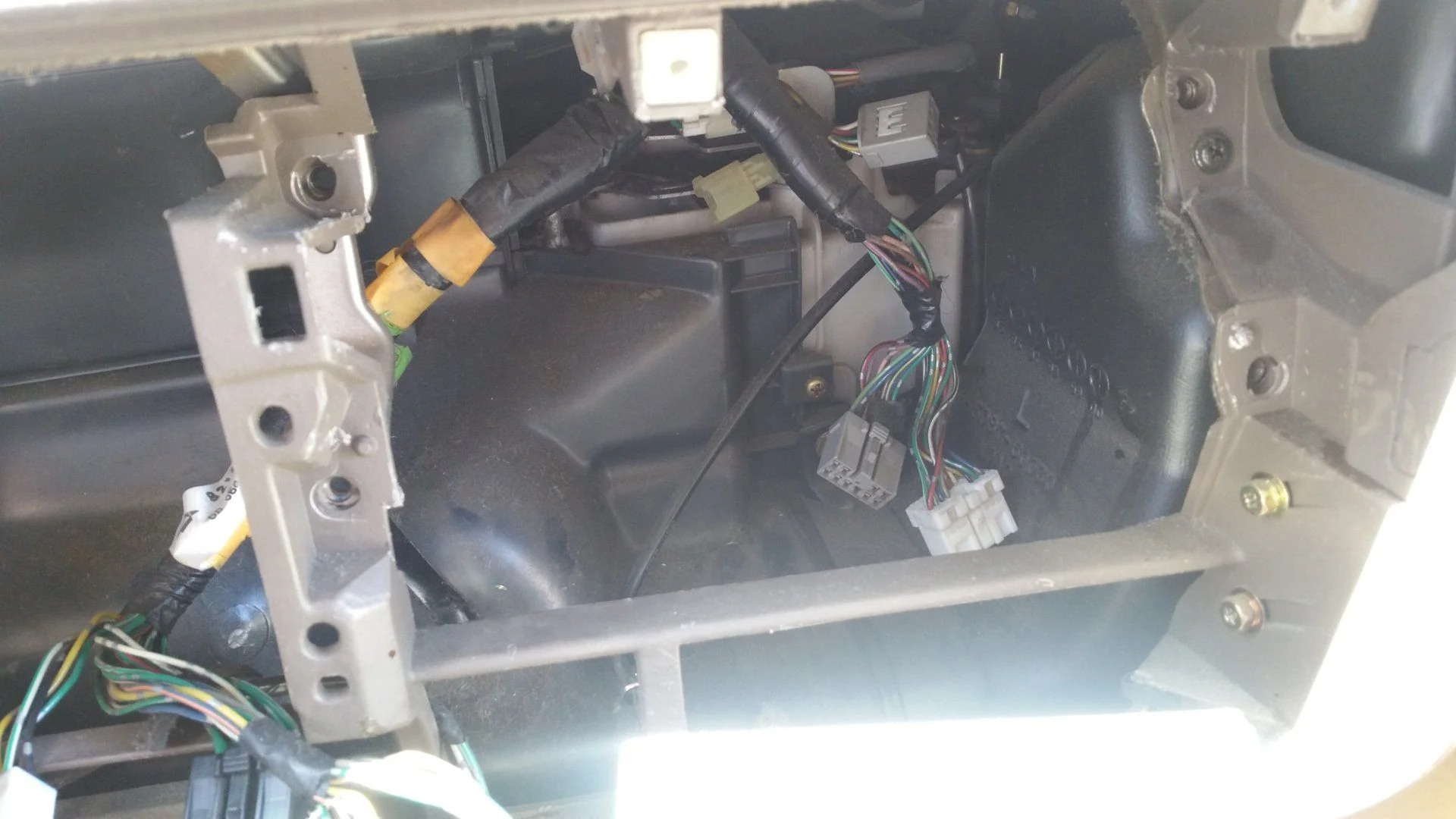

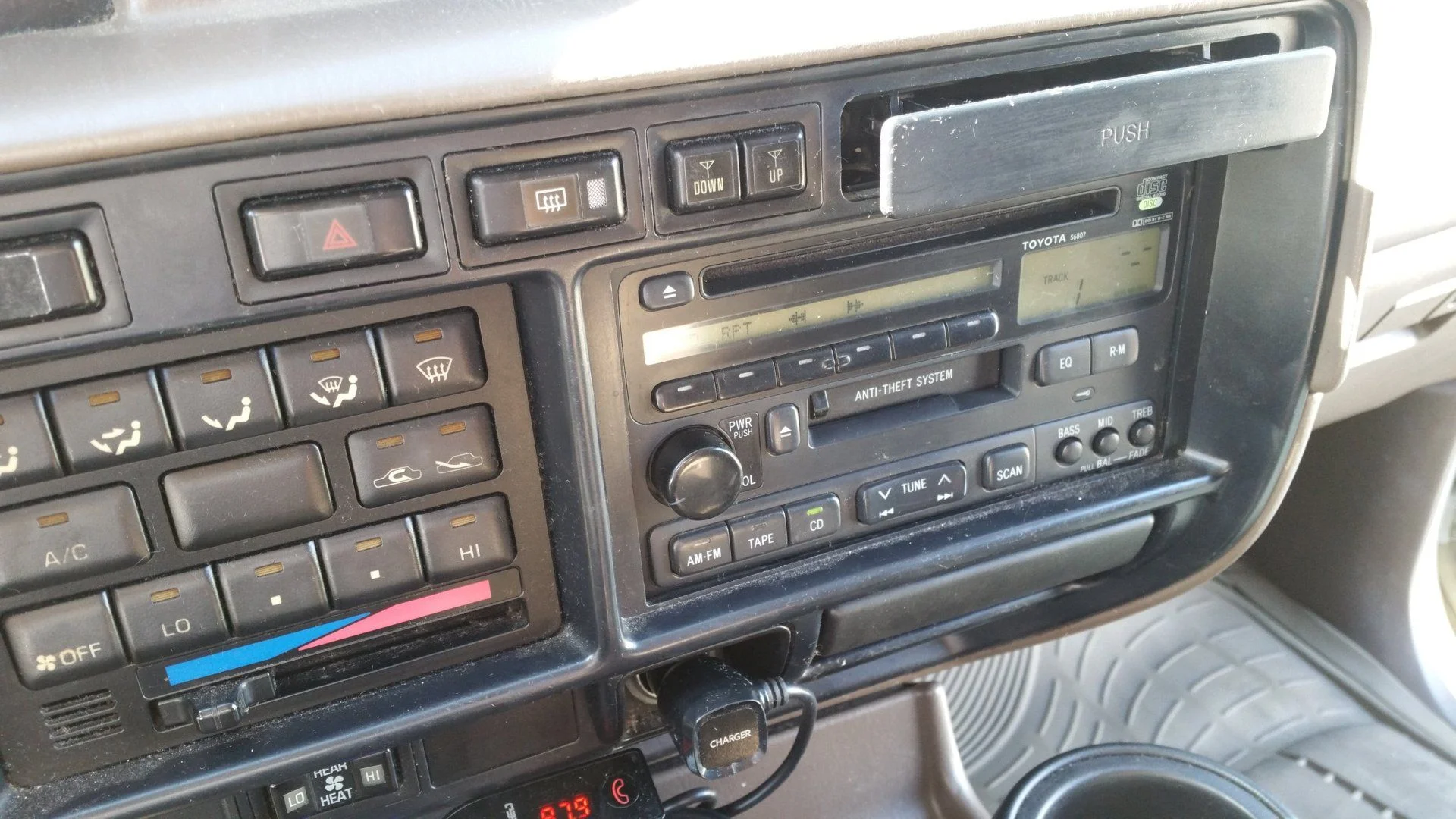

Project Toystory begins. As a newb, I got to start somewhere so why not the easy ones. With leftover parts from the prior owner, I replaced the original 1995 radio with an OEM of 1997 vintage. Replaced the burnt out bulb in the antenna switch and installed the OEM cup holder.
If anyone can answer, in the last pic what is the gray connector for? Did I miss something? Thanks.

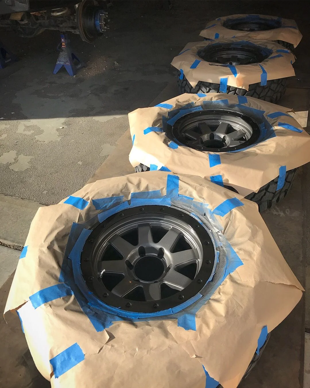

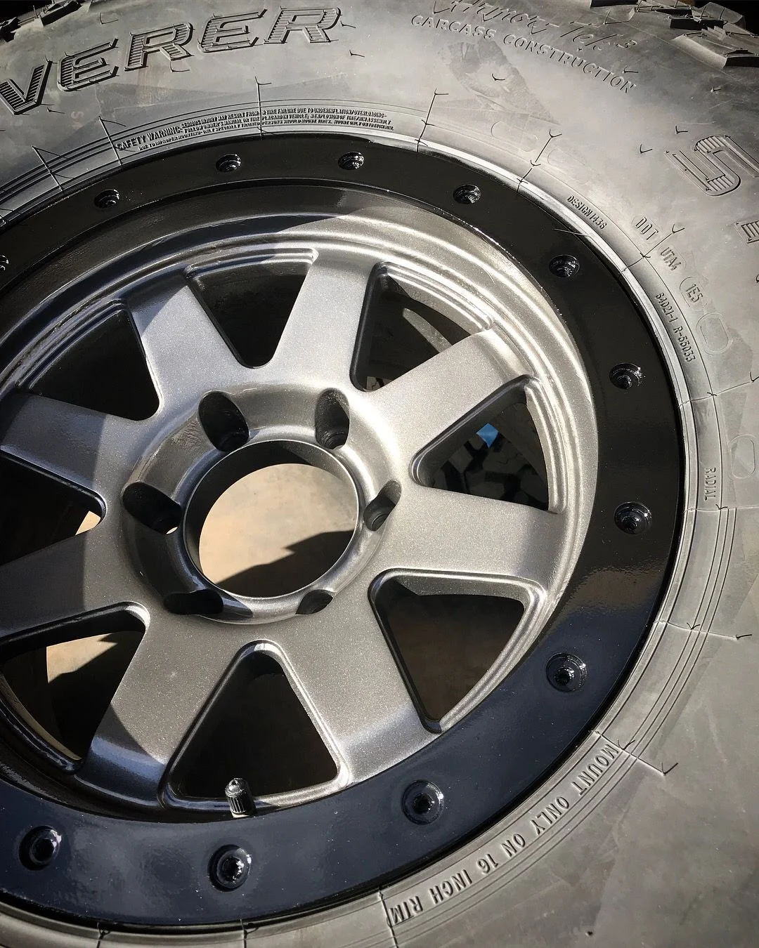

annual ritual taken care of this week. Sure would be easier if I didn't try to keep my truck pretending to not be a complete pile. But each winter I end up trying to clean up my wheels from a years worth of rock rash. They were looking pretty rough again so I sanded them down to bare aluminum and resprayed them. They've been all black, but I was itching for a change. Used VHT wheel paint (The VHT paint has given the best results from my experience). Tried Duplicolor - hated it. Plastidip sucks on wheels. Rustoleum is decent. VHT has been the best IMO. I used Graphite color for the centers and Satin Black for the rock rings and hit the whole thing with a few coats of clear.
Nice change from the black.

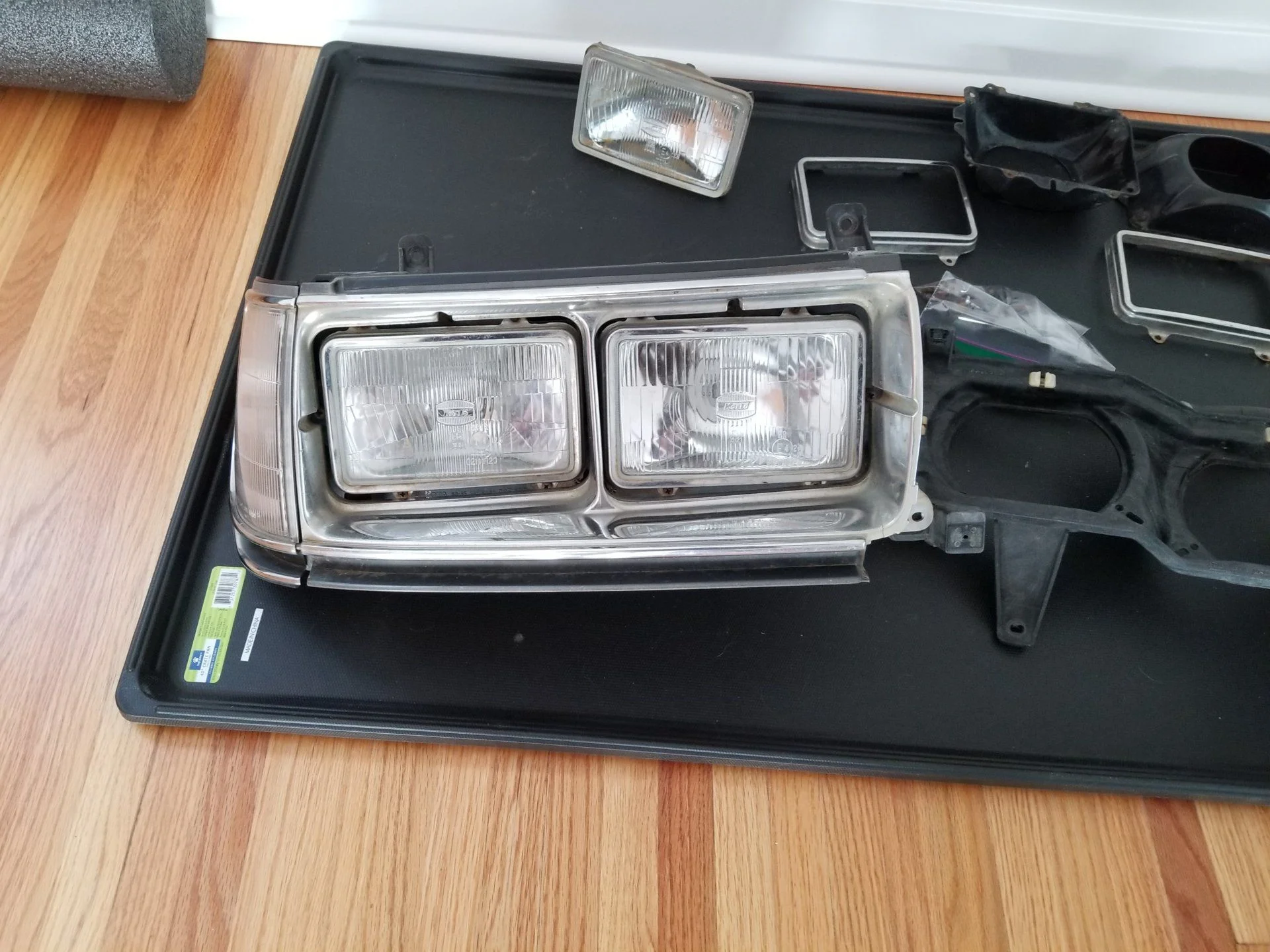

where did you source the headlight buckets, trim and housings? Cost?

That grey connector is the one you'll use when you replace that stereo with a decent aftermarket one.

Thanks! That gray one threw me off like having extra screws left after assembling something.
No aftermarket for me. I will pretty much will keep the interior as stock as possible and limit drilling holes. :)

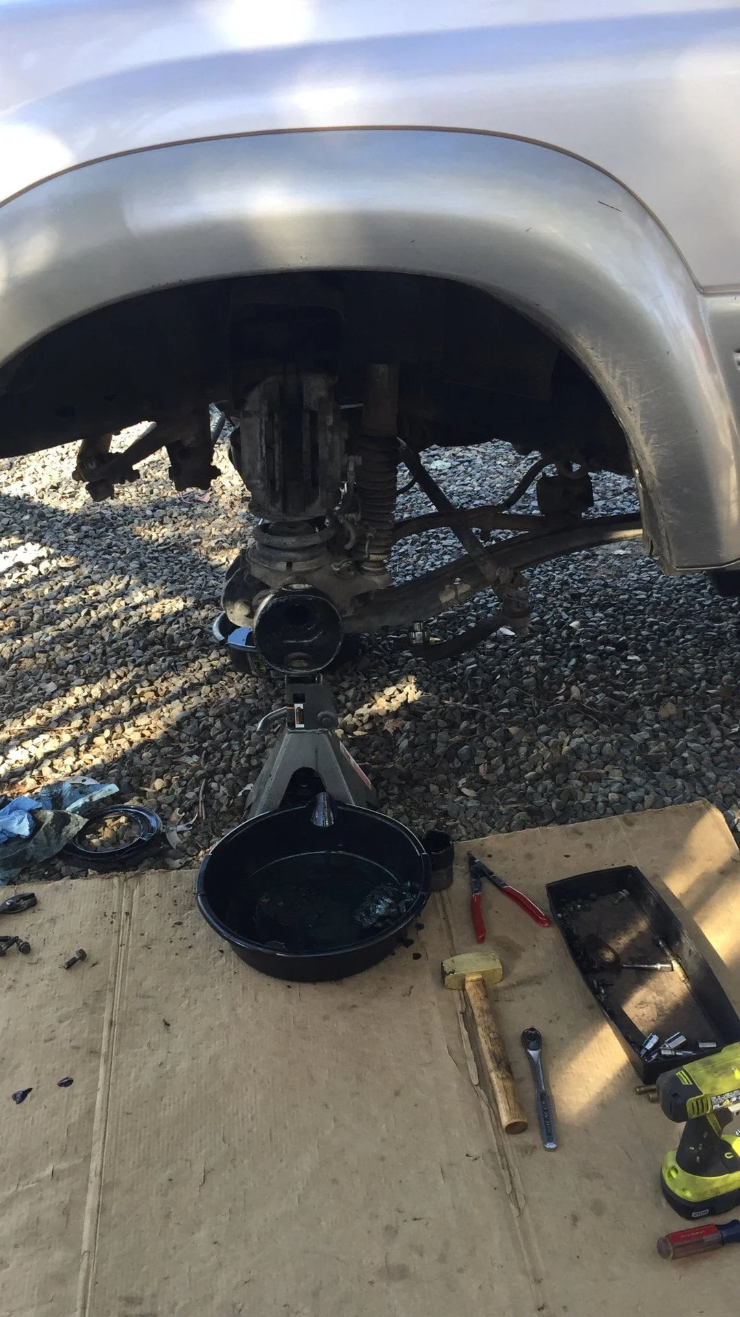

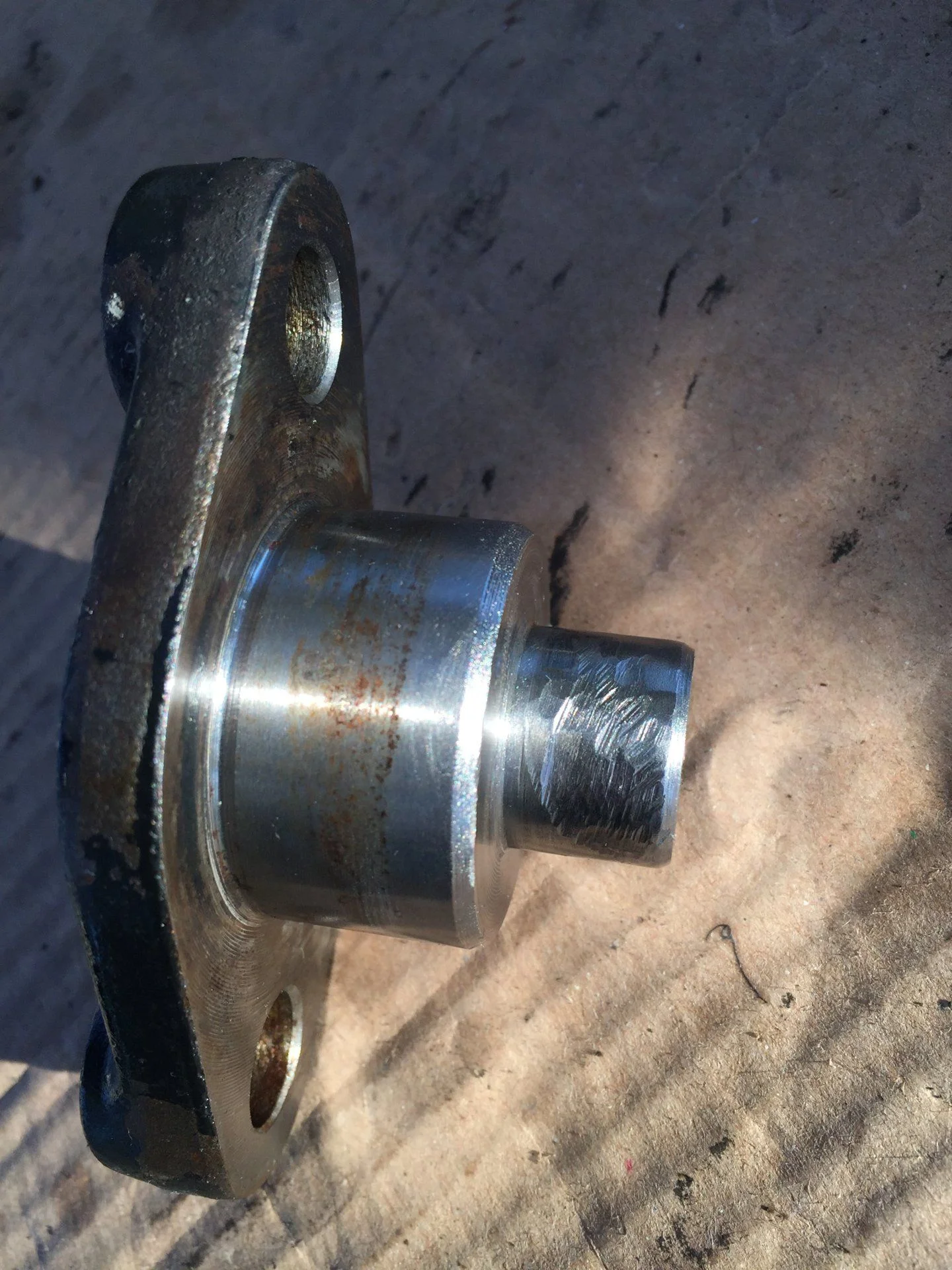

Rebuilt the from axle today due to the leaking inner axle seals. Also discovered that the knuckle cap was a little beat up on the portion that hold the trunnion bearing. Replaced the bearing and used the spare cap I had on hand.

Searched for individual headlight parts on Ebay AUS and then messaged the seller when I saw some and asked if he would ship over the whole set.
Total cost was ~$300 CAD for the lights and another $95 to ship. Note the quad headlights have different corner lights so you'll need those also.
