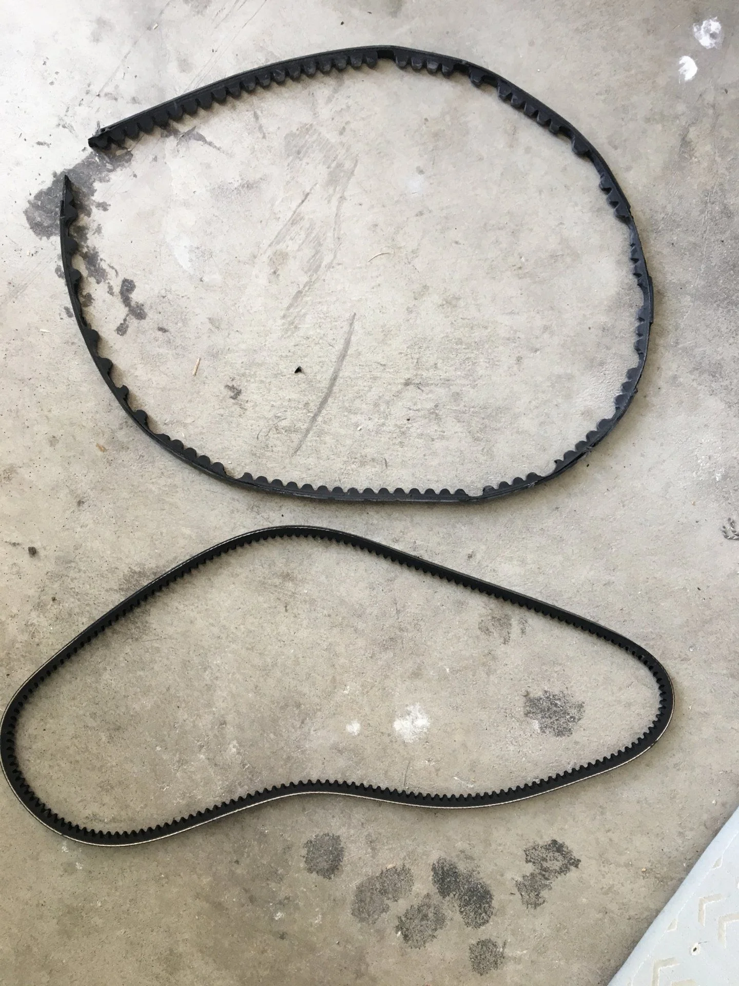

Not the weekend but finally got around to replacing the alt/fan belt. Realized there should have been 2 of them, and the only one I had on there was complete garbage. :doh:
That's the stuff of nightmares right there.......

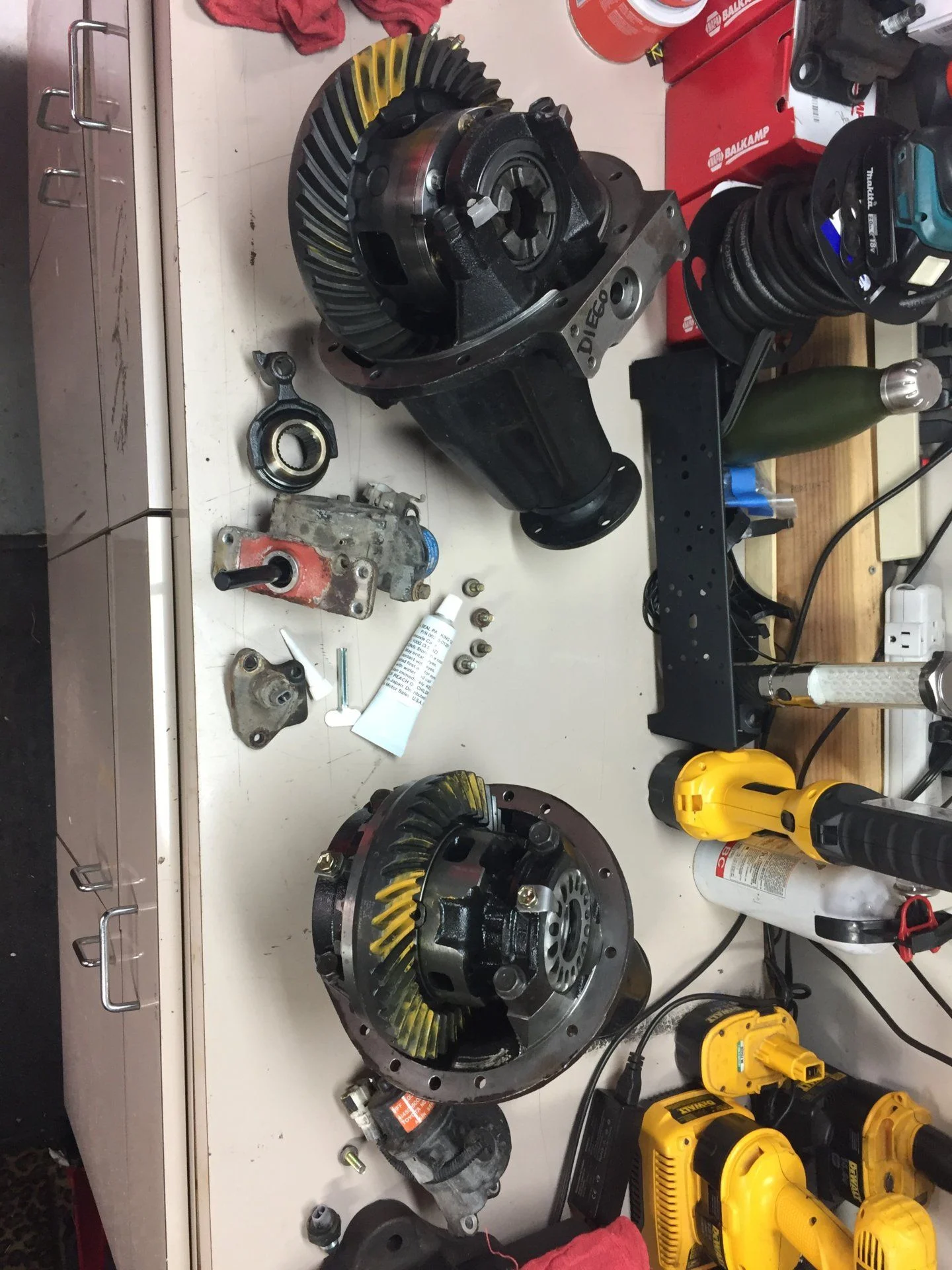

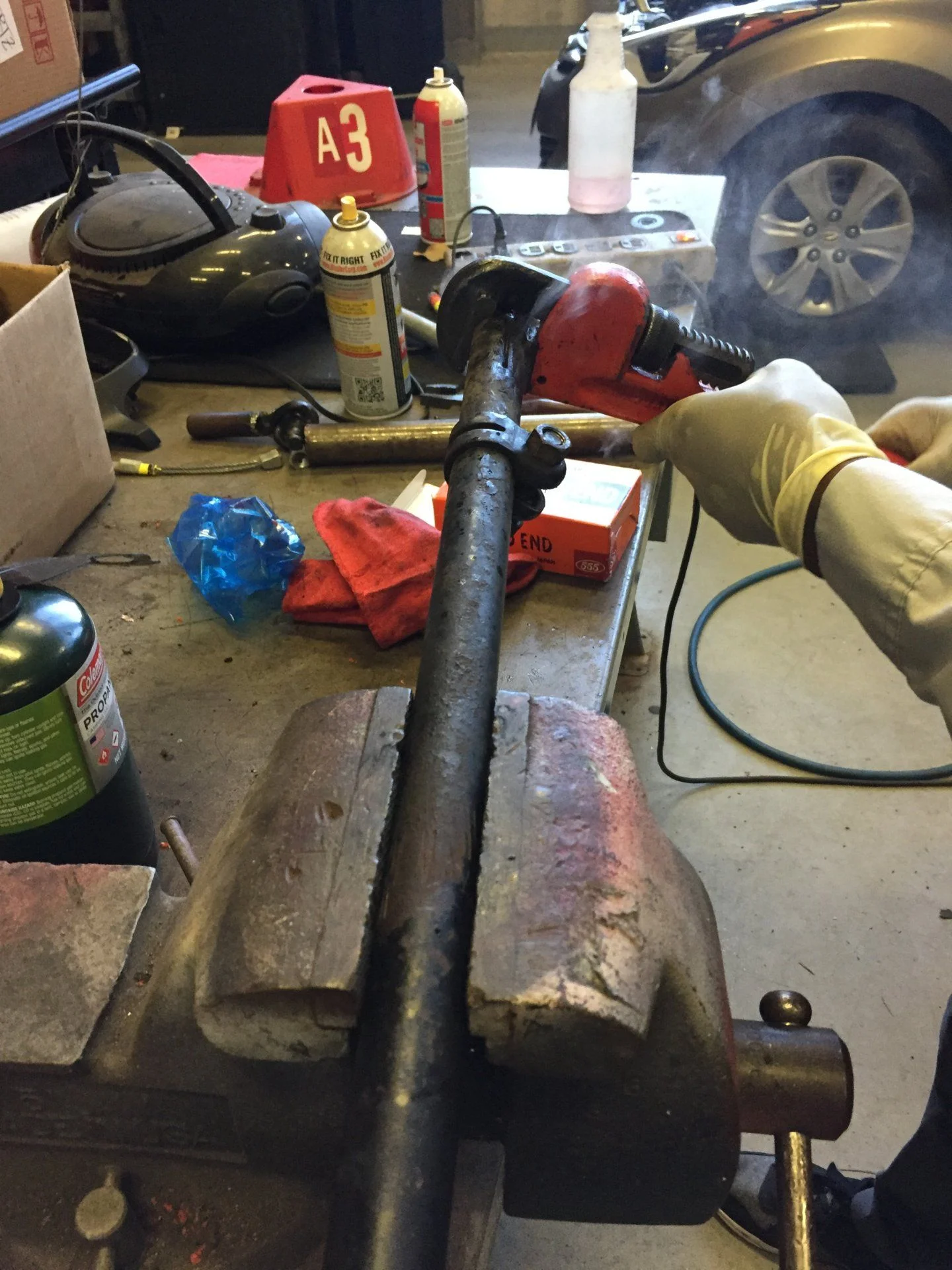

At 122,500 it was time for a regear to 4.88's. The "while you're there" is strong with this project. Rebuilt front axle with new bearings and seals, rebuilt rear axle with new bearings and seals. New front brake pads, rotors, and calipers(rebuilt NAPA), new rear pads and rotors, new Toyota U-joints, swapped sides on the birfs, and obviously, new gears, gear oil and grease in the knuckles. Just went with Toyota orange FIPG instead of the gasket on the diffs.
Zuk at gearinstalls.com is the man in getting the gears installed quickly and more importantly correctly with some great communication in between.
Overall, it was a straightforward job, the only real challenges for me were bench pressing the diffs when removing and installing and not realizing that the front diff will not reinstall with the tie rod attached. Had to pull the tie rod and I replaced the ends. They came off the steering arms with some heat and some pounding fairly easy, but it took a lot more heat and pounding to get the ends off the rod.
Dang! Dodged a bullet. Good to have two belts on for redundancy like Mr T intended. Glad all is still working. :beer:
