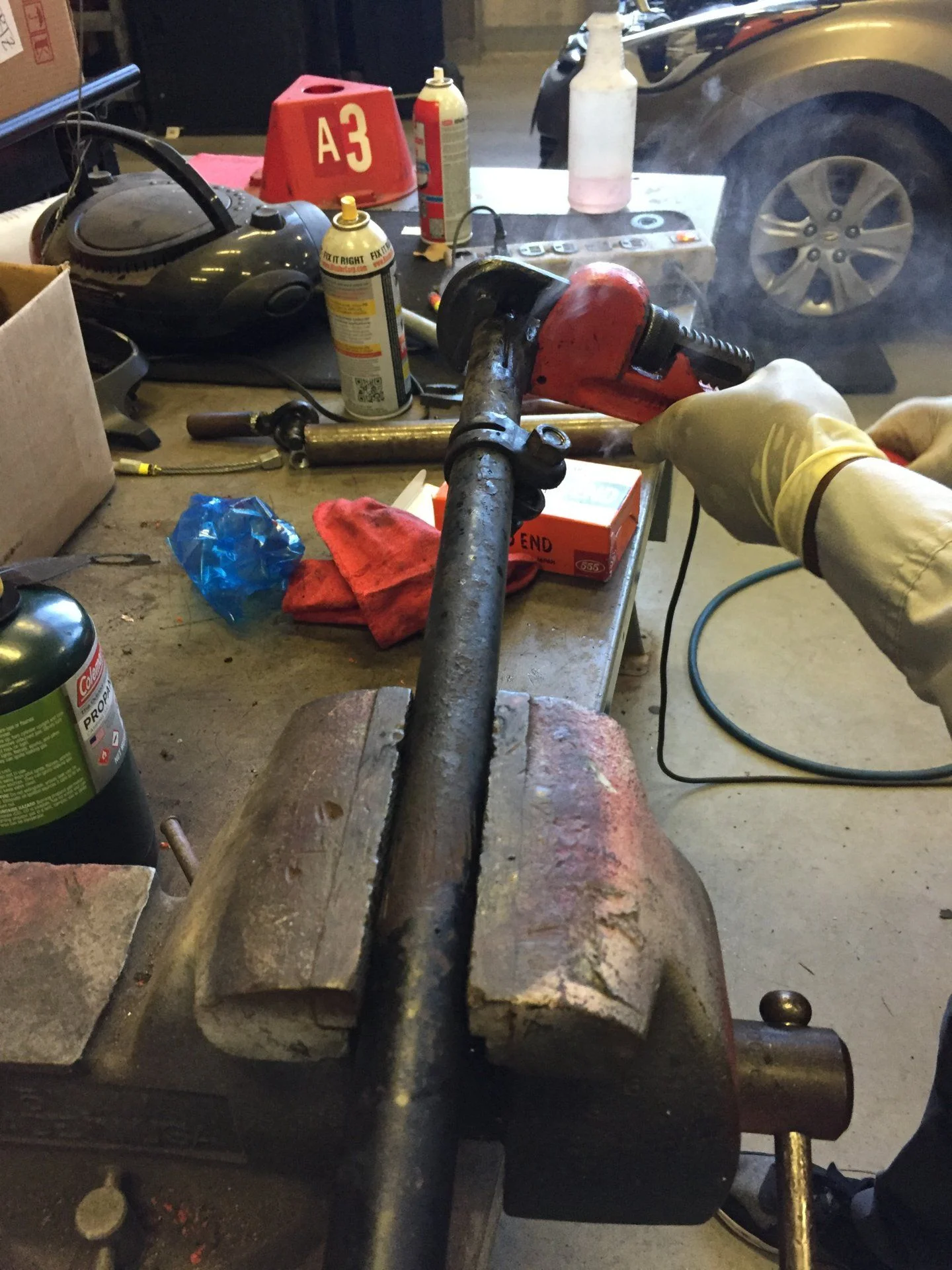

At 122,500 it was time for a regear to 4.88's. The "while you're there" is strong with this project. Rebuilt front axle with new bearings and seals, rebuilt rear axle with new bearings and seals. New front brake pads, rotors, and calipers(rebuilt NAPA), new rear pads and rotors, new Toyota U-joints, swapped sides on the birfs, and obviously, new gears, gear oil and grease in the knuckles. Just went with Toyota orange FIPG instead of the gasket on the diffs.
Zuk at gearinstalls.com is the man in getting the gears installed quickly and more importantly correctly with some great communication in between.
Overall, it was a straightforward job, the only real challenges for me were bench pressing the diffs when removing and installing and not realizing that the front diff will not reinstall with the tie rod attached. Had to pull the tie rod and I replaced the ends. They came off the steering arms with some heat and some pounding fairly easy, but it took a lot more heat and pounding to get the ends off the rod.

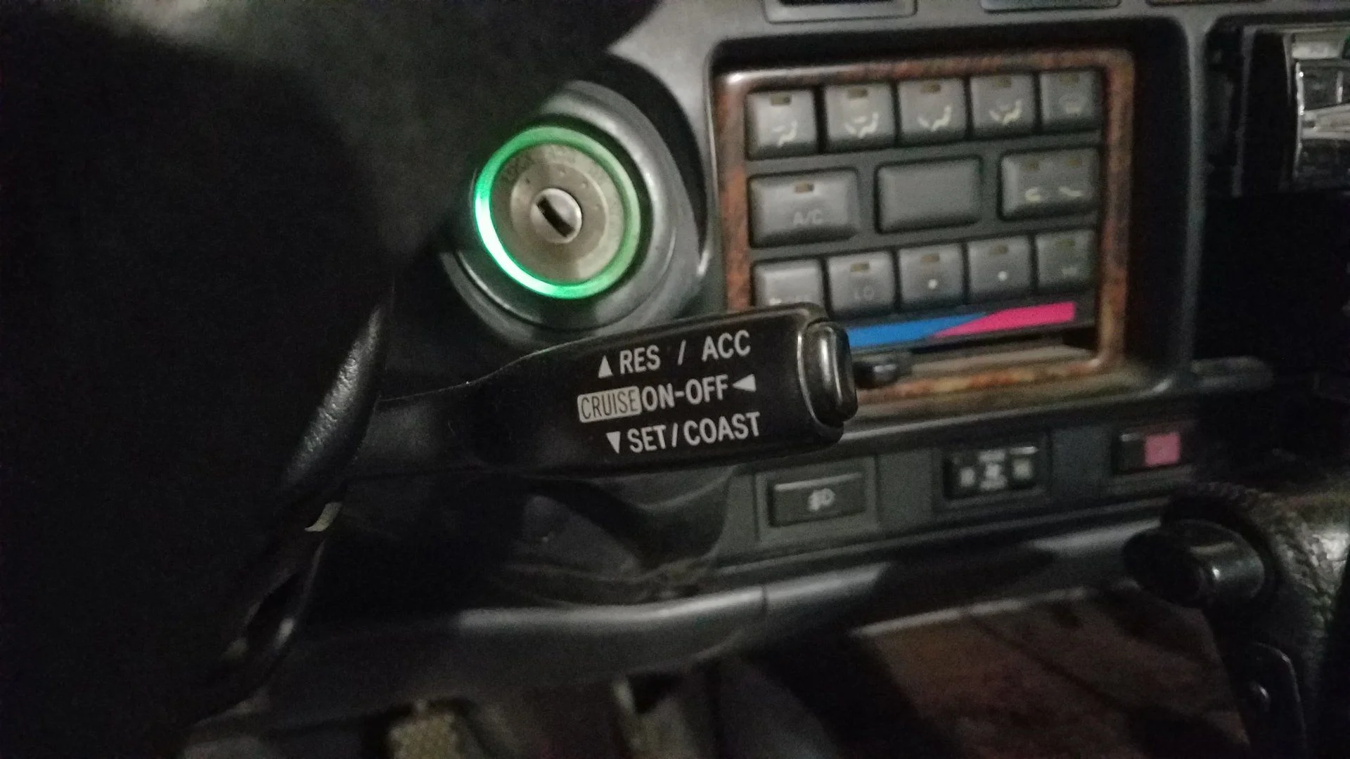

Got to try something I saw in a YouTube video a few weeks a go that I had no idea about. With the cruise control set, a simple up or down bump of the stalk raises or lowers the set point by 1mph respectively for each bump. Mind=blown. Sometimes it's the little things lol
Whaaat!!! This is possible?!! haha.... welcome to your land cruiser
Yup, that says"accelerate" and "coast" on it.
Reading... it's not just for books.
Yeah, well, coast doesn't mean slow in a precise amount. And they all accelerate, but I've never known one to go up in mph increments like that either. Nor does it say that. But thanks for the snide comment.
Welcome to the 90s, we've been waiting for you.
I use it a lot as most vehicle have the same feature but FWIW I get 1.5 mph changes:flipoff2:
Also noted if you pull back on the stalk it kills CC but remembers your setting for when you hit resume(RES).;)
