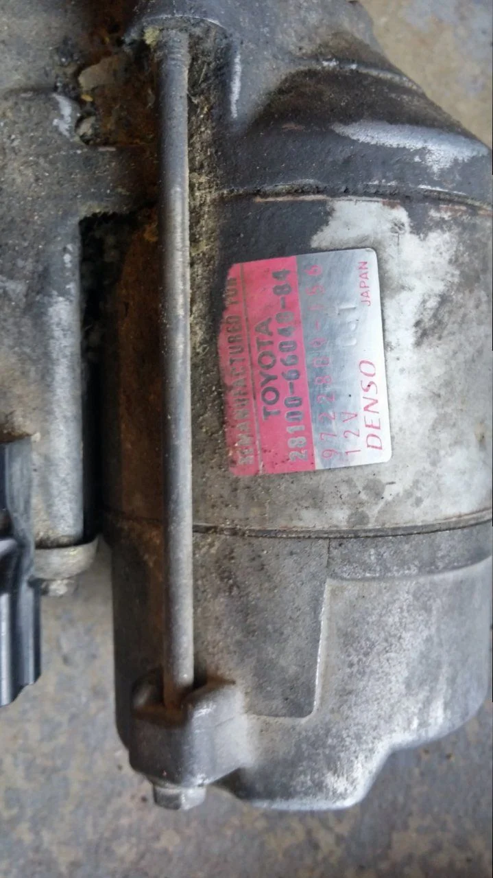

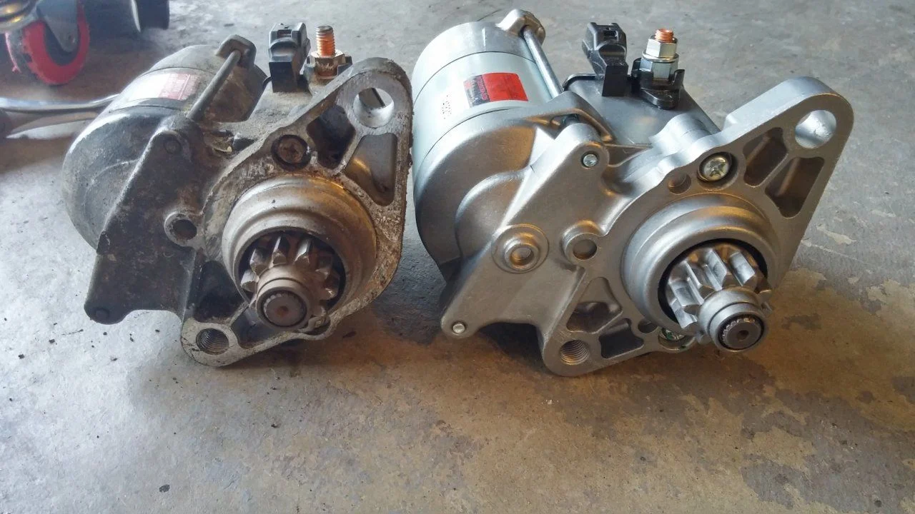

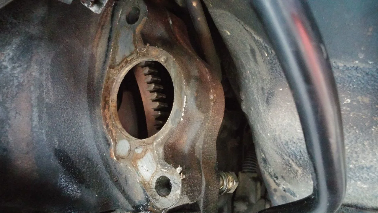

Had to replace the starter. I know I know, I could have just rebuilt it but I decided to go with a remanufactured OEM starter. The replacement is a 2.0 Kw and the original was only a 1.4 Kw.
Last photos with install.
Does it start faster? Not sure if it is all 1fz or just mine but it takes about 3 seconds before mine fires up even when it is warm.
Not sure if it starts faster but it cranks right over. You don't get the wa wa wa then turn over now.

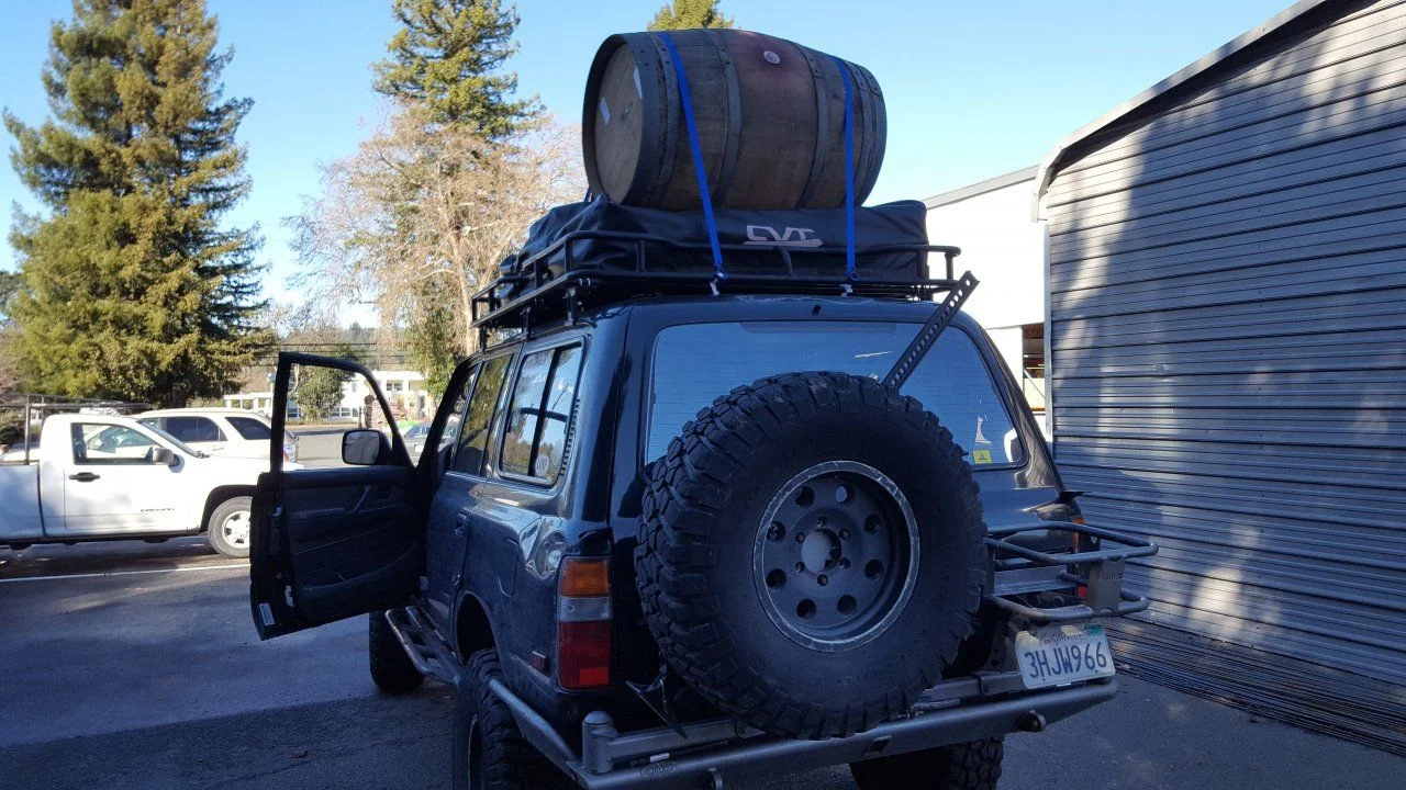

Put new 315 duratracs on the truck. With a 2.5" lift, they fit perfectly. I know you all tried to tell us how great 35 inch tires were, but the traction in the snow and on ice is unbelievable, and the ride actually seems much smoother. Now I need to find a way to carry the spare!
The 315 spare will fit in stock location. Look it up.
