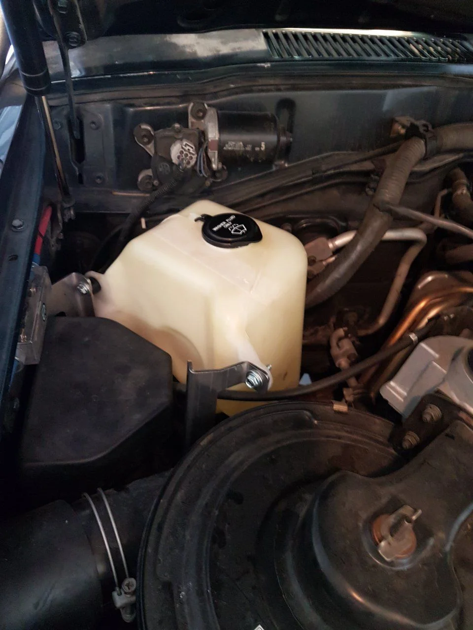

Also started the instalation if the second battery tray. need to read a bit more on how to deal with the PAIR plumbing which is in the way. Hopefully i can just block off both ends for now until I get a permanent soultuion.
NAPA 8955 hose, cut 1/2" or so off the straighter longer end, and bend the (in your picture) left hand side of the bracket back and out of the way of the battery tray. Job done. You may need a new clamp at the air box end.
I took the hose off the air box. Wrapped the port in the air box with heavy duty duct tape and a zip tie. Temporarily. Did the same near the engine. It held just fine for 3-4 months until I blocked it off at the exhaust manifold.
I'm planing on using some speed tape (aluminum stuff for aircraft) that I have lying around. I have the '95 coolant hose on order and a couple of blanking plates from Joey in my future so I can do the job properly .

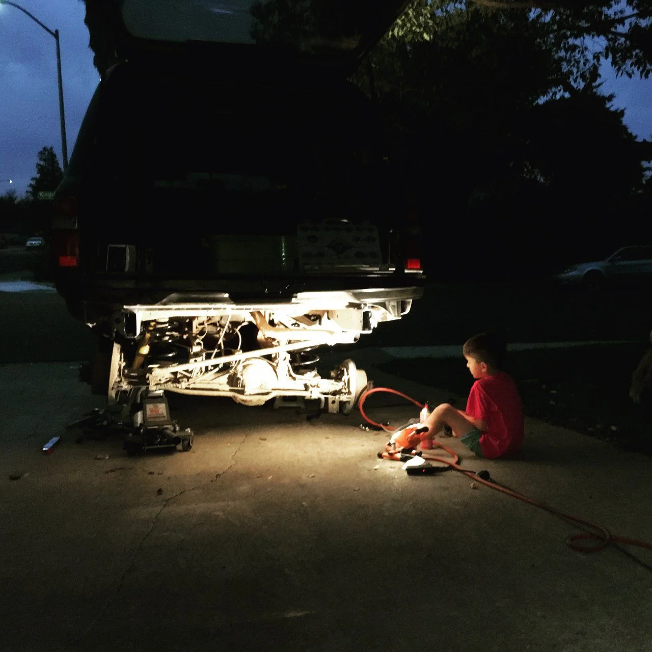

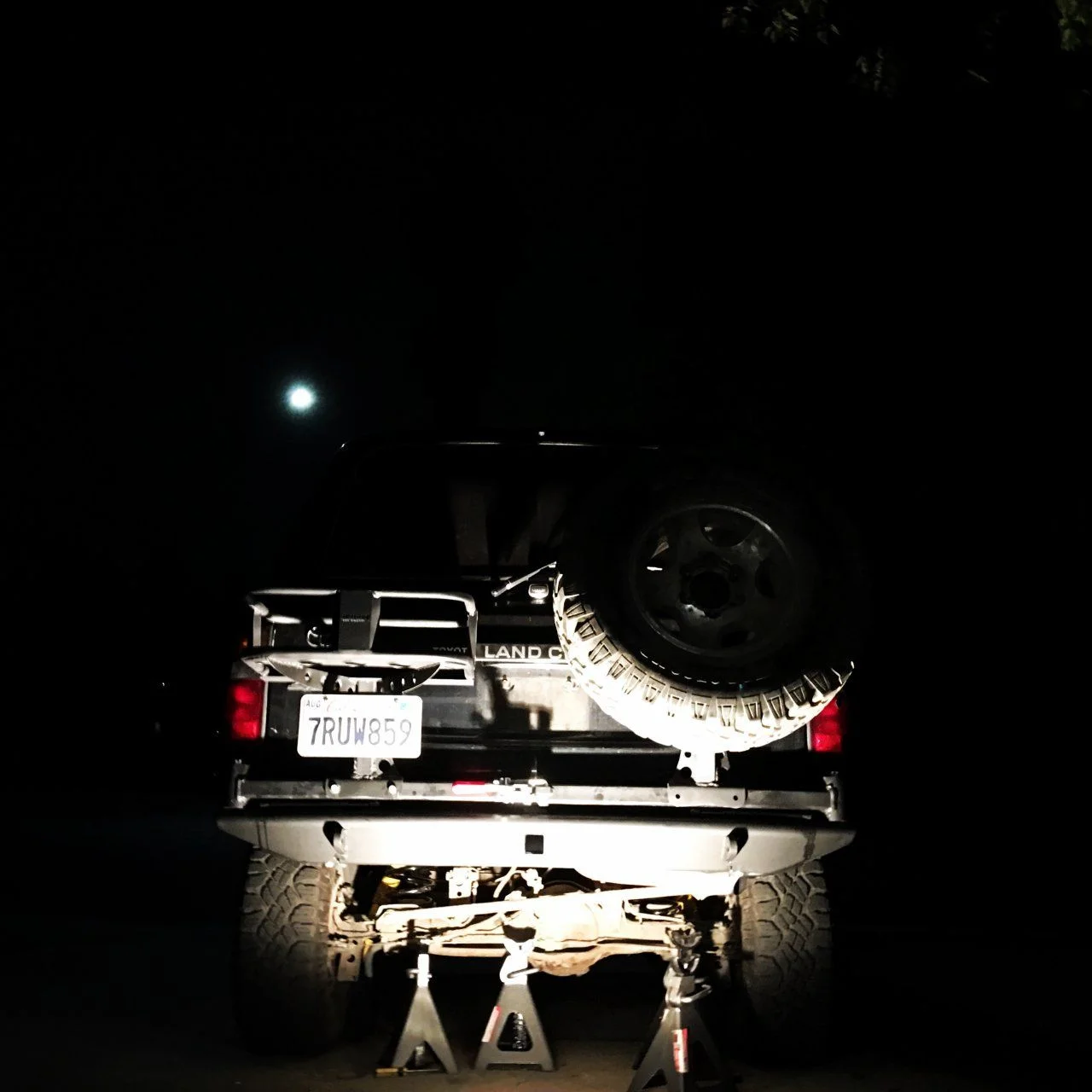

Finished installing the rear heavies + Ls last night. It was a family project.
This guy's new favorite strongman toy
Found that left over .035 makes great tie wire.
Knocking out a rear brake job while we're in there.
After I put the boys to bed I got restless and installed my DIY 4x4 Labs kit
All in all happy with the new stance.
Now to adjust the LSPV.
My rear brakes are super loud...need to address that.

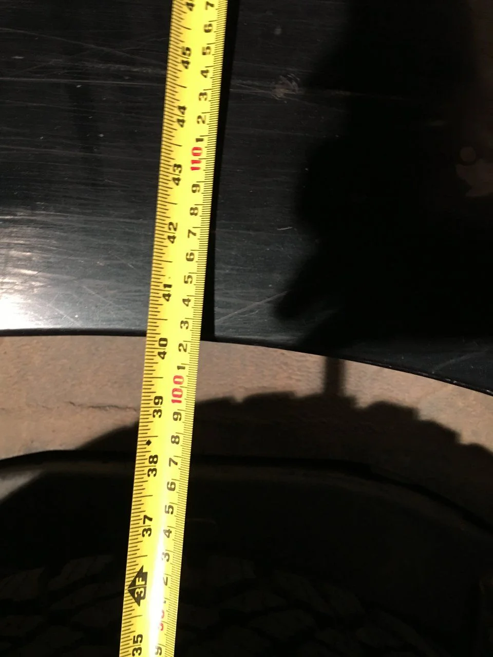

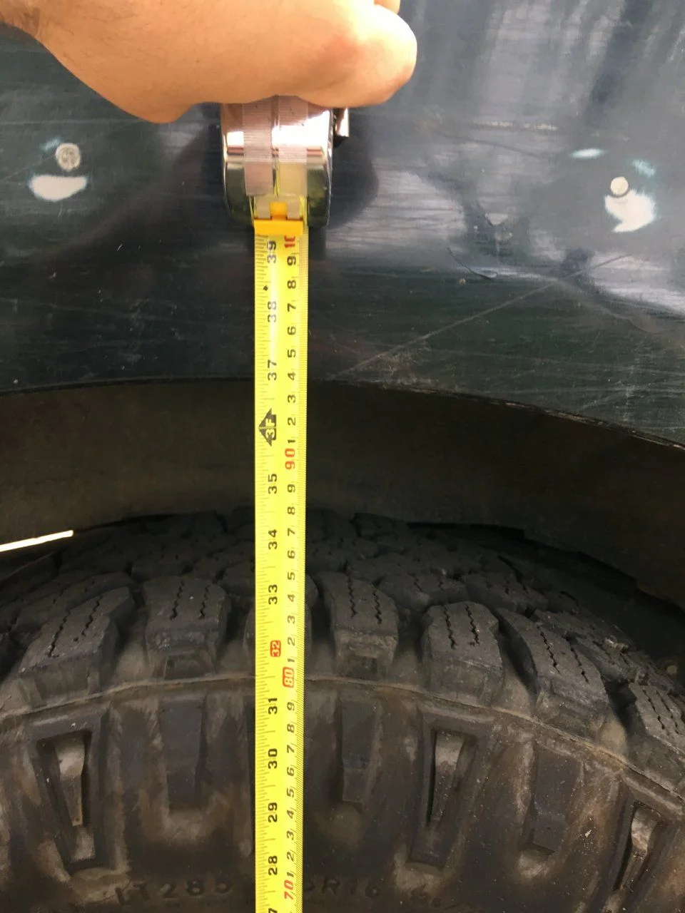

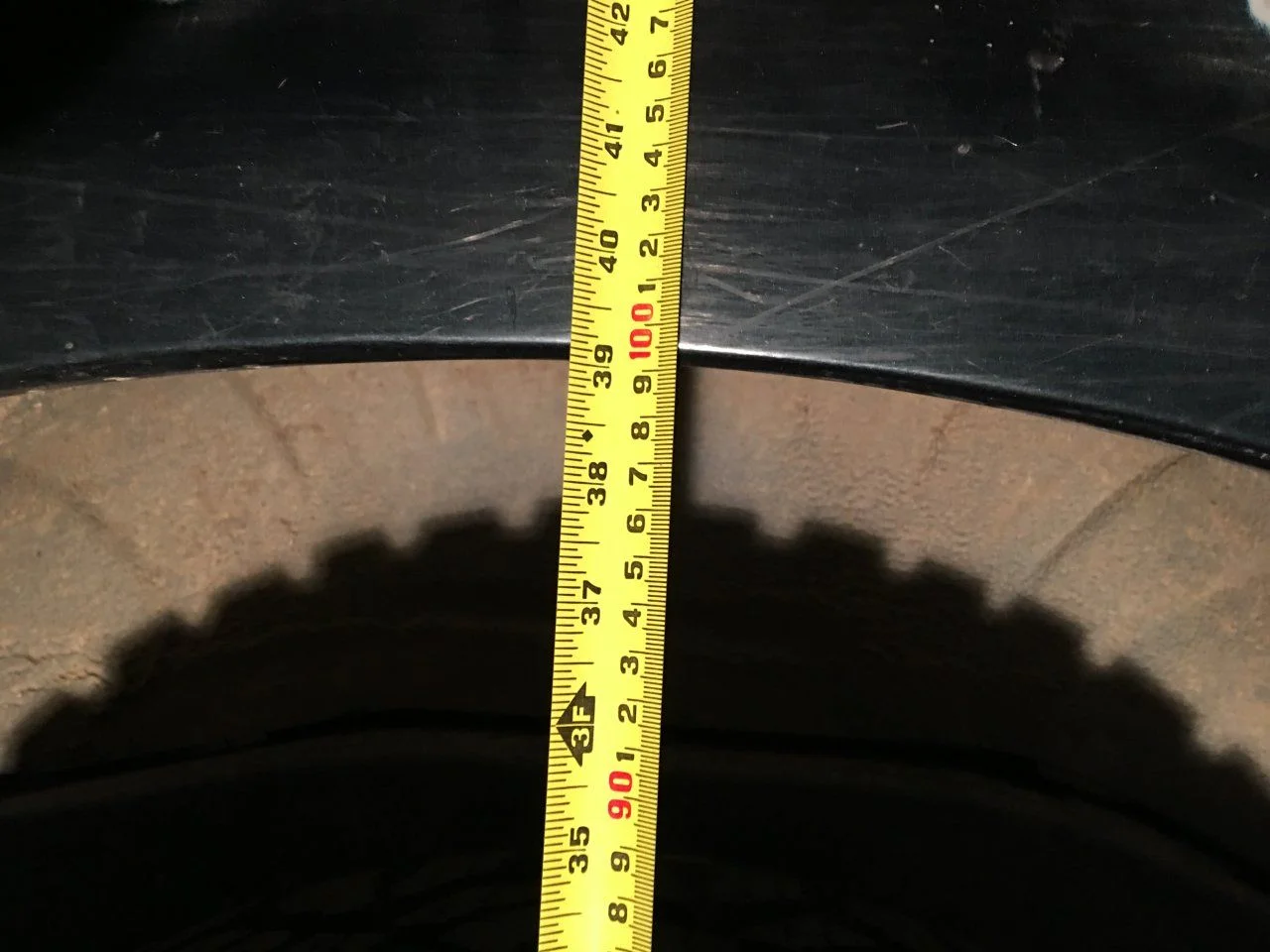

Rear measurements from ground up (nut hub up)
Stock, no bumper no spare
Heavies no bumper no spare
Heavies + 4x4 labs with spare mounted
Finished installing the rear heavies / Ls last night. It was a family project.
This guy's be favorite strongman toy

Is that measurement from the bottom of the rim?
Cause otherwise you are scaring me and I might have a cry-in session.
This is from the ground to ~top of wheel well. Not super scientific. Is it ideal to measure from bottom of rim?
