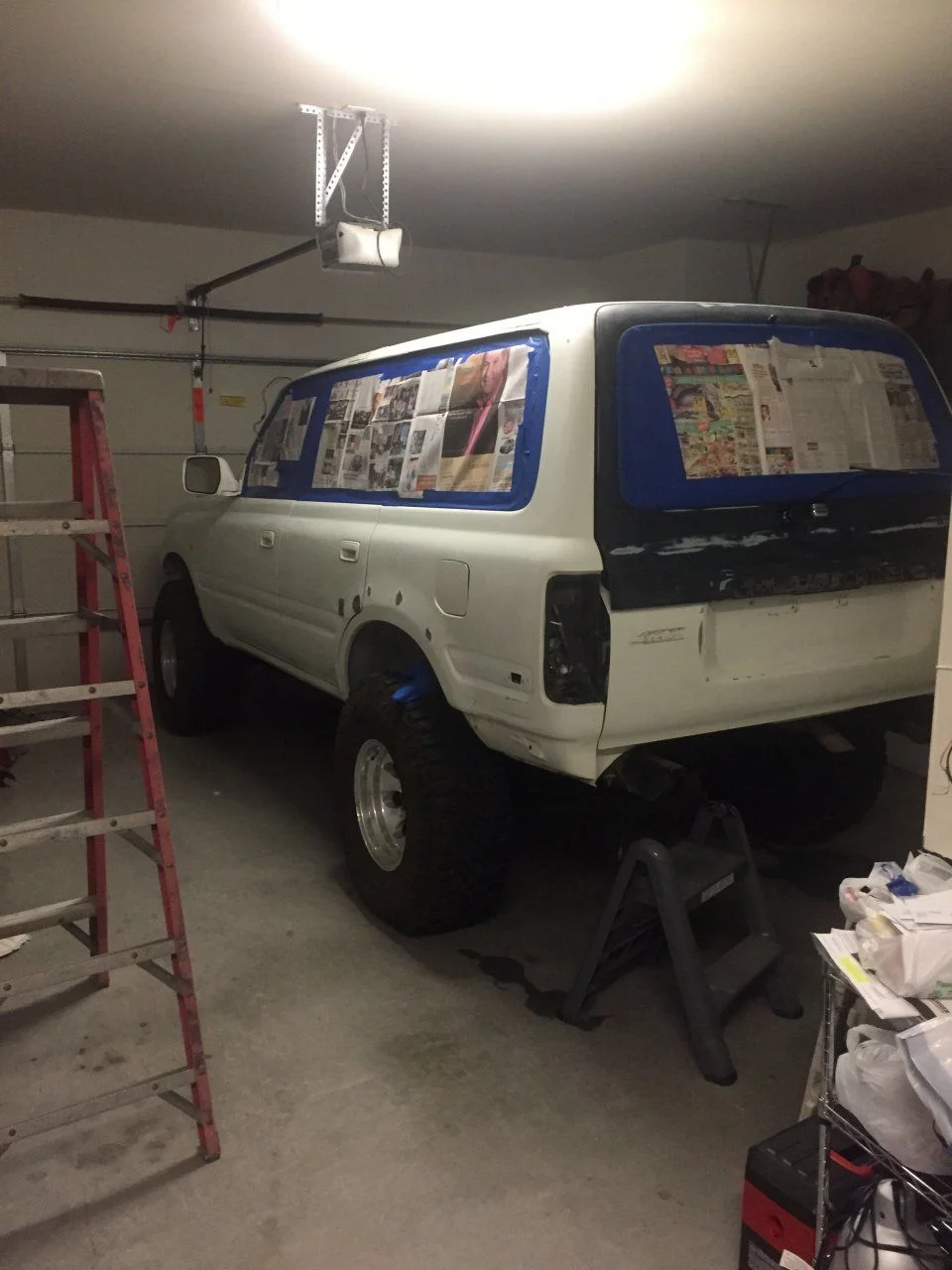

That's the color of the uppertail gate I bought for my '94 before I lined her...
Hey John, that's exactly what mine looks like after replacing my recently smashed hatch with the one off my green parts truck.. haha What color did you liner it? Did you sand and apply a white primer to green hatch before the bedliner?
Hey Steve, this was the end product. I went with white but mixed a little bit of beige to get an off white finish. I just sanded the green upper hatch and NO primer applied prior to liner.
It covered it pretty good. I didn't like the glossiness of the original white that is why I mixed it with the killer beej (beige). Then I rattle canned my rims.

Yes, I already went to Finish Masters and bought the factory 045 white tint. Did you remove the door handles or tape them off? I was think about having my powder coated.
I removed them.
And lined them as well, in black, errr, sprayed, lined. Whatever!
