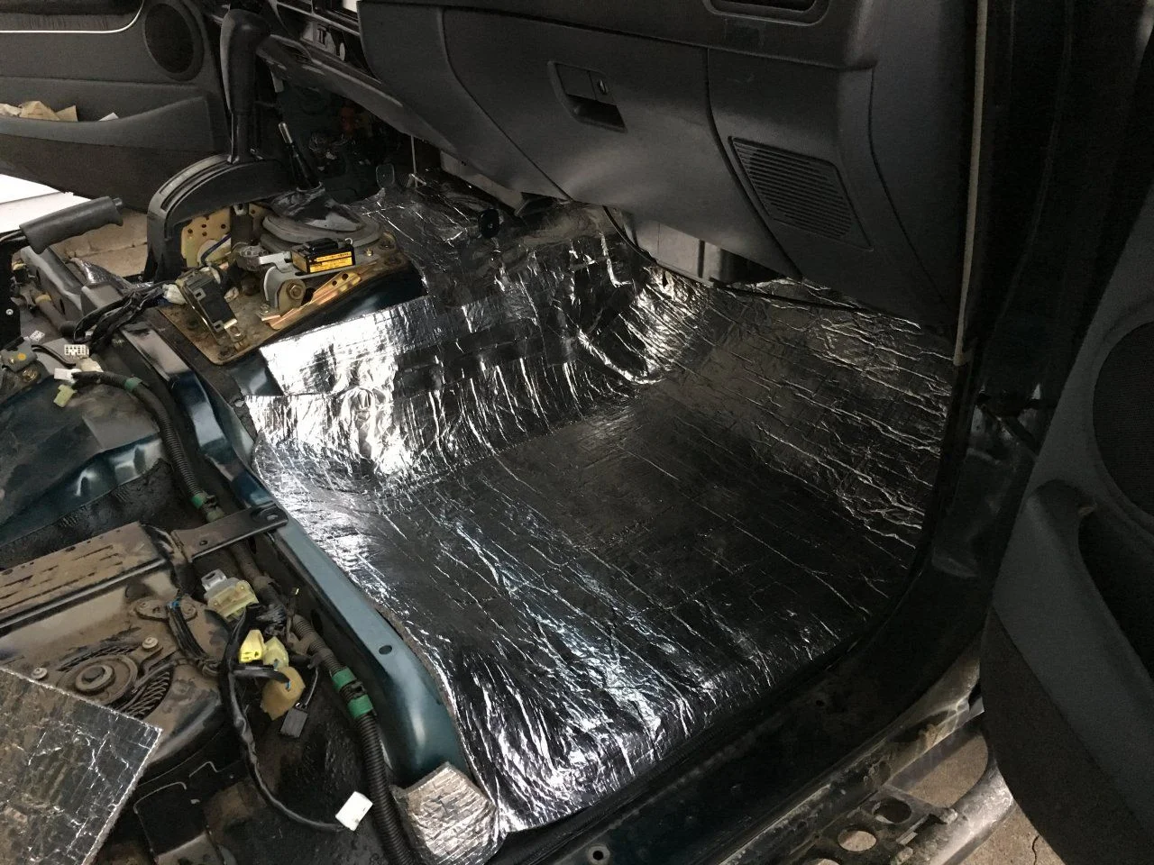

Back to cleaning and tearing out the carpet in preparation for the new vinyl flooring from Trail Tailor aka @reevesci. This rig was freaking disgusting. Pics don't do it justice. On the plus side it is now clean as a whistle and I found a couple more dollars in change and a chunk of silver (I'll contact the PO to see if this is a family heirloom or something and send it back to him).
View attachment 1320410 View attachment 1320411
Installed the Thermozite. There are varying opinions on which way to install it. I chose wool side down so that it would fill the flutes of the floor. Some say to install it metallic side down to reflect the heat. :meh:

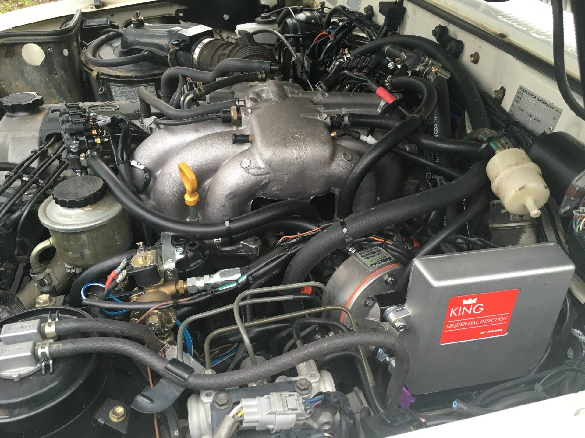

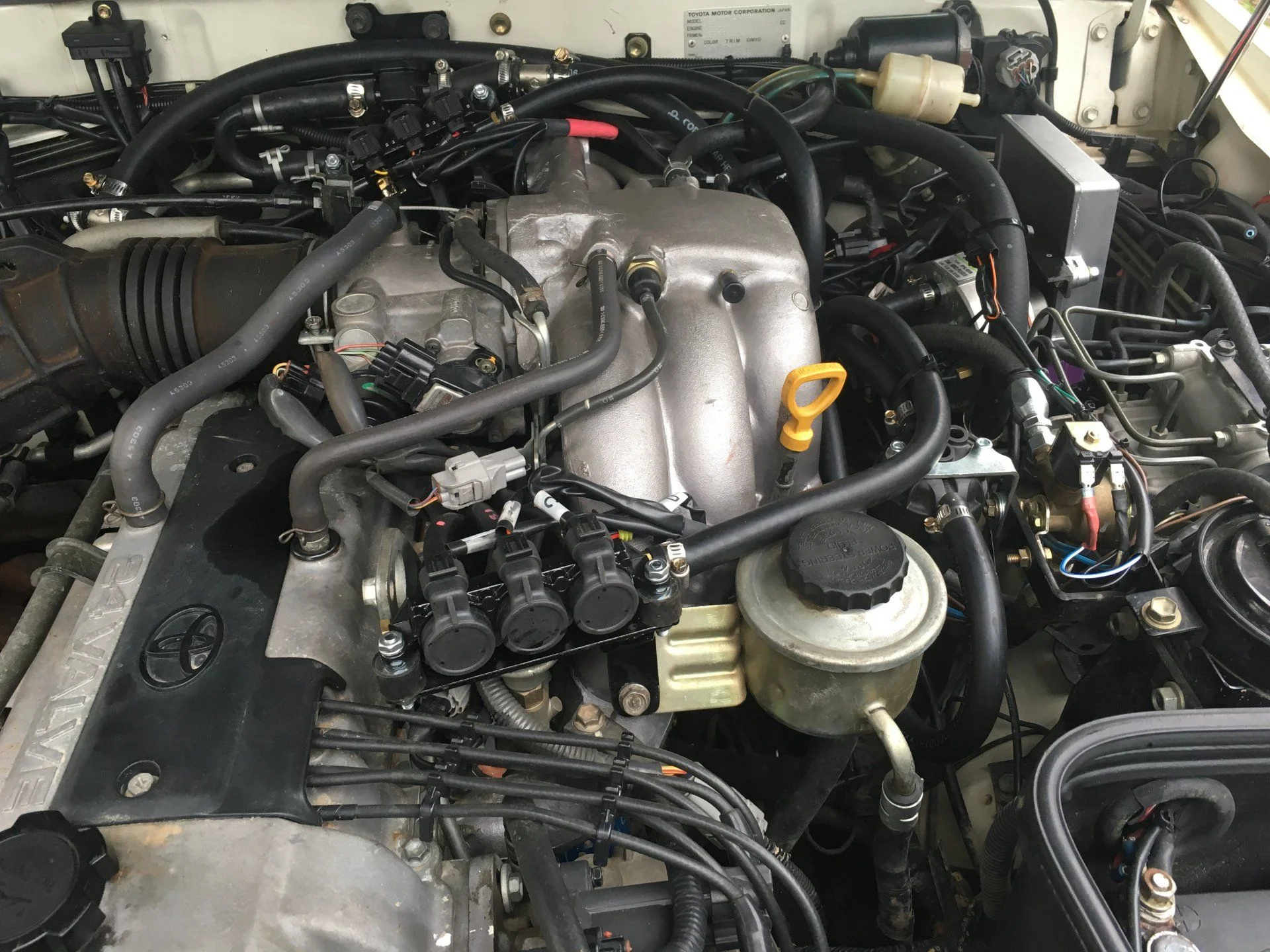

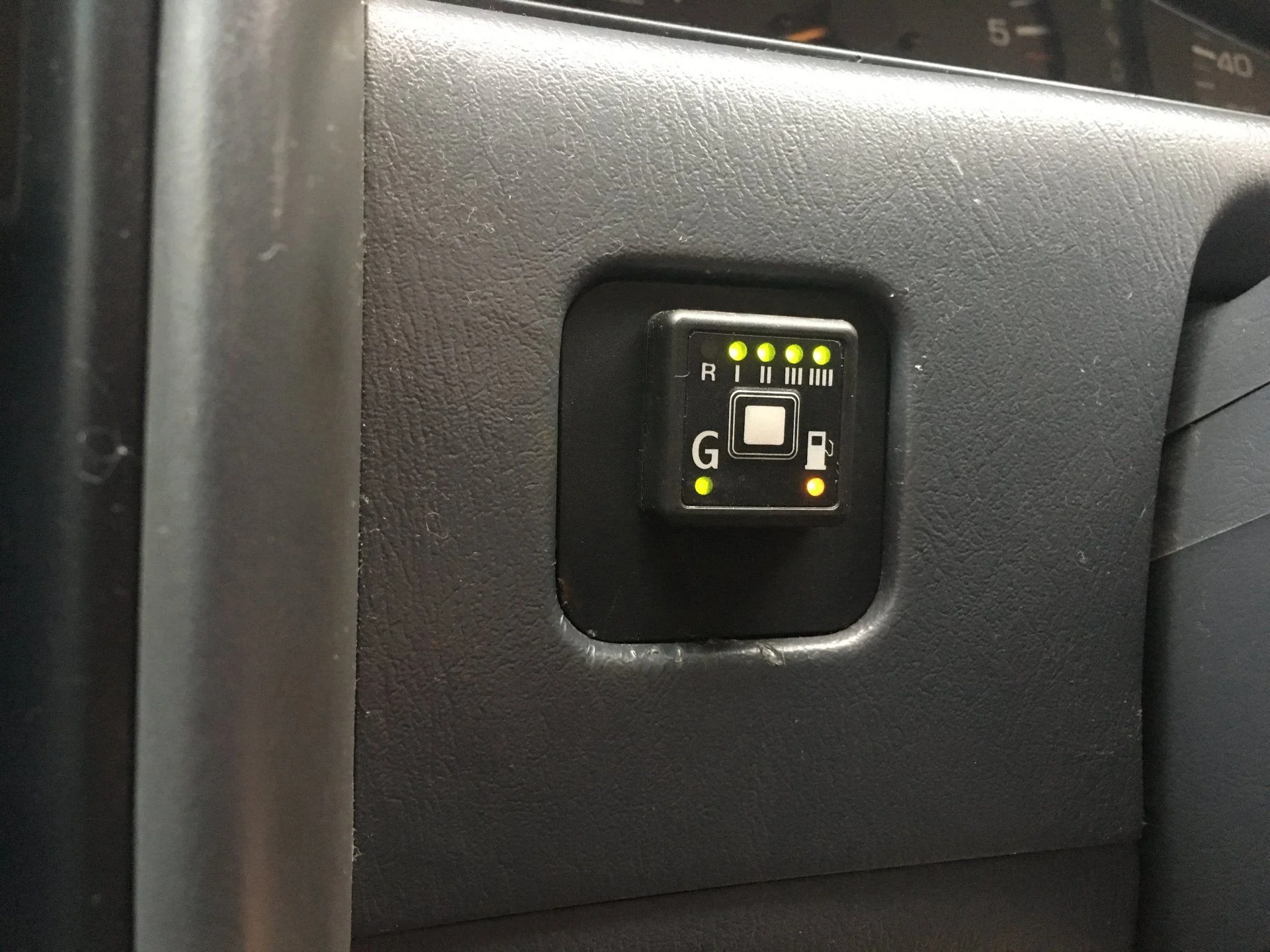

finished the sequential vapour injection LPG system over the weekend. (Thats propane to you seppos;)) I don't have any mileage figures yet but on first glance it needs less throttle for the same amount of Go and feels like the same power as petrol. the last system i had was a mixer ring type and there was a noticeable drop in power. pretty happy with it so far.
you can see three black injectors in front and three behind the intake manifold, there is a pressure sensor mounted high in the centre of the firewall above the intake pipe with vacuum lines running to the converter which is the round silver thing down next to the ABS lines and the brains of the whole operation is that shiny silver box with the red sticker on it. There is also a black filter for the vapour right next to the yellow dip stick and next to that is an on/off valve from the LPG tank under the back of the car.
So to operate the system its pretty simple. you get in start the engine and press the switch. the new computer knows when the converter is hot enough and turns on the LPG then at a set minimum revs 1200rpm in my case, the system switches over automatically and it stays on LPG until you shut down the engine. the computer with then start the engine on petrol then switch to LPG when it's ready. No hesitation in the engine at all when it changes between petrol/LPG unlike the last system.
if you are standing there with the bonnet up you can hear the injectors operating but that's a little clicking noise and not noticeable with the bonnet down. unlike my last system, when I run out of lpg the computer automatically switches back to petrol.
both the LPG and the petrol lights are on in this pic because I pressed the button before taking the photo but had not yet blipped the throttle above 1200 rpm to let the the computer switch to LPG. The little bars on the top of the switch indicate how much LPG you have in the tank. I will move the switch when I have lockers and install the magic dial.
This is pretty cool. Do you expect drastic fuel economy? What does a system like this cost?
This is awesome!!! Where can I get more info on this ? I have been wanting to look into this for a while but have yet to see it done. I converted a samurai years ago and it worked awesome.
