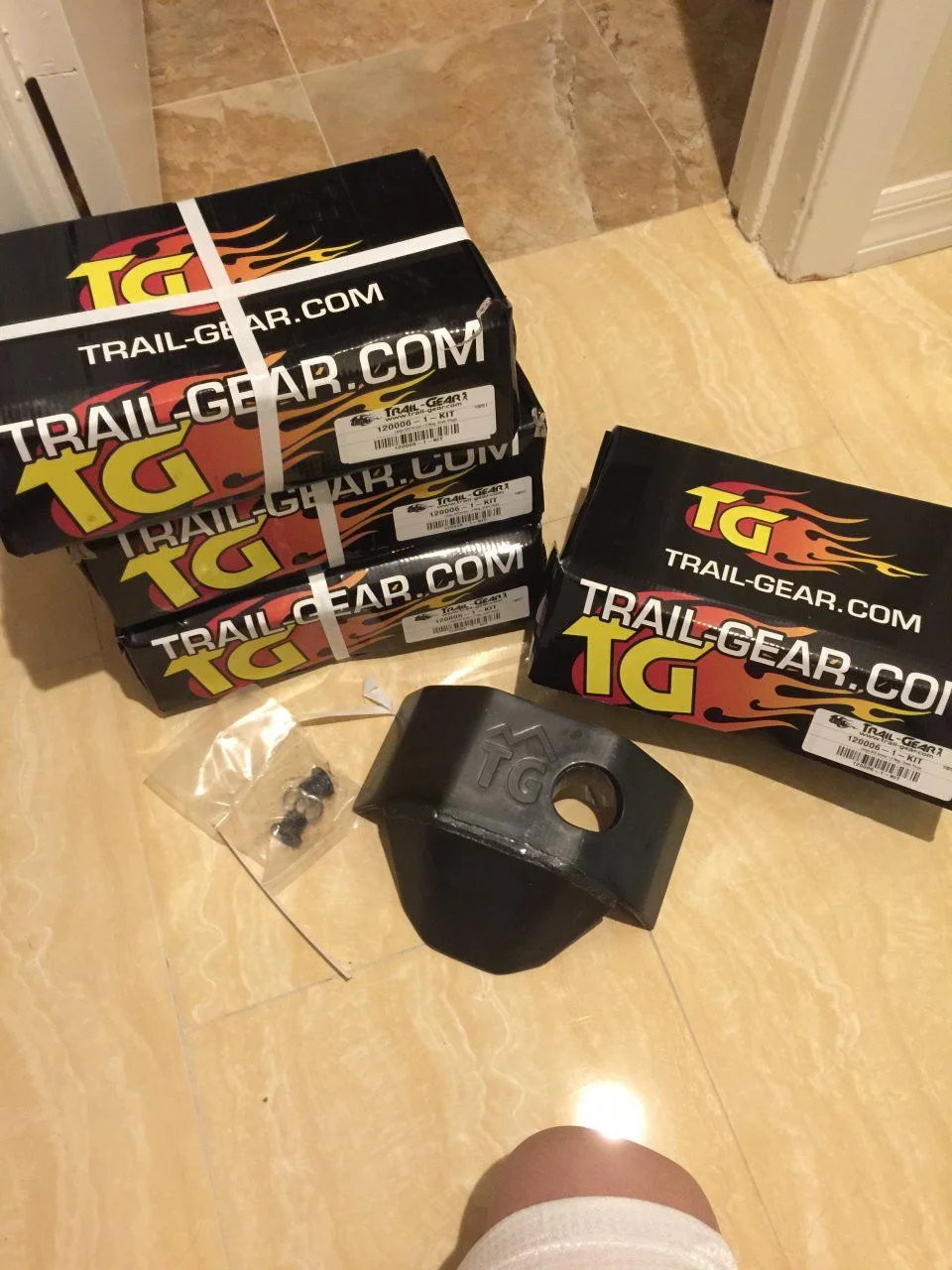

These finally came in....@dragos80 come and get yours!
Make sure your front Panhard rod clears that trail gear diff guard when you get it on. The trail gear diff guard was causing interference with my Panhard rod and making noise when the suspension flexed. It was really hard to find where it was contacting. The Panhard required more clearance than I would have thought.
thanks for the heads up....will make a note
