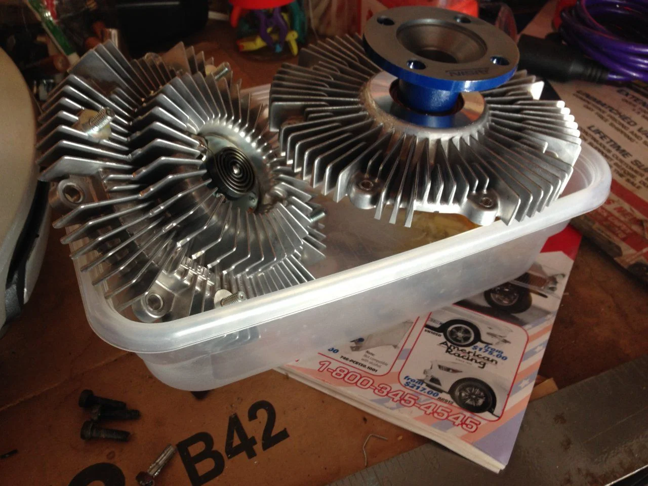

I had to purchase a new blue hub clutch because I couldn't get my s***ty eaton one to separate. Hell, I even had to drill a screw out that got stuck in there. :( Only $70 on amazon though. Going through and draining the OE fluid. I have a bottle of 10k and a bottle of 20k, should I do 10? mix and get 15? or go straight 20k cst on this clutch?

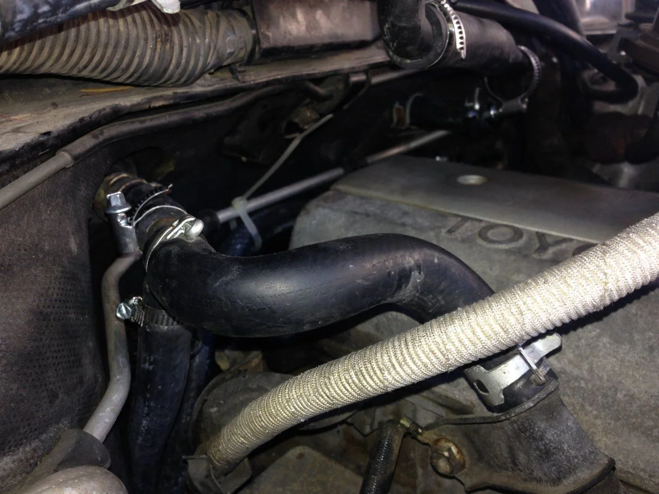

Also completed the PHH work around and re-routed the rear heater hoses with 1/2" gates hose. Also decided to just replace all the heater hoses while I had it apart since they were all hard.
Also cleaned out my throttle body for the egr ports, I'm hoping that clears my CEL as one of them was completely clogged.
Next is to get the new heater valve from Napa (on order). The original was in terrible shape. Also replaced the thermostat with a new OE one. Radiator looked like it was in great condition. Flushed all heater cores, block and radiator, everything looked clean. :)
