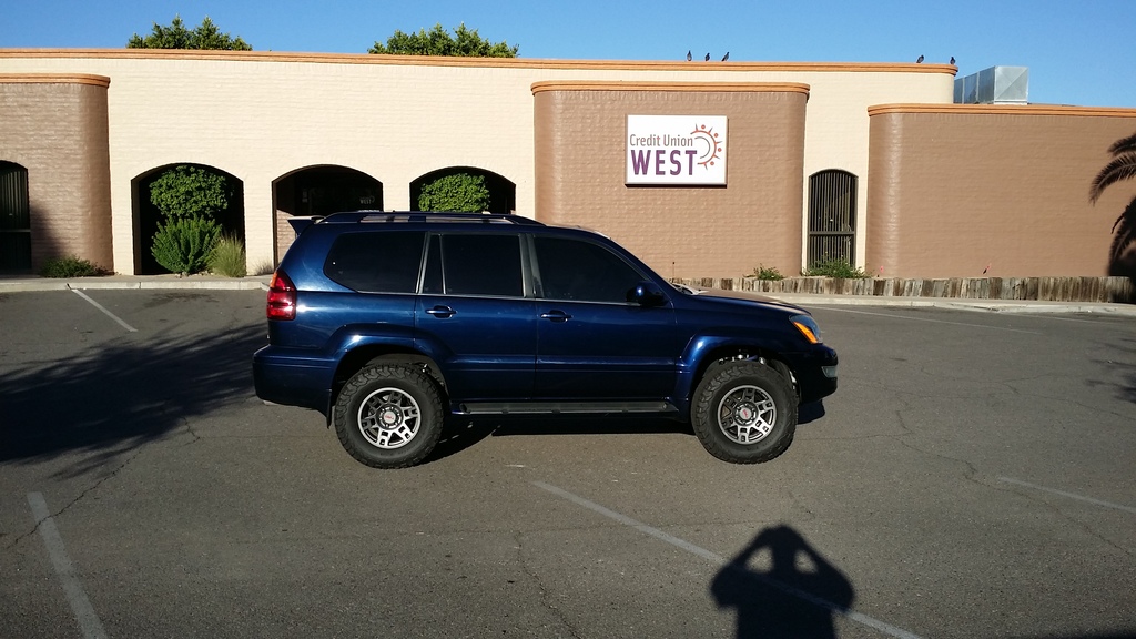

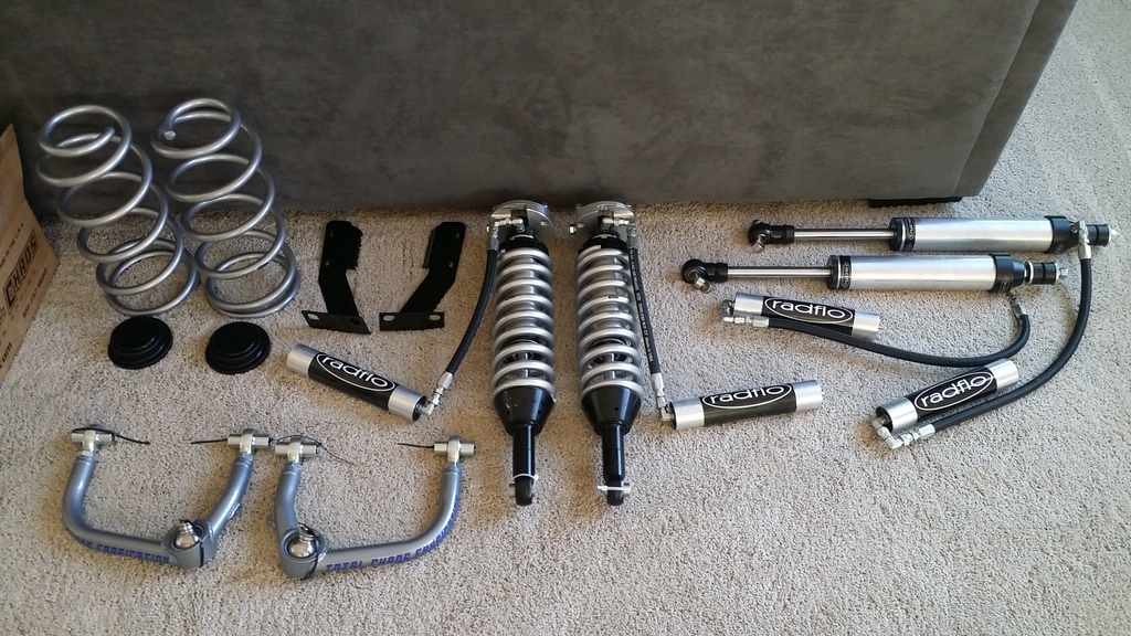

@FreeGX What lift do you have? I'm getting ready to install my Radflos and they are currently at the as delivered setting but I don't know how many inches of lift that translates to.
GX470: Radflo 2.5" with FJC coils
Straight out of the box at the setting they were shipped at, my front end measured ~21" from center of hub to fender flare. I seem to recall this was about 2" over the stock sagging suspension?

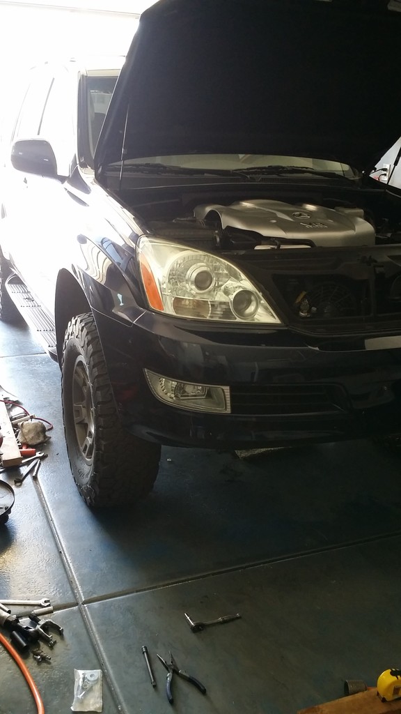

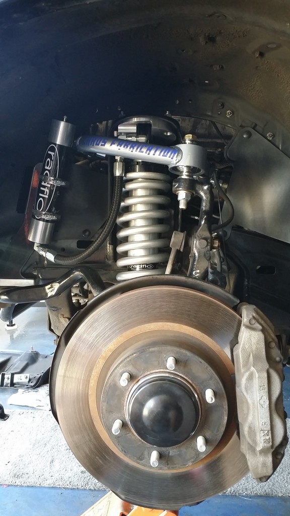

Got the A arms, rear springs and front coils on and mounted. Rather than drill holes for self tapping screws, I chose to run the hose clamps all the way around the frame. Not sure how long this will hold or how reliable it will be....The fronts were bolted on as designed. FYI, I did run into some interference on the right front reservoir mount with the windshield wiper tank. After hammering the mount flat, it slid right behind the tank with no issues. As far as the ride goes, its definitely stiffer than stock. It soaks up large bumps nicely but you feel more of the road imperfections. Unclear how much of that is the suspension or the heim joint A arms. Anyway, I'm happy with it.
