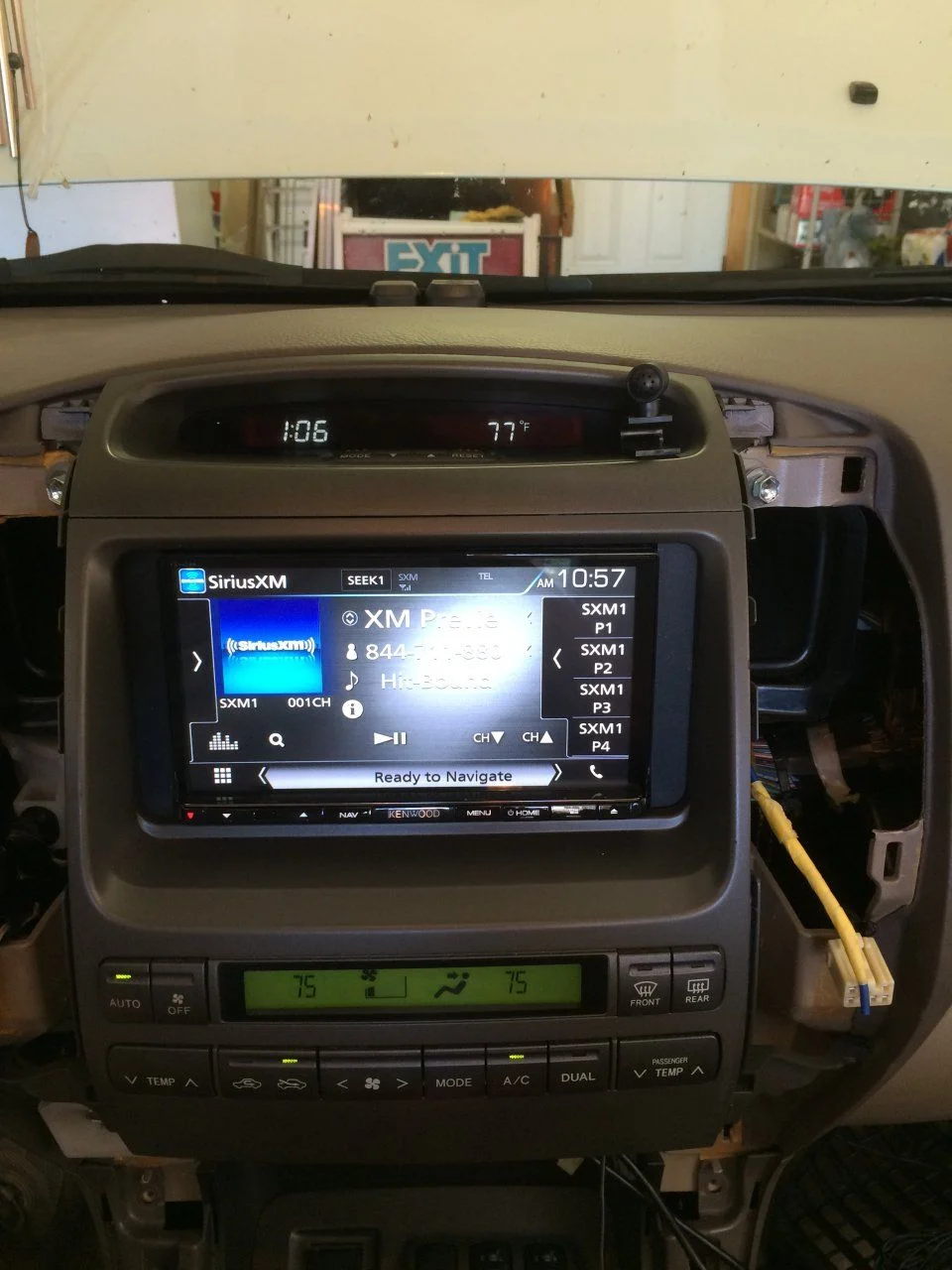

Hey Coops! All you need to do is pull the two center console pieces, then remove the two lower dash panel pieces to expose the bottom of the wood panels where the vents are. Once those two vent panels are off, it will expose the bolts to remove the radio.
Thanks. Might try to get it in before heading to Ouray on Weds

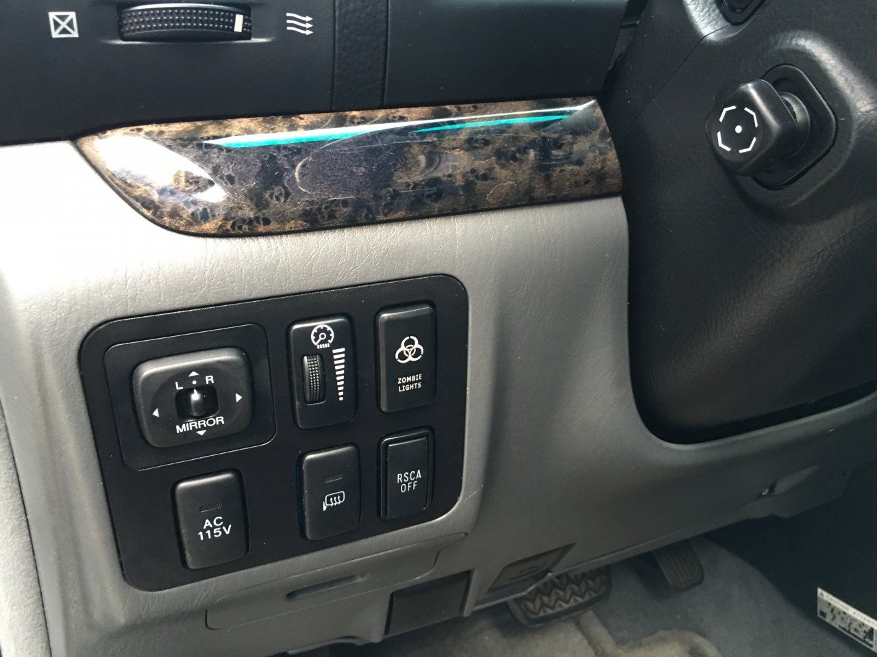

Did the Late Model switch mod and added a factory style switch for my aux lights. Very Happy with it. Also saw that only one of the original switches were lighting up in that cluster. Fixed all of them and the diff lock switch light. The contacts on the bulbs must not have been touching. I just bent them out with a tiny screwdriver and they are good to go.
What is the late model switch mod? My '05 doesn't have a spare space for a button like yours, does the mod free up space? Looks great.
Hey, Mine is an 05 also. The switch panel that I picked up is from an 07. Once they started putting at the AUX port in for the radio, they moved the center diff lock switch to the side. Since we have the diff switch in the center, it gives us a free slot. I picked up the whole assembly on eBay for about $55. The light switch is also from eBay. Just look for FJ Cruiser factory style fog light switch. I think it was $13. Came from China.
Sweet! Thanks for the info, I'll start looking for an '07 switch plate.
