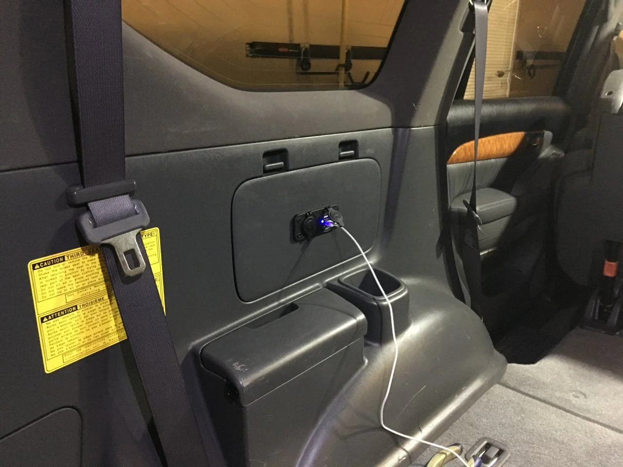

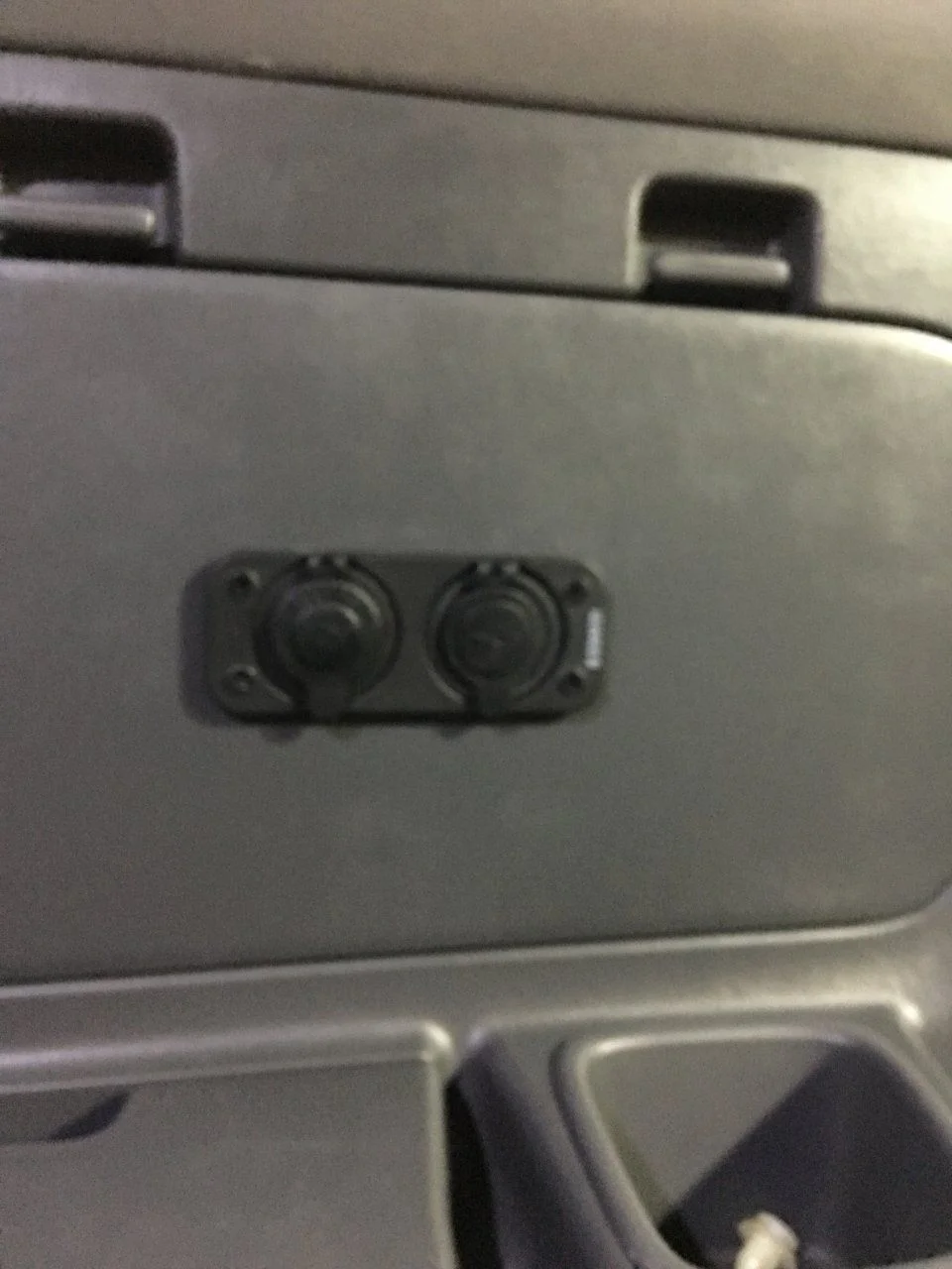

Installed a 12v socket and 2 USB ports in the rear. Installed them on the little cubby panel since I dont use it for anything else.

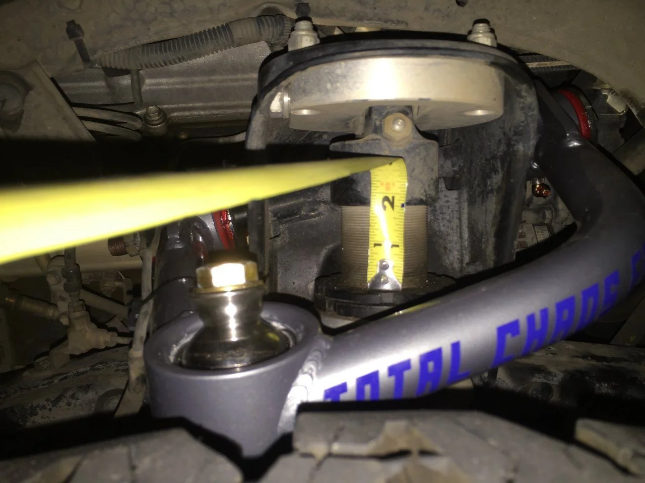

@FreeGX What lift do you have? I'm getting ready to install my Radflos and they are currently at the as delivered setting but I don't know how many inches of lift that translates to.

Standard travel Radflos up front w tricked airbags in the rear. There's about 1.75" of threads showing on the RF. A little more on the LF to compensate for all the additional left side weight (fuel tank, battery, driver).
Very interesting. As delivered, my shocks have just under an inch of threads showing at your measurement spot. How much height did you gain with having 1.75 inches of threads? I'm just trying to equate inches of threads to inches of lift height.
