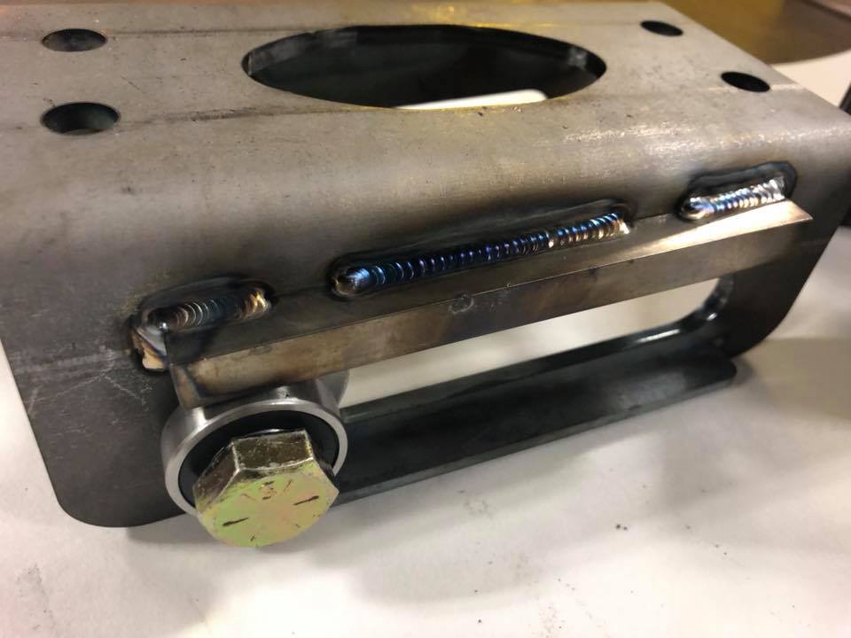

looking for options for front
If it were me and the plan is to keep the springs you own then sliders are an option.
Bearing type.
Bushing type.
iu
Or a leaf spring reversal with the shackle in the rear and build a set of 7" shackles with the pivot up in the frame.
Bearing type.
Bushing type.
iu
Thanks Jim, will discuss with Steve at Northwest design and Fab. He has sliders on his pig
Better than the ‘through the frame’ front shackle setup? That’s my favorite 👍🏼
Haven’t seen enough of the long term slider use to have an opinion on them yet.
Through the frame front shackle was a PITA and it works great but not sure it would be my first choice if I was paying someone to do it for me, lots of stuff guys like us do is cool but it's a hard sell to get someone to pay for it when things like sliders exist.
Sliders have been around forever in dirt track racing and I think they are reasonably durable, it’s my understanding they help keep a more constant spring rate throughout the range of motion and I would experiment with lighter springs if I were going to try them (or remove a spring or two from existing spring pack) then move the mounting points around to get my ideal ride height.
That bearing setup looks interesting and would be easy to throw a set of bearings at every 50,000 miles if that’s what it took.
