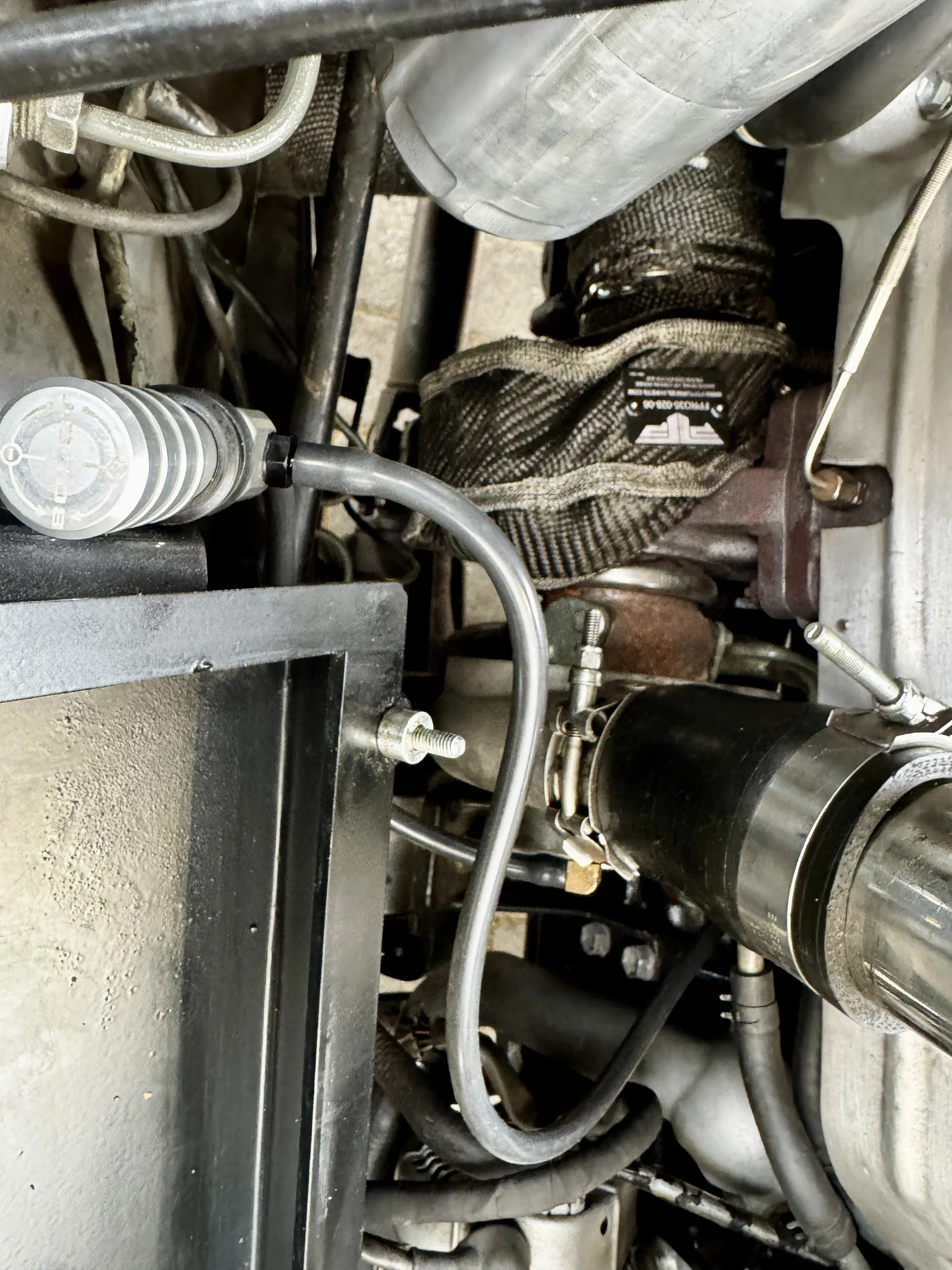

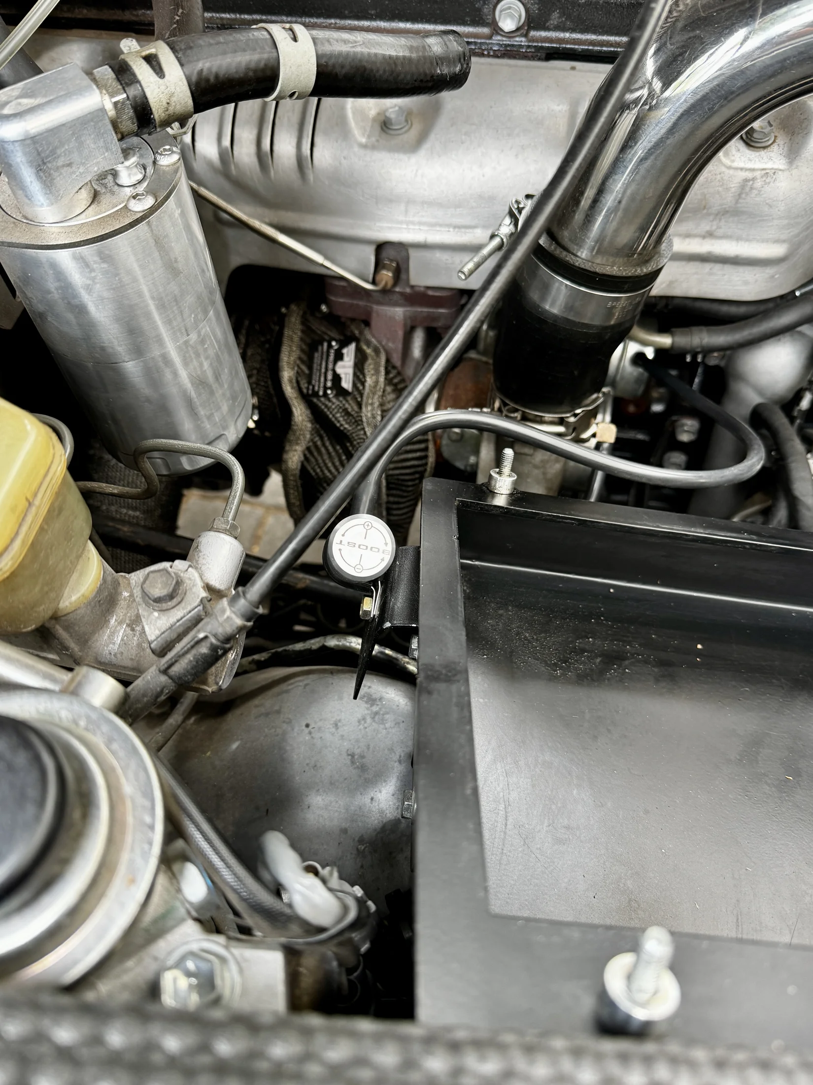

Tossed a Hallman manual boost controller on the 77 over the weekend. Seems like a nice unit but still need to play around with it.
Upcycled a bracket to have it stand-off Tor's air filter box a bit. Only place I could fit it and still be able to easily adjust.

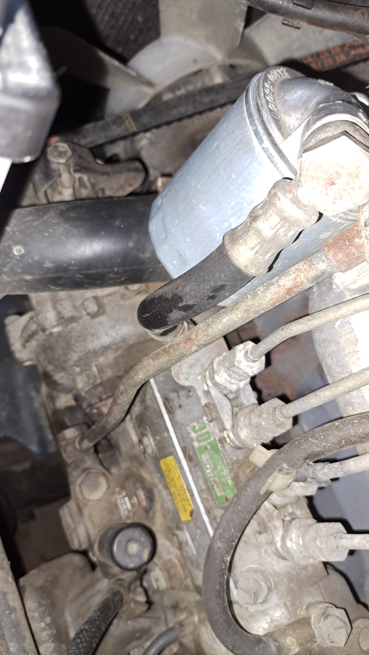

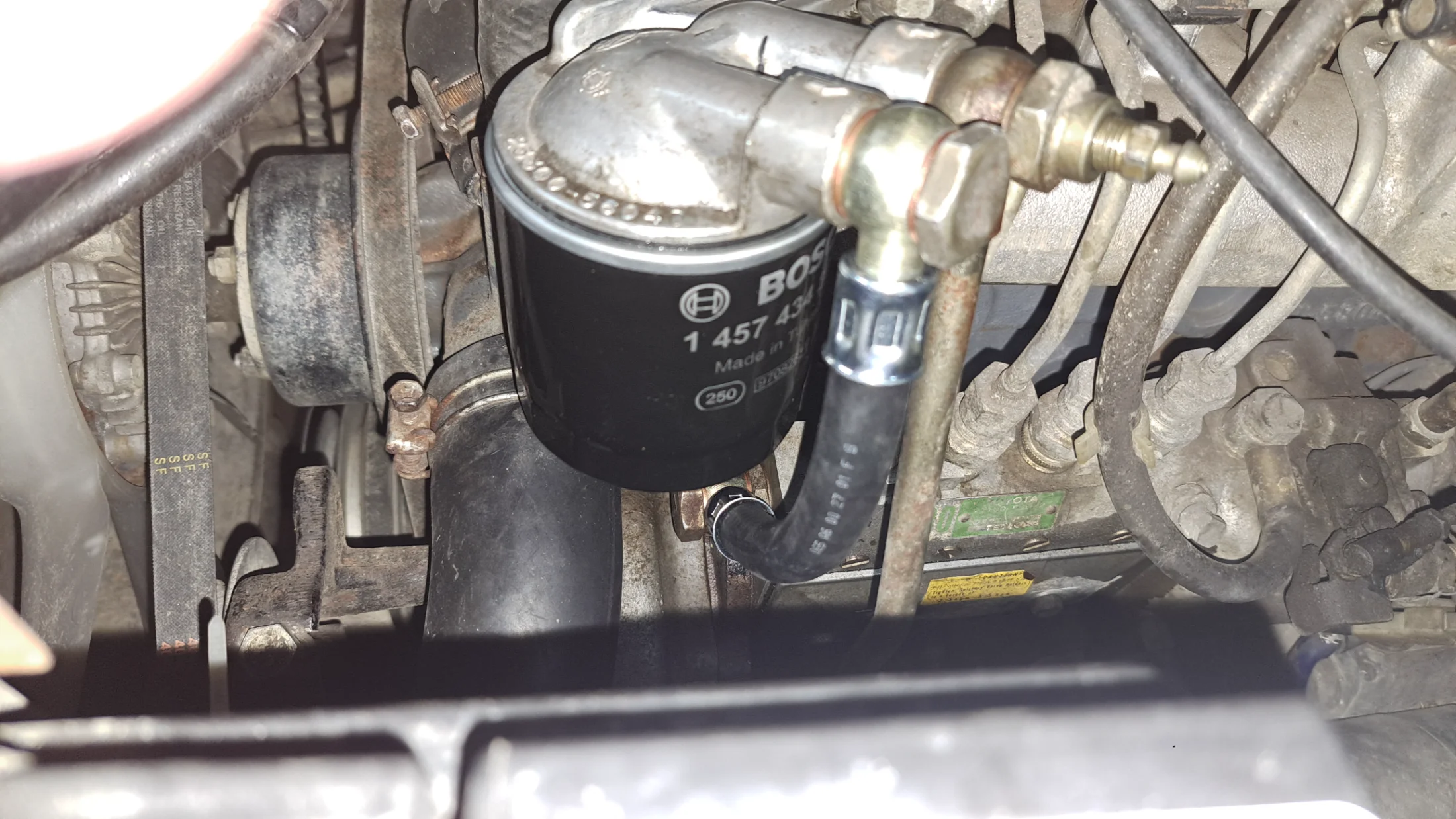

The other day, I noted cracks in the fuel feed line. Not leaking yet, but definitely due for immediate replacement.
Had a local tractor mechanic to rebuild the piece. 20,30€ dead cheap.
Bleeding the fuellines however was a PITA. It ran for 5-15 sec and then it died again.
It was air in the main fuel line from the tank.
Took me ~15 start attempts to get it running.
Should have followed my own advice, I occasionally gave here: Pull through some 3l of fuel with an external pump until it runs free of bubbles, then reconnect without letting air in, then prime and bleed fuel filter. Would start right up. I need to get a new external pump, as my old one died. Back in business is what matters.

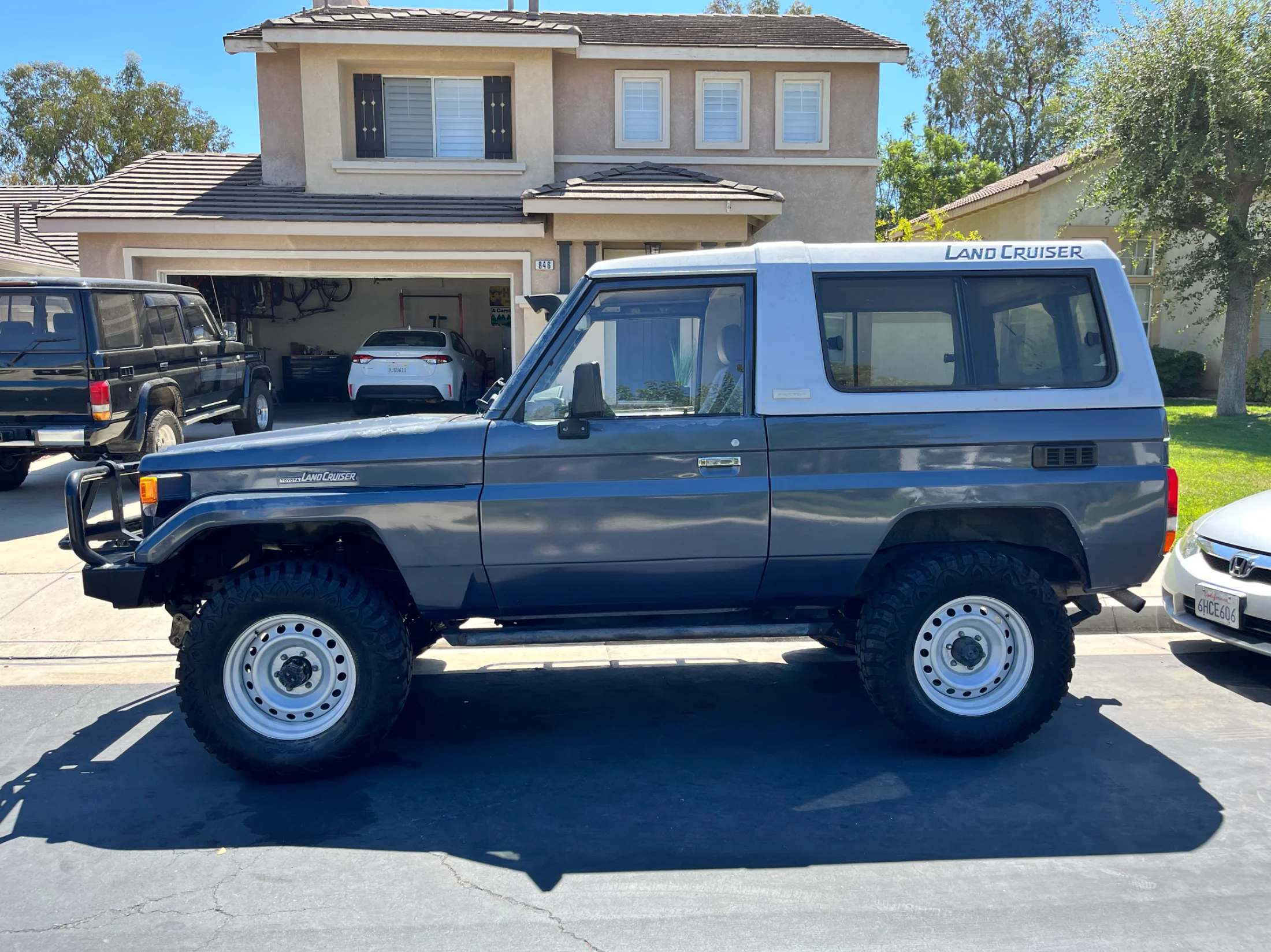

Got some new wheels for the bj74 project aka patina turner.
Truck came with 75 splits basically as rollers. Cool looking but too narrow and don’t want to run tires with tubes.
I was on the hunt for fj cruiser steelies specifically since I’ve always loved how they look on 70’s especially in silver.
Found a guy local BUT he painted them bronze. No biggie since I was doing silver anyway. Couple cans of vht and she’s lookin good.

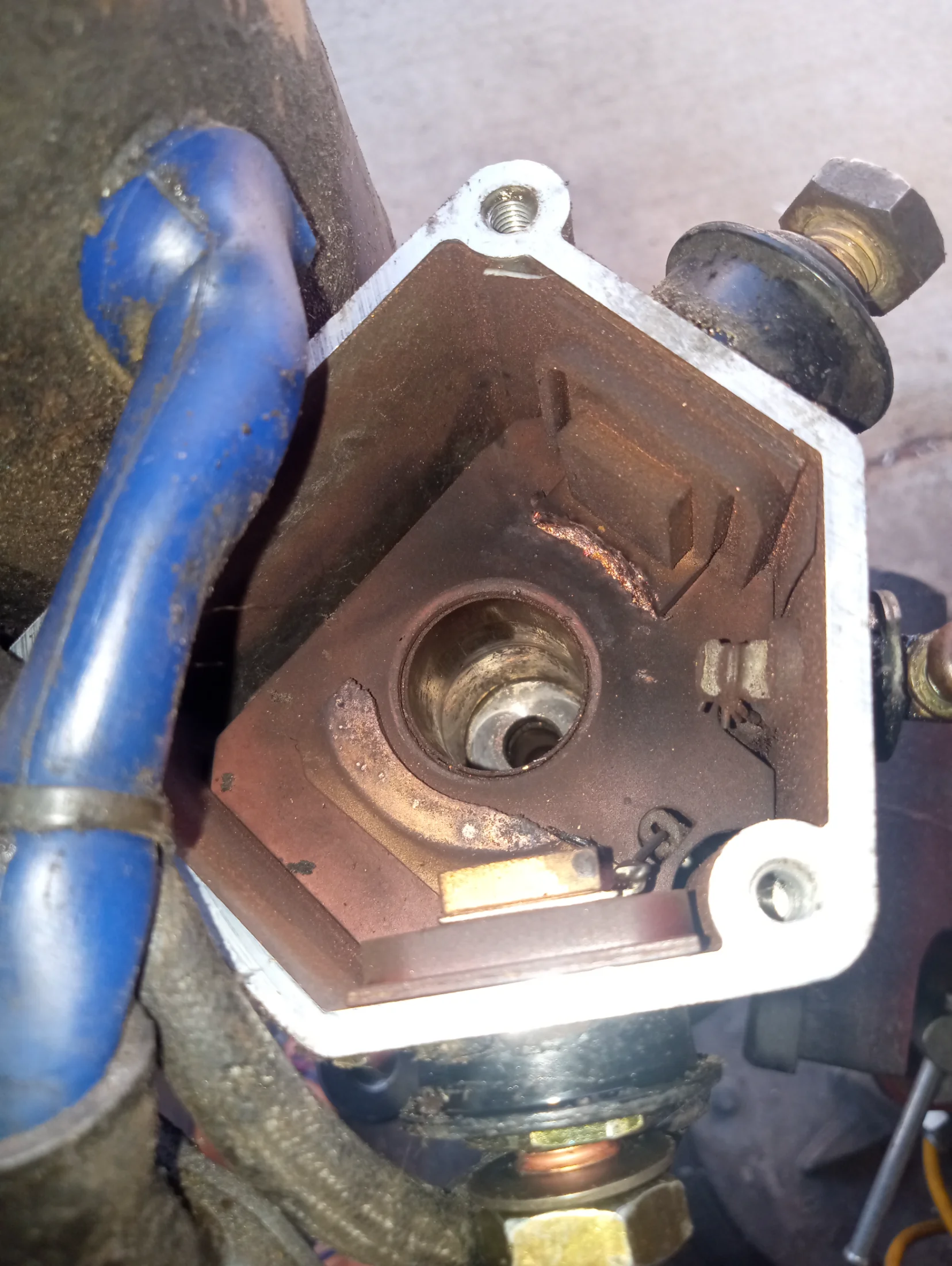

Got to have my wife pull me out of the fuel island at the gas station. Was able to pop the clutch and start it once I was rolling.
Thought I need a jump-start, had a jump pack, that didn't work, tried jumper cables to one battery and the jump pack on the other, nothing but a 'click'.
Turned out the starter contacts were stuck and subsequently fried.
I had a spare 24v starter on hand, different configuration than mine, so it won't fit, but was able to rob contacts and plunger out of it to get me back up and starting while I look for a rebuild kit.
