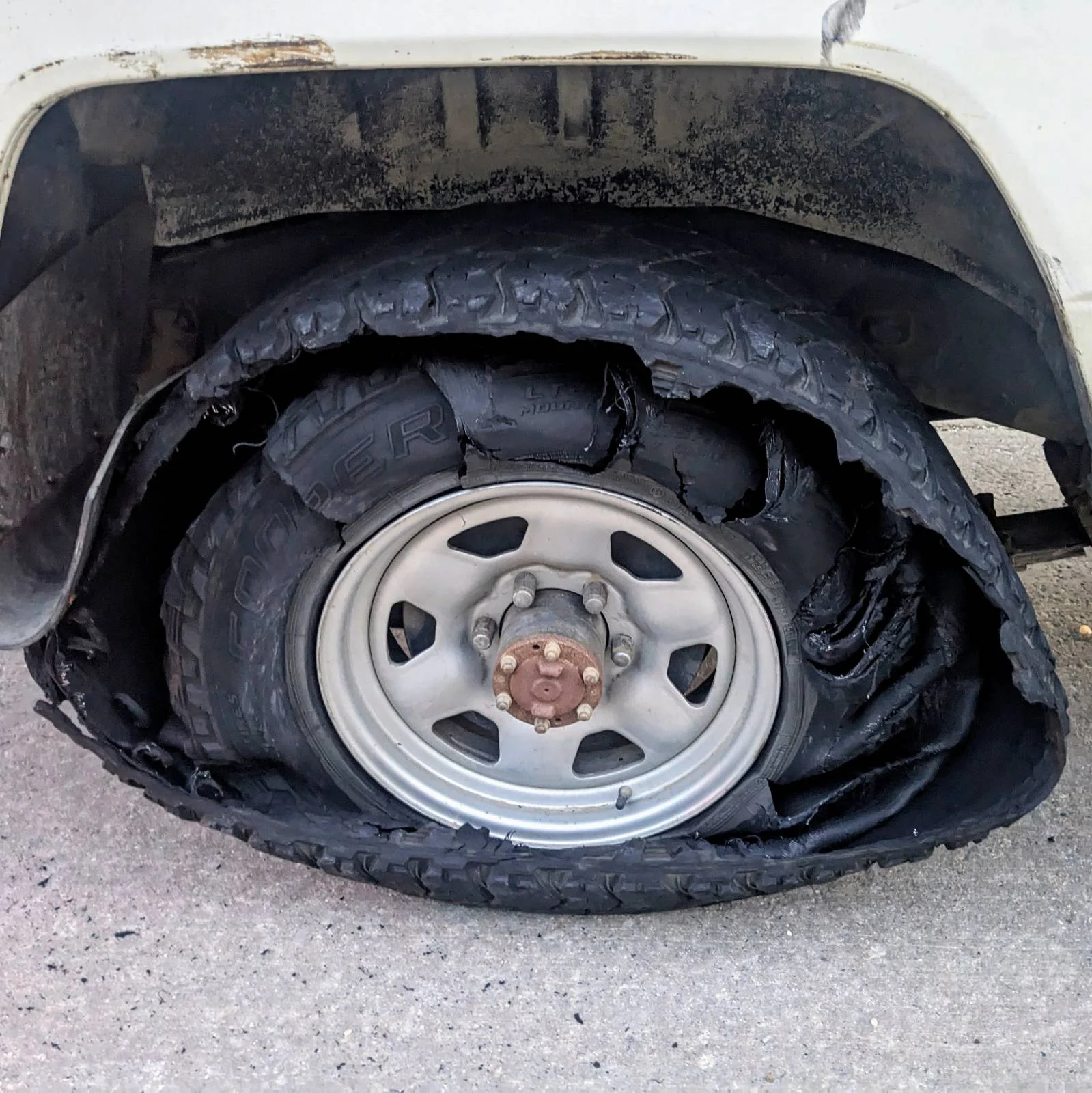

I was definitely not treading light that day. I had food, water, shelter and gear for a few people to be off-grid for a stretch and was definitely carrying a heavy load, and doing so on a curvy mountain road.
I don't know what pressure that tire was at. I had buried my tire tools under the rest of the gear and then the kid at the first gas station couldn't figure out how to turn on their air. I resolved to check the tires at the next stop.
I didn't make it that far.
That tire failed from heat. Not sure why though. Maybe it was low from the start. Maybe I picked up a nail. Maybe Coopers explode at middle-age.
When i did unload my gear and check my tire pressure on the side of the road, the others were at 35. I inflated all 4 to 50psi and didn't have any other problems.

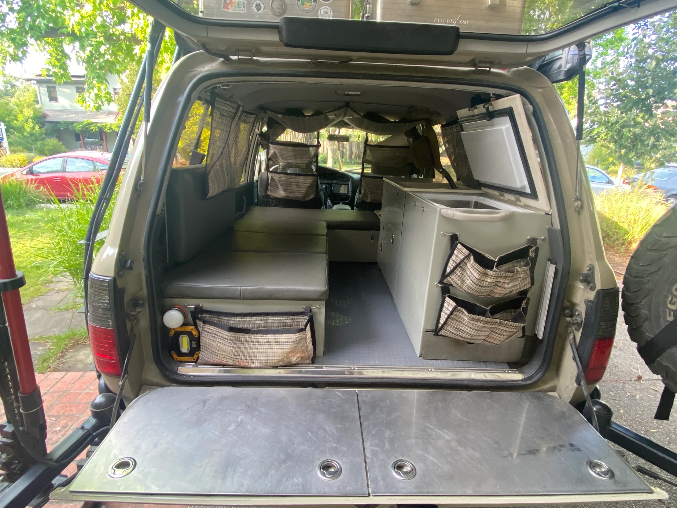

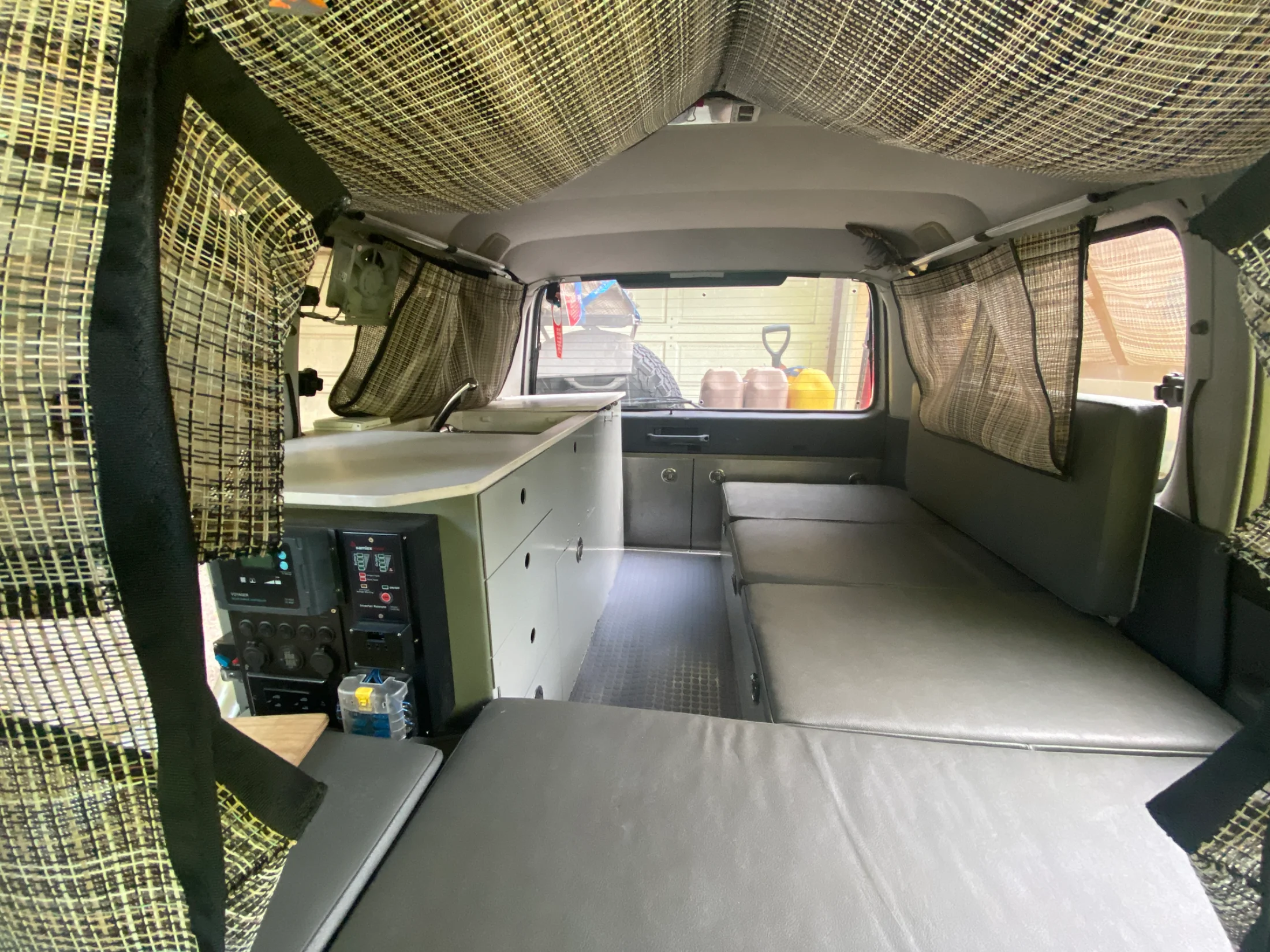

It is 32" wide. I don't need any metal under the cabinets. The build will be similar to my 80. All metal construction. Frames are 1/2" square steel. Cheap and light. All you need is a welder and a grinder to hide your ugly welds. Galley on the right side and a bench/storage on the left that opens to a bed so 4 people can sleep inside. The reason for the aluminum sheet, I like to have the floor flat and not wavy. Wife architect... First 2 photos are our 80.
View attachment 3989644View attachment 3989646View attachment 3989647View attachment 3989648
Ofer, how high is the bench in the 80, and how thick are the cushions? Thanks
I have not started the bench just the wheel well part. I'm thinking 10.5"-12" high + 2" cushions. The cushions are custom made with 18 oz gray cotton canvas with hard foam. I'll have seat covers made from this material as well and a dash cover.
The 80 is 10.5+2 but the troopy has more head room so I’m debating.

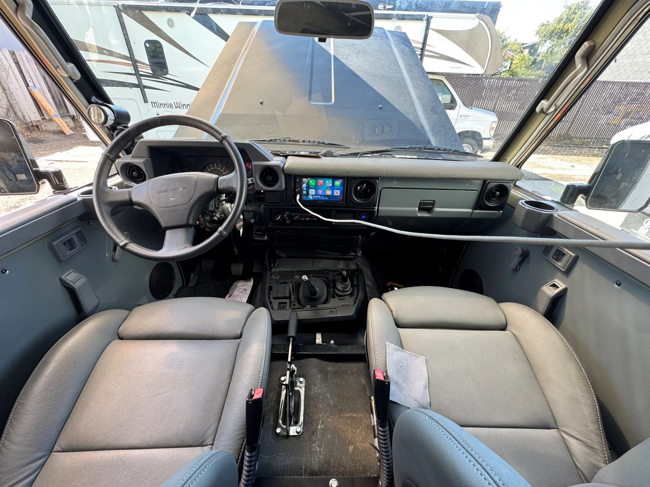

Thanks to @orikawa I have the door cards installed. Thank you Spencer. Love the way it looks. Now I have CarPlay® so can listen to podcasts while working.

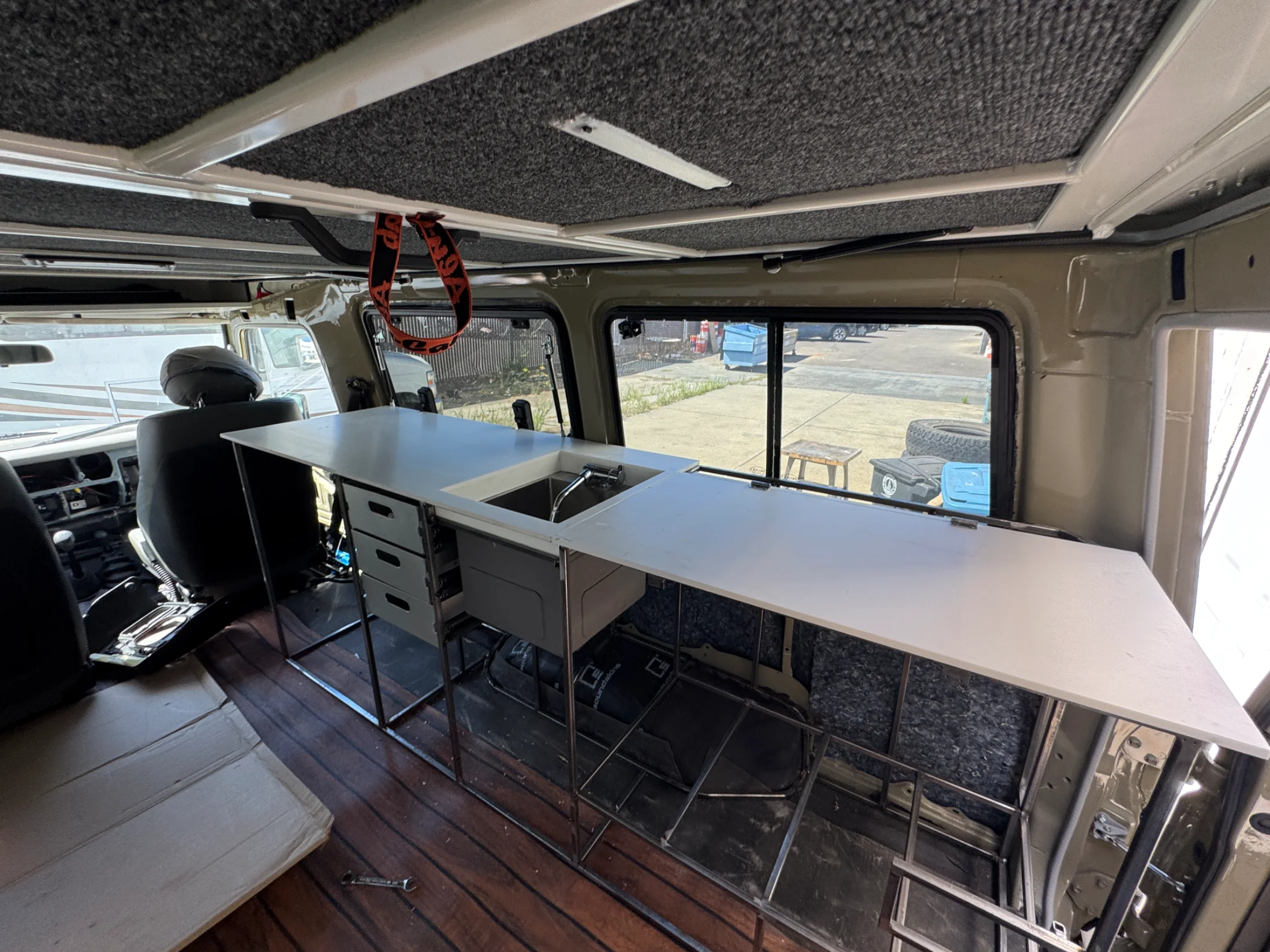

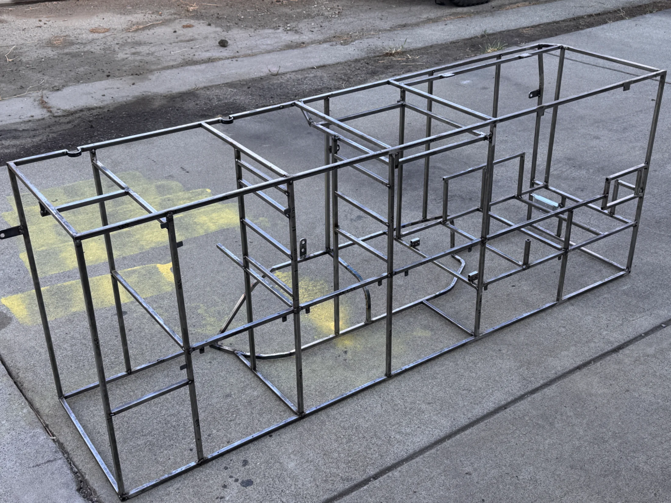

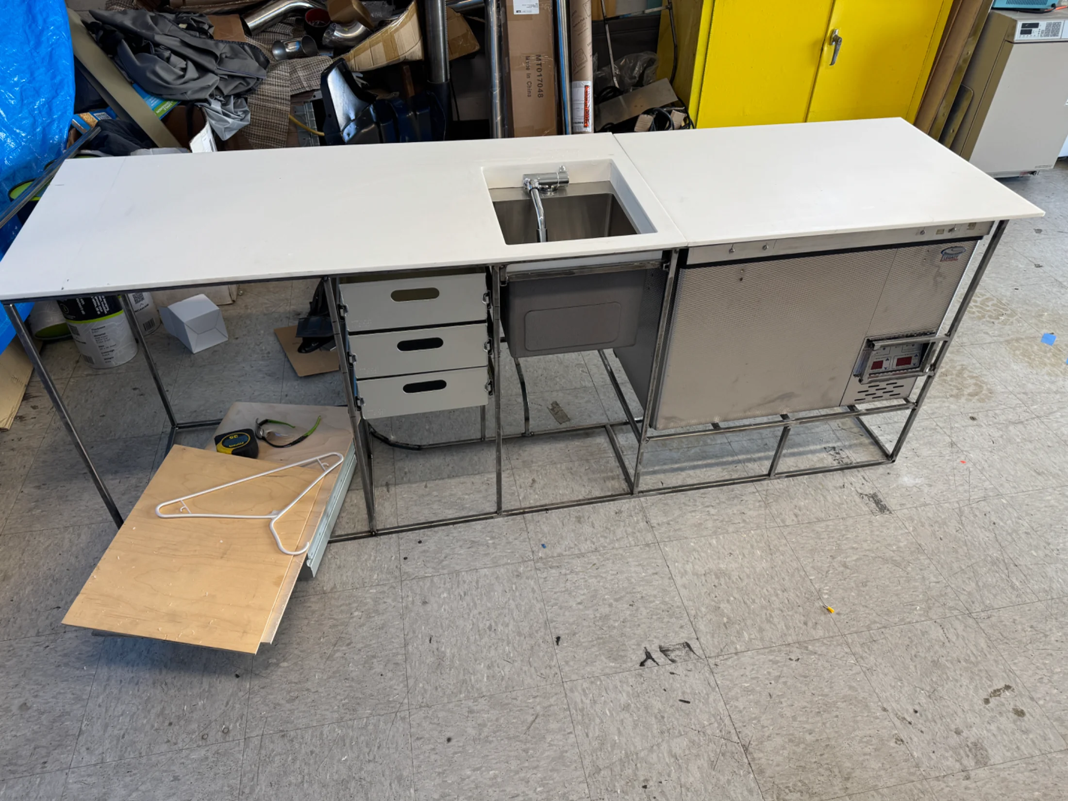

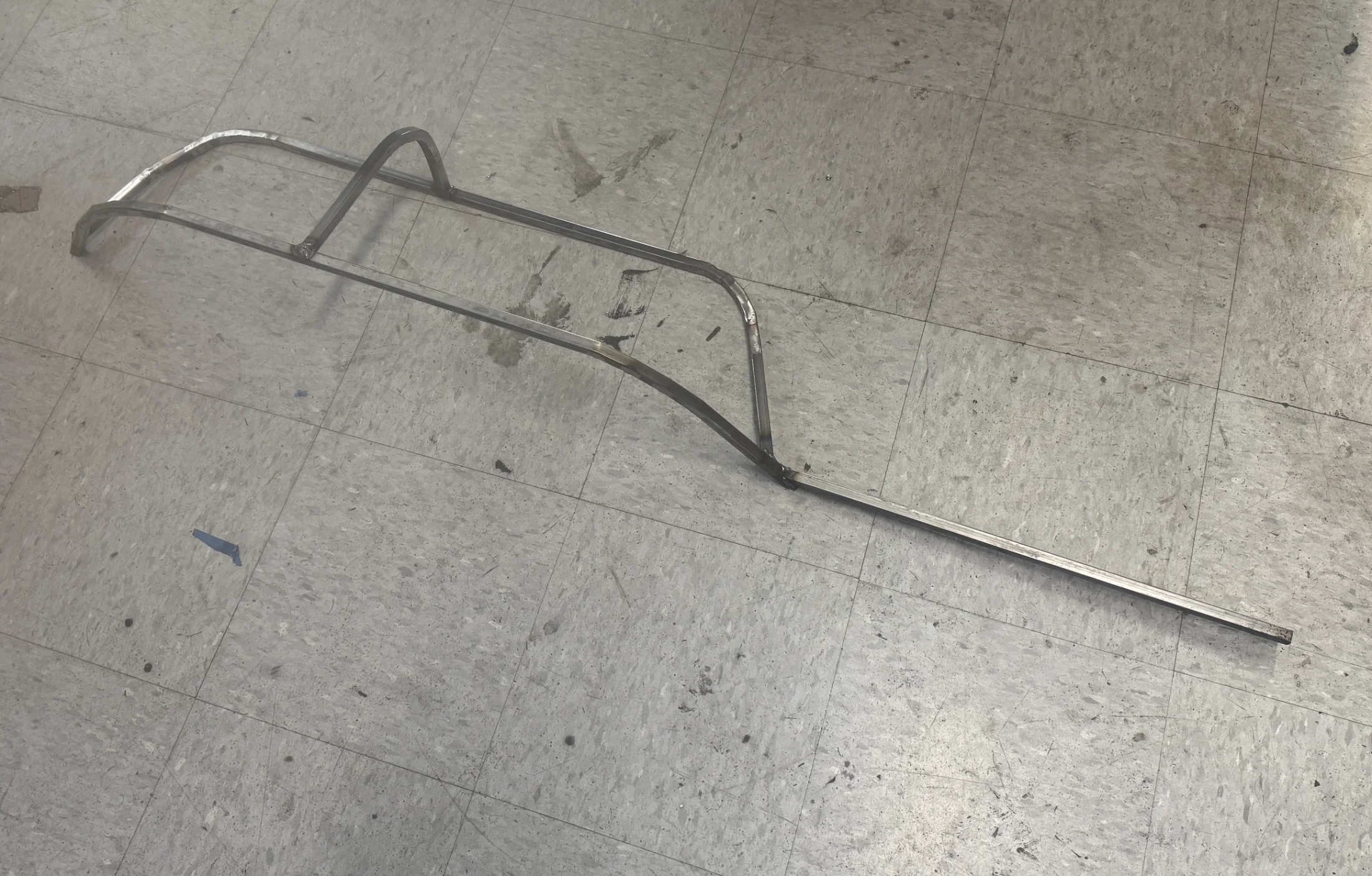

finally found time to finish the frame of the gully. Next it welding sheet metal, and ordering the 0.080" aluminum panels for all the doors. All piano wire hinges have #4-40 threaded holes in the frame. Size of the door panels is written on the frame in mm. The tabs in the openings are for locking the doors with magnets. Hope that works to avoid installing latches. The far bottom has a 110V electrical box. I need to weld one across in the front section as well. Total cost of material $130 and a few hours of work :D.
Frame weights 43lb. Sheet metal about 30lb and counter top 30lb. With the drawers and sink painted I am estimating 130lb. Fridge is 55lb. My goal is to get less the 200 lb when it's all done and powder coated inside the rig.
