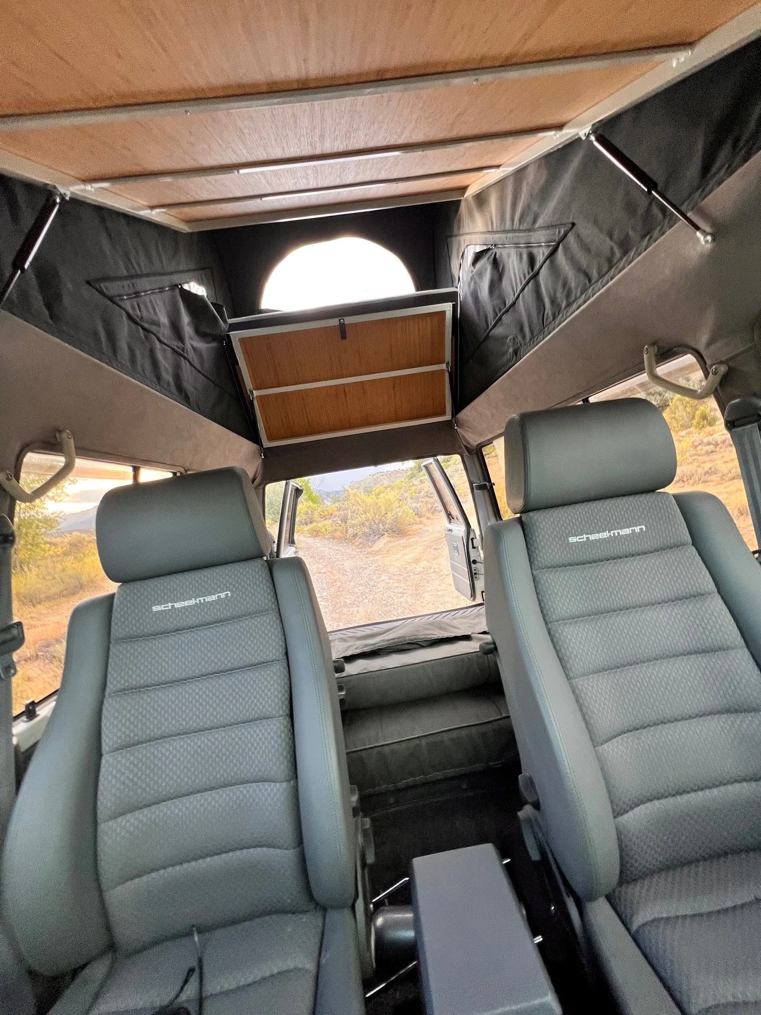

Yeah. I think he has some exterior shots posted up on his social media. He did a great job and am pleased with the outcome. My original plan was to do the removable option but decided in the end to go all the way.
Oh. Wow! Just spied the Insta images. Looks great! Congrats.
Eric does fantastic work. His pop up roof and interior setup is just a work of art but extremely practical as well.
Yeah his work is fantastic. I admit I was nervous at first. When he showed me some of his other work in person I was willing to go all the way instead of just “clamp and camp”

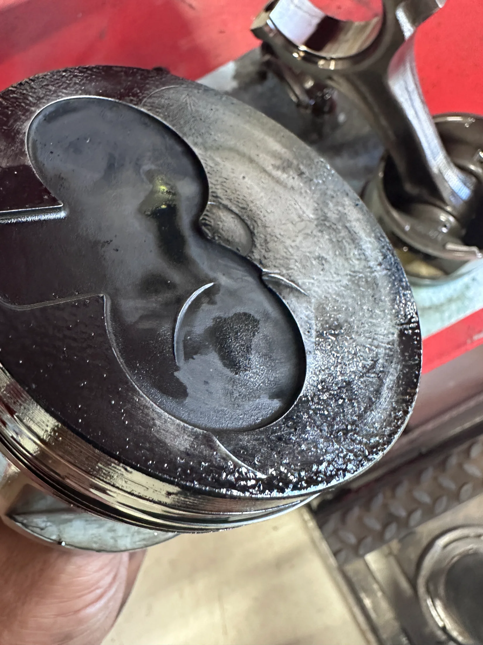

What happens when you get a mechanic who dos not know how to time a 1HZ….
Boom!
Valves smashing into pistons.

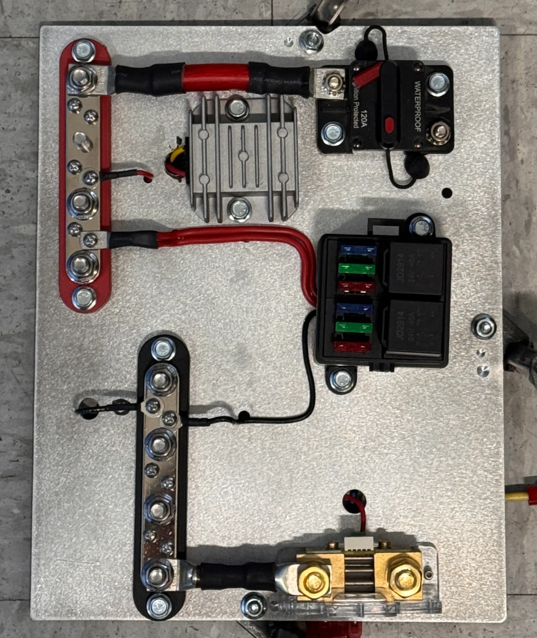

Distribution panel is done. System is 24V (LiPo 29.6 nominal) and running max 100 A to the inverter at max output (which rarely happens). The hydronic diesel heater is 12V (4A) so it was cheaper to buy one for $1200 and a $20 DCDC instead of buying a 24V for $2800. Most function are low current running directly from the switches. The only ones with relays are the fridge and the heater. All this will be powder coated black (Cardinal BK208).
My thoughts that no more then 2 wires come out of each battery terminal, one to a distribution panel.
