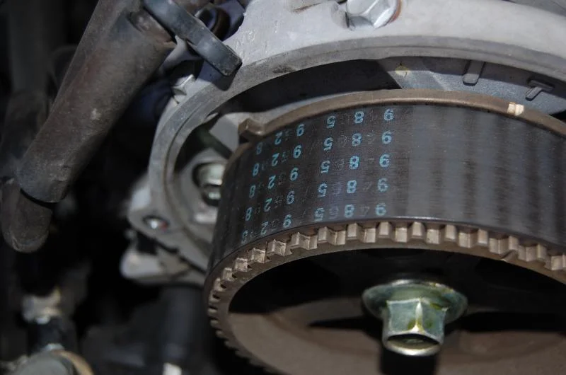

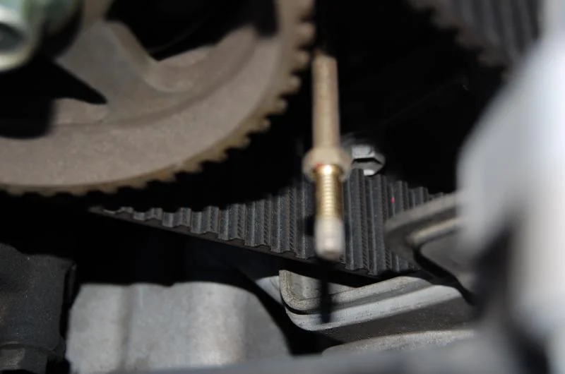

UPDATE with Pics
looks like a new belt was put on and hopefully a new water pump too. I will monitor for leaks. The pass cam cover was pretty easy to take off less than 30 min. I also cleaned the throttle body too.
Comments anybody?
Yeah - not scientific but that belt does not look like it was original so looks like you're good. Mine at 90k had all the lettering completely worn off. Ideally you'd get a lot done at the 90k service including Timing belt, water pump, thermostat, idlers and tensioners (for timing belt and drive belt), drive belt, cam and crank seals. I believe the TB is the most important and given your situation I'd wait for the 180k and go to town on that TB job. Unless of course you're paranoid, money is not an object, etc.
