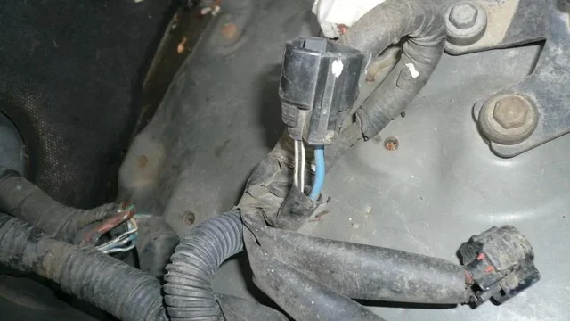

Anyone know what these plugs are used for? They were like this and unplugged when I bought my LC back in 10/11. I don't have any check engine light warnings and seems to be running fine.
These plugs are located passenger side rear of engine bay. Thanks in advance.

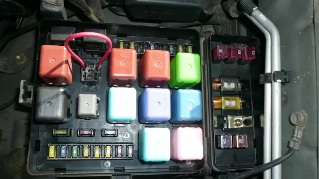

actually this is a good subject. if you dont have ahc this is a good place to mount a compressor or something. if you run a jumper as in the pic (use a thicker wire this is just to show) you will then have a 50amp circuit on the white/black(ground)wire and blue/black(12v constant). the 50amp fuse should already be there under the smaller fuse cover to the right.

Fine - What Bawlz said it's for AHC.
