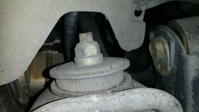

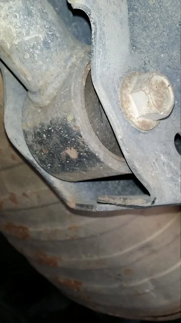

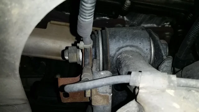

Took the '99 LC to an LC specialist today for 2nd opinion re. steering rack slow seep. It's on the pass. side boot. They said it's not a rush to swap out the rack. Yesterday dealer made it sound imminent. Oh: LC shop quoted $1,000 LESS than dealer for OEM P+Labor. Yowza! $900 all-in.
Interestingly, while the car was raised I pointed out cracked control arm and other bushings - mechanic said not to worry, it's "topical" and wouldn't effect the inside of the rubber where the insulating was happening.
Though not a mechanic myself, it seems common sense would say if it's crackled-looking on the surface it's a fairly worn bushing throughout. Esp. 'cuz of my symptoms: car bounces a lot (needs shocks), clatters over bumps bad, and leans. Sorta like a creaky boat.
What say y'all?
Photos attached...
swap out soft parts or stay cool and just fix the rack?
Loving hearing people's reports of improved rides, super encouraging.
More bushing and boot shots for grins - not sure on a scale of 1 to 10 (10 being best) how bad these look, compared to other LCs out there, and among you who have swapped yours out?

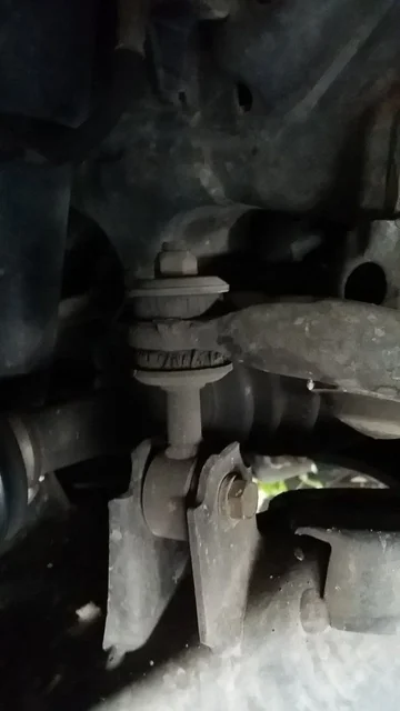

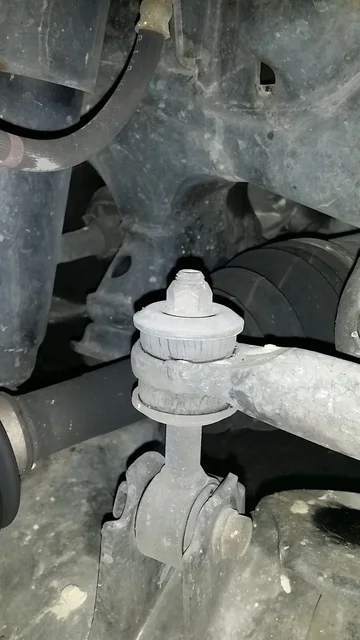

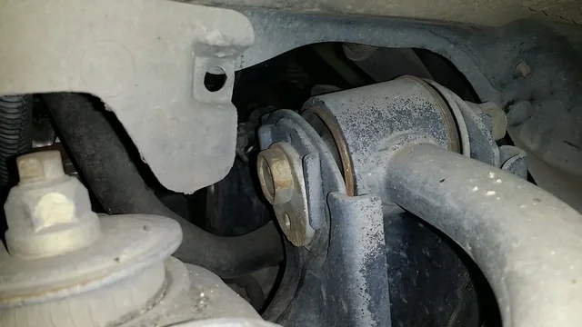

not a pro at this photo attaching thing yet...
More bushings! Sorry if I'm boring you! Who knows, these may make a useful conversation continuer for us...20150401_141527.webp 20150401_141533.webp 20150401_141555.webp 20150401_141711.webp 20150401_141527.webp
@CA Cruisin
FWIW, those look pretty much exactly like most of my bushings before I replaced them. It has made all the difference in the world. Things are way tighter and more precise, squeaking - gone, metal on metal sounds -gone.
Replacing bushings/ball joints is pretty dull work, but it's way less frustrating than chasing sounds.
When I got most of mine out, they looked pretty bad all the way through. But then again I'm at 270k miles, and between South Dakota and DFW, not the best combination of environments for rubber.
