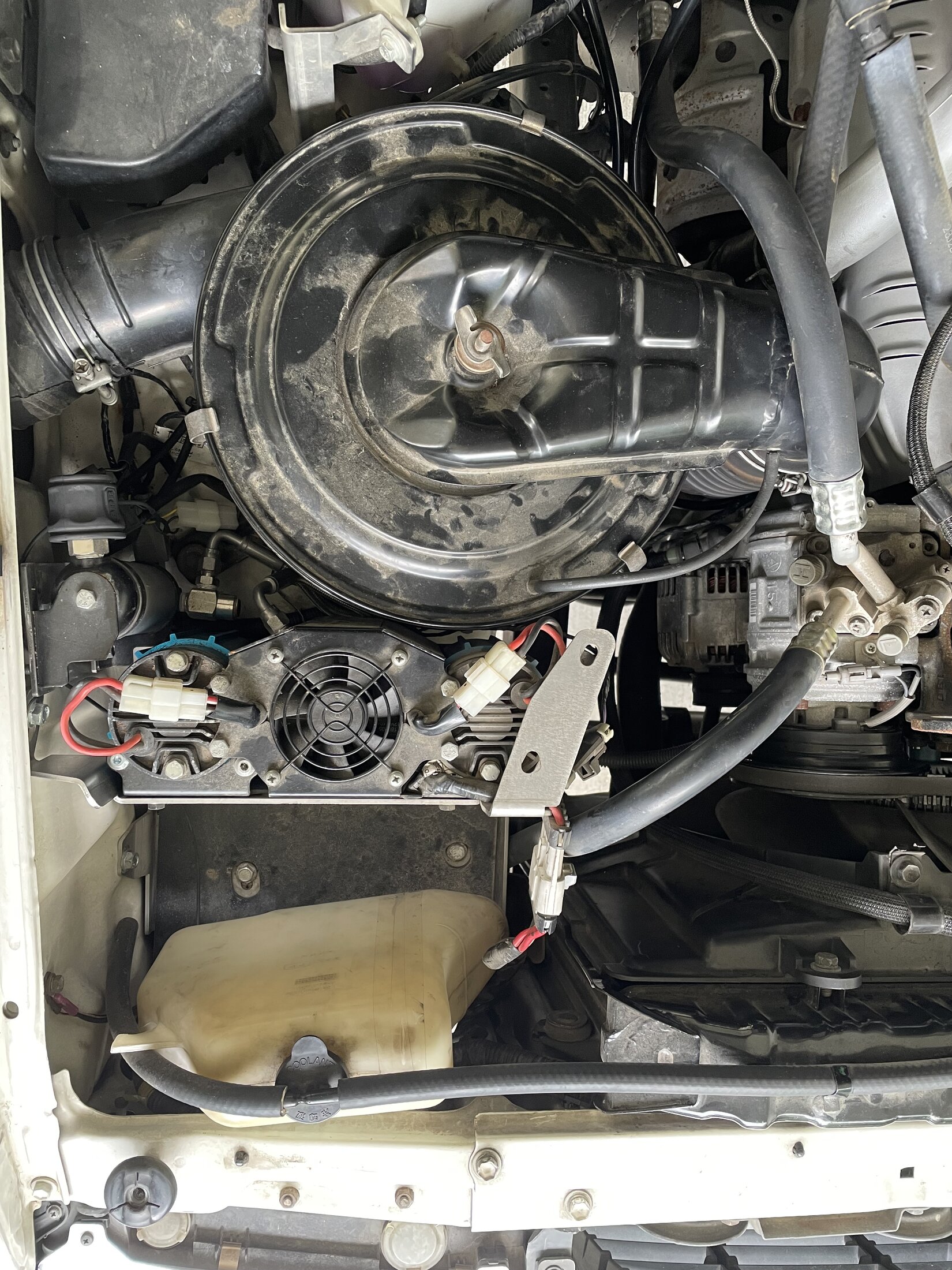

I have a U.S. spec. 80 series that is 1hd-ft swapped with Slee ARB twin compressor / dual battery tray and washer bottle relocation kit. Not sure what airbox works with this configuration. Any suggestions? I plan on installing a snorkel and PDI front mount intercooler.
Got a pic of your engine bay? I have a PDI airbox and it's a very tight fit next to the battery tray on the RH side
Looks like my issue will be the ARB manifold.View attachment 3915827
Yeah, maybe you could flip the compressor and mount it facing the coolant overflow? and then get creative about mounting the manifold to get some clearance for an airbox.
Also PDI might be the largest - you could look at a Radius or Torfab airbox. I'm sure there are some others too.. maybe Moonlight
