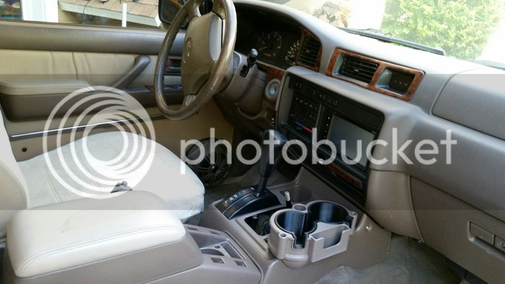

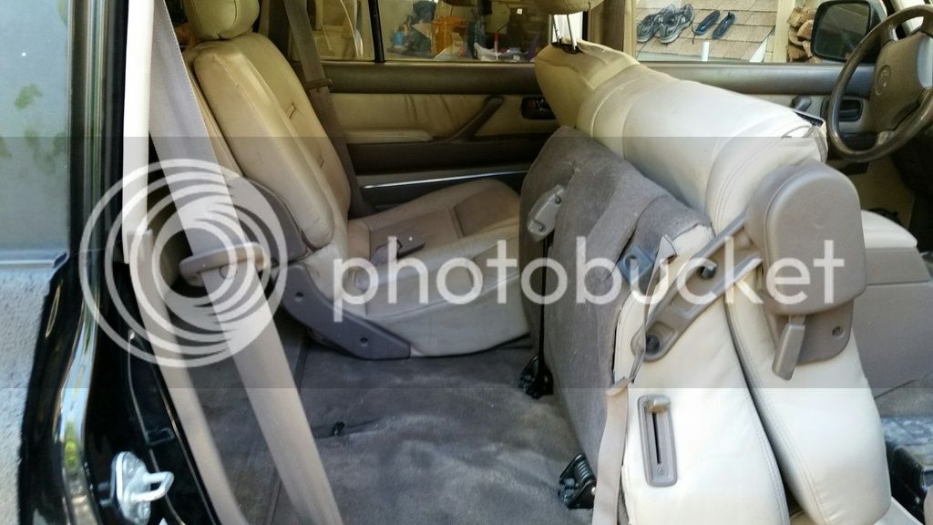

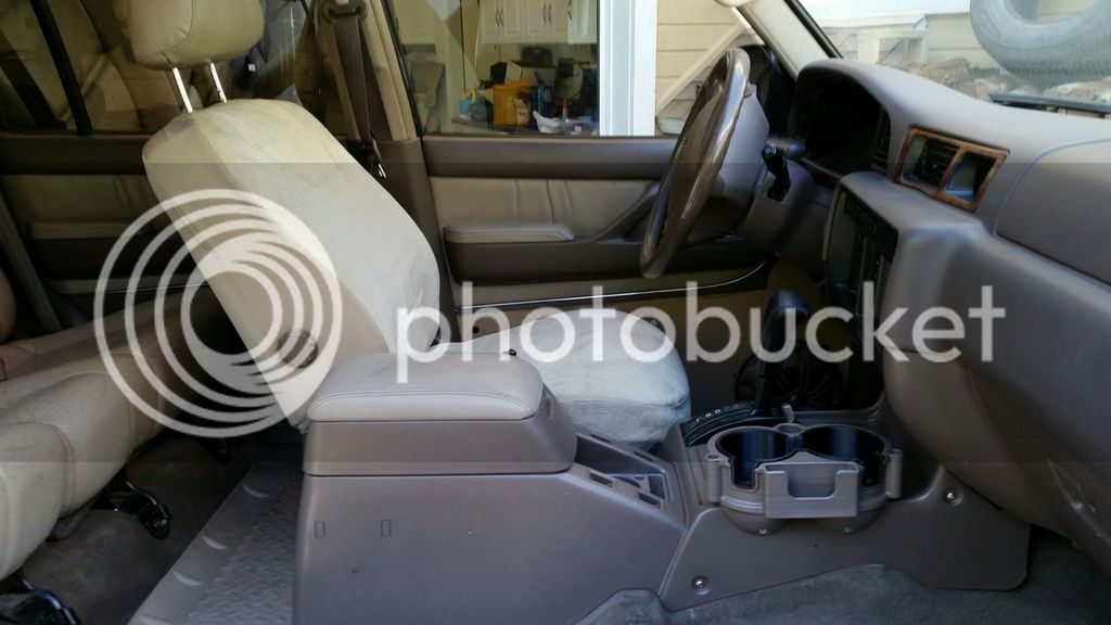

The carpet, interior trim pieces, weather stripping, and seats all got put back in today. The only big component left in the interior is the passenger front seat. The gears are shot and need to be replaced and I figured it would be easier to replace with the seat out of the car. Here's how it looks as of 30 minutes ago. Don't worry parents; I don't drive my boys around without car seats. They just climbed in and buckled themselves in. The car wasn't going anywhere.

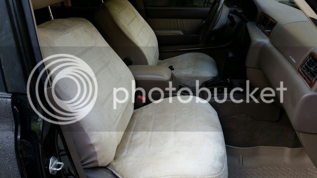

So the new Gamiviti seat gears went in yesterday. I decided to do both seats since I didn't know the history of the driver seat and wanted them both fresh. Sorry about not docuementing the seat gear install but there is a ton of threads on it and we didn't need anotehr. Both are moving front to back very smoothly and quietly now. I also got the seat installed. I finally dealt with the horrible exhaust rattle. The rubber exhaust hangers were done. In fact they were totally gone. They deteriorated a long time ago and there was nothing left. Replaced the front and rear hanger and now the exhaust is no longer rattling on the rear cross member. Tomorrow I will deal with the rattle in both mirrors and get the new 35's installed. I will get some pics with it sitting on it's new shoes soon.

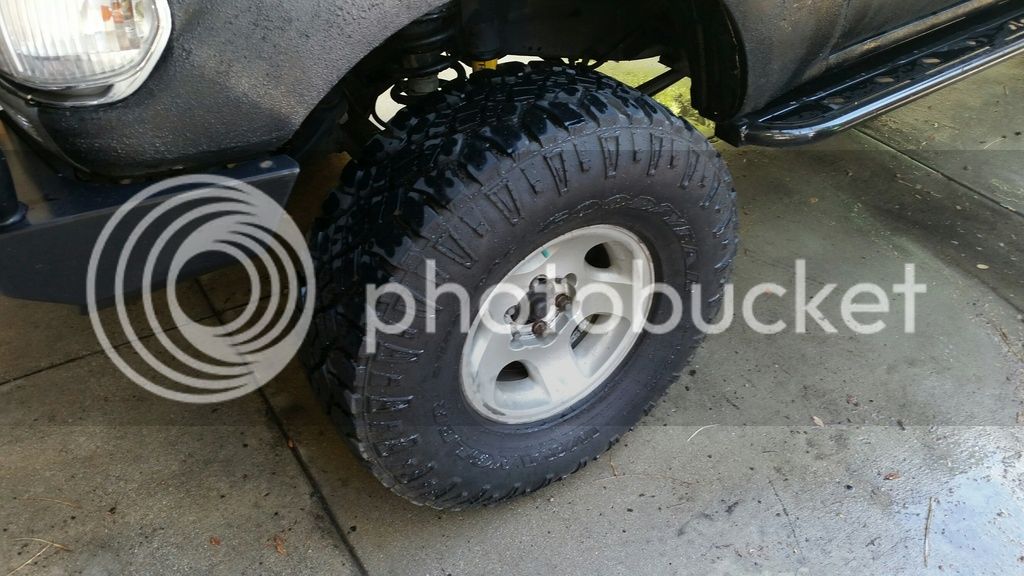

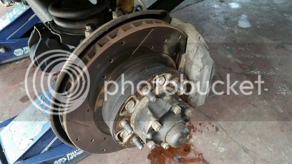

So I pulled the tires today to get the new 1.25" wheel spacers and 35's installed and was pleasantly surprised to see new slotted rotors and 90%+ life left in the high end pads on the front and rear. Way to go Chris!! I got the wheels all bolted up and will get some pics tomorrow. The 35's look fantastic with the OME competition lift and it rides great with the 4.88 gears.

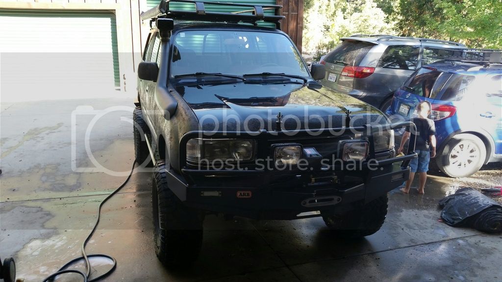

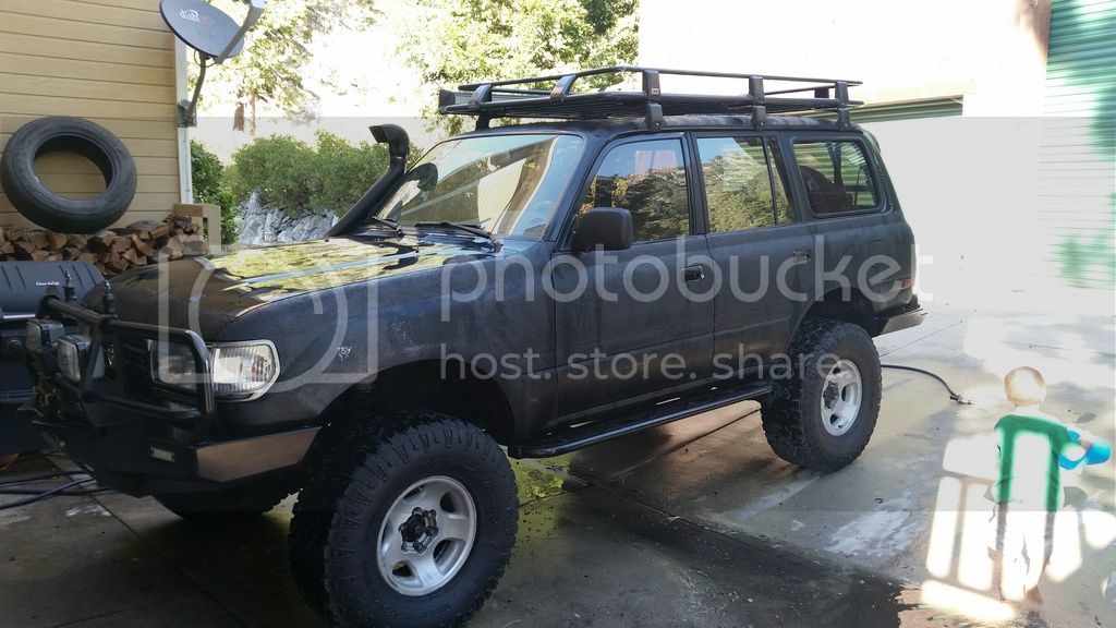

So here is how she sits with the new 35's. Just gave the cruiser her first bath.
Here's my helpers. They were supposed to help me wash the car but they just ended up playing in the mud and getting filthy.

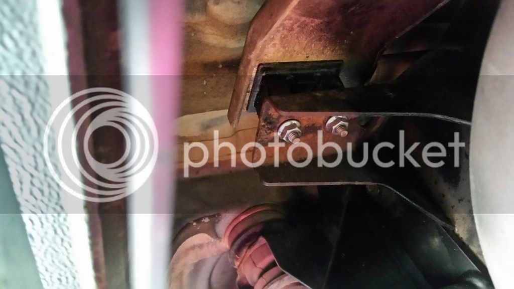

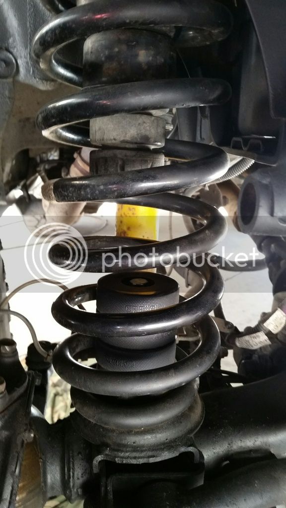

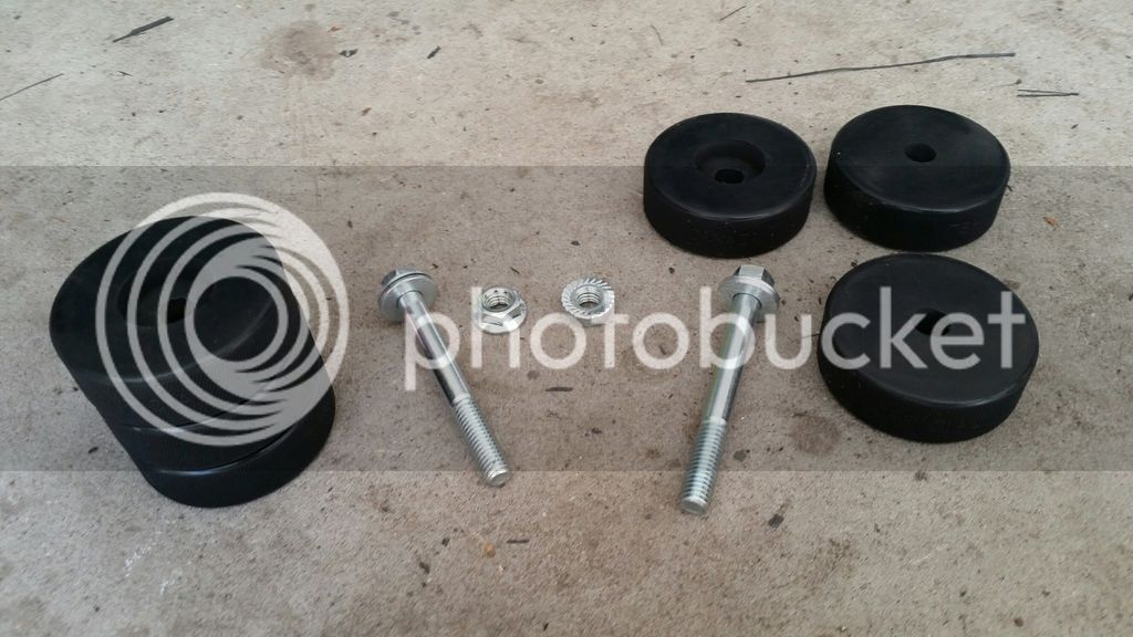

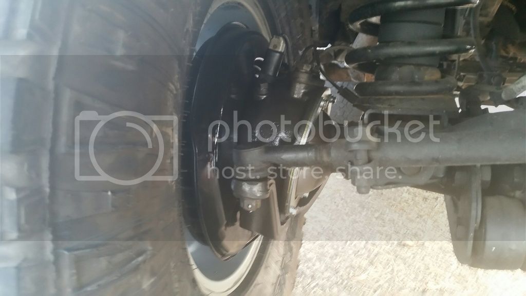

Got my own homebrew front bump stop extensions installed today. The front tires were rubbing at full flex and turning a bit. I had about 2.5" of space between the factory bump stop and upper rubber stop. I figured a 3" extension would be perfect to stop the tire just before rubbing. I have used this style bump stop extension on 3 80s now without issue. Cost about $15 total for the 6 pucks and hardware. Here you go.

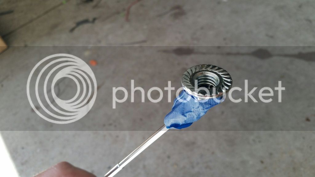

Here is how you have to hold the nut in place and fish it up through the tiny hole to get the bottom nut threaded on. The tape is just there to get the thread stated. Once started I switched over to my 5/8" open ended socket.
Here it is all installed.
This is the tiny hole under the lower coil spring mount you have to fish the nut through

Thank you! I have a couple rink bags full of old hockey pucks. (From my younger playing days) I use them for Everything..... Lol.... And believe it or not, I thought of this same idea! Looks good. Thank you for "verifying" my idea!

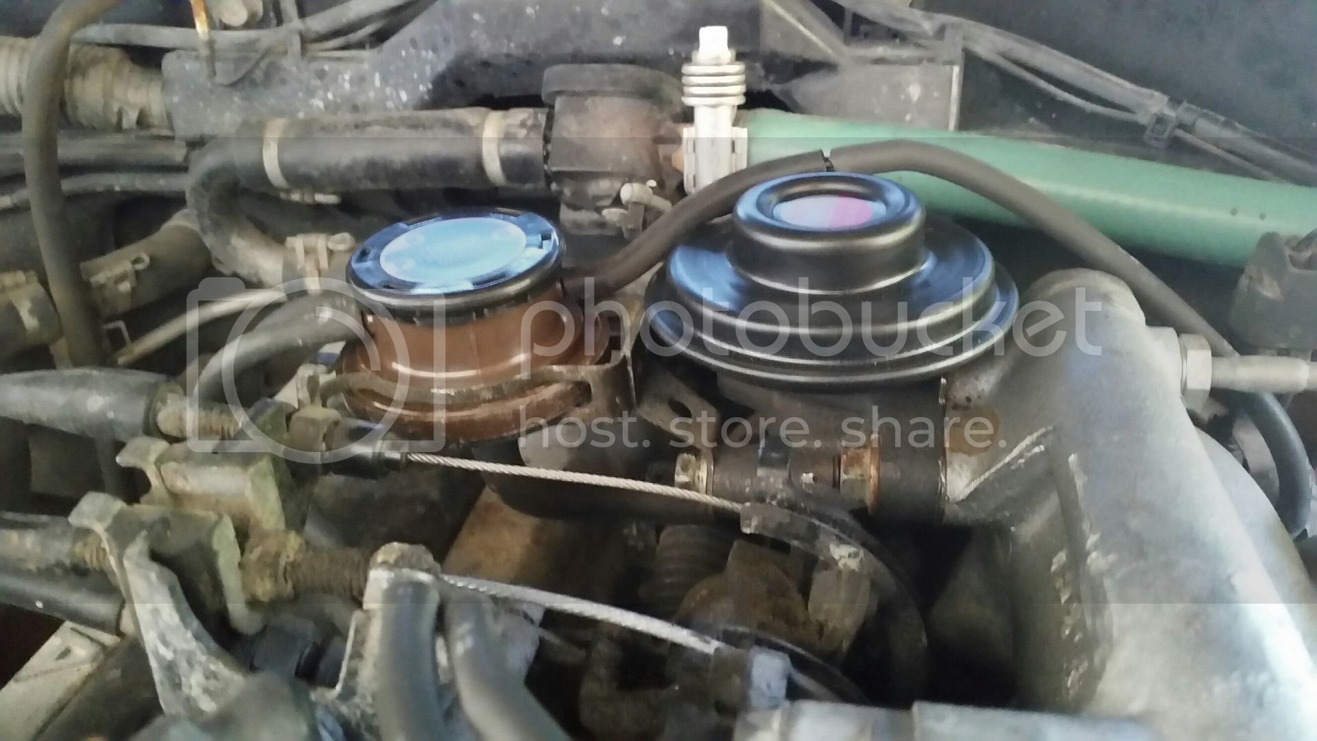

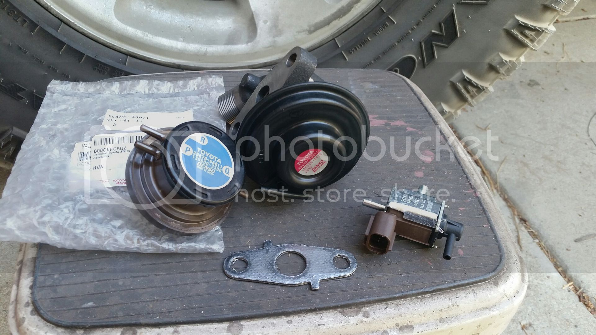

So after failing smog twice I decided it was time for an EGR overhaul. I did the usual steps of cleaning things out and replacing hoses but the damn P0410 code (or whatever it is) kept coming back. The weird thing is that the computer is throwing the code but no CEL on the dash. The light works at start up but the ECU is not turning on the light when it should. That was the deal with the first failed smog. I didn't know it had a CEL and the smog shop looked at me like I was trying to pull a fast one. They informed me of the code and sent me on my way. 2nd failure came when they went through the EGR system in detail and didn't like what they were seeing so again I was sent packing. I'm getting really sick of this smog crap in cali. Hopefully 3rd time is a charm. I cleared the code last night and have now driven almost 80 miles with no returned code BUT the system has still not reset. Hopefully a few more miles and the system will reset and the CEL will not return.
So I ran the 80 for 70 miles today with my code reader hooked up an no CEL. Looks like all systems are back on so I will try for attempt #3 on smog tomorrow. While I was killing time with the kids today I decided to try to use the 80 in a new way. The boys wanted to get out the pellet guns and BB guns for some fun. No worries folks the big boy guns will be out when my little ones are bigger. These are just BB and pellet guns. Although my Walther does shoot just over 1200 fps and is crazy accurate which is super fun with the squirrels. I let the boys use the tail gate as their little shooting platform. They had a blast getting the scopes dialed in. I set the targe at 40ft. The 6 year did pretty good. The 4 year is getting there. Looks like were ready for out coming camping trip. For the shooters out there, I know the youngest has a crazy grip. I'm working on it. He's right handed but left eye dominant so he wants to squeeze the trigger with his right hand and look through his left. It's a mess. Hopefully we will get it straightened out before the real fire arms come out.

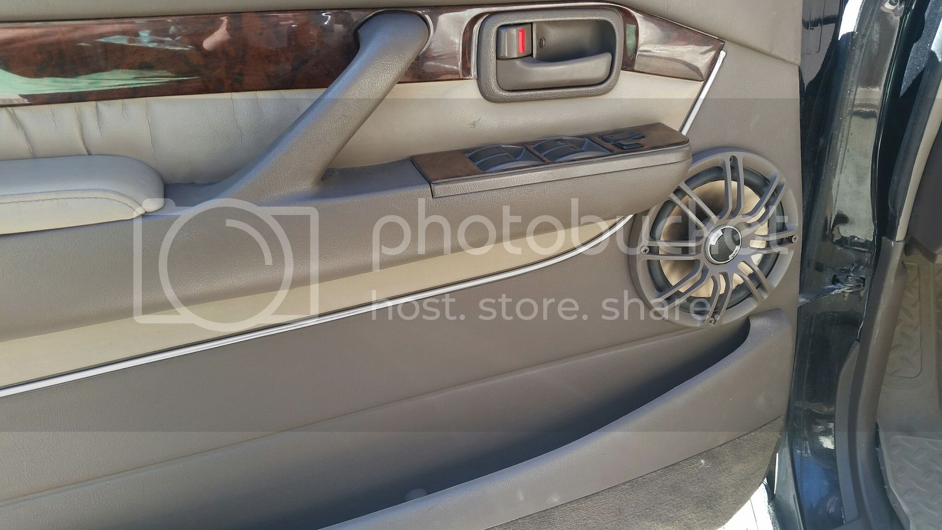

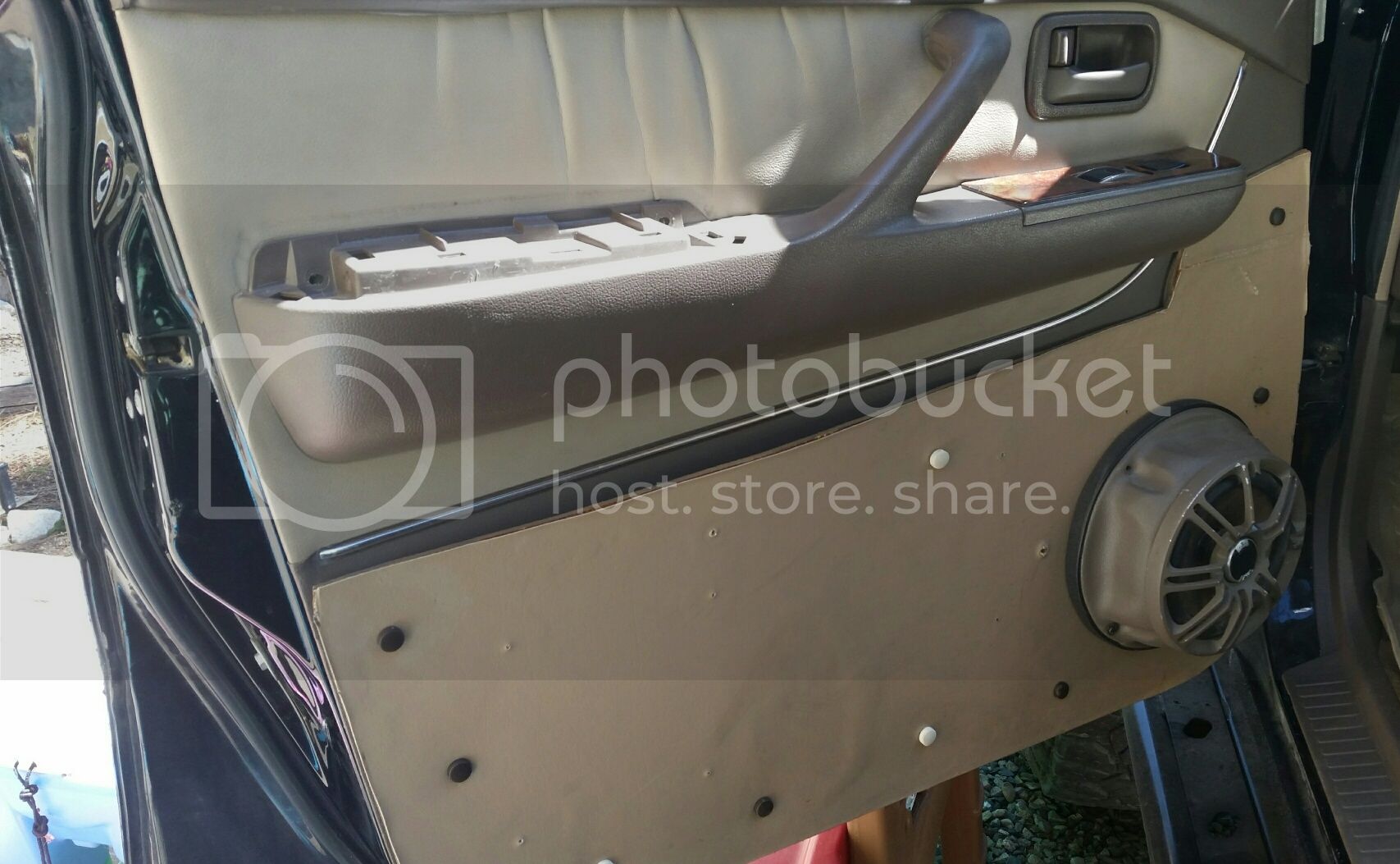

So today was set aside to finish up the door panels Chris started but never finished. He was running into a challenge of getting these larger deeper speakers to fit in the doors. Looks like he decided to just make his own panel and move the speaker further out on the door mounted onto a large universal spacer. It allowed the window to clear while going up and down BUT was driving me nuts since it kept rubbing on my left leg while driving. I decided to tear the door panel off and see what type of clearance issues Chris was dealing with. I realized I only needed a little less than 1/2" of clearance to make it all clear. Fired up a 3D printer and made some 1/2" shims that go into the door. I reinstalled a new (to me) door panel (since the old one Chris cut all up) and then reinstalled the speaker without the huge spacer. Everything just barely cleared. If Chris would have had access to a 3D printer this is probably the route he would have gone. There is just no spacer out there that is the correct diameter and depth. My spacers were a little off so I had to do some grinding and sanding and more drilling to get everything to line up but eventually it all lined up perfectly. Now it looks way more stock, has more clearance for my leg and zero interference issues of any kind. Hopefully Chris approves.

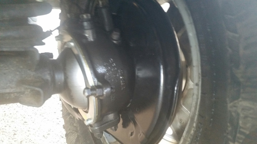

Just got the 80 back from YotaMasters in Corona, CA. They did one hell of a job. Had the birfs completely redone, with all new parts. Had a new pinion seal and flange installed since I had a tiny leak. Also had a few other drivetrain items done that I didn't have time for. They even surprised me with a new coat of paint on the birfs and extended diff breathers at no extra cost. They were almost $200 less than the dealer for the axle rebuild and did a WAY better job. I went with some OEM and some trail gear components. Basically I upgraded if i felt like Trail Gear was an upgrade. Don't really want to get into a debate on Trail Gear axle components vs. OEM. Sorry for the crappy pics. My 6 year old insisted that he take the pics.

Nice to see these installed. Chris and I traded these panels for his 2 inch emu springs. I had a rolled 80 that I saved the chassis for another build and didn't need these and wanted the springs. These panels came from a 1997 LX450. The rolled LX is an American truck although we did have Canadian spec models.
That means these panels originated in Japan, went to the US, went to British Columbia, went back to Montana and are now in California.
I think he wasn't happy with his mods on the original panels and was relived to get mine to start again
But its sounds like he cut up the ones I traded to him or did you source them yourself

Those panels came with the truck. They were the ones Chris was planning to use to redo the door panels. They were in excellent shape. I didn't know how he planned to fix the door panels so I just used what he had and made it look as good as I could. They are the LX450 faux wood version, but that doesn't bother me since this 80 has the faux wood interior anyways.
Then you have my panels and I'm glad they're in use - Chris got them to replace his home made versions and the panels you took off look like what I remember seeing when we traded.
They really have traveled the world
