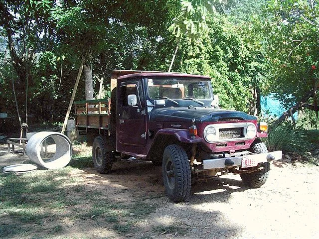

Here are a few more pics and an HJ45 my friend in Costa Rica owns just so the mods don't throw me out.
