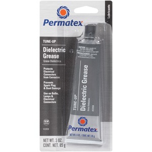

Dielectric grease is the easiest probably most reversible method of improving water resistance/decreasing ingress. That's what the grease caps for sprinkler wiring are. A little bit on the existing seals on the Toyota connectors should help a lot with those. I haven't pulled apart the actuator so I can't speak to that, but I'll definitely be interested to see some ideas! Obviously there are tradeoffs with water proofing versus serviceability, and I personally want to preserve serviceability. So for me, the most reversible but still effective technique wins out.
I agree that maintaining serviceability is priority. Im thinking more for sealing individual parts rather than the combined parts. I mistype, the part that I shorted out is a "transfer shift actuator." From the dealer it runs $1500 and from my understanding it is none repairable. Fortunately for me, I was able to find the part on ebay for much less. Assuming no one with electrical experience posts anything in the negative for waterproofing, I'll likely apply something to this part. Thanks for the suggestion of dielectric grease. I'll look into it.

I didn't know the GX470 was waterproof for fording. Dielectric grease can help on connections. When I installed radio equipment for emergency services, we would both crimp and solder any ground connections, as this would remove one corrosion source.
