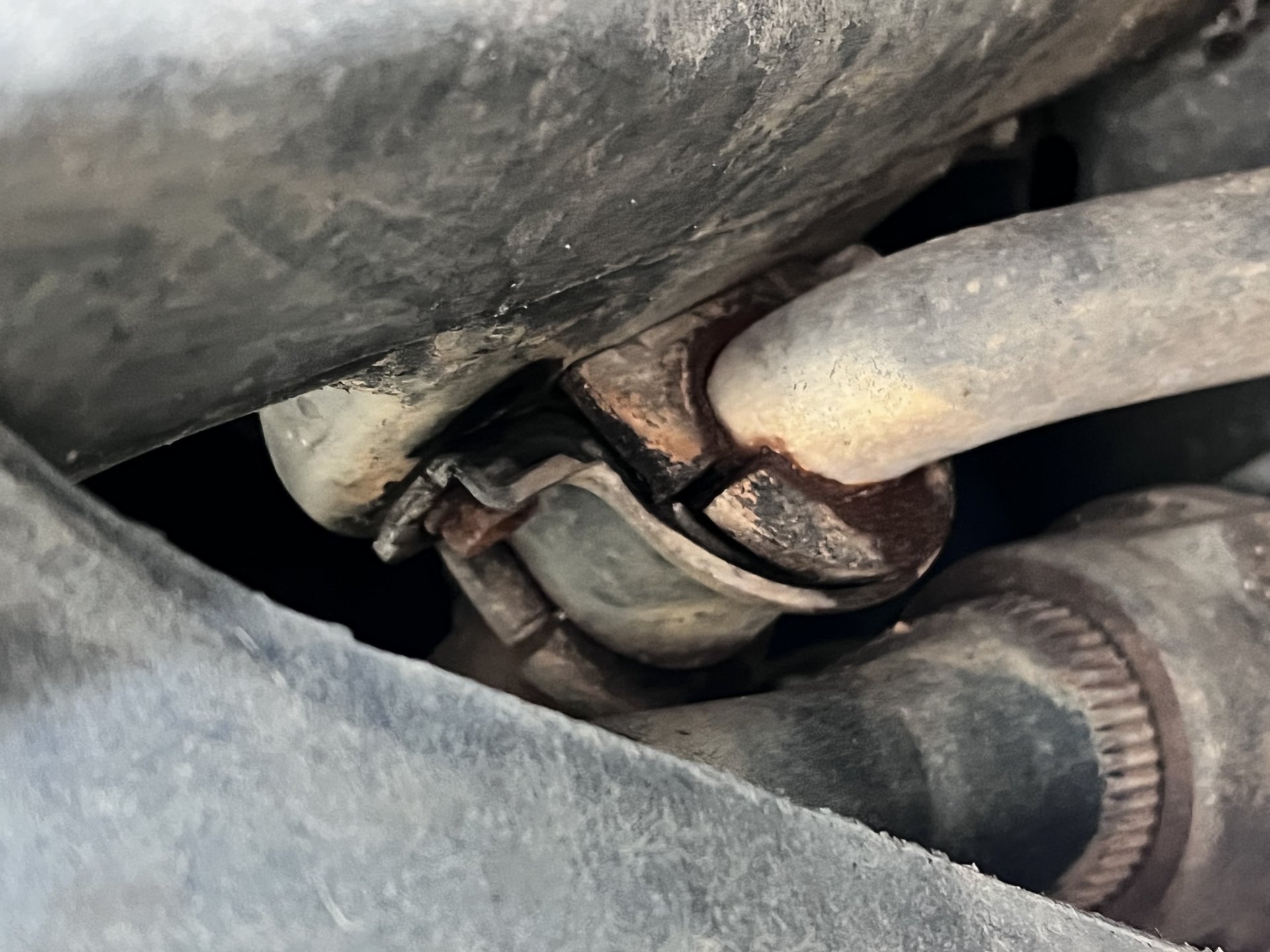

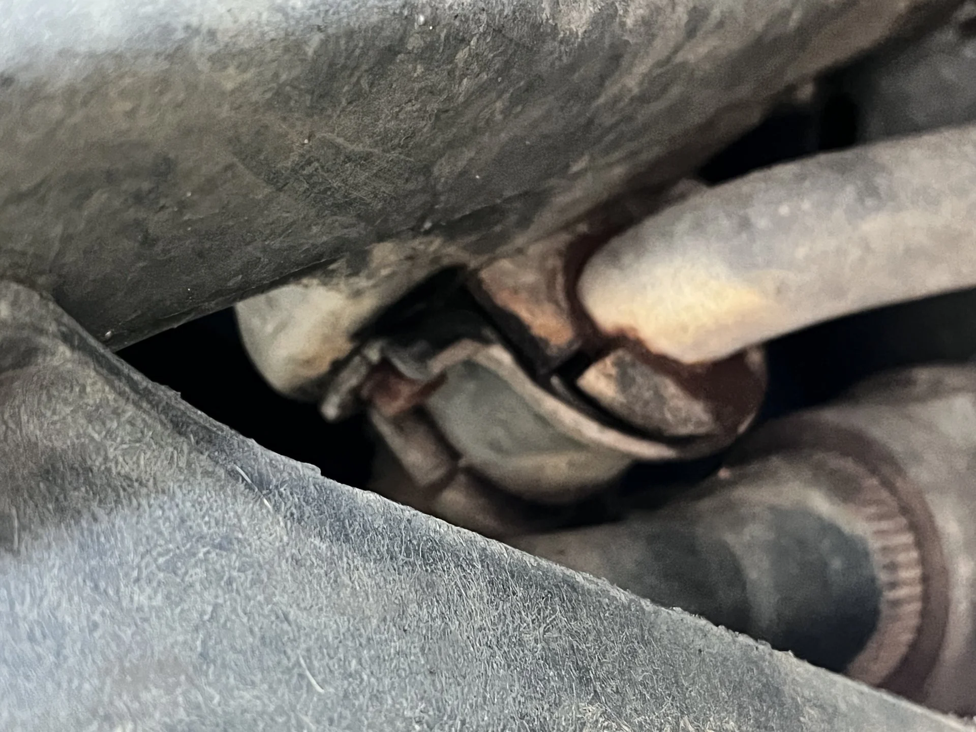

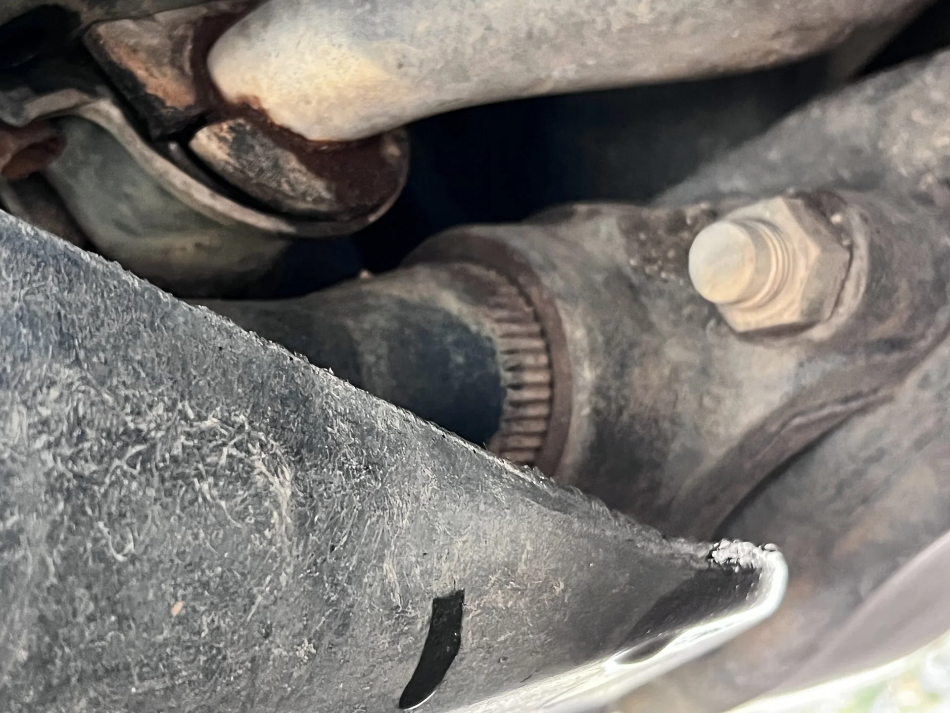

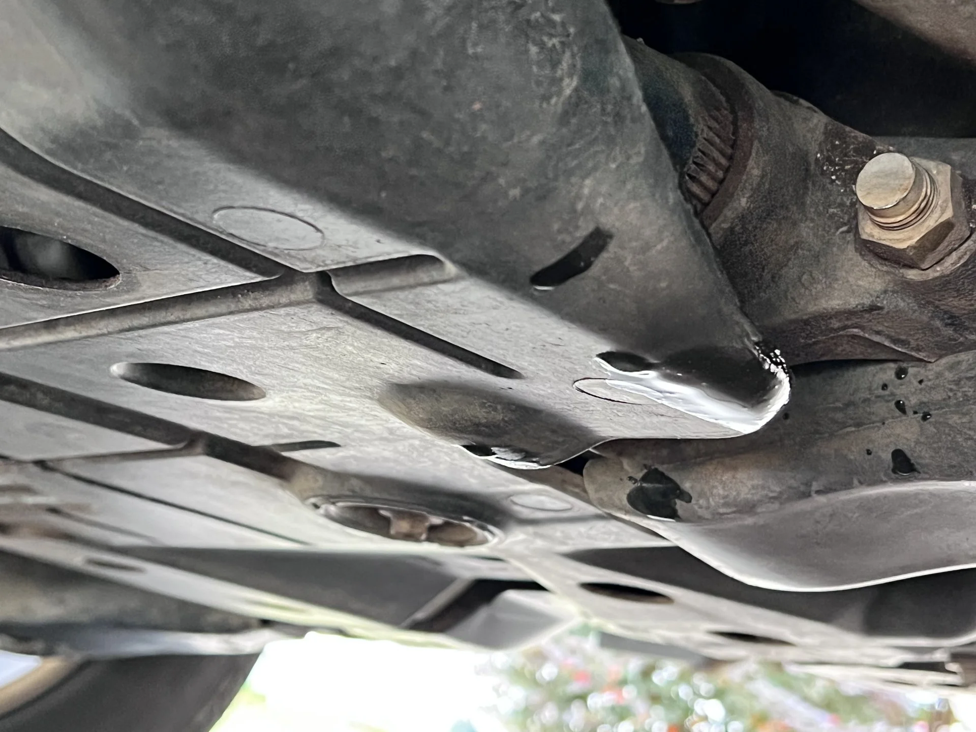

I have a 2003 LC with 182,000 miles and I have some sort of water leak on top of the skid plate. I will post a picture but it drains out of one of the holes on there. But when I put my hand on top of skid plate I could feel a good bit of liquid that was up there dripping down. It looks like water to me. I don’t know if it’s the AC but it seems a little to much liquid to be the AC. I’ll post a picture or two and I would love y’all’s input. Thanks.
If passenger side, then it's the A/C drain.
That’s passenger side. drain for AC.
You can tell because of how the sway bar mount is…
Rusted
I've had large amounts of water dump from mine depending on the environmental conditions for the day. If it's only water you are all good!
