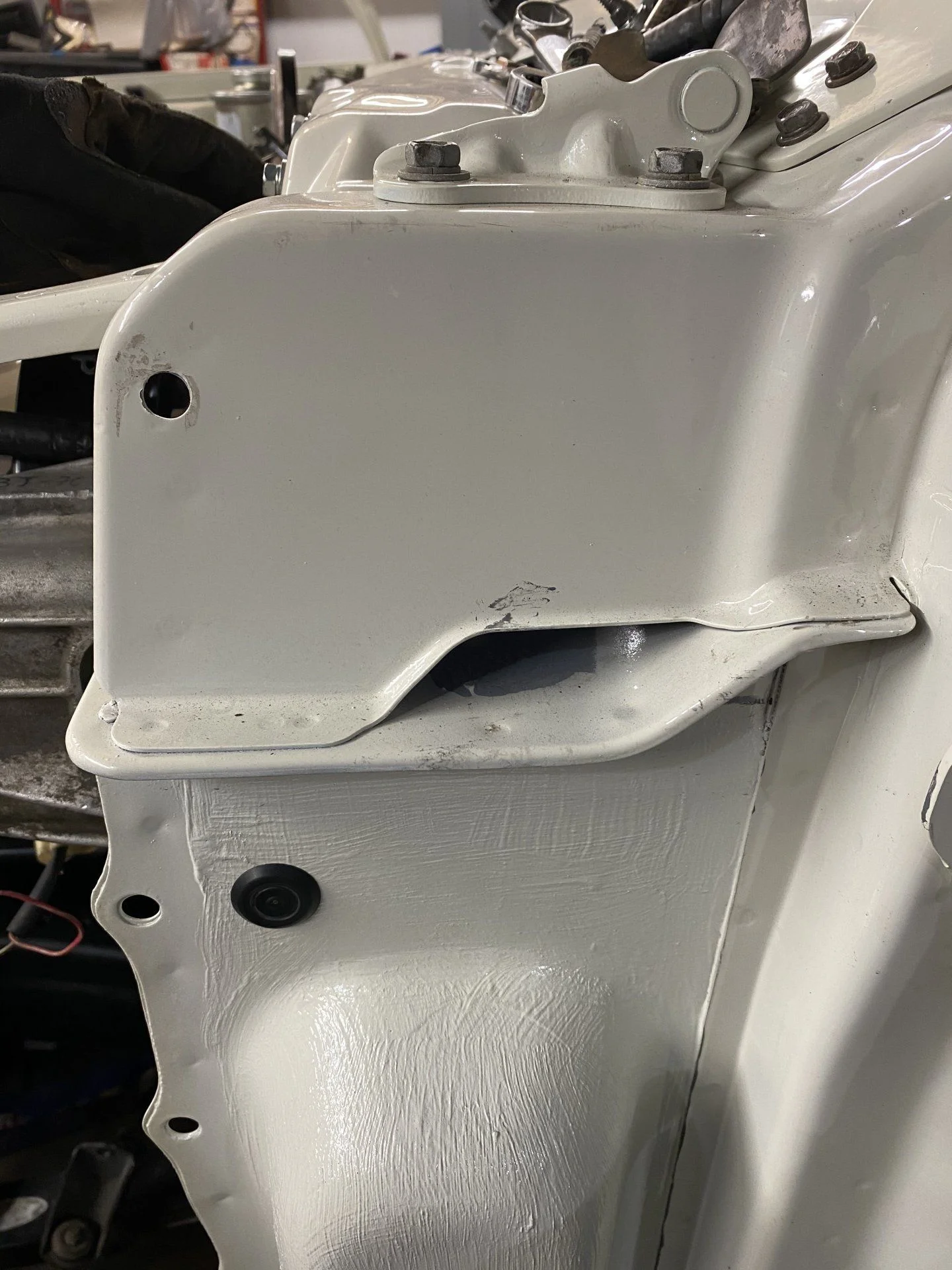

Having been inside the "box" section that the wiper rods are in I would be tempted to say you have way too much accumulated crud in this "box" area. Take the boot cowl off and clean out. Also, at the ends of this "box" section there is a opening for water to run out of but you can't access this with the fenders on.
Here’s a picture of one of the ends of the “box” drain.

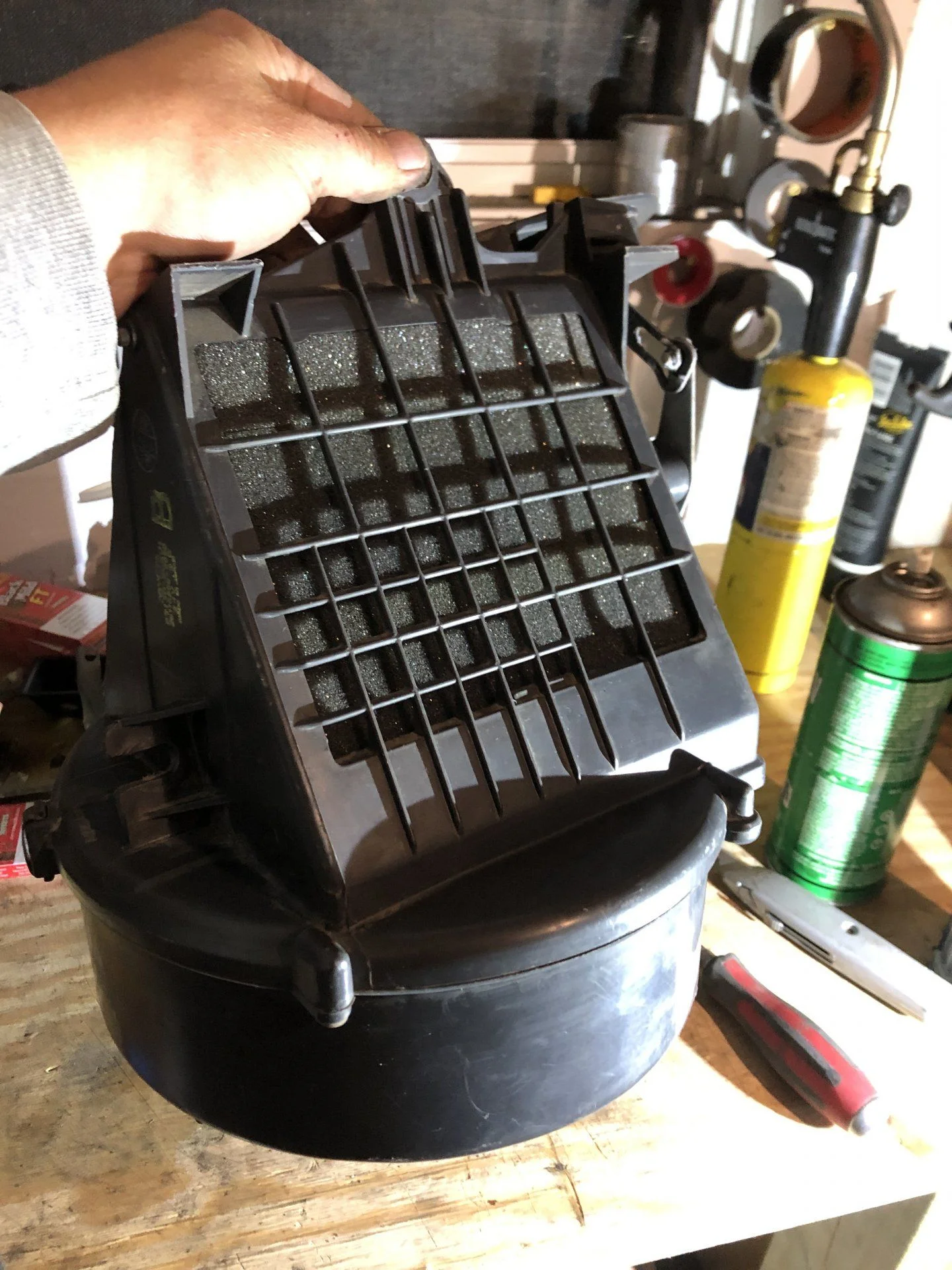

Discovered that water is not getting into the blower motor through the ducts, but rather it is dripping in (from the outside) through the motor's cabin filter. Rain water comes in from above - likely through the windshield frame and then through the dash somehow.
Does anyone know if that filter (imaged below) can be removed / changed? It is in terrible shape. If not, can the entire housing be removed without taking apart the dash?

Yes, good point, it is more of a foam baffle. But nonetheless it is completely deteriorating and I would like to remove it. Do you know how that's removed?

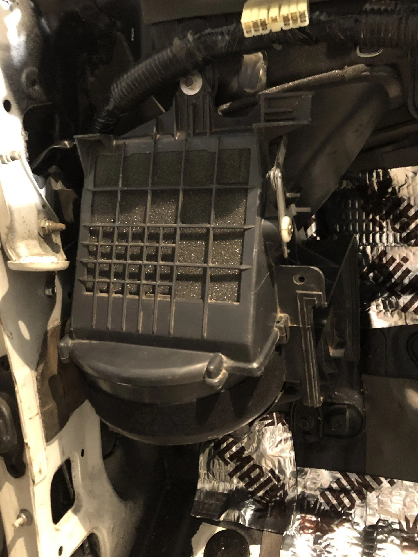

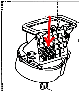

3 screws and 2 electrical connectors and the blower motor/fan assembly drops.
To access the upper portion, you will need to remove the glove box door, the glove box itself and then access the bolts and nuts to take the upper portion off.
The door is foam covered. You’ll need to R&R that and then reinstall in reverse order.
The factory manual has all of the instructions. You have a manual, correct?

Thank you Onur!! I have the HD chassis manual in English, and a hard copy of the factory manual in Spanish. No luck with the chassis manual, but I'll check out my owners manual (and practice Spanish) tonight.
The top nut was easy to spot, but not sure where the other screws are. I'll dig around more this week and see what I can find! Once the housing is out I will be able to clean it up much easier.
