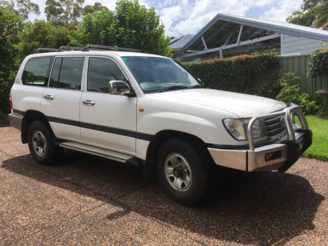

I have a complete and well received running 1999 100 series and a 1992 80 series. Should I marry the two together? SAS for the 100? Or a complete motor, tranny, Ecu and wiring for the 80?
Seems like it’ll cost the same to do either. 🤔🤔
A union between these two beauties?
105 is still 1FZFE so yeah you get a solid axle but still have to do an engine swap. And I think 2022 would be the first year they are eligible for import.
Can't we start importing 105 series next year? maybe a few years away. @beno ?
sorry, had the wrong link. I though you could get the 105 with 1fz, diesel, or v8 2uz?
