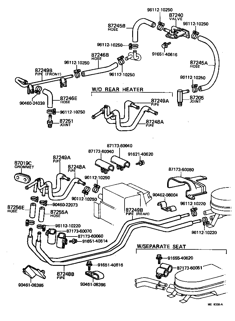

Sherman Tank Joined Apr 2, 2018 Threads 14 Messages 59 Location Bozeman, Montana Feb 3, 2019 #1 Location United States I'm looking for all of the under hood heater hoses and fittings....and any photos of how it all goes together...Thanks!
tlaporte SILVER Star 10 Year 15 Year 20 Year Joined Dec 17, 2003 Threads 54 Messages 1,142 Location Pasadena, CA Feb 3, 2019 #2 Parts diagram for the 2H heater stuff under an ‘83 HJ47 (RHD): As I recall when I checked a year or so ago, all of the hoses are available from Toyota. Might have to go to Amayama or Megazip or PartSouq if a North American dealer can’t source them.
