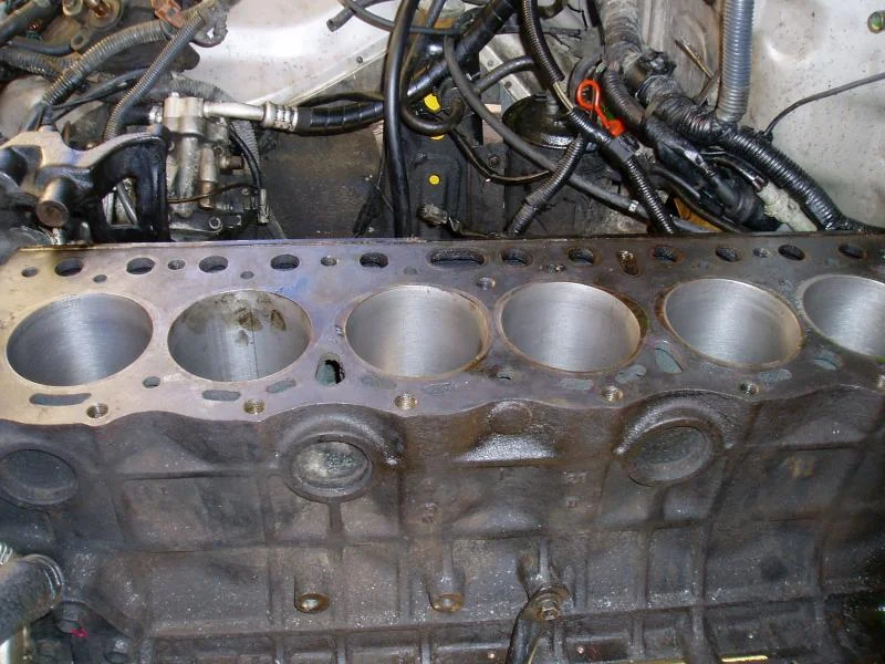

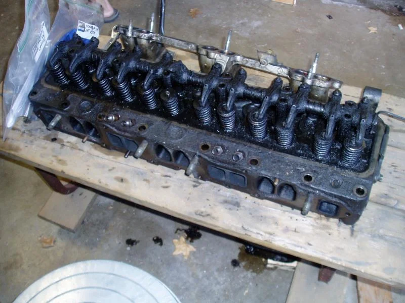

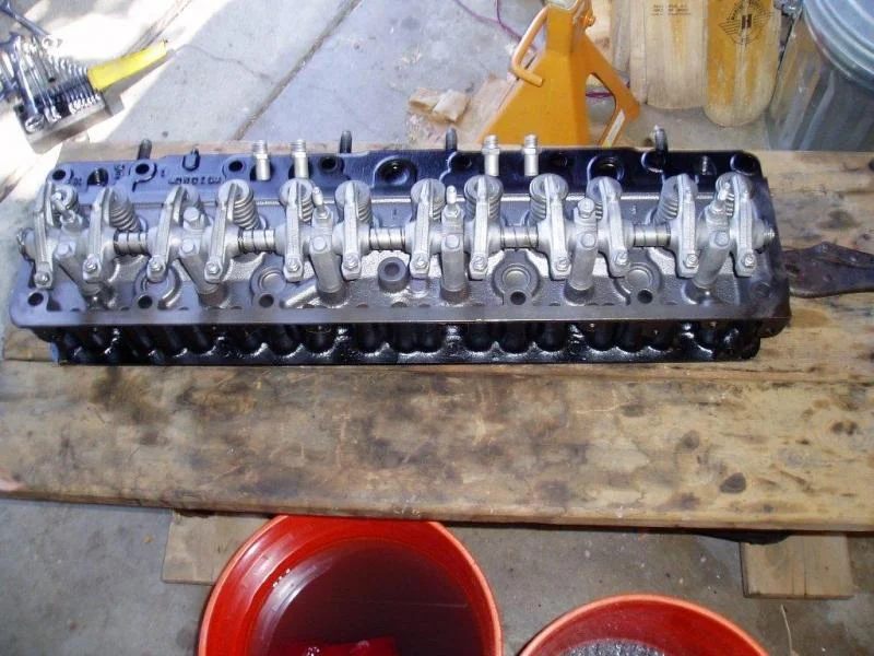

I'll be out on the Big Piney River this weekend. I got almost all the parts and next week will get my FINAL (hopefully) shipment from CDan & rod studs installed at local machine shop all ready for next weekend (10/6-10/7). Here's some pics.
Before:
After:

After:
This is the first time I've done any engine work. After I got some pistons in, I filled the top part of the cylinders with oil to see if any leaked through. It's still full, so I think my low tech, re-ring job is working.

Realize the block is in the car. My "brilliant" plan for the head is to hold it over the block, have others start a few head bolts to assure alignment, then slowly lower the head to the block. The radiator is out, so I can stand (slumped over a bit) in the engine compartment. That's the plan, we'll see.
