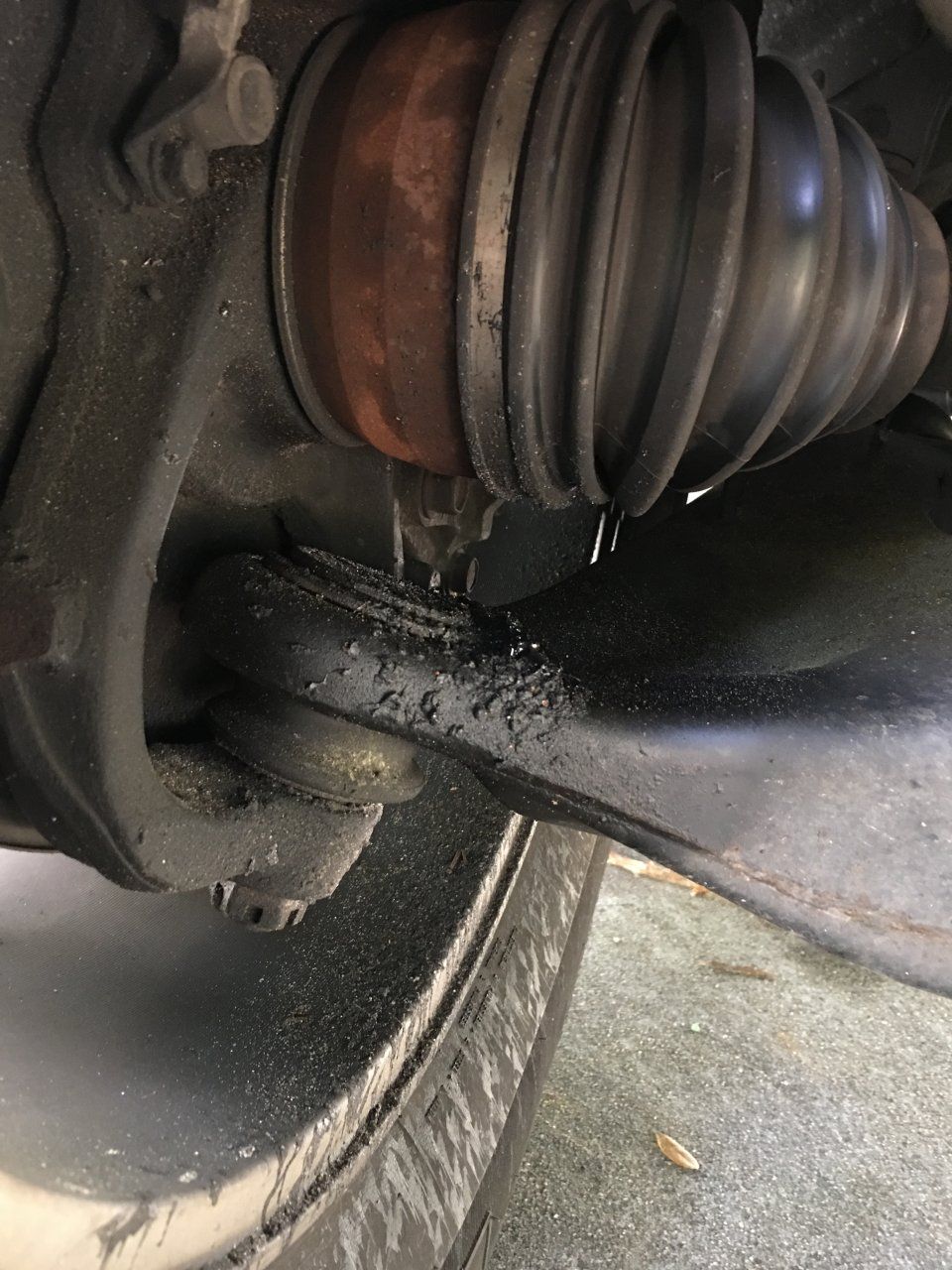

Here is a picture of the right front axle that they said was in need of replacing. I just had both cv's replaced 4 or 5 months ago.
I would try and see if you can get a replacement under warranty as it has flung it's grease everywhere, if not get it regreased and a new clamp on it if you can't find a split. Dealers won't reboot, they just replace.
