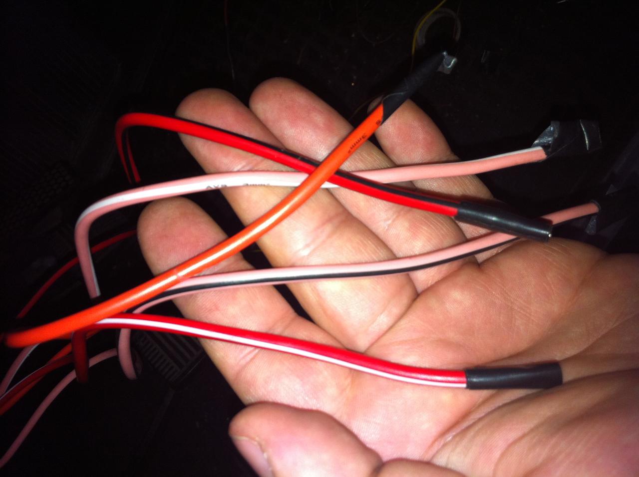

Some days befor chrismas my radio was stolen, so an friend, who is working in germany for the USAF bought me an Viper 5902.
My garage never heard from it before ... but acepted the challange xD
yea its working ... BUT they cant figure out where to connect the remote start 5 cable left
so mybe someone can help me =) :bounce:

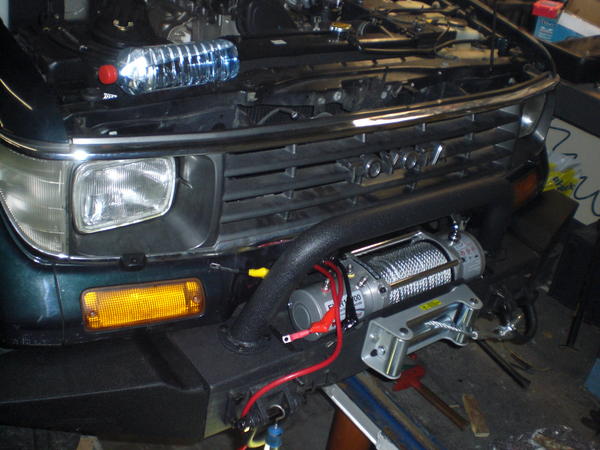

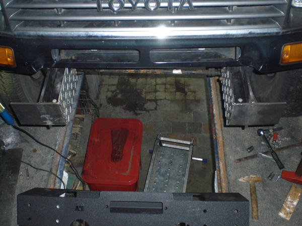

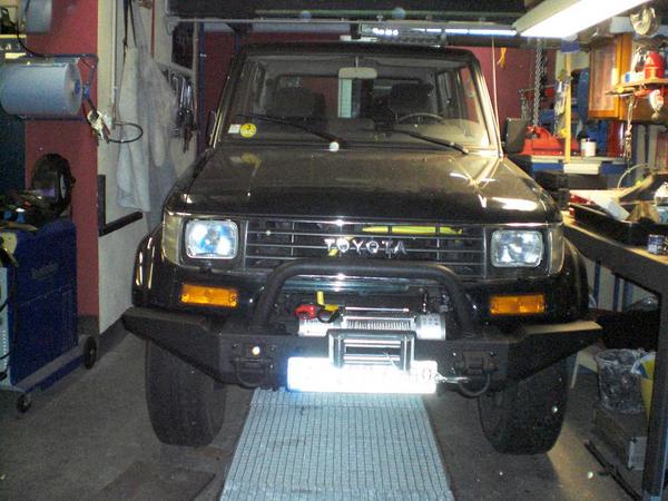

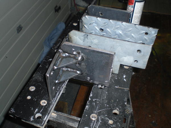

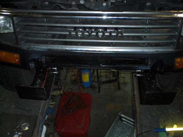

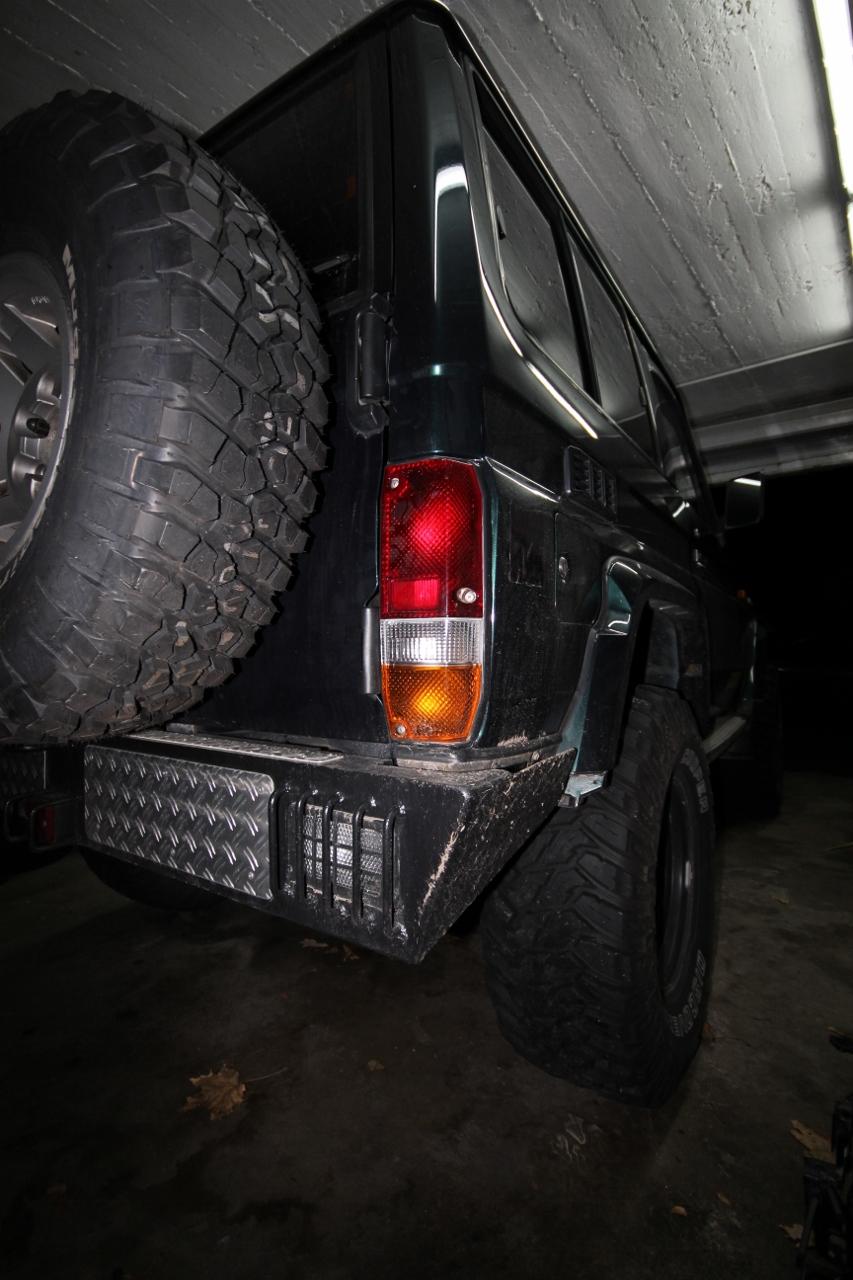

Its a rugged rige bumper custemised for toyota.
Was not to hard, just needed to built two mounts.
I can search some more pic if u want

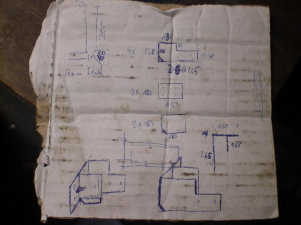

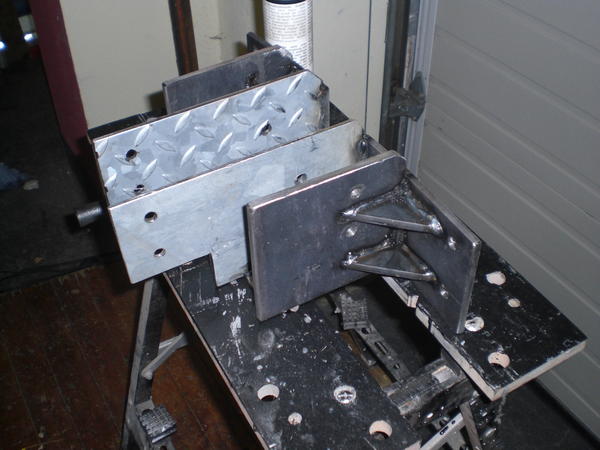

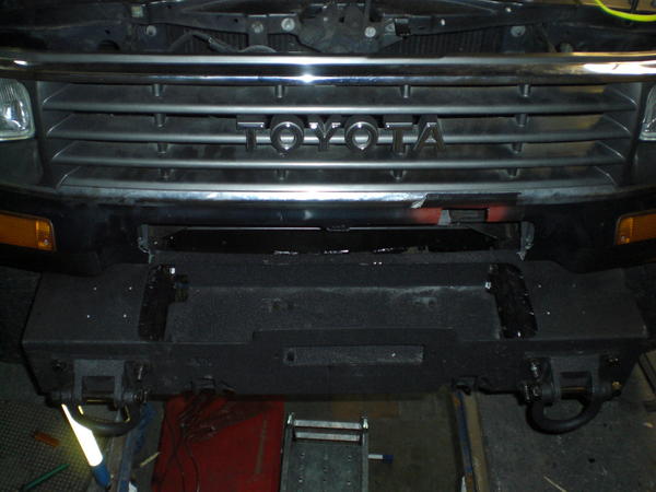

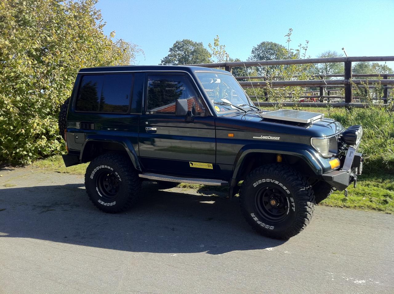

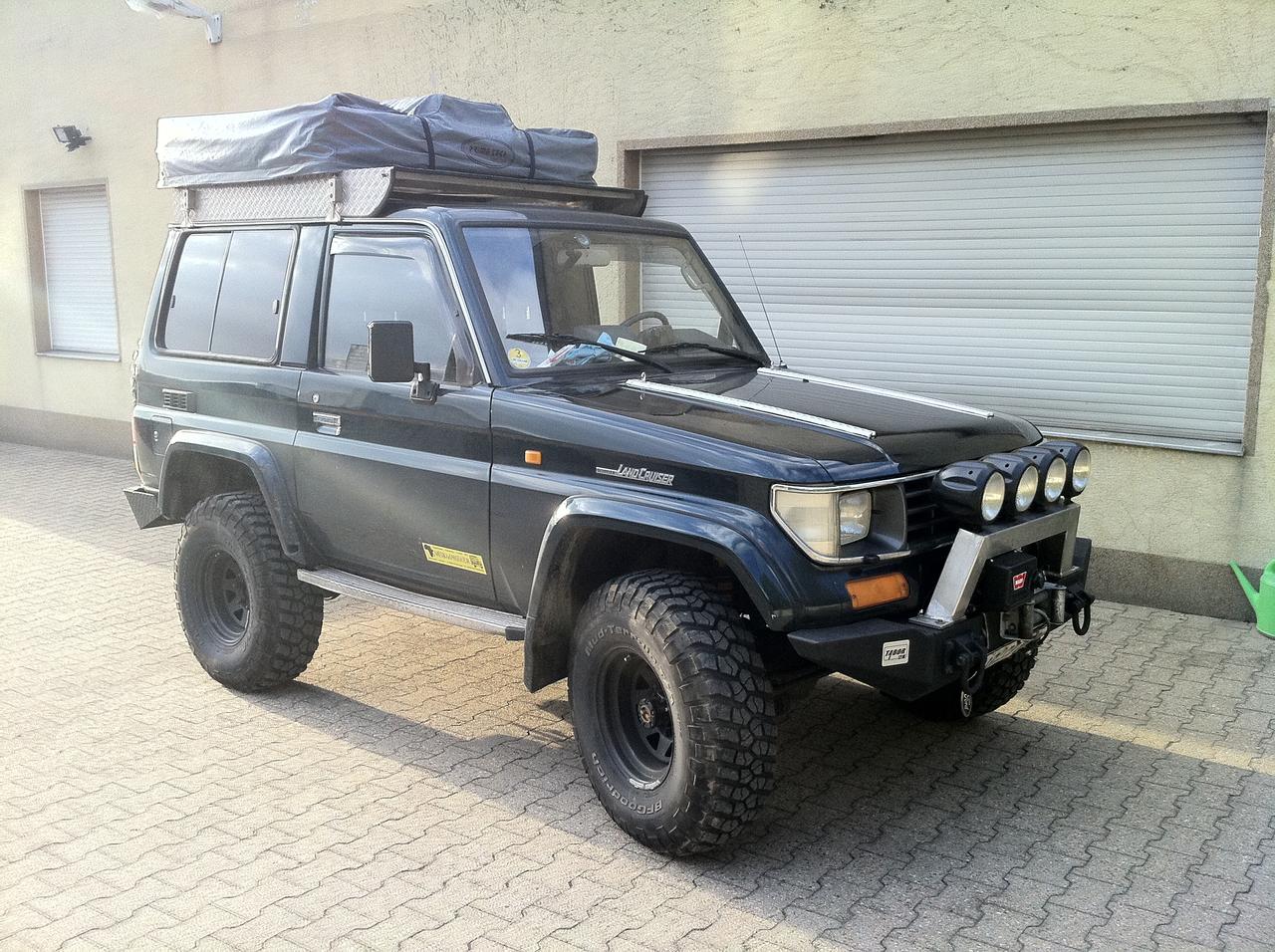

The bumper was the first thing i made on my car ^^
Bumpermount
Ive 100 more if u want a pic of an spec part just tell me ^^
some more ;)

hey
ya ive fount this side before, was very useful for the rest of my alarm but the remote start is a real pain in the ass ...
next week ill have some more time to check out these cables :bang:
I tried to call the viper suport but they just tell me to call a dealer and till now i doesnt find one u wants to help me xD :censor:
buuut im on it ^^
i would be perfect if someone would have installed the viper 5902 on his kzj an could tell me red to yellow blue to green :lol:
