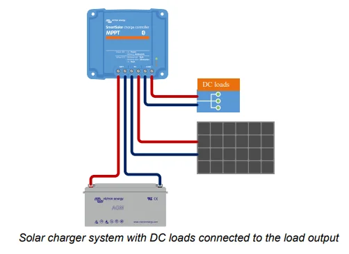

I'm (finally) installing my 75/15 Victron but can't find a clear answer on something (the included booklet is barely there if ya know what I mean).
The 'Battery' and 'Load' pair connections...does the controller use the 'Battery' pair only for power, or does it charge the battery thru that pair as well?
Trying to find out if I need to connect the 'Load' pair to the battery bank I intend to charge thru the controller (which is the same batt bank to be wired to the 'Battery' pair).
There will be no additional load other than the batt bank.

The Load output is for powering DC loads and does not connect to the battery. It is for convenience being able to power small loads directly from the controller.

OK! So if I only intend to trickle charge a batt full-time, then I'm only using the 'Battery' and 'PV' pairs?
Yes that is my understanding.
yes, the main battery to be charged should be connected to the Battery port, not the Load one. There are algorithms built in that reflect / rely on that.
