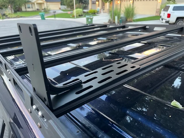

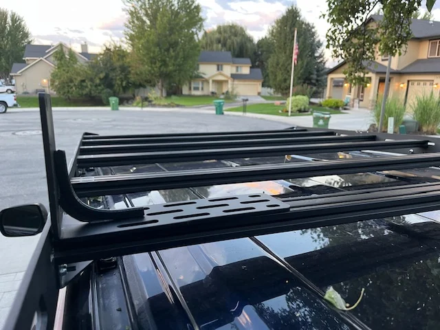

I am so dissapointed with my V Roof rack. I just bought a 270 awning and realized once I start to install that I have to spend $170 extra dollars to purchase the V awning mounts in order to install my already expensive awning. I am starting to regret this purchase.
