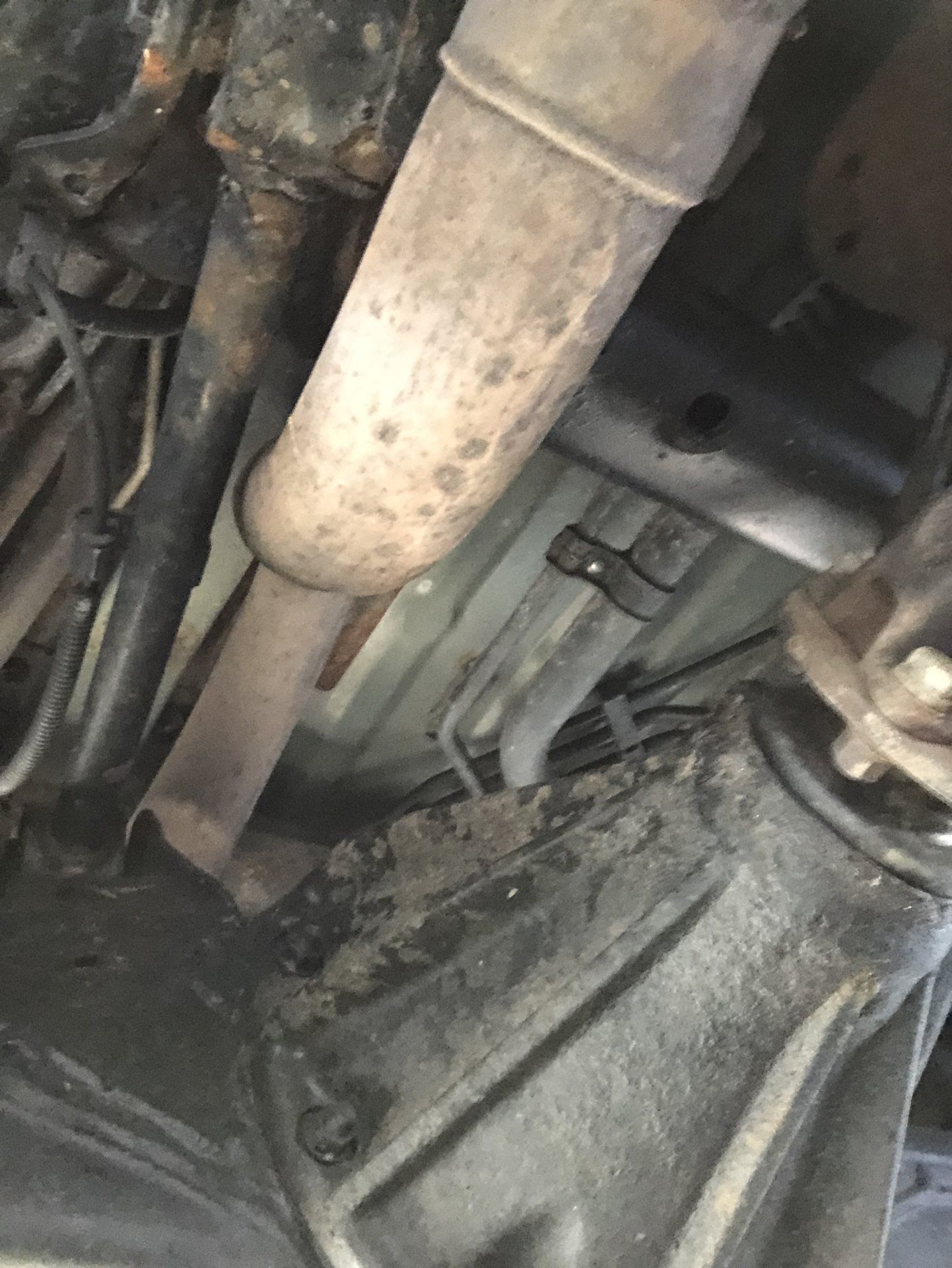

So, the closeness of the exhaust pipe to this sway link was pointed out in another thread (ignore the booger weld, that was done at a shop when the PO had part of the exhaust replaced).
I feel like this is probably the source of the vibration, for my truck. I wanted to see if I could create some space between these two parts, so I took a two by four that was long enough to reach from just outside the wheel well, and a hammer, and started hammering. I couldn't get that exhaust pipe to budge. I think the hangers are absorbing most of the force from the impacts?
After hitting it a bunch...
Whoever previously did the work routing the exhaust pipe failed to consider these parts making contact. It looks like it gets really close to the floor, too (the section after the bend up).
Now that I'm thinking about it, there are two separate rattles: one during acceleration, and another on pot holes (like bouncing metal on metal, could be the exhaust hitting the bottom of the cabin floor.)
Of course, there is always the chance this isn't even the source of the noises.

Does the exhaust wobble or move enough to touch the other metal parts, if you shake it?
Can you see any evidence of rubbing - polished metal, or the like, between the near components?
If they are rubbing, there should be a visible sign.
Is there any noise from the exhaust if you wobble it?
Could perhaps be caused by a crack, rust, where the exhaust pipes go into the muffler?

I left my truck with that shop. They called the same day. Turns out, as quite a few people suggested, whoever the PO had do the muffler work did a really terrible job.
The shop cut the pipe, added a section with the correct bend, re-routed it and properly secured it. The vibration under acceleration is now completely gone. That V8 engine sounds so good. :)
