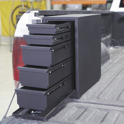

With that as the backdrop I have been looking for essentially a narrow file cabinet like box that could replace the left side rear seat. I’ve been looking at some rear entry, behind the wheel well tool boxes for pickup trucks. (Some even have rear access pull drawers.) My gear list is light compared to many. My biggest, bulkiest thing that is a bit unforgiving is jumper cables. I have a plug kit, light tow strap, light 1st aid kit, little compressor and a few hand tools. It all fits in a slightly overflowing milk crate.
I’ve scoured build threads, searched this forum (100&200 sections) and haven’t seen anything that has a similar footprint to the removed seat. The goal would be to have the cargo area similar in size to the OE cargo area with both seats folded.

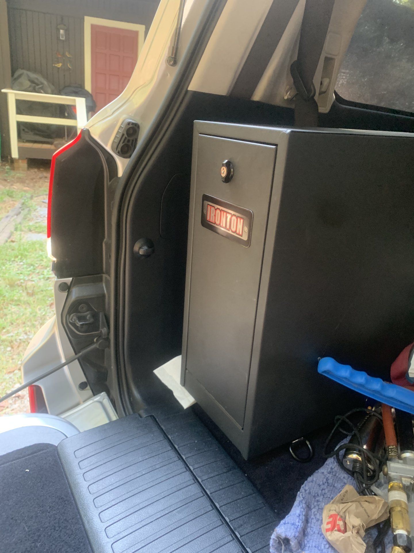

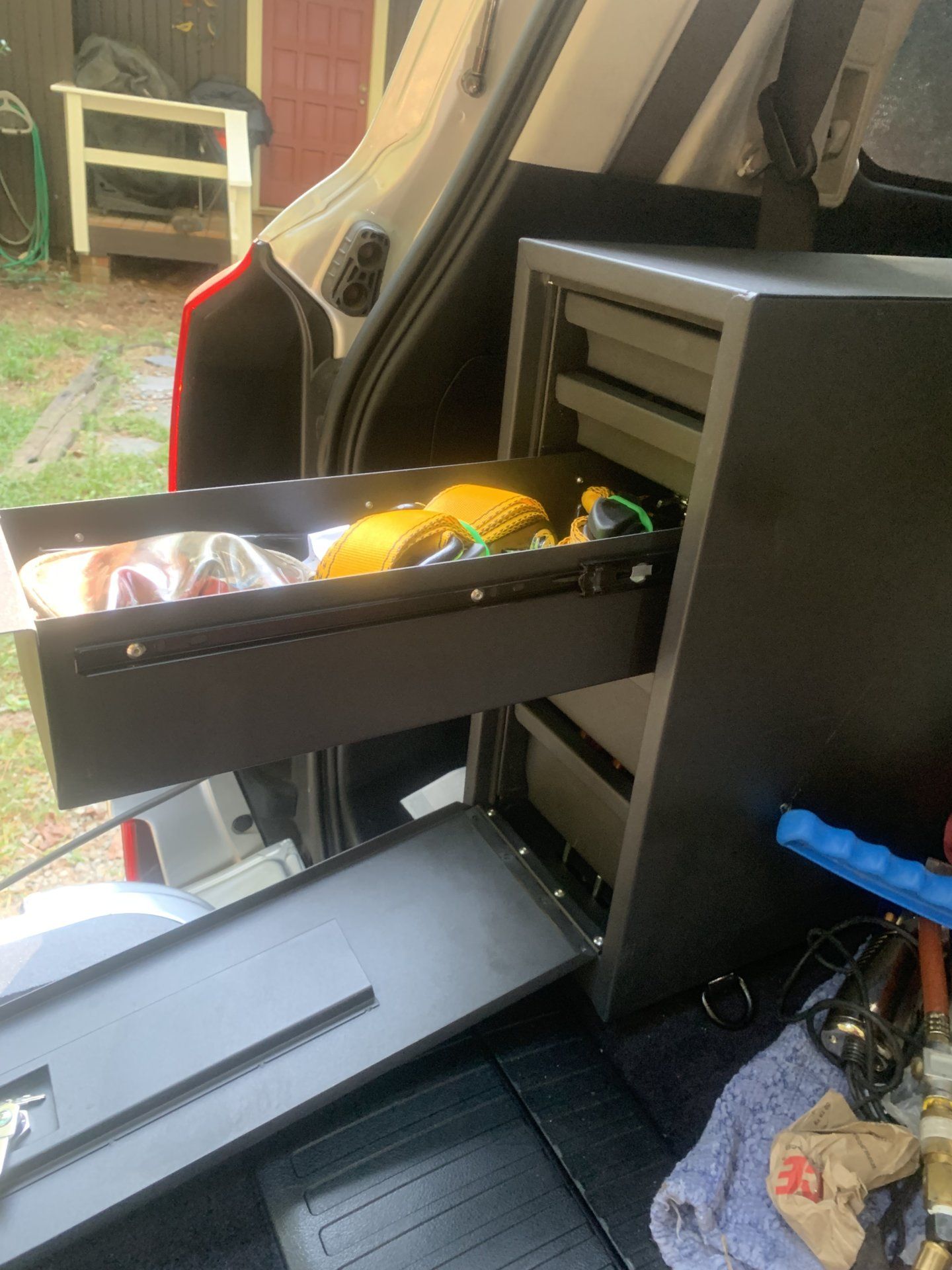

Well, I did it. So far it’s exactly what I wanted.

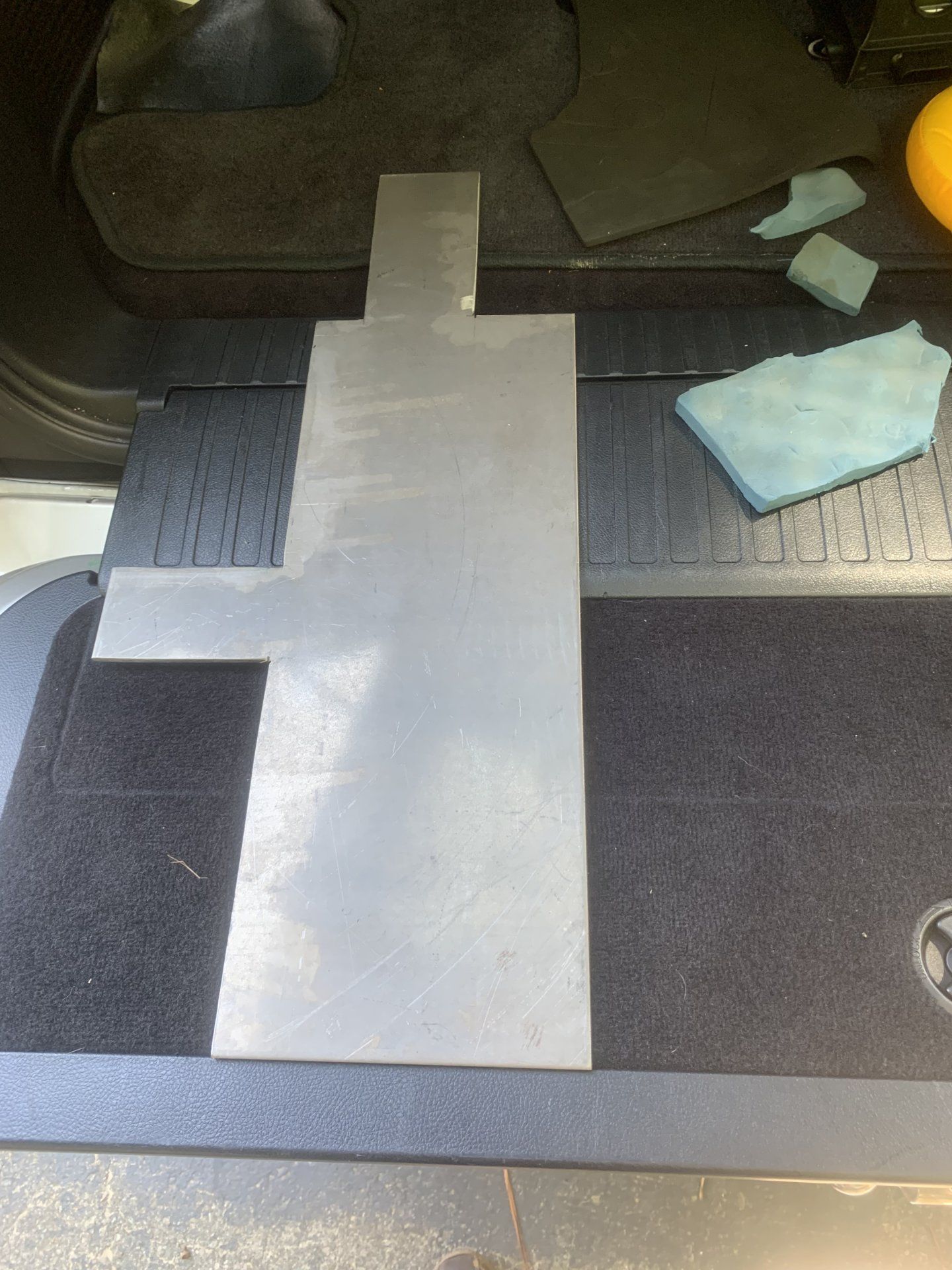

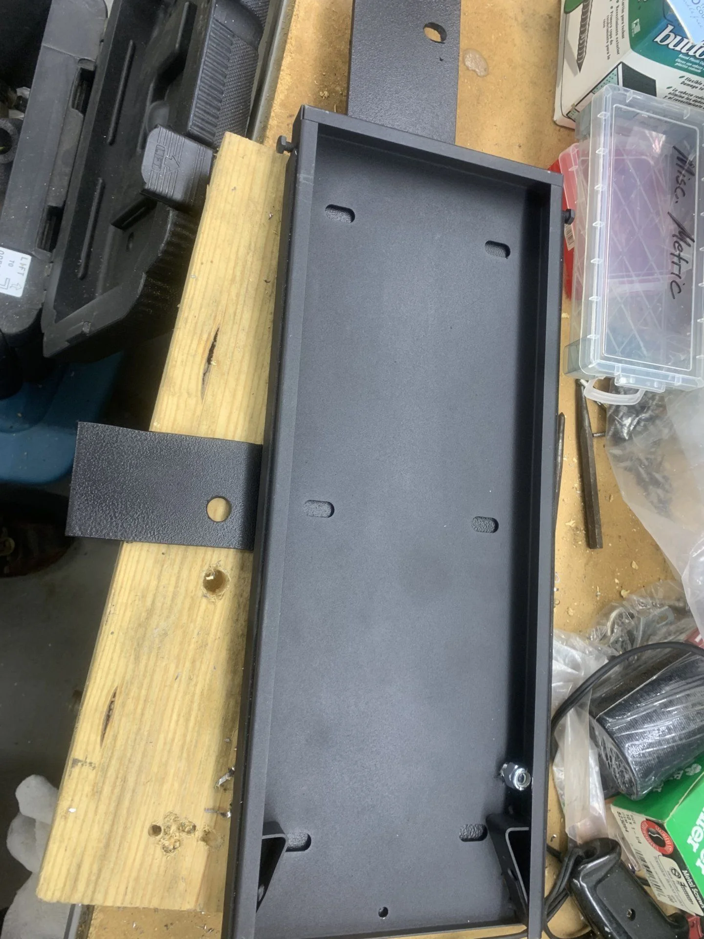

I removed one rear seat, used the seat mounting holes and bolted a 3/8” mild-steel plate. I then bolted the toolboxes mount plate to the 3/8” plate. I then drilled, in assembly for the base to truck bolts.

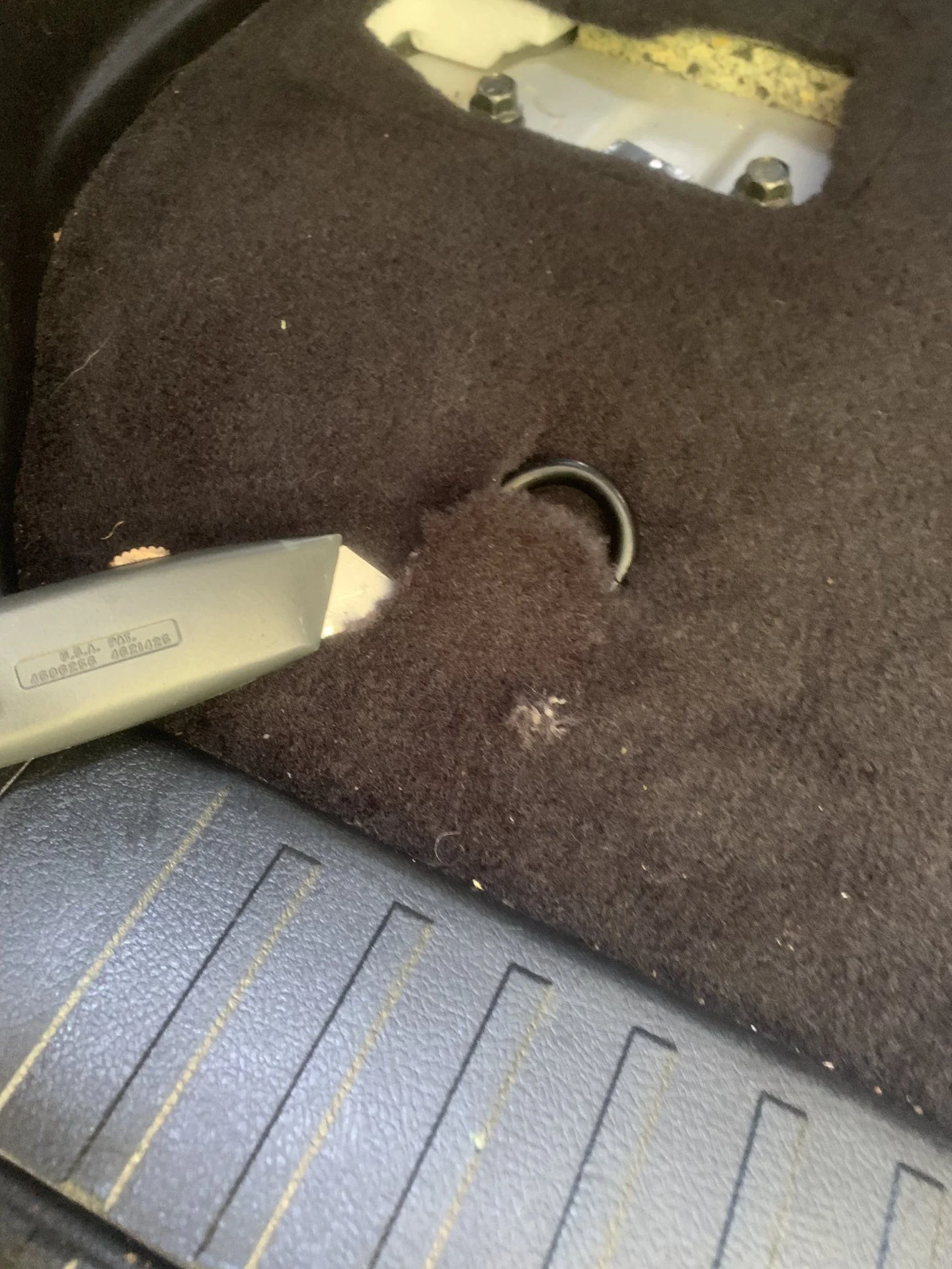

The only ‘non-reversible’ thing is a one inch cut in the carpet near the cargo hook. I wanted to make it so it’s a super easy return to OE.
Overall it’s mostly quiet in normal driving too, I’m very pleased about that.
