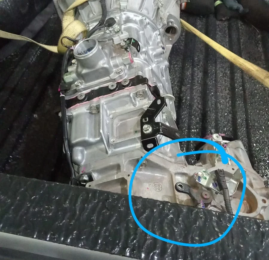

Or if in ex hire vehicle they may have locked low range out. Have a look for bolts or something restricting the movement of the transfer lever/linkages.
Happened to us in Aus we soon had it disconnected stuff them and went wheeling :-)
If it has had a clutch done before, check to see that the linkage rod's nut for the transfer actuation is tightened properly and inserted correctly into the taper of the range selector lever on the side of the transfer case -
