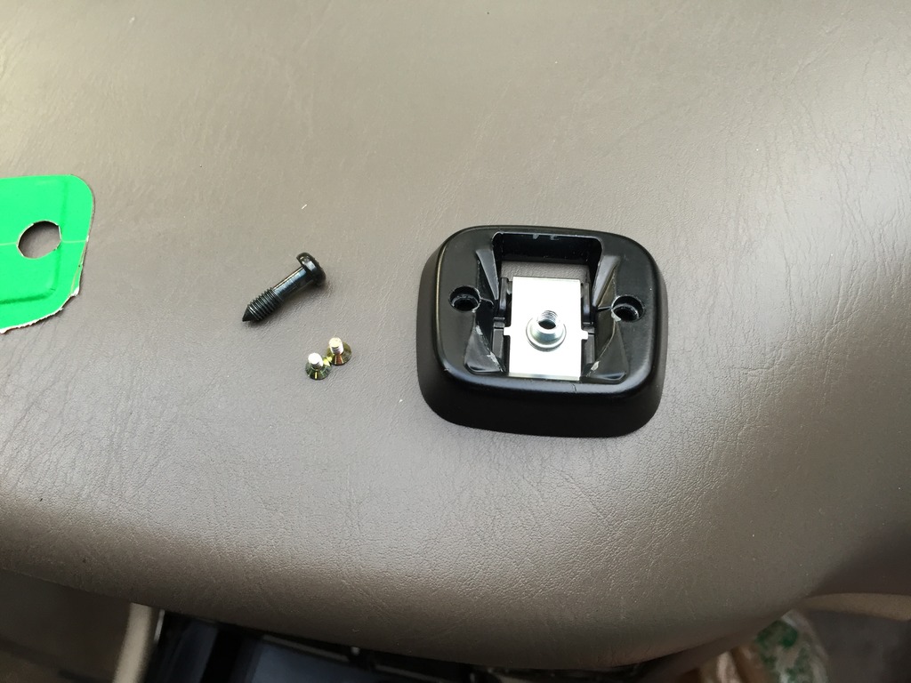

Here's the intermediate bracket that goes between the windshield and the mirror post itself.
When I took the mirror off again last night, it turns out that the threads on that black screw aren't M6 or M7.... they are actually M5 x 0.8 (thread pitch)

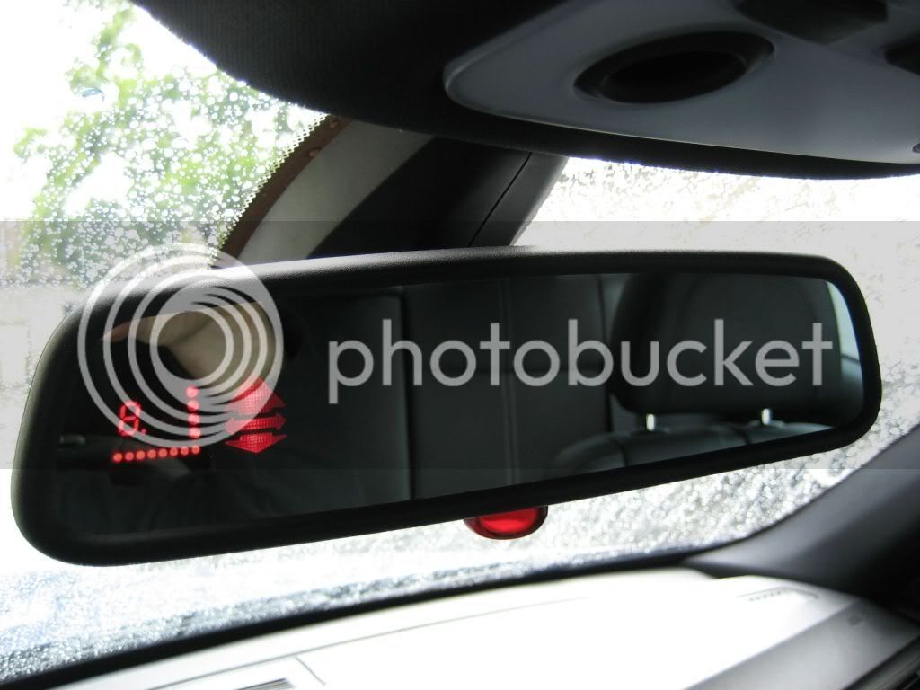

You could build the display into the mirror - those setups are very slick.
Yes..... very cool.

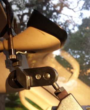

I have one of the $40 ones. To prevent the slipping, I made a little "z" hook that uses the screw hole to prevent it from sliding down the taper.
Well done! Simple and effective. :)
It looks like the V1 is going to be substantially below the bottom of the mirror however.

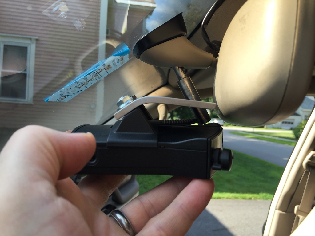

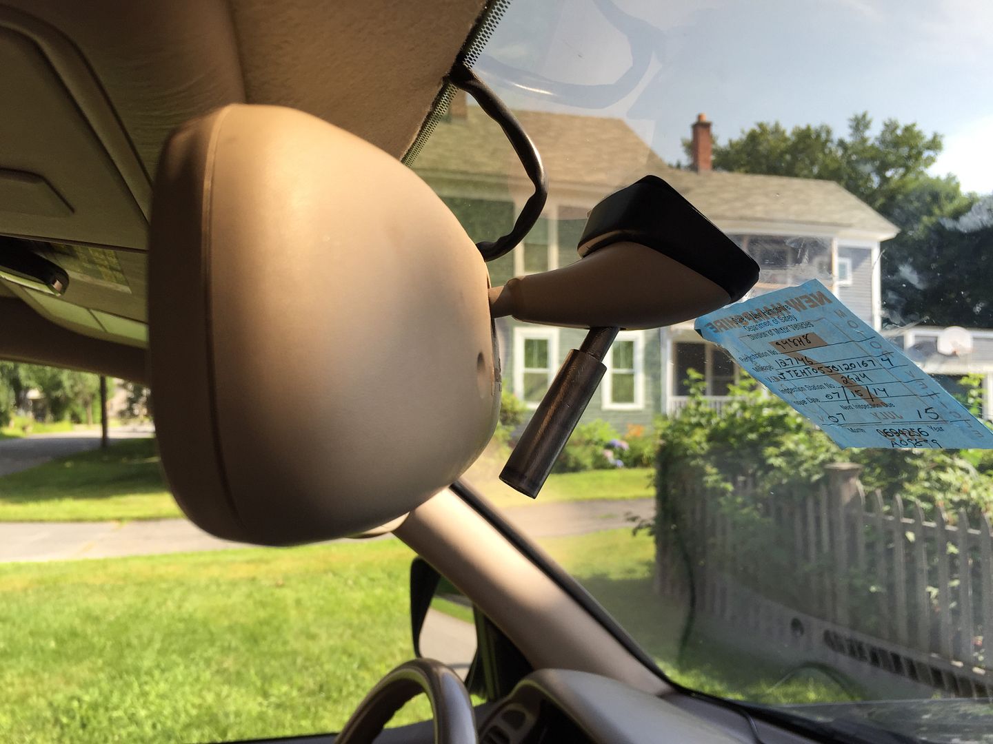

I took my new M5 x.0.8 screws and grafted them into a small hex spacer....rounded the 6 corners off the spacer and sleeved-it into a larger 1/2" diameter thin-wall steel tube. I wasn't sure how long it needed to be overall so I just left plenty of extra length to start.
The only "trick" that isn't immediately obvious is that the screw that goes into the mirror stalk (and into the windshield) needs to have the threads filed off partway down to match the factory screw design. This allows you to thread the screw into that springclip but also allows it to be "sloppy" enough that you can then finagle the clip over the windshield mounting tabs so that it can lock into place. If you leave the screw fully-threaded it's basically impossible to reattach the mirror to the windshield.

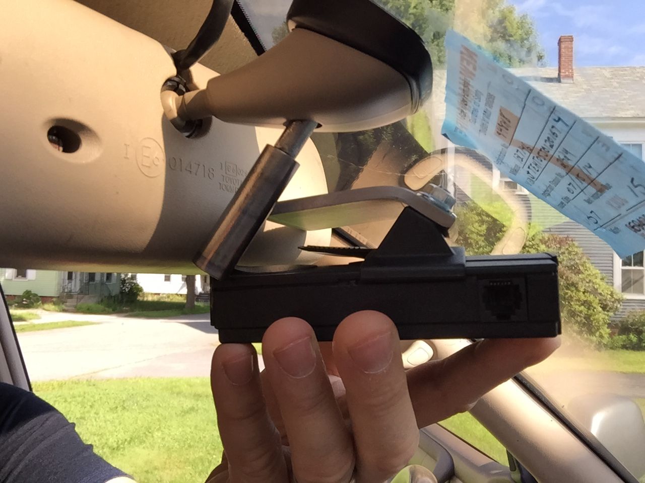

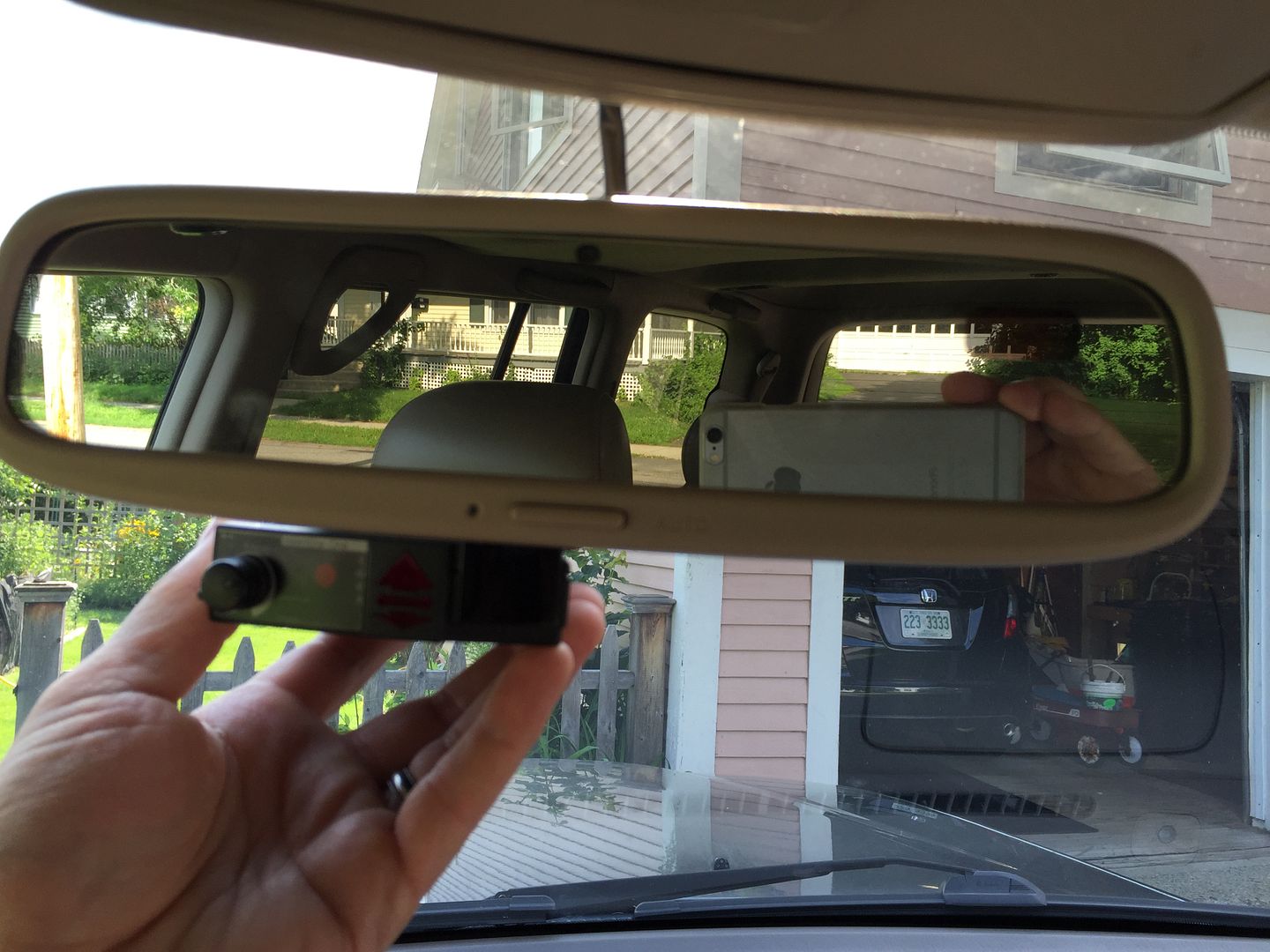

Here is a sideview of the target mounting location for the V1 based on my own personal preferences. You can see that I'm really trying for quite a bit of "setback" from the mirror face.
....and I'm trying to keep the V1 really tight to the underside of the mirror.
So here's what I need to figure out on the back side.
Obviously the V1 is completely offset toward the driver's side of that post, and that's where I want it.... makes it easier to see and to reach the damn "mute" button when it's reporting Audi park distance sensors instead of actual speed traps!
I think what I'll end up doing is to cut down that post by another 1", then weld a small section of 3/4" tubing (vertically) to the mounting plate on the V1. That will allow me to "sleeve" it to the post and will give me an up-and-down adjustment for height, and also allow me to rotate the V1 laterally to align it under the mirror however I want. A small hole in the outer sleeve can be tapped for a set screw and I can lock the final position down from there.
After that, remove the whole thing....rattle can the bracket and screws black and re-install.

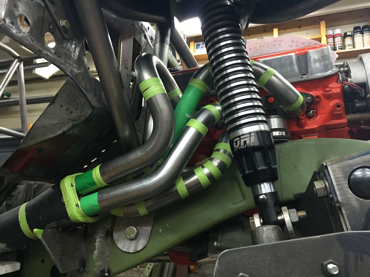

The latest project is designing a set of stainless headers from scratch. Never did that before, and I had a blast doing the mock-up work!

Actually, the mount has 2 joints, so it tucks right up under the mirror (like an idiot, I had it for a year before I realized this lol.) I know how I get obsessed with projects like this, so it's amusing to see it in 3rd person :)
Great idea. Mind if I co-opt it?
