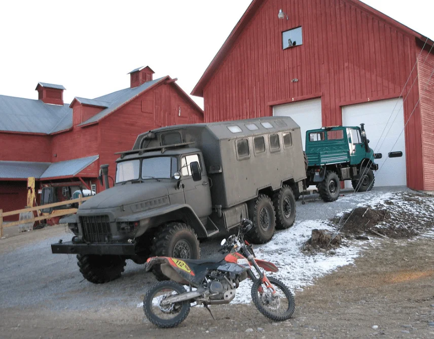

Thread is worthless without photos:
took this one back in 2009 I think.
