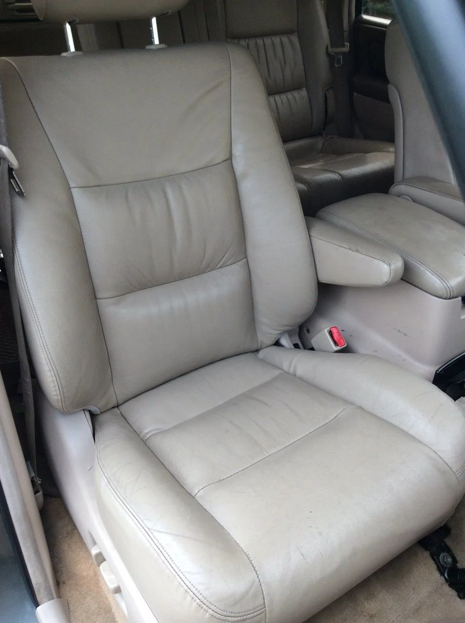

Agree with the above. It's a little fussy but that's all. I added foam to the passenger side in an LC. The photo doesn't show it but I did the side pieces on the lower foam as well as the center pieces.
