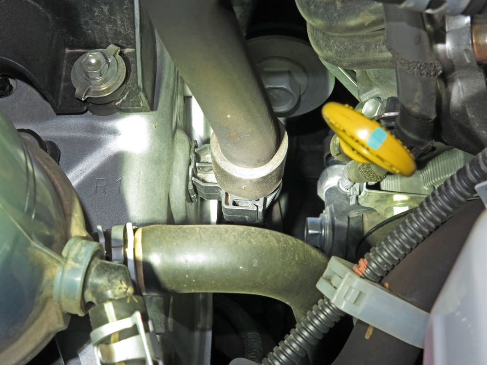

Is anyone able to help identify this clip that broke?
It holds a hose that im pointing to and a wire bundle in convoluted tubing together then it has a tab that attaches to the side wall of the engine bay.
Toyota broke the tabs when replacing my water heater and I wanted to have them just send me the part but I can't figure out the part #
They sent me a replacement but it was the wrong part so I wanted to tell them what it was.
Thanks!
Does it clip in to where you're holding it? I found that hose on toyodiy but the clip is not showing, might be in a another section of the parts diagrams
*the clip will be for holding the wiring, and not the radiator hose
Piping on the 1ur is slightly different, and much less electrics (maybe for gcc spec?)
If you could post a wider pic or show where that pipe is coming from and where it's leading/connecting to would narrow it down. Also what year is your cruiser pre or post '13

look for the clip under the air pumps, that rubber hose goes from the pumps to the plastic tube. me I would just zip tie the harness to the hose to keep it out of the way, not a major issue
Here are a few more pics
The clip i'm looking for holds The larger hose (not sure what its for maybe coolant?) and the convoluted tubing then there is a tab on the clip that pushes into the side wall of the engine bay
if someone knows what that hose it that may help me search.
I don't think its a huge issue, but I'm just being annal about the issue since they broke it.
This is a 200 series 5.7L
I don't know if it will help, but here's what that clip looks like in situ on a 2013:
HTH
its for the air pumps. The air pumps are located in the r/f wheel well area and the tubing and hoses run to the front of the motor and under the intake back to your switching valves.
