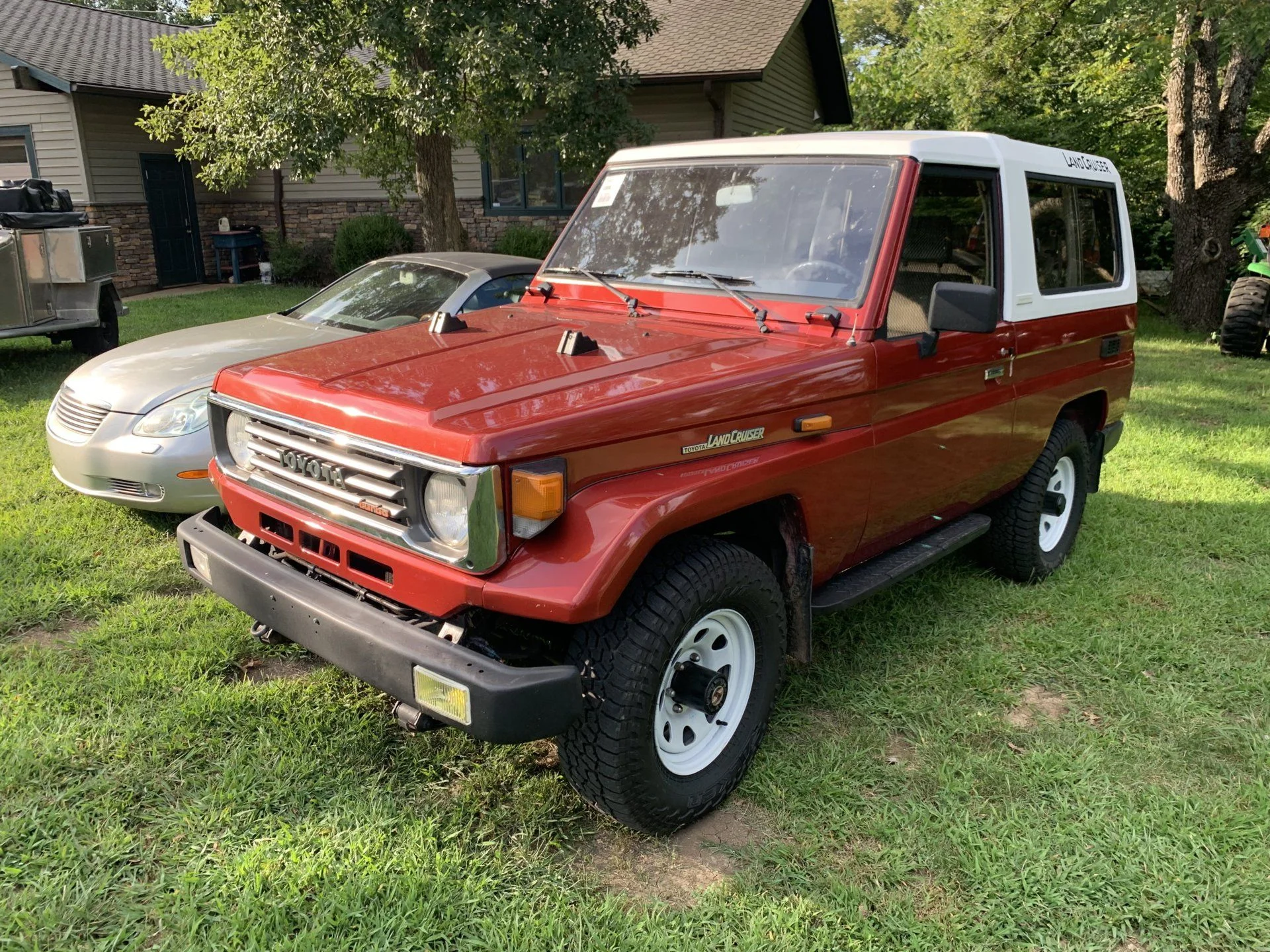

I took one picture of the car today..... Saw at least a half dozen people taking their own picture of it :D:D:D:D:D
One unique feature I see that I did not expect is windshield rest blocks on the hood. Are the upper door frames removable as well?
My JDM BJ74 does not have rest blocks or removable door frames.
Thank you Dan
I wonder what those people call you if they don’t know your name? You definitely must have one of the more unique collections in the area. I know in my neighborhood there is “old rusty Mustang collector”, “old Volvo guy” and “fast n furious kid”. Don’t know their real names.

I also see folding wiper arms so I bet the door frames are removable. Way cool truck.
If that was mine I would put an LS in it, lift it about 3 inches, put factory flares on it, move the front axle forward an inch and put 305/70/16 Mikey Thompson Baja MTZP3s with OEM 80 Series 16x8 steel wheels with 1.5 inch Spidertrax spacers.
Then I would drive the wheels off of it.:grinpimp:
Indeed. My device is not good enough to see black frames
If present my question is irrelevant.

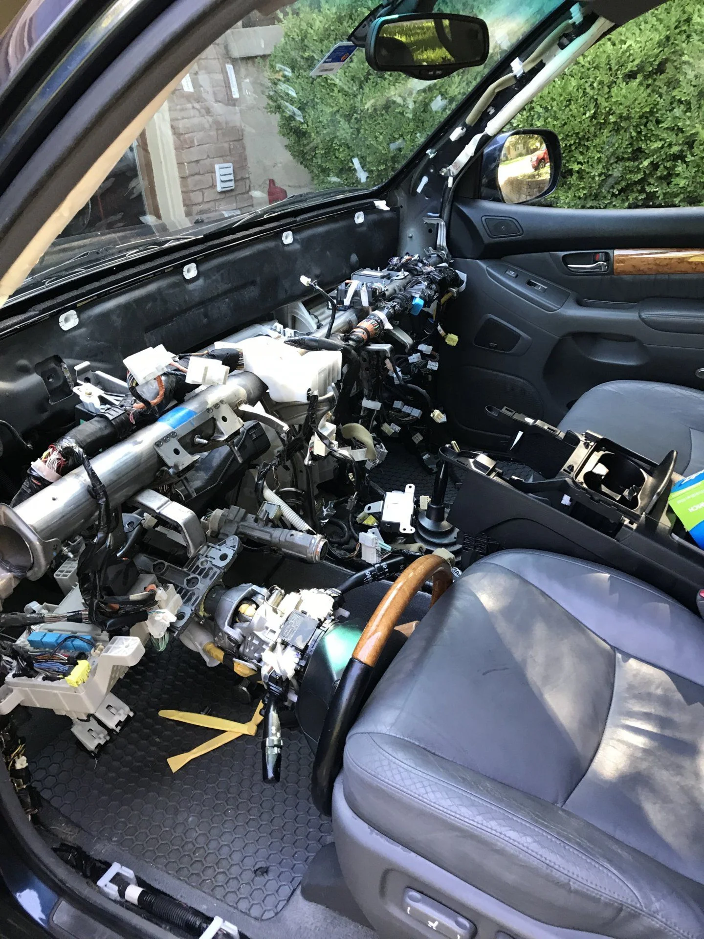

Yes... freakin' hidden behind the dashboard. I have the new Denso unit ready to go in. Tonight my boy and I are going to start dismantling the dash.
I hope this gives you inspiration. It sucked to do this on my wife’s gx470. All others are simple(r). Just be methodical with pics of each step.
